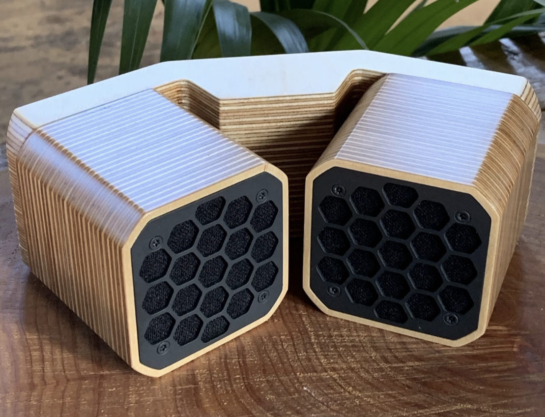

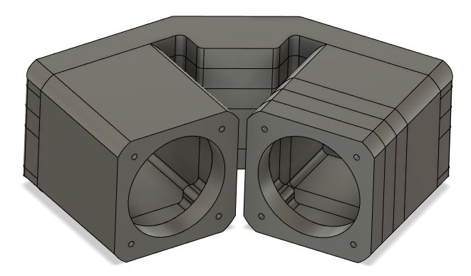

I put a pair of those Alphas in a Mini Back loaded Horns that I 3d printed for them.
Hi tiverson,
Very nice work - that’s a huge print! How long did it take you?
Is the print file something you will share! Live the sound. Great stuff.
Happy new year everyone!
thanks and happy new year to you, it was a big file and took over 3 days to print one. the horn is over 2 feet long. my build plate is 400 mm x 400 x 450. I designed it to fit with in the space. here is move views of it.Hi tiverson,
