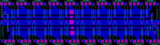

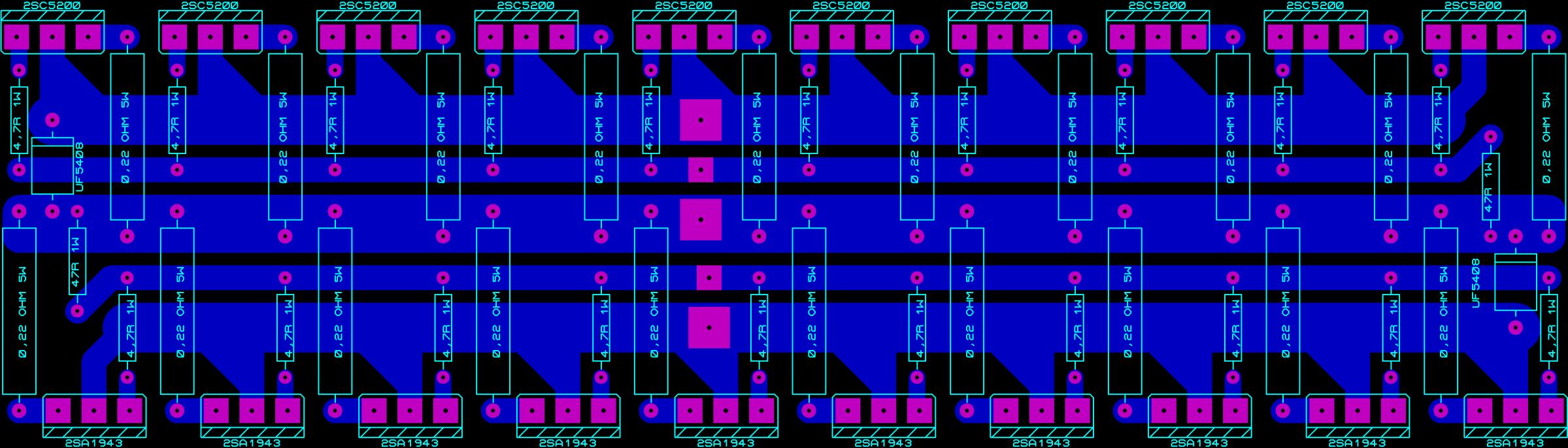

Hi all DIYers!
I have the B500 built, it's just about to test. I also plan to build the H900.
A few question about this two amps:
-I have some VTL5C1 lying around, can it be used in the limiter with 47k parallel on resistor side?
-I also have a bunch of MJW21195-MJW21196 pairs, would be they ok instead of 5200-1943?
And one more thing, I want to use the H900 for bass guitar on 4 ohm load. It would be safe enough on low frequencies?
Thanks for any advice, keep up the nice work!

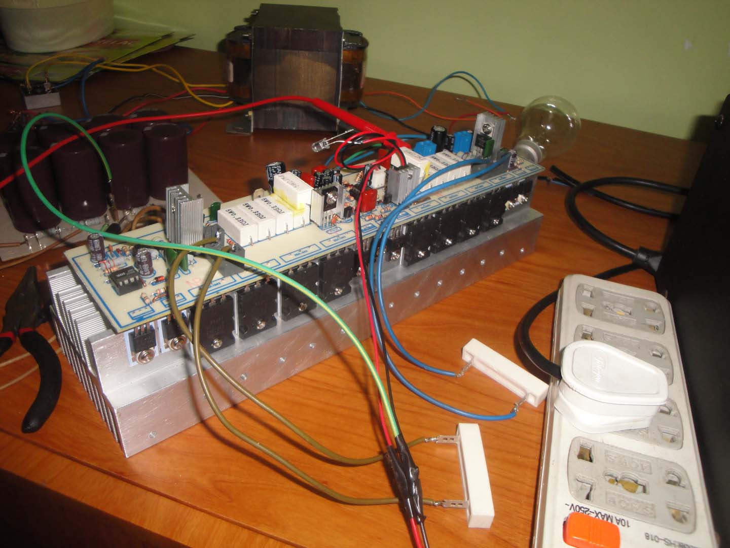

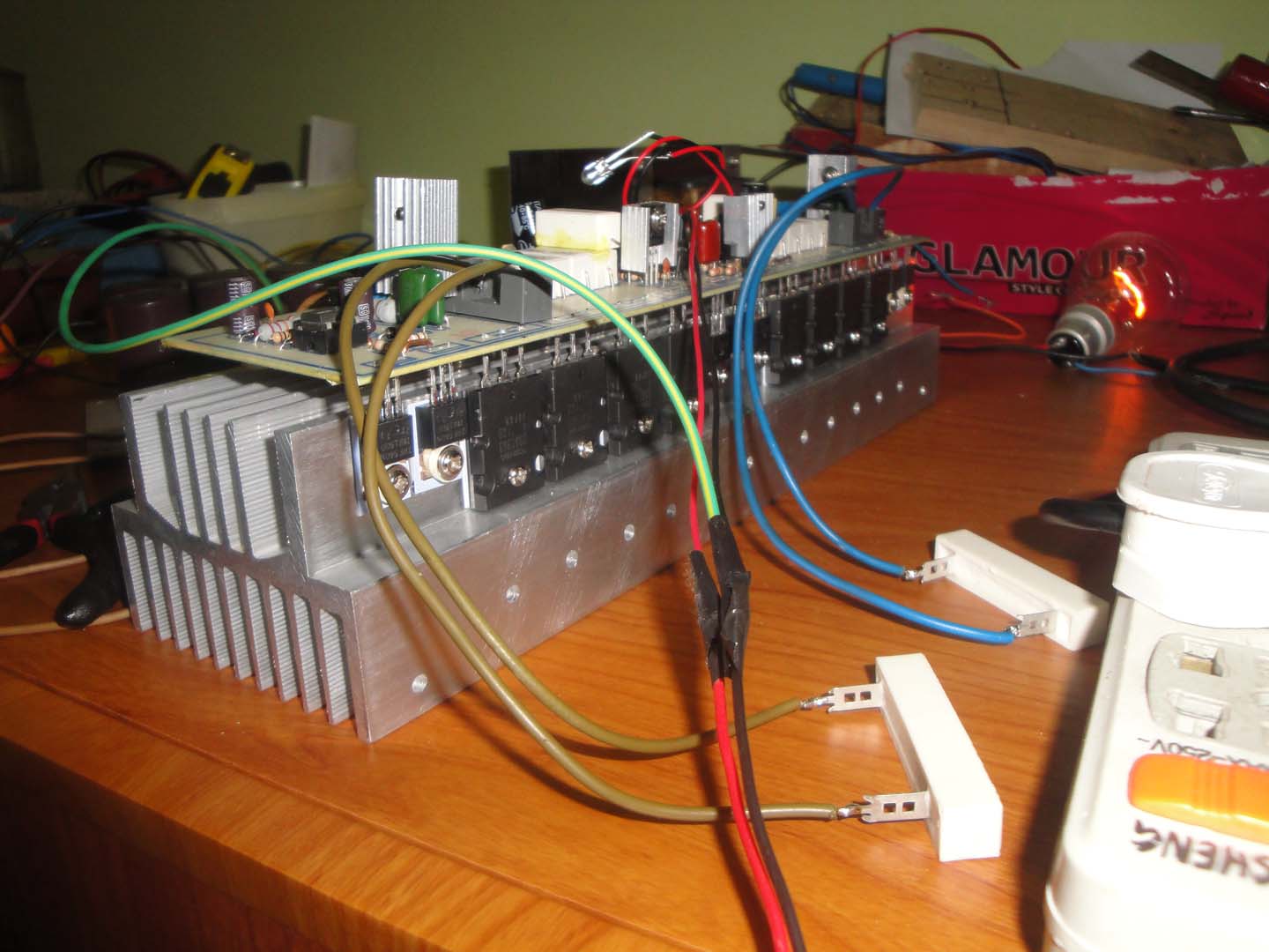

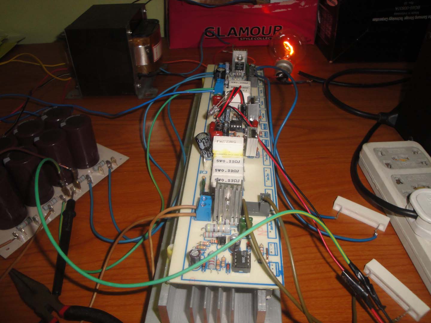

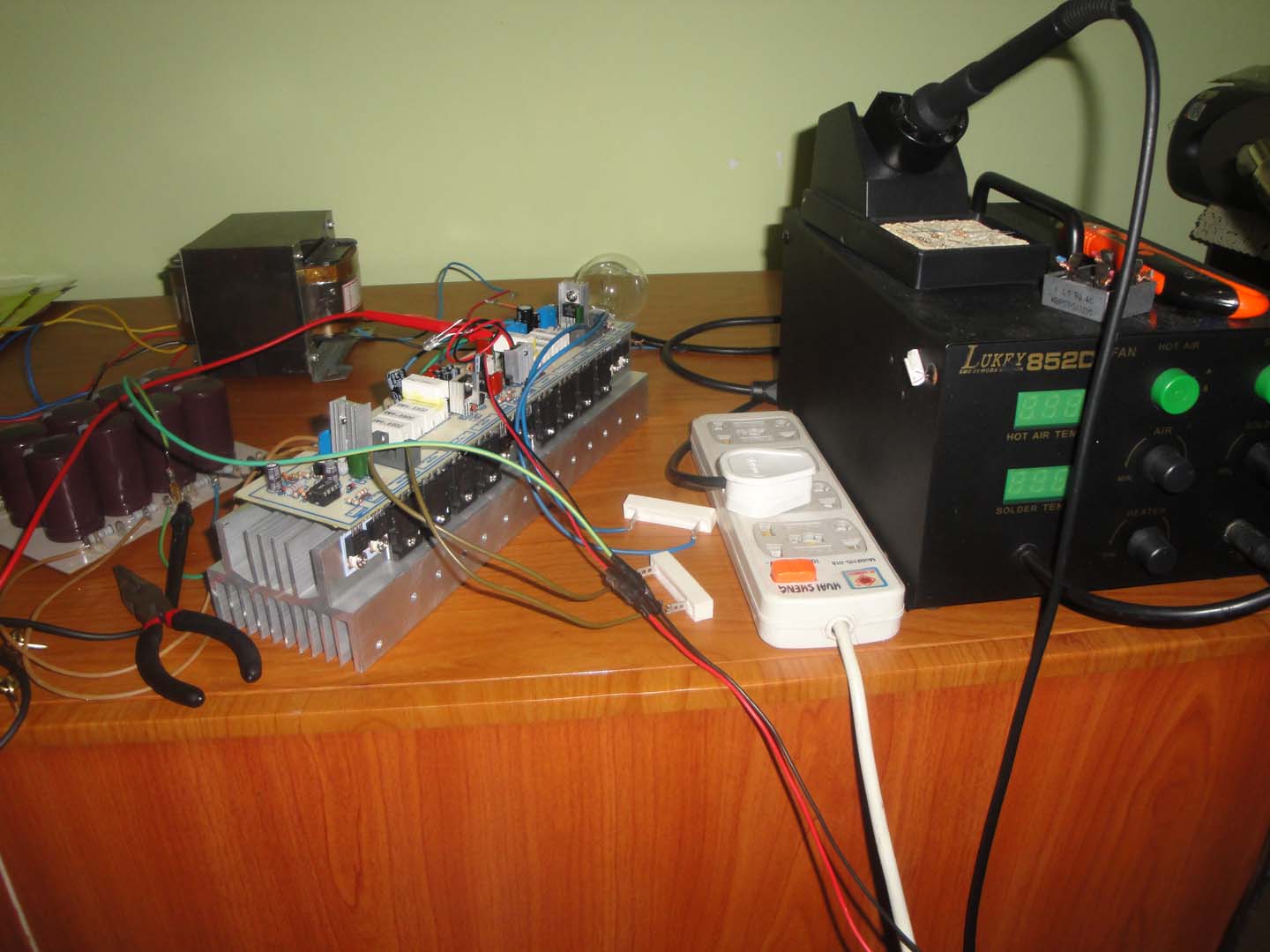

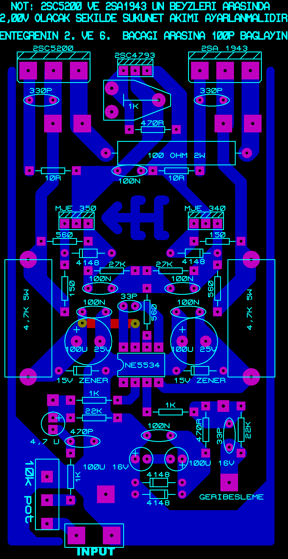

hi apex sir,
here is h900.
supply dc votage is 100-50-0-50-100. sound is excellent.
one question , without load i increase the volume ,and i see the clipping led is blink, but i checked the out with dmm ,ac voltage is 26vac. is there any mistakes from me.
thanks.

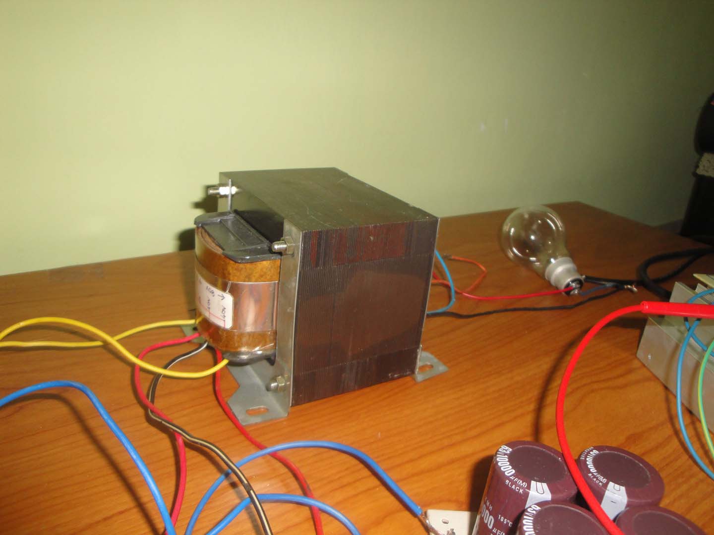

one question for tony, can u tell me what is the exact ampere of this transformer.
40 into 4 transformer,
core size is 40mm by 79mm.
thanks

STEP 1:
A = 4.5 inch = 11.43 cm;
H = 3 inch = 7.62 cm.
STEP 2:
Then calculate the coefficient a = A / 6 = 1.9 cm.
STEP 3:
After step 2 is calculated active section of the core:
- first: b = 2 *a = 3,8 cm;
- second: S = b * H = 3,8 * 7.62 = 28.95 cmp (square centimeters).
STEP 4:
Now calculate the apparent power of the transformer (primary winding):
P1 = S * S = 28.95*28.95 = ~850VA.
Efficiency of such a transformer is about e=85%. In this case secondary power will be:
P2 = P1*(e/100) = 0.85*850 = 722.5VA.
STEP 5:
Knowing secondary electrical transformer voltages we can determine secondary winding current value using the following formula:
I2 = P2 / U2.
For example, you have two DC voltage of 100V (filtered with capacitors). Now, I refer to a symmetrical voltage of + / - 100Vdc, this means 200Vdc. The secondary voltage will be effective:
Vs = 0.707 * 200 = 141.4 VAC.
In this example, the secondary winding current will be maximum:
Is = P2 / Vs = 5.1 A.
So, if those 141.4 VAC are given by two voltages of about 70V each then current calculated above will be given by each winding.
I hope you understand me and I hope I was helpful.
hi donpetru,
A-4.5 inch,
H-3 inch,
thanks.
take note that calculations are at best estimates, since the quality of your irons are unknown....
From RDH4 i estimate your iron as capable of 630 volt-amperes, not far off from donpetru's calculations....
heat is a single biggest determinant to how much power you can draw out of your power traffo...... the less power you draw out, the lower the temperature...
if your traffo is M6, then you can draw more...losses with this kind of iron are lower...
