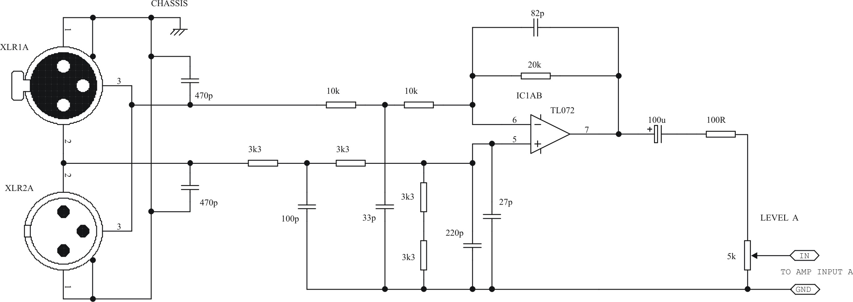

how can we make a balanced input for h-750
do you have a circuit
or modification
apex
or modification

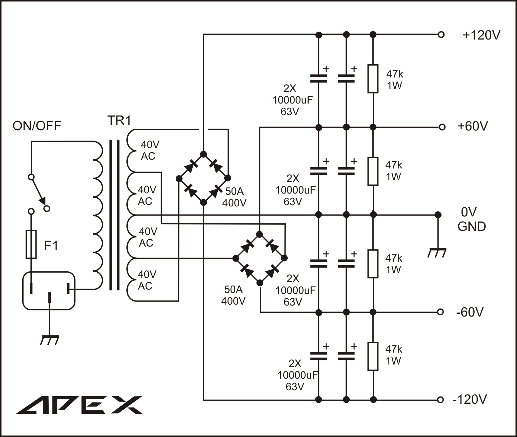

5 terminal must be from transformer the center must be ov,terminal 1,2,4,5 must be the x-former 4x40v
the other four terminal must be dc with discharge resistor,which is for +/-6o?and +/-120?
apex
Yes, I will post schematics soon.apex

greetings thanks for power supply circuit have wound my torridal
transformer yesterday will post pictures making soft start circuit

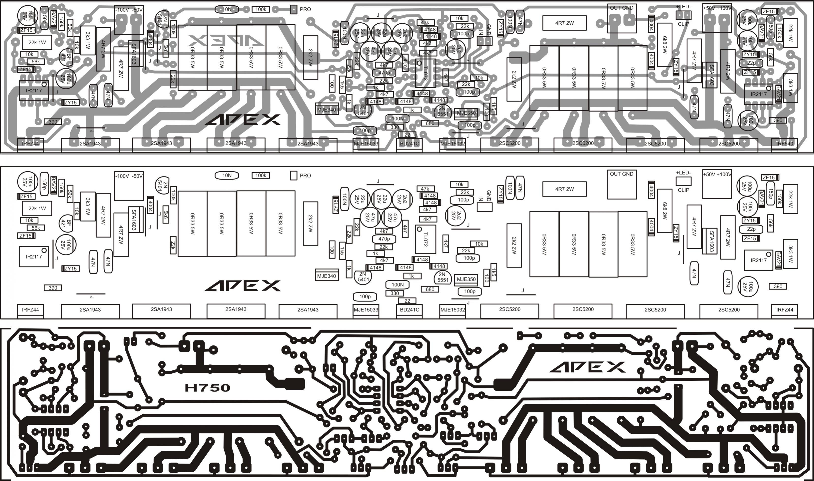

1 want to show you pcb with heatsink how i will mount it please tell me if it correct method and also your heat sink dimensions
thanks for your guidance and valuable suggestions
thanking you

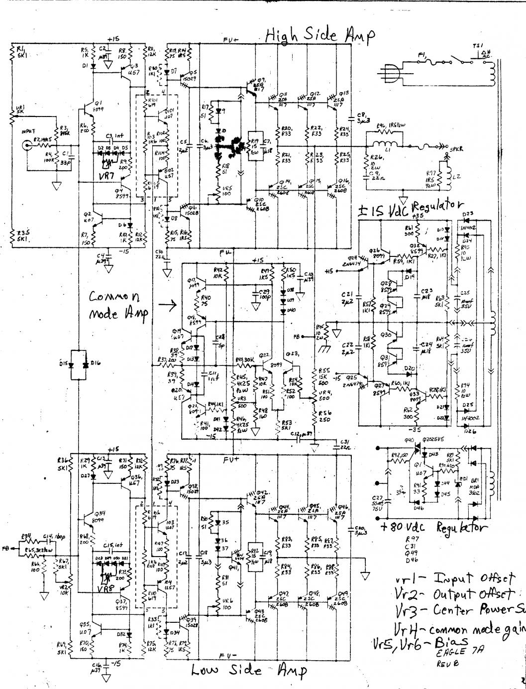

Yah I have seen this junk and it is so often a big smoky JOKE!! Start jerking the power supply rail around (called H or G) with a marginally stable amplifier and YES the smoke will come out!! Got a crappy Crown here in warranty blown up 3 times already. The amplifier that changes the supply voltage rail must be faster and ahead in time of the signal amplifier. Most of these rail voltage jerking amps have slow circuits jerking the rail around which never really does what it is supposed to do (in theory) so the amp goes unstable and blows its parts to wires or open circuits. Yah it is a nice idea but in the end it takes more parts to make it work than the equivalent higher voltage amp would. Further, the supply voltage rail jerking amp ALWAYS jerks the rail voltage on the last gain stage!! For all you theory specialist out there what happens when the rail voltage is jerked to a different voltage on the last gain stage? I shall kindly tell you, the transfer function of the amp changes so the feedback changes also and unpredictable gain and phase margin results. This mean smoke. Plus rail voltage jerking means kickback diodes cannot be used to prevent the output voltage from inductive kick back (never seen an inductive load with a power amp...NOT) from exceeding the lower power supply voltage rail which always causes output transistor degradation resulting in eventual smoke and wires where devices used to be. You want to jerk the rail voltage around? Use a real amp that is faster than the amp being rail voltage jerked. If this does not occur then the rail voltage jerking amp is likely to blow its little parts. Far better to use a ground referenced amp paired with a standard amp to get the voltage swing desired. I think Crown (macro reference) copied the Eagle 7, the most copied amp in the world, to make a ground referenced driving amp paired with a regular amp to achieve its bigger swing voltage. Eagle 7 schematic attached.
As another point, high power is interesting but WHY? I have yet to see a driver that can handle more than 34 volts RMS before increasing the voltage drive does not cause an increase in output. These lame amps have lousy damping when tested dynamically so more power does not make it louder--- only more distortion. Surely what is needed in PA work is more distortion, NOT! Further the idea that these wonderful designs provided by APEX AUDIO are needed to make a good PA is, is, is simply insane! 1000 watts is only 3 dB louder than 500 watts and 3dB is not jack. Far better to use an amplifier for every driver than to use a giant stupid unstable amp of huge proportion to attempt to achieve loud output with anything that resembles low distortion.
In the end an amp for every driver will completely blow away in sound quality and distortion any big stupid amp driving a bunch of drivers to insane power levels.
I greatly appreciate the effort by APEX AUDIO but the reality of PA system has been lost in the thought that bigger is somehow better. Let us focus on the fact that drivers to work within there somewhat linear region do not need that much power (34 volts RMS) to play as loud as they can before heinous and unsavory distortion drives me from the concert.
If the goal is to make noise and not music I have a 200 horsepower air compressor with a wideband modulatable orifice that will make like 175dB but then, who wants to listen to that? Keep the focus on BOTH low distortion with reasonable sound pressure level please and thank you.
