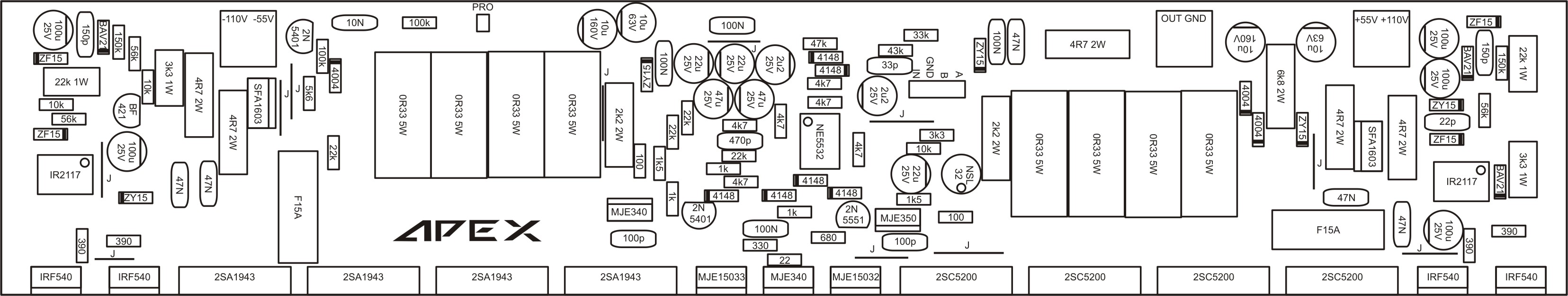

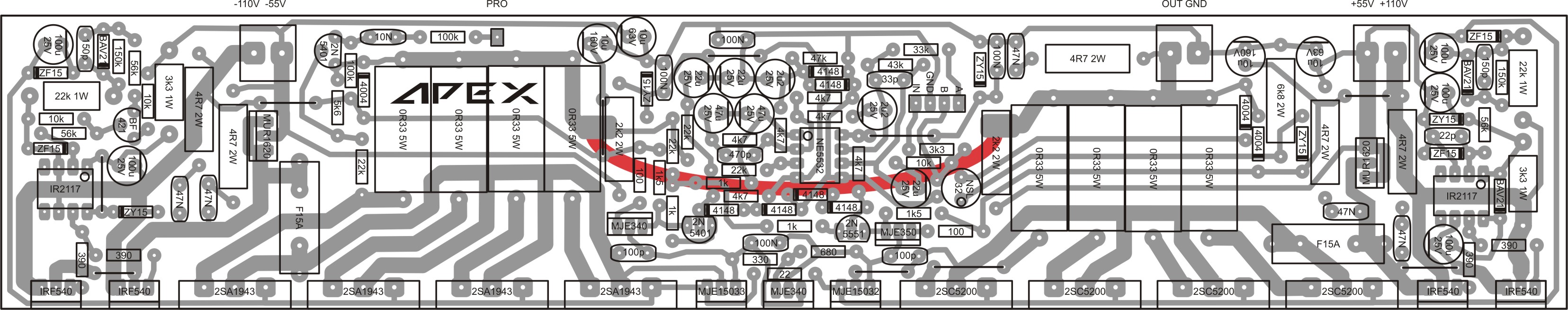

To Andrew LebonComutation diode SFA1603 in negative side have wrong direction, be more careful.
Regards
Several eletrolitic cond. also wrong direction...

Andrew,
How are you planning to drill and mount the heat sink? One thing I will mention is that its a whole lot easier to drill the heat sink *before* soldering output tansistors (and commutators) to the board! A copy of the layout can be used as a drill template. Mount the outputs, then put the leads through the board one by one starting from one end. Then solder. This forces everything to align and there is less chance of breaking something. It's frustrating to have a competed, stuffed board and try to drill from that - and then the holes still don't line up.

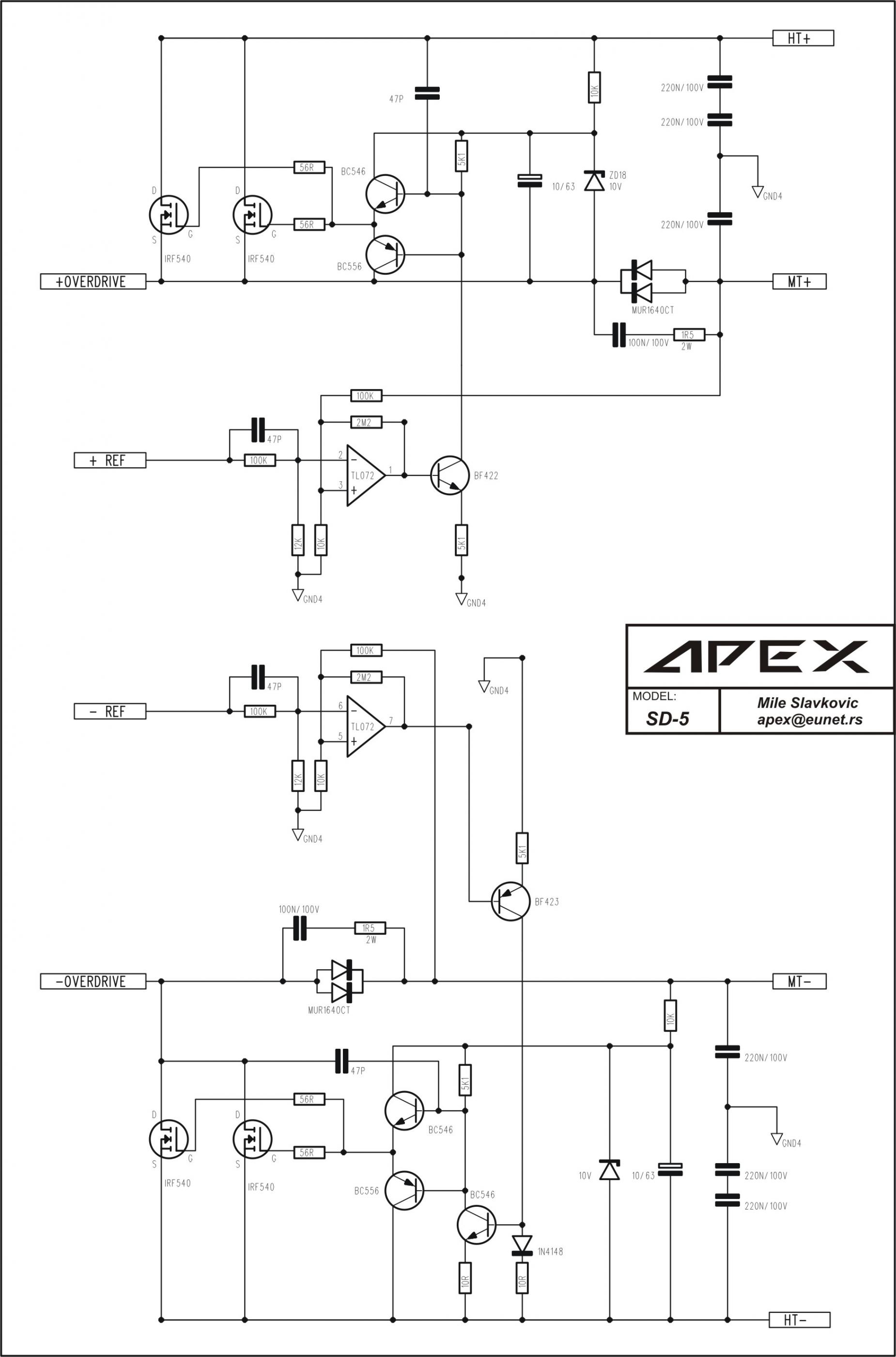

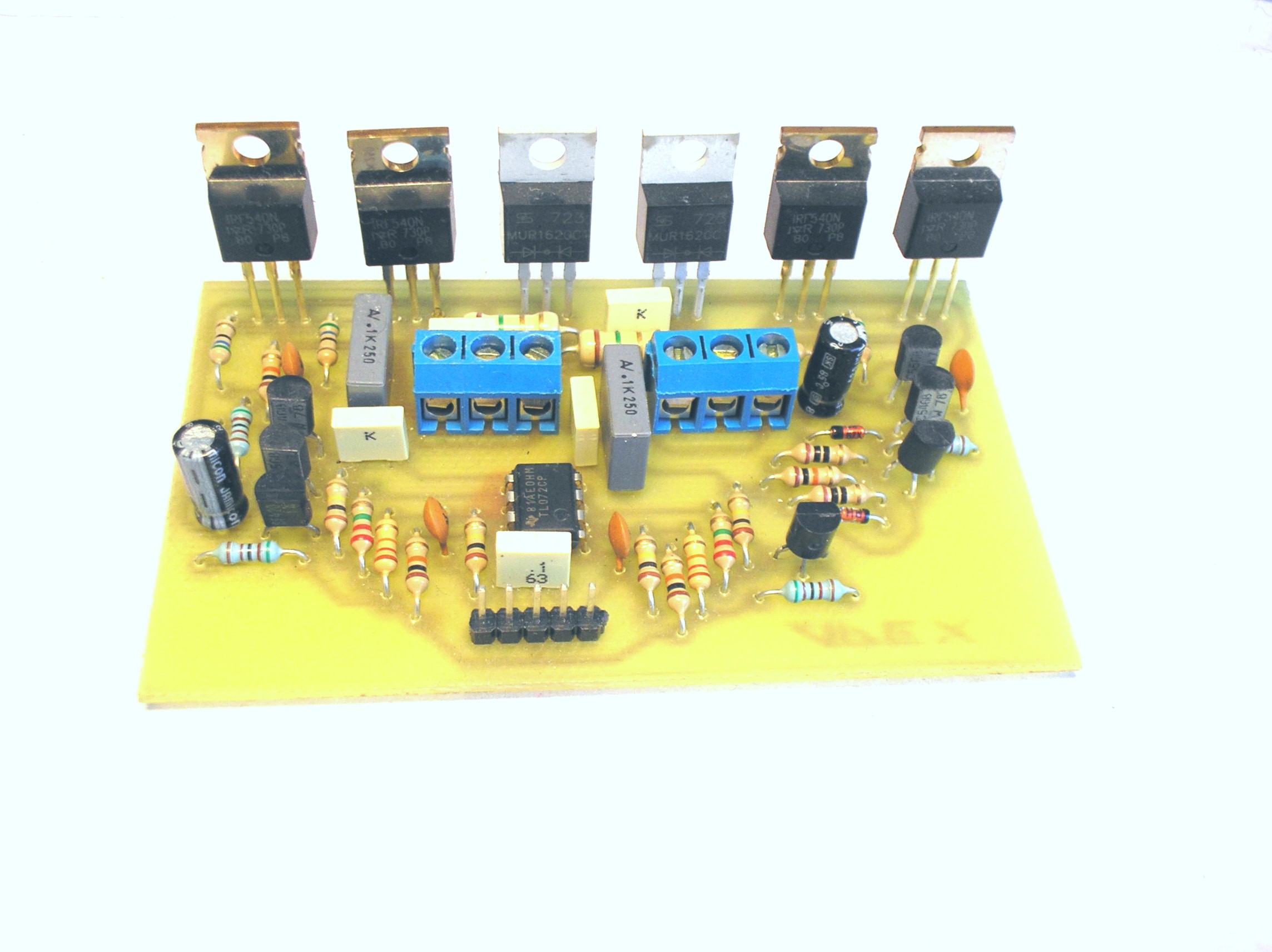

There is detect for VI Cut-out, post "mute" signal to protect board. This is simple schematic praktic for DIY. I made all kind H-class step circuits (QSC, Crest, Mackie...) this one not in use last 2 years.There is no slew limiter, but its OK for diy. Is this your first class-H?

greetings thanks for pointing out my mistakes have changed polarity
of condensers inserted wrongly checking pcb for mistakes
1 will send you high resolution pictures for inspection before powering up

Class H Step Driver based on C-audio and Crown schematics.Hi apexaudio
can you post latest Class H Step driver schematics that can be use with most class A/B amps ?
I will post PSU, soft-start and protect schematics with specific method for powering on with series 150R 10W resistor.hi apexaudio

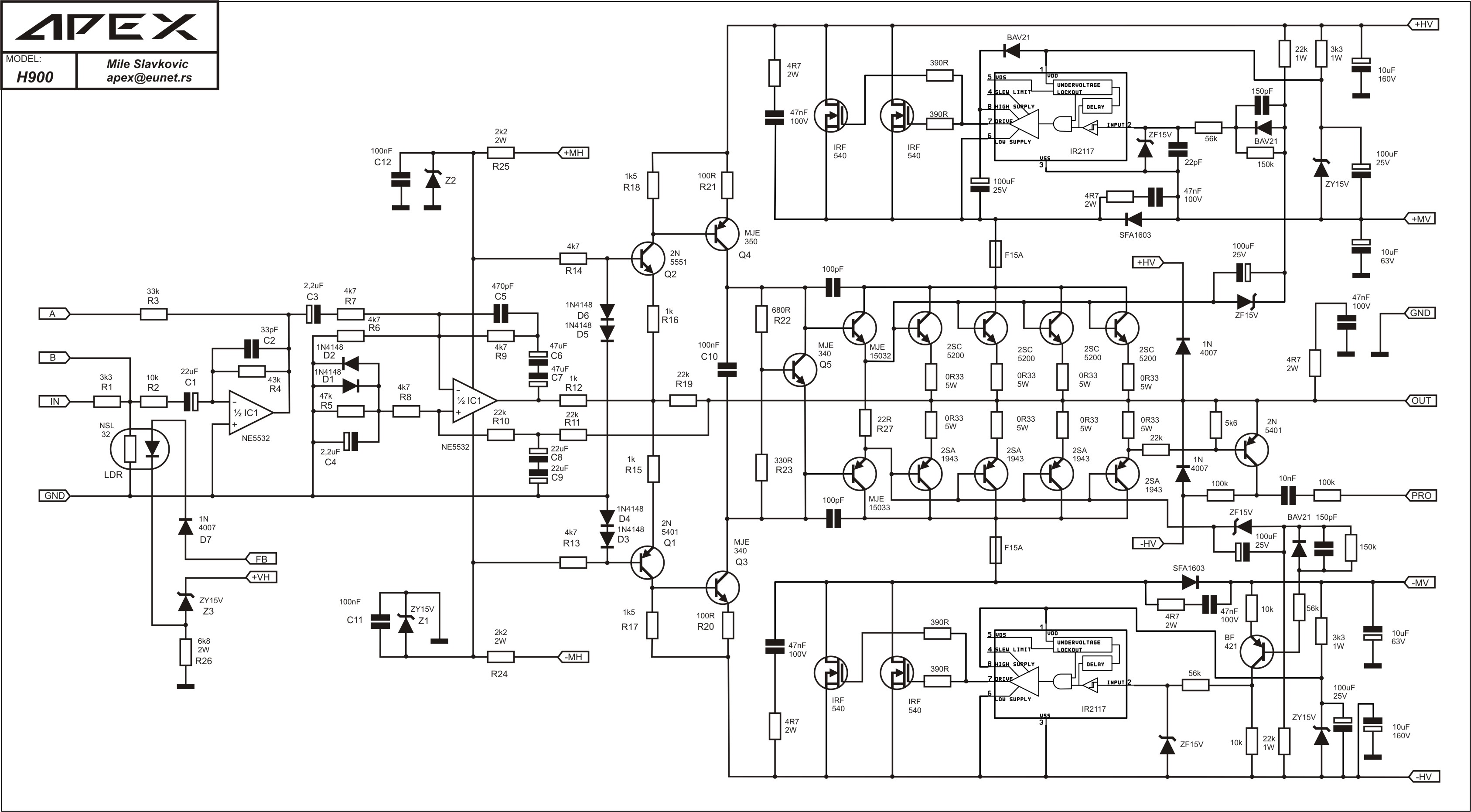

zy15 question?can any 2watt zener diode 15v work
zf15 and 1watt 15v?
bf421 > bf423, bf872bav21 > byd73d, byd33d
sfa1603 > byv79/200, byw29/200
