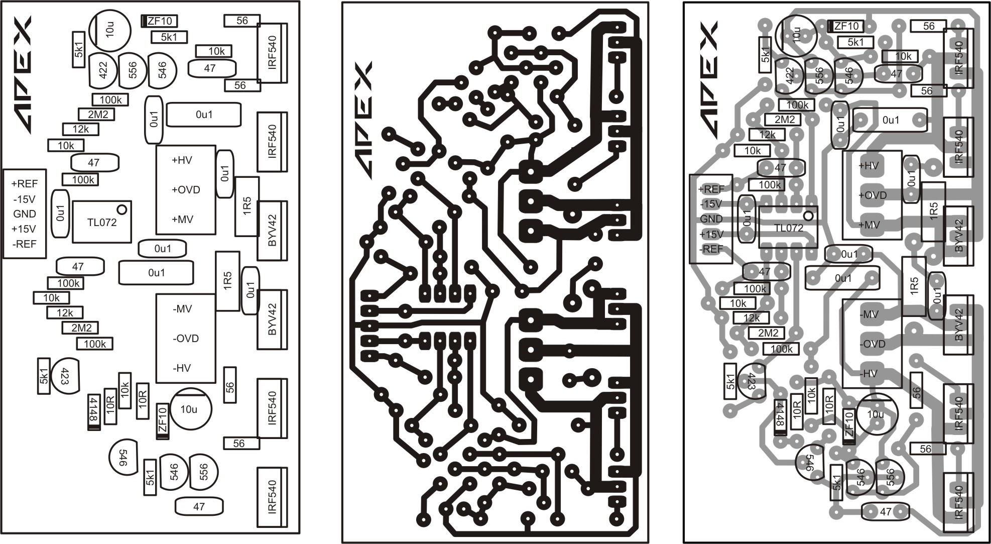

900W H-class PA Amp with Limiter
Class H is first time for me, have simple question...
Can I use following transformer for APEX Class H Step Driver

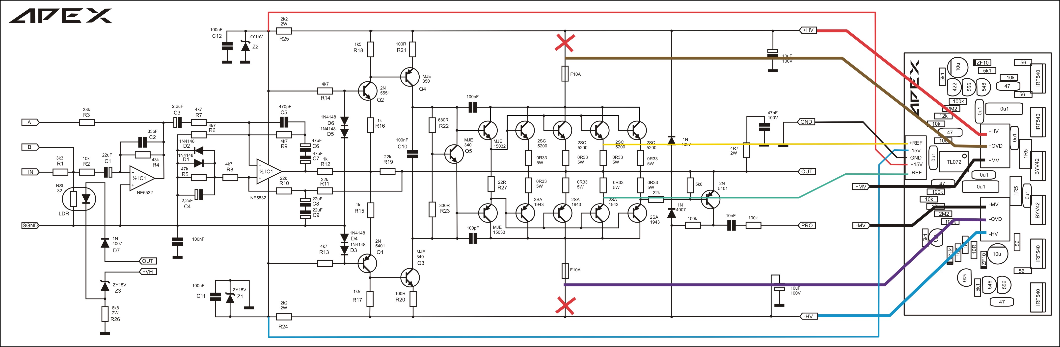

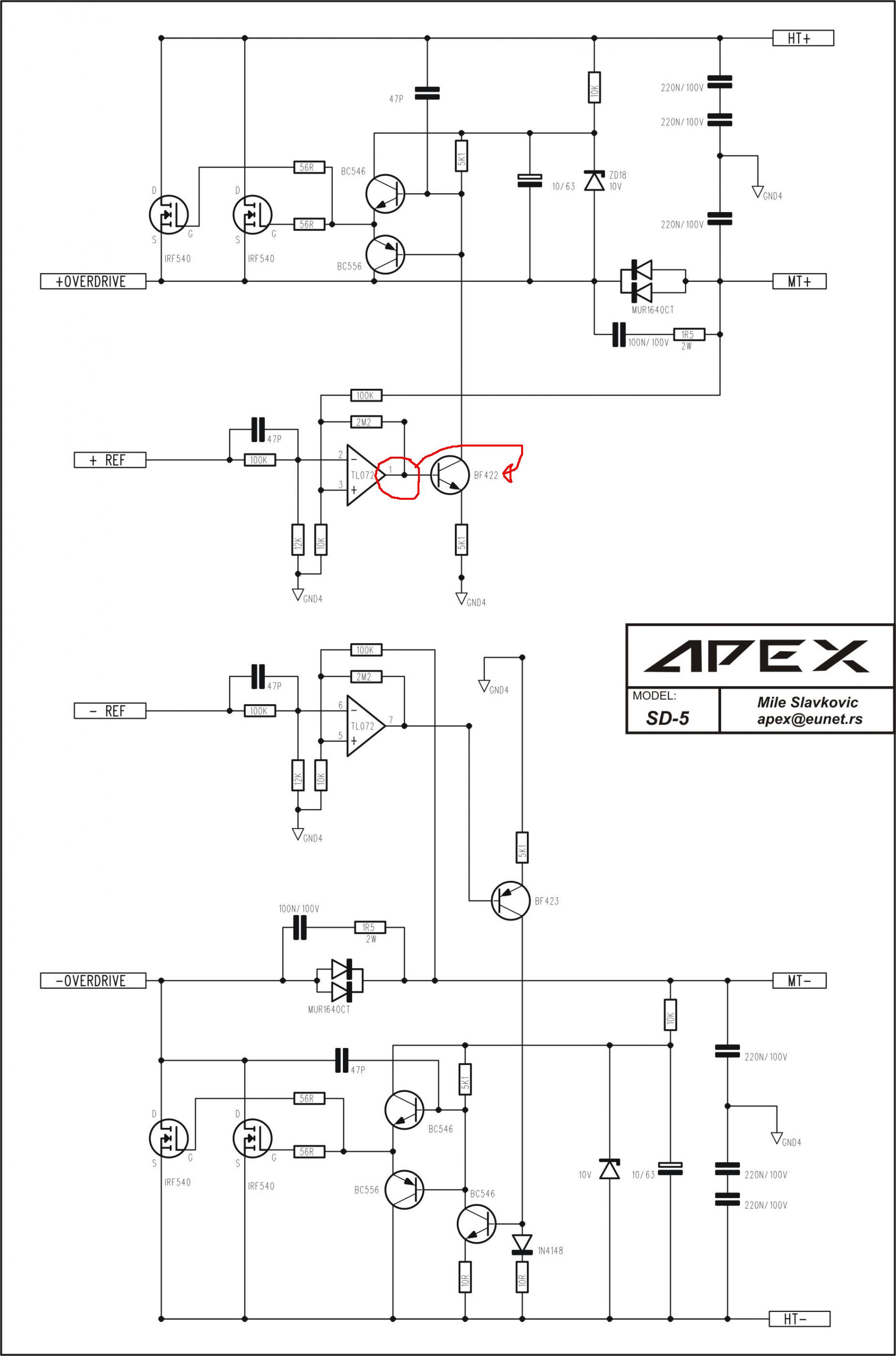

Im also trying to figure it out why TL072 wont trigger
But crown amps uses same step drive tl072

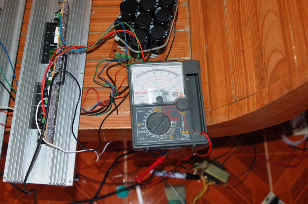

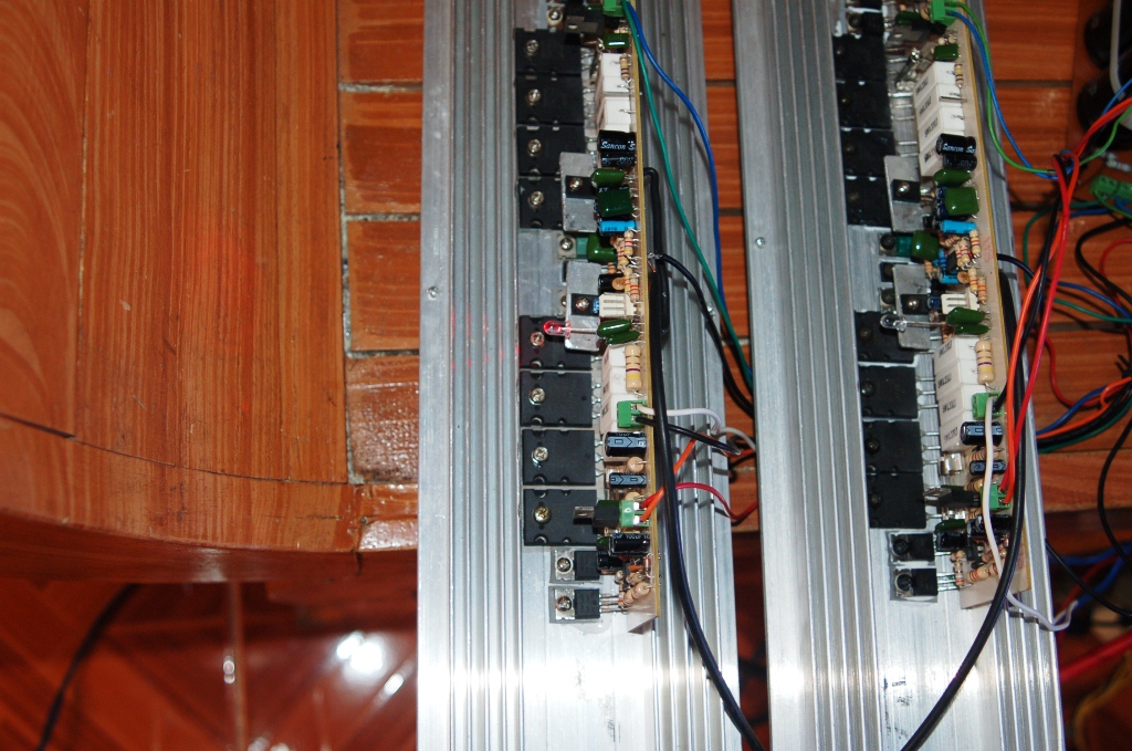

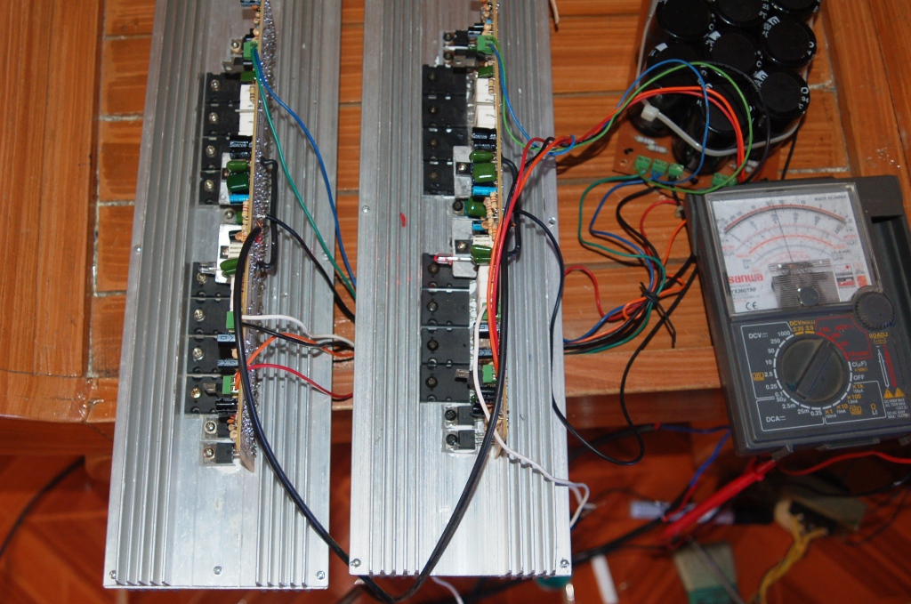

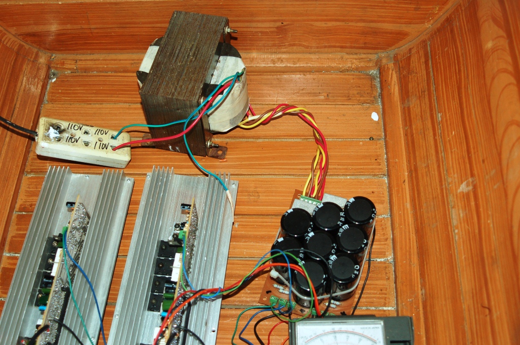

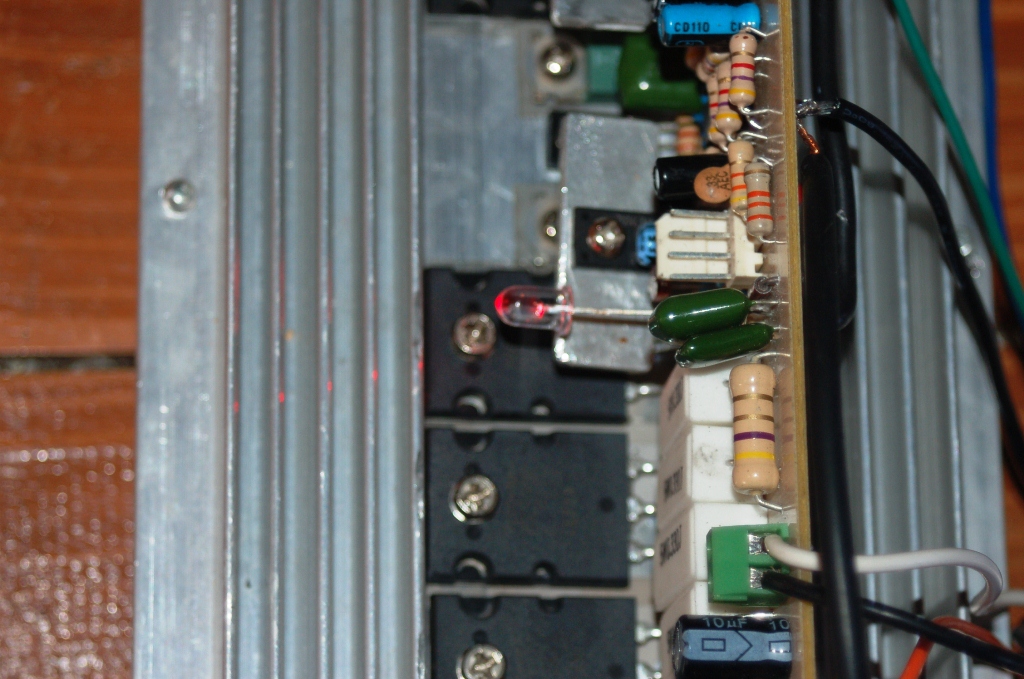

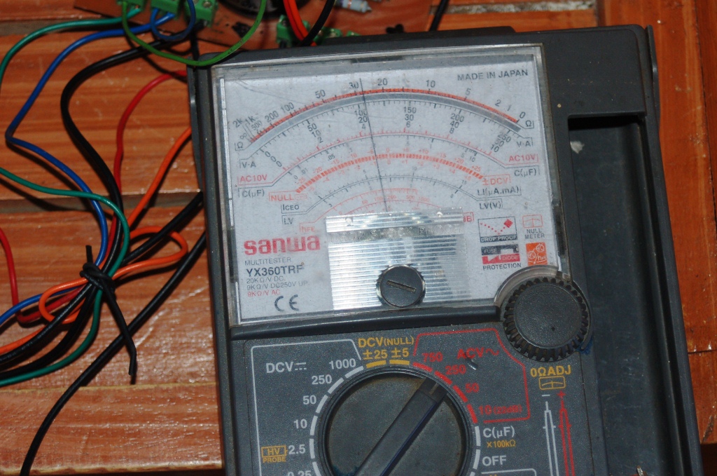

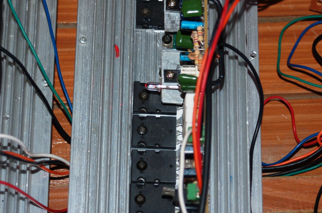

H900 WOW!!!
I just installed the TRAPO 40x4 30 amps and the result all i say WOW so VERY LOUD
picture taken feed input 50/100 hz sinewave and measure the output with multi meter the AC reading on output is 110v ac full volume no load
