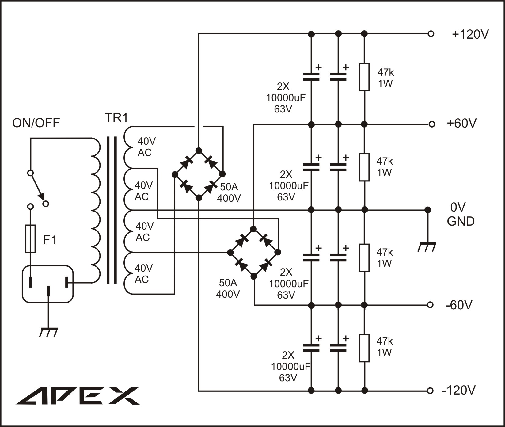

i have a diagram here by pagarigan i used it as my power amp since year 1992 and it work so nicely without any problems, supply is 70V-0-70V, and i want to employ TL072 stepdriver to make it a Class H power amplifier. please help me to do this...thanks and merry christmas....

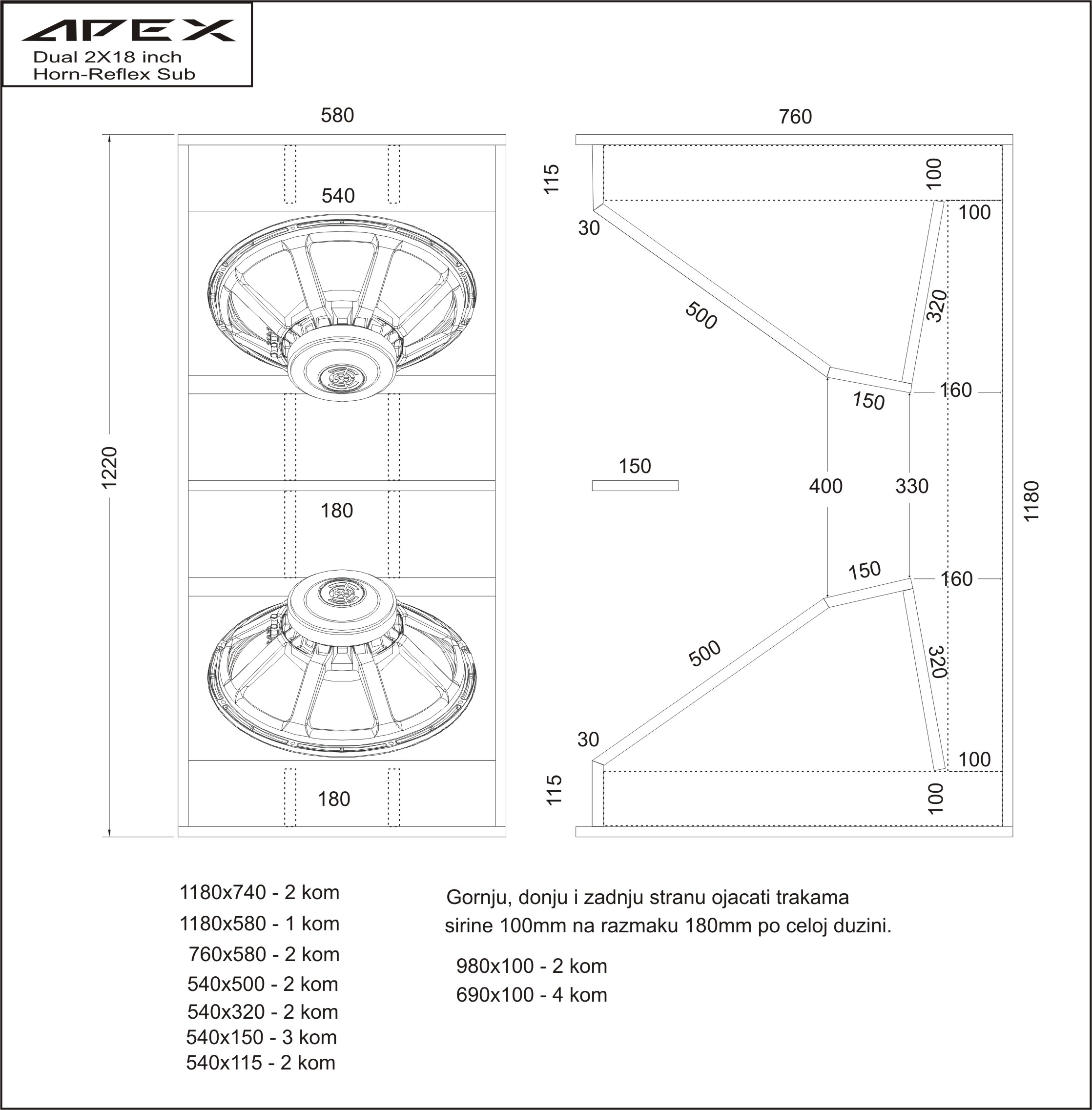

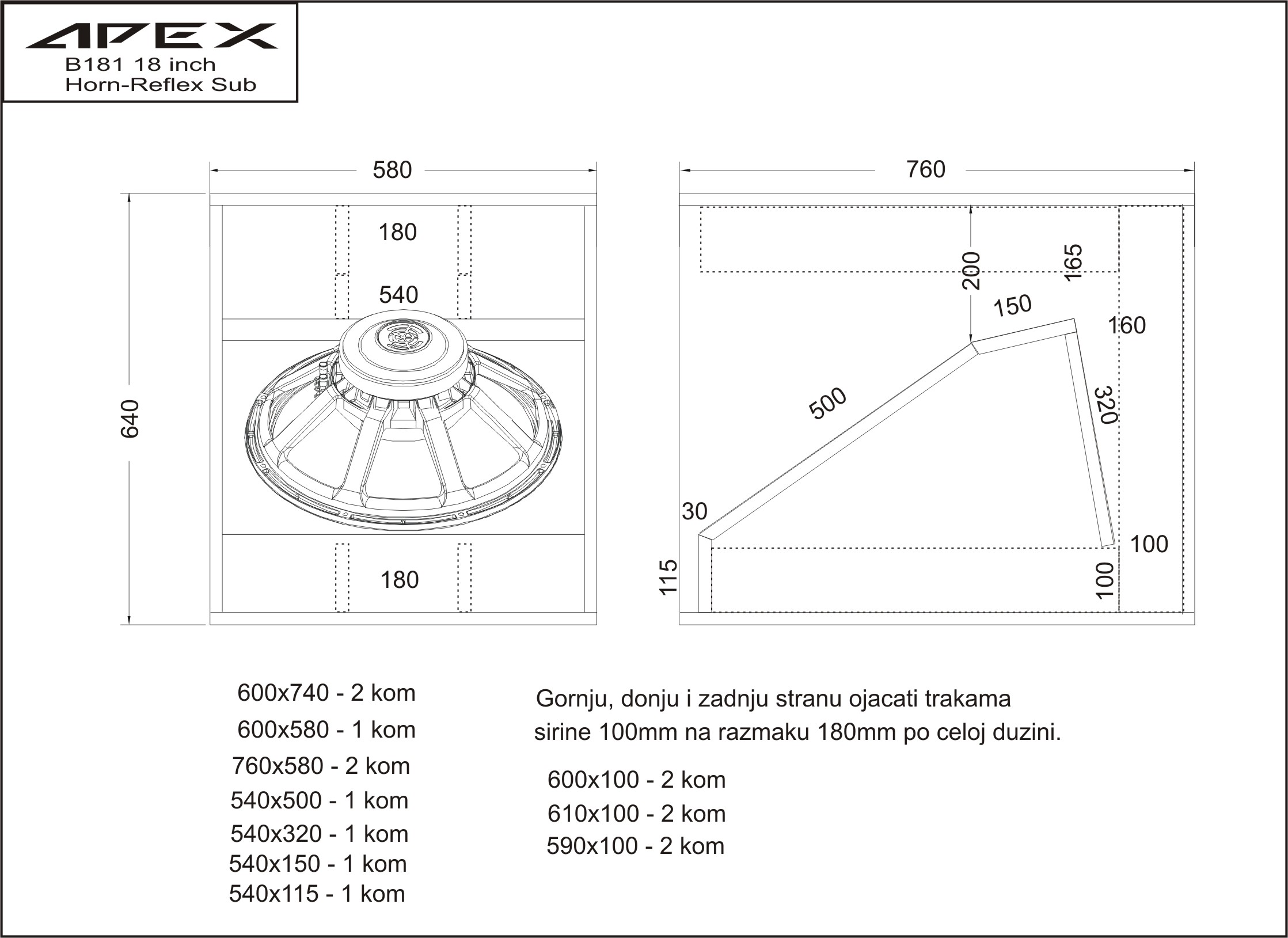

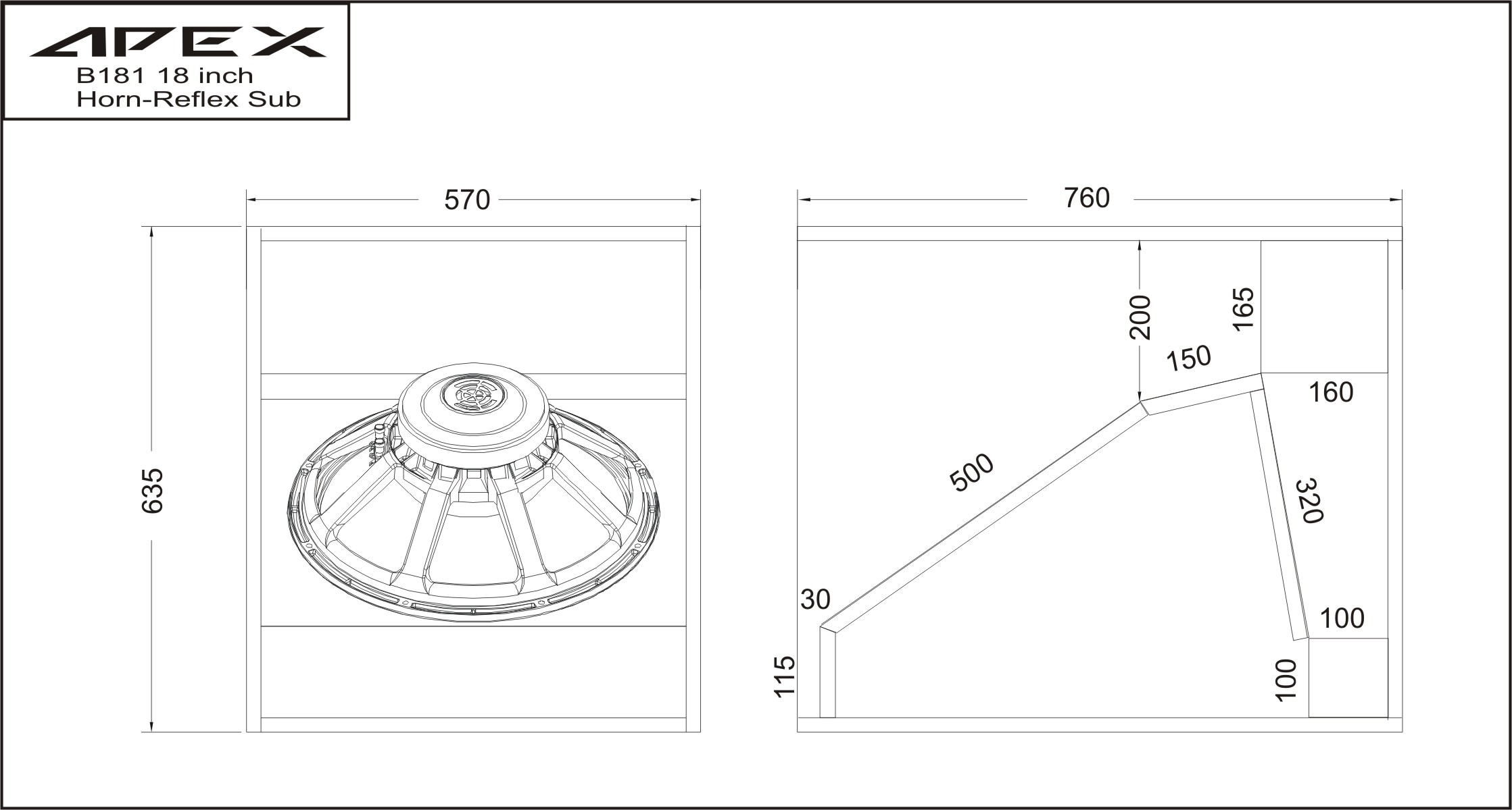

APEX B181
18 inch horn-reflex sub.
H900 and B500 have inverted output phase for useing with B2181 and B181 subs. Speakers in B2181 and B181 are in reverted position for beter cooling.
If you use B2181 and B181 with another amps you must reverted (+) and (-) on speaker terminal or you can turn around speaker in standard position, also if you use H900 and B500 with another speakers you must reverted (+) and (-) on speakers terminals or amps output terminals.

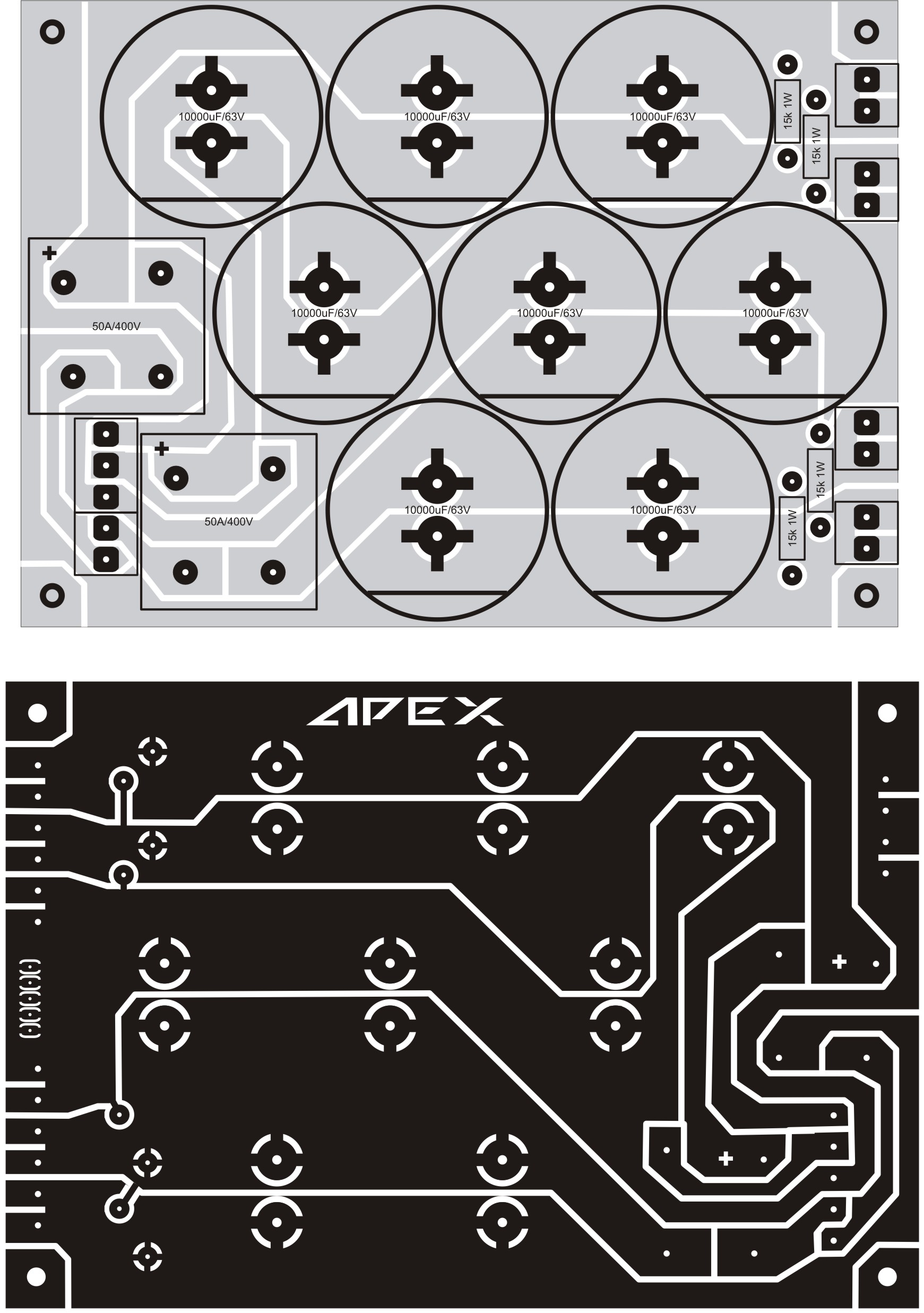

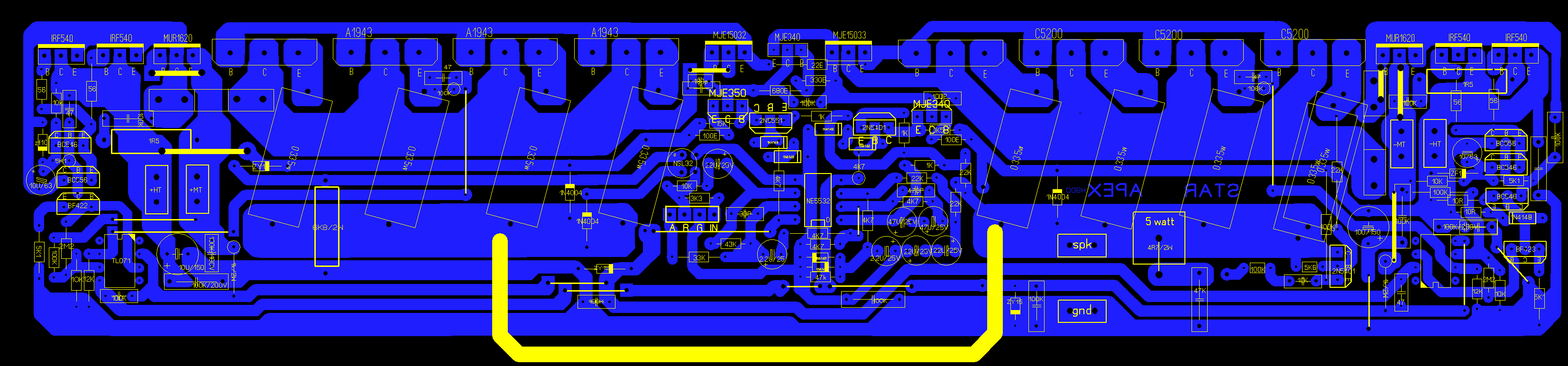

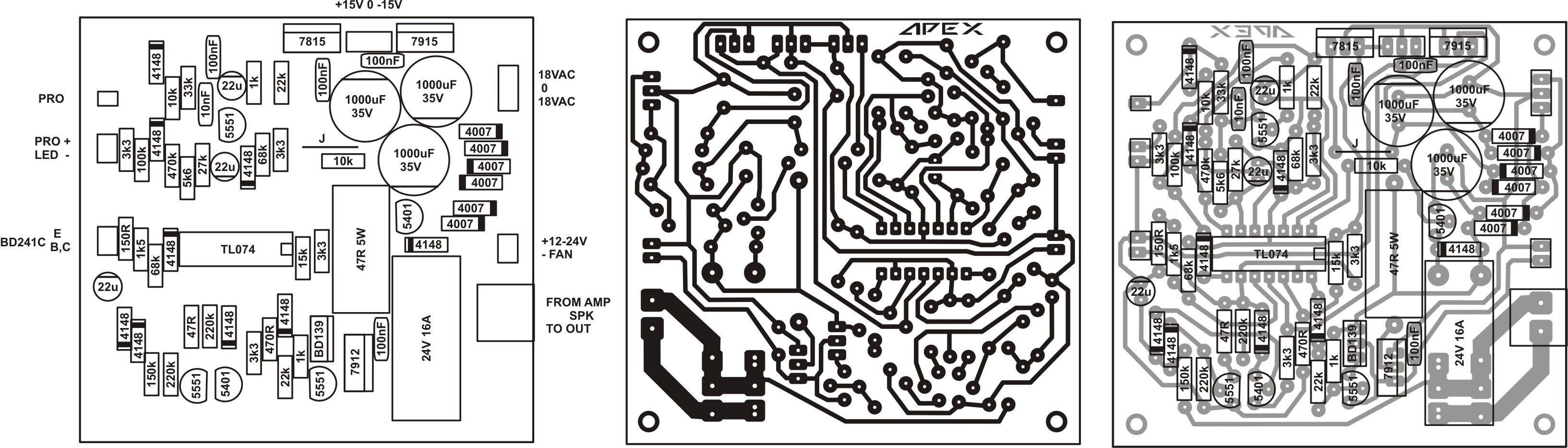

ravslanka sir do you have a parts placement guide of your pcb foil pattern if you have can you post it pls. thanks🙂
hi darwinbibit,
here is foil pattern and silk.do you gonna use toner transfer method.
pdf is mirrored.
best regards
ravs
be a vegeterian......
That layout will not work, the power devices on the left doesent have the common end on the emitter resistors tied to the right side emitter resistors where the speaker output is.
hi tekko,
left side power devices are connected through a jumper in its original pcb too.
i have added it now in the silk.
regards
ravs

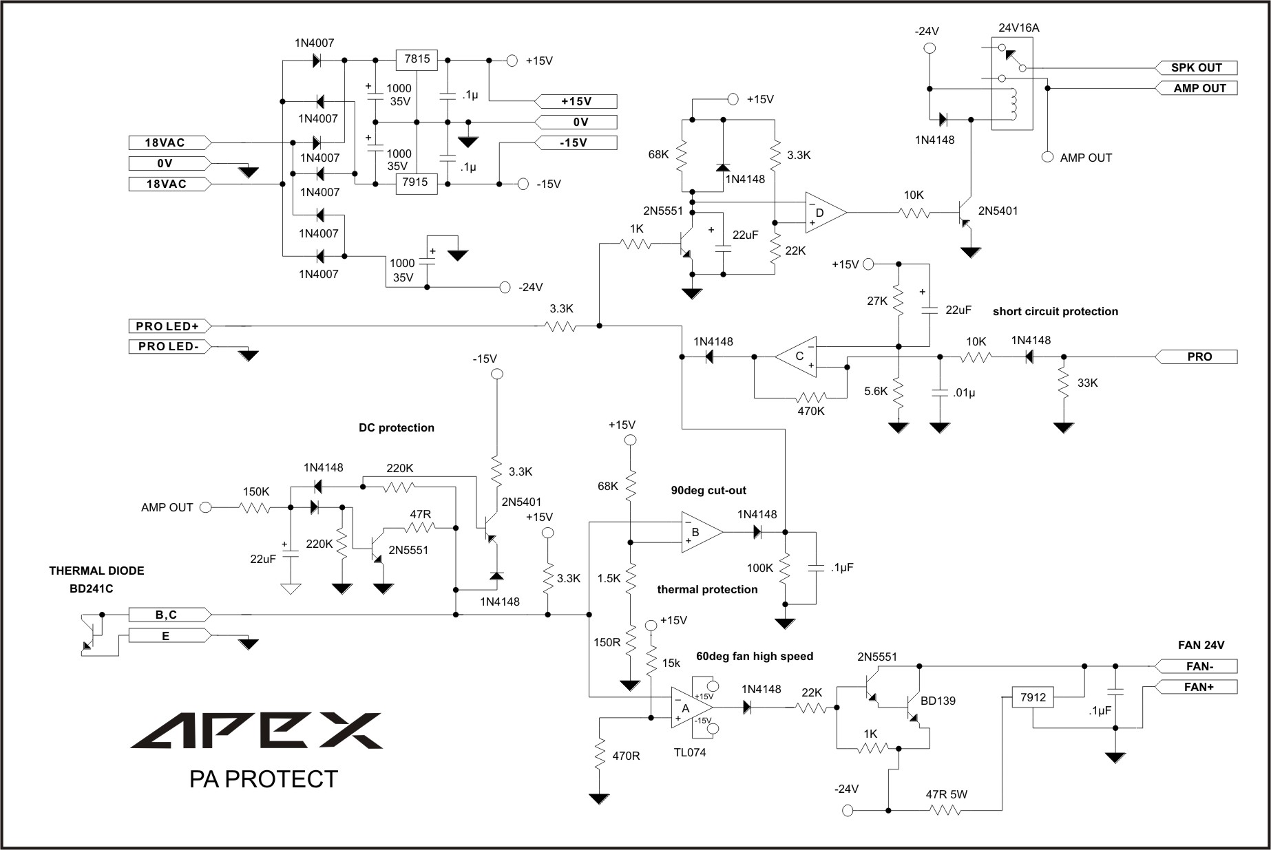

Cant find VI Limiter in Class H design and how does protection circuit in short circuit or overload situation work ?
With peak current over 8A per output circuit around 2N5401 give AC signal on amp PRO pin, and protect circuit disconnect speaker. Protect will connect speaker after turn amp off and turn on again (power on reset). If you not sure that usen outputs will not break with 8A current don't try to short circuit amp out.

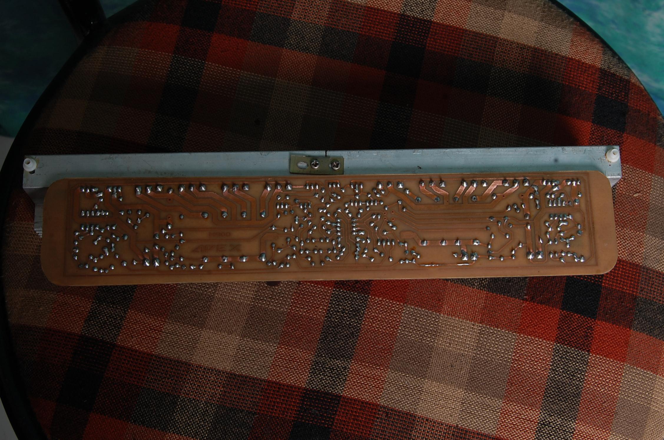

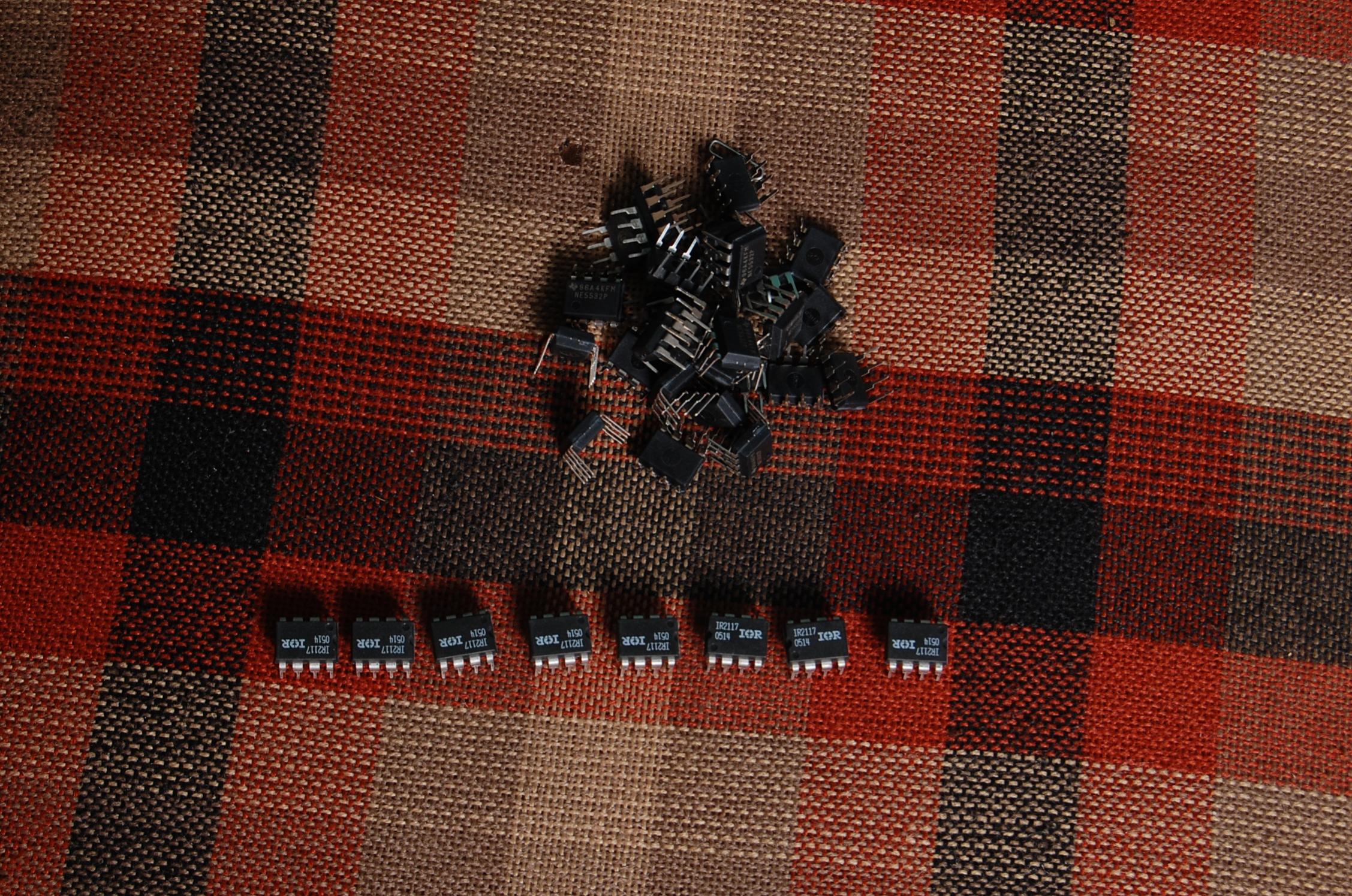

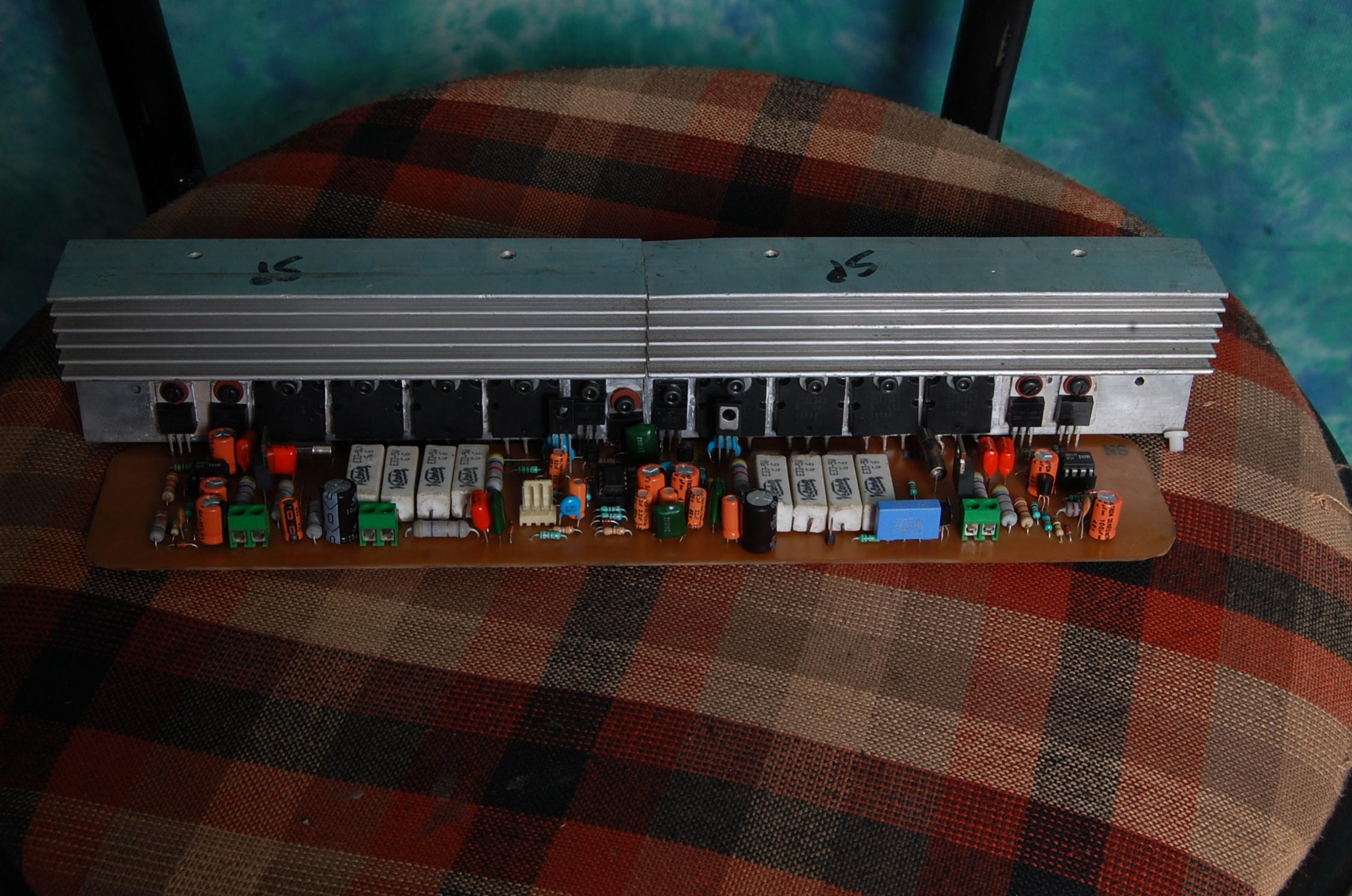

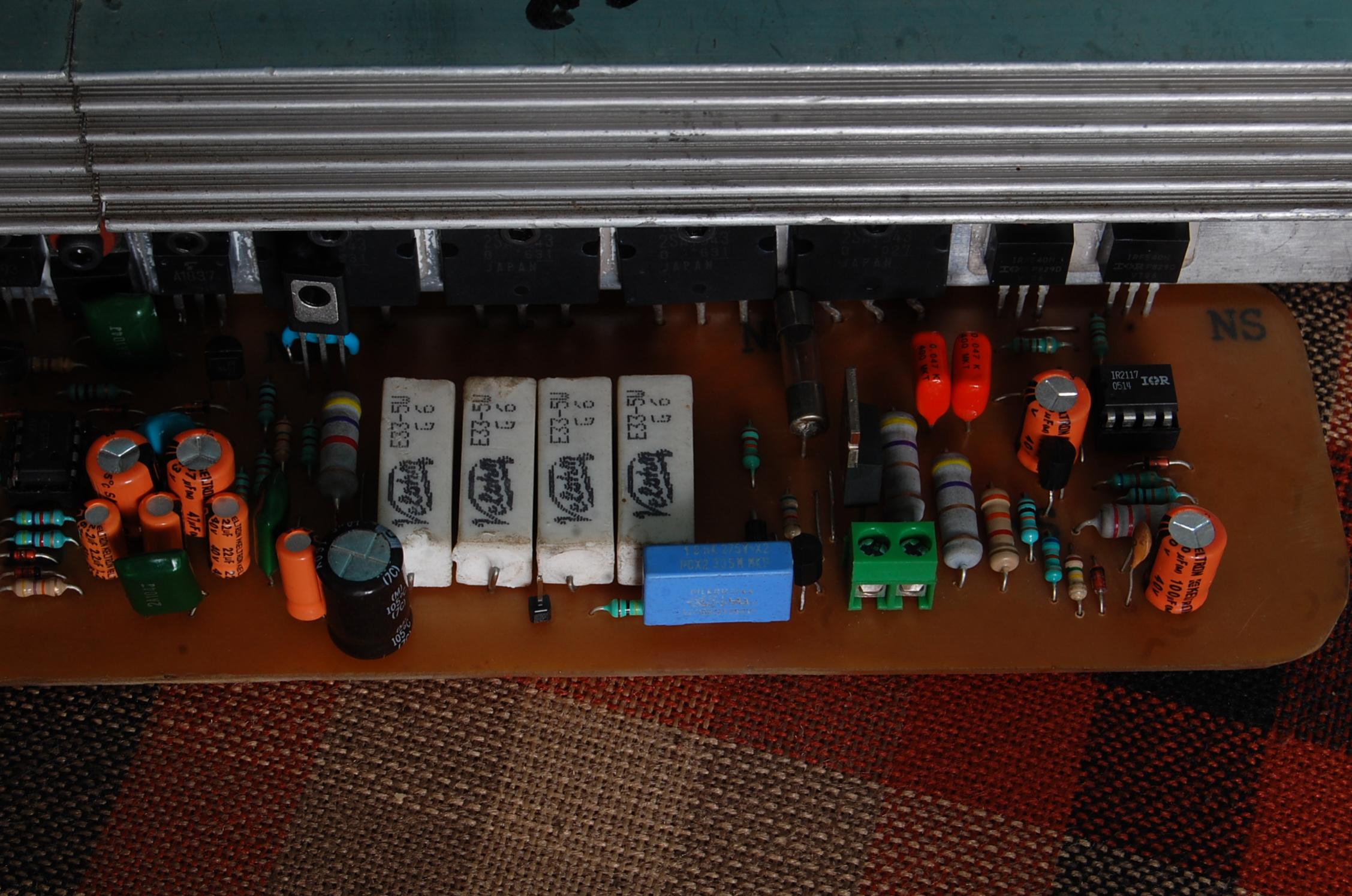

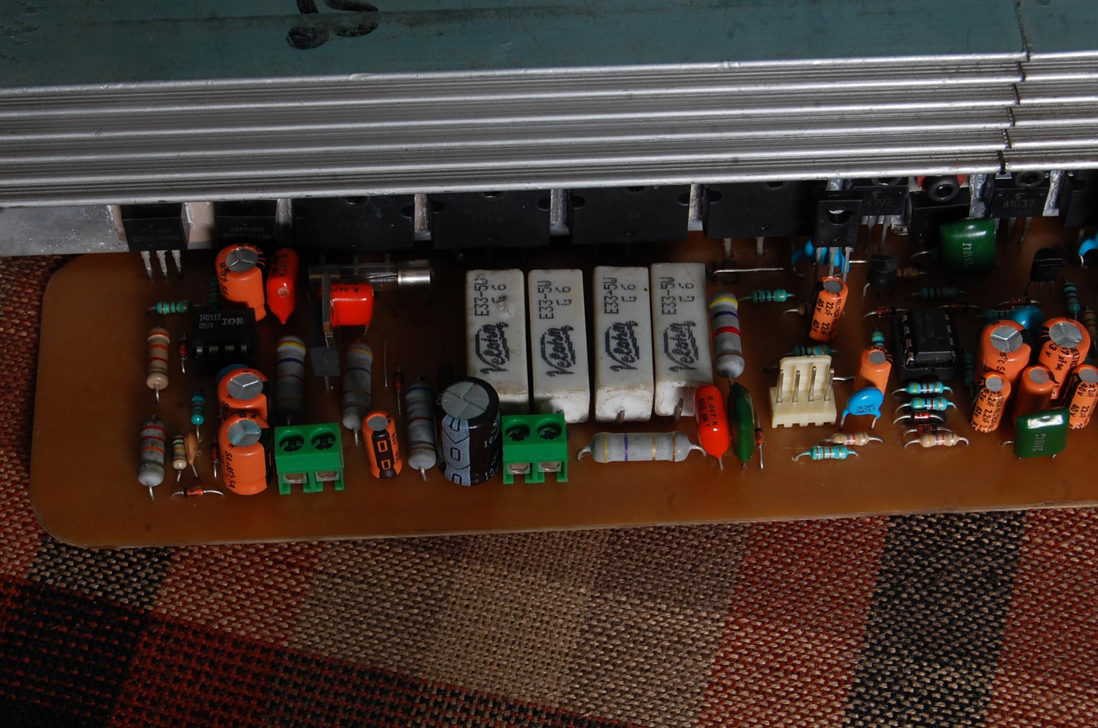

hello sir
try to make your h900 . hard to find ir2117 but anyways i have some..
ready to test...
pls check out my mistakes ....
thank u sir ...
Regards
very good !!!!! but please where can I find the protection circuit in this long thread ?
