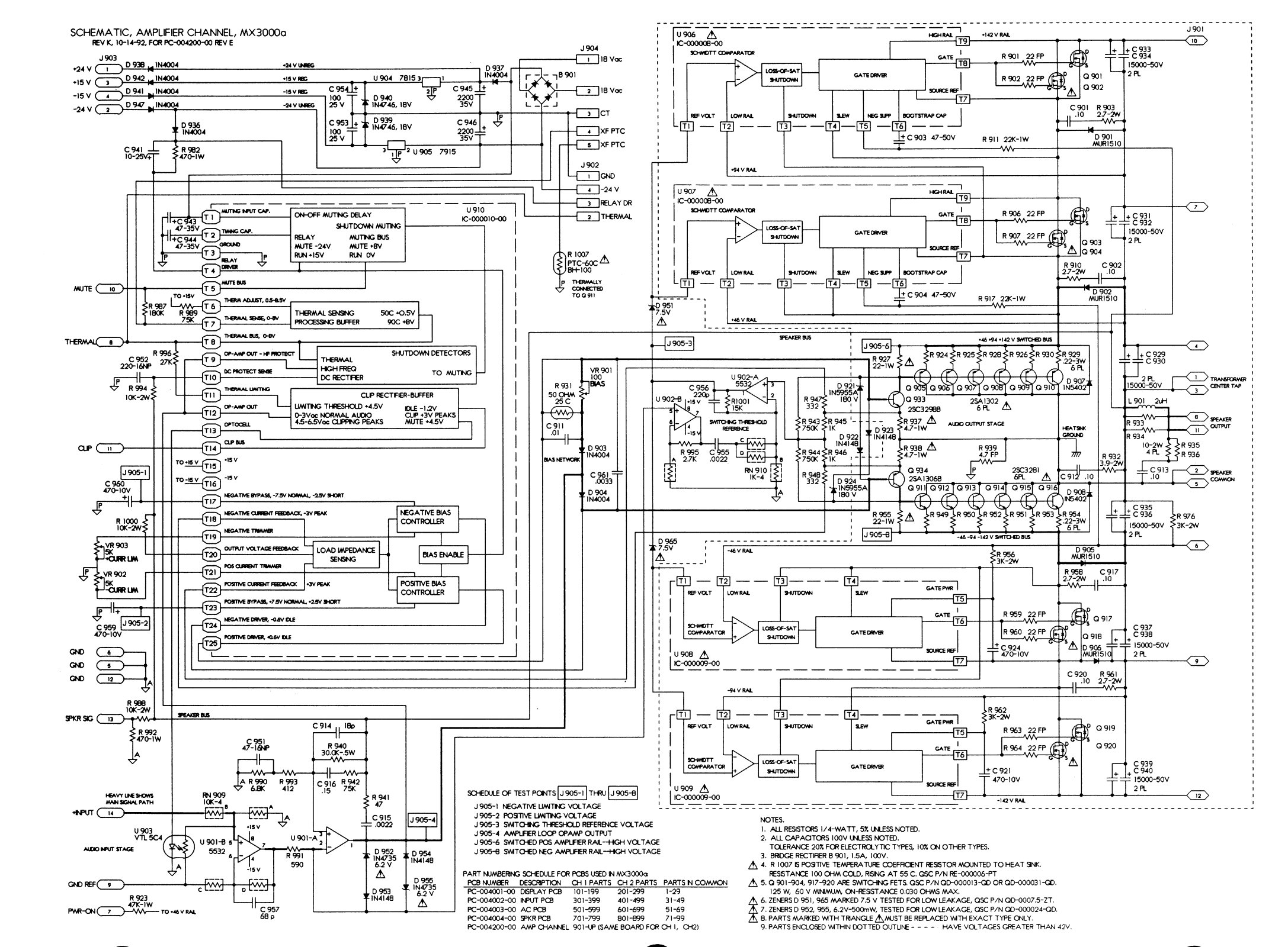

The circuit looks to me like a Crest front end, Dirty Harry's output stage, and QSC-type rail switches (they would have used 2117's if they were available way back when they did the MXa series).
The buffered 311's are plenty fast enough for rail switch drivers. QSC intentionally keeps the slew rate down to about 30V/us on the rails, because it's less prone to misfiring or other misbehavior. You can still do that with a 2117. A high speed circuit is much much much more sensitive to layout and produces weird unexpected failures. Dissipation goes up somewhat at 20kHz if you slow the switches down, but trust me you don't want to put 3kW into a compression driver. It's too loud, painful, and costs money.

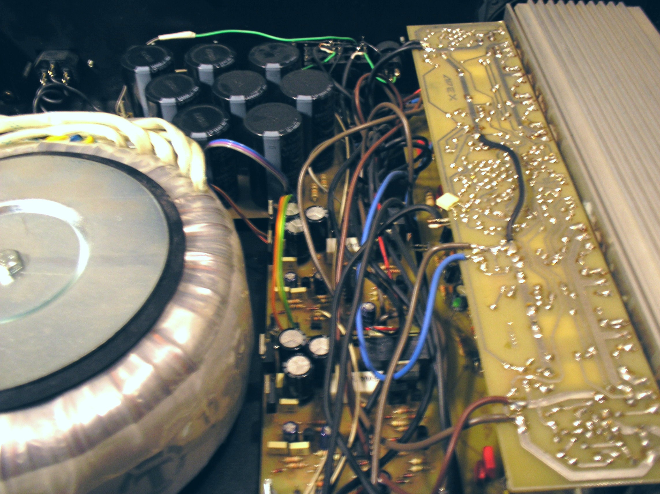

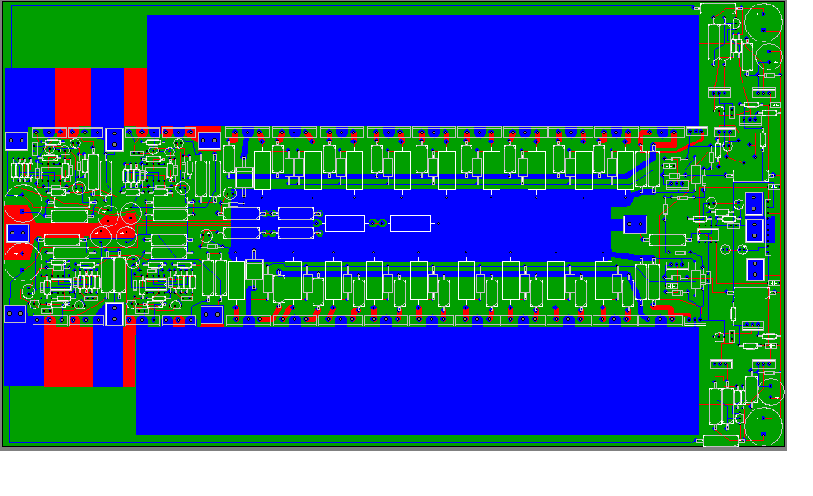

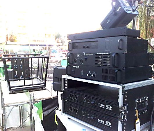

That's not a low-dissipation amplifier (just class AB not H). I built three of them, but the PCBs were hand-drawn directly on Cu-clad so not too reproducible. They were 1500W at 2 ohms and would melt the plugs off the extension cord. I have since been working on class H, TD, and D designs, with several class H in various states of completion. I have PCB designs for 2 and 3 rail class H amps - I have 8 of these board populated, but the rest of the chassis are still being built.

I like to say that I have best relation power/square inch of PCBThere is more space for PSU🙂
You cheat. You used a jumper wire between the NPN and PNP banks. Just make sure you don't run it parallel to or close to your feedback resistors or input trace. 🙂 And I wonder if the power traces need to be wider.... Remember how many amps are being pushed through them. Even if the average heating isn't an issue with 1/8 power pink noise, it's just evil to lose voltage swing in a PC trace.
