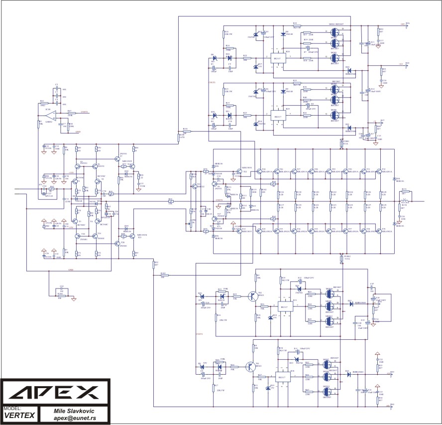

1 any substitute for diode BAV 21
2 any substitute for diode SAF 1603 very hard to find
can you show inputstage schematic and power supply schematic
waiting to make your amplifier thanking you

bav21 > byd73c, byd33dhi apex

sfa1603 > byv79/200, byw29/200

Full power of this amplifier is not 900W. Power with THD 0,5% is 1200W on 4R load, and 1800W on 2R load. Output transistor must be MJL4281A/MJL4302A for maximum power. For step mosfet use IRF2807. MJL21193/MJL21194 can be used for full power on 4R load.
Transformer minimum 1500VA for one channel 4X40V AC + 2X20V for protection circuit. 2X35A bridge and 8X10000uF/63V for PSU... are you still interesting to build this amplifier?

Thanks for sharing the class H circuit, having looked at it & it's simplicity i think i'll be incorporating it into a few amps that i'll be building in the future 😉
You have just saved me the hassle of building a switchmode PSU even though i didn't realise it at the time when i saw your circuit. Instead i can use transformers i already have but build a high power high frequency charge pump circuit to power the high voltage rails 😀
Cheers for making me think, & for saving me time, hassle & money

Class H DIY good idea,...
check RMX 5050 schematic for DIY ideas...
I want spend my time to add Class H in Quasi NMOS Amp too and share experience with another DIY people,...actually i dont have much time for DIY

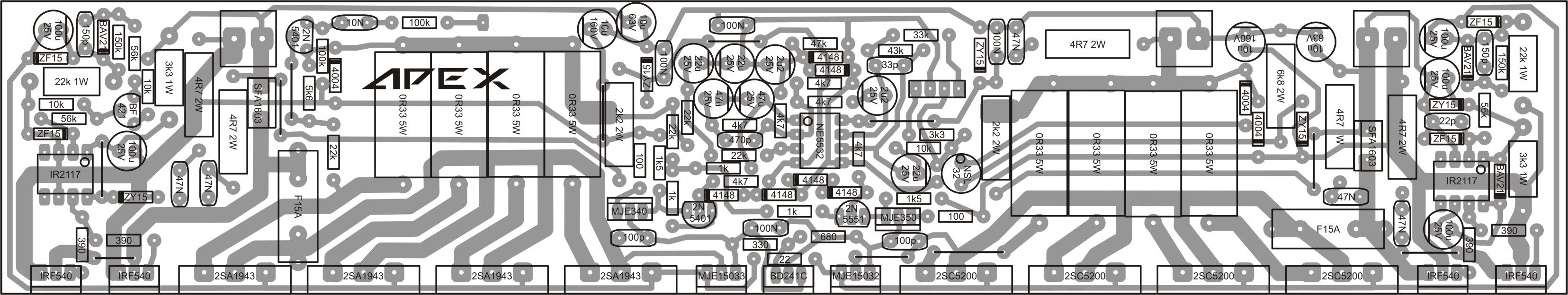

plz send me the schematic and the copper side pcb layout for this amp very much interested with high power amps.......

IR2117 give circuits with best possible stability for driving mosfets. Uses in industry concert amplifiers.
This circuit is for example not for DIY.component values nt readable
