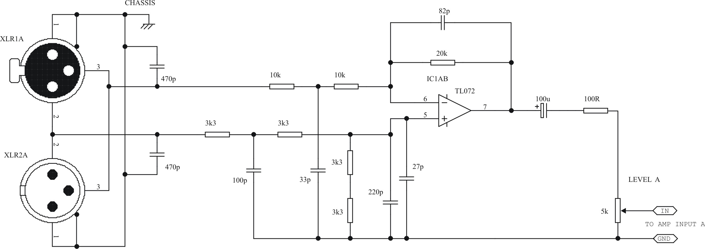

i'm happy to inform you that i already have a working balanced input
thank you for sharing
i have an old quasi mosfet amp but unbalanced input only
now i can use your circuit and my amp to avoid power loss due to long speaker cable because it is now balanced

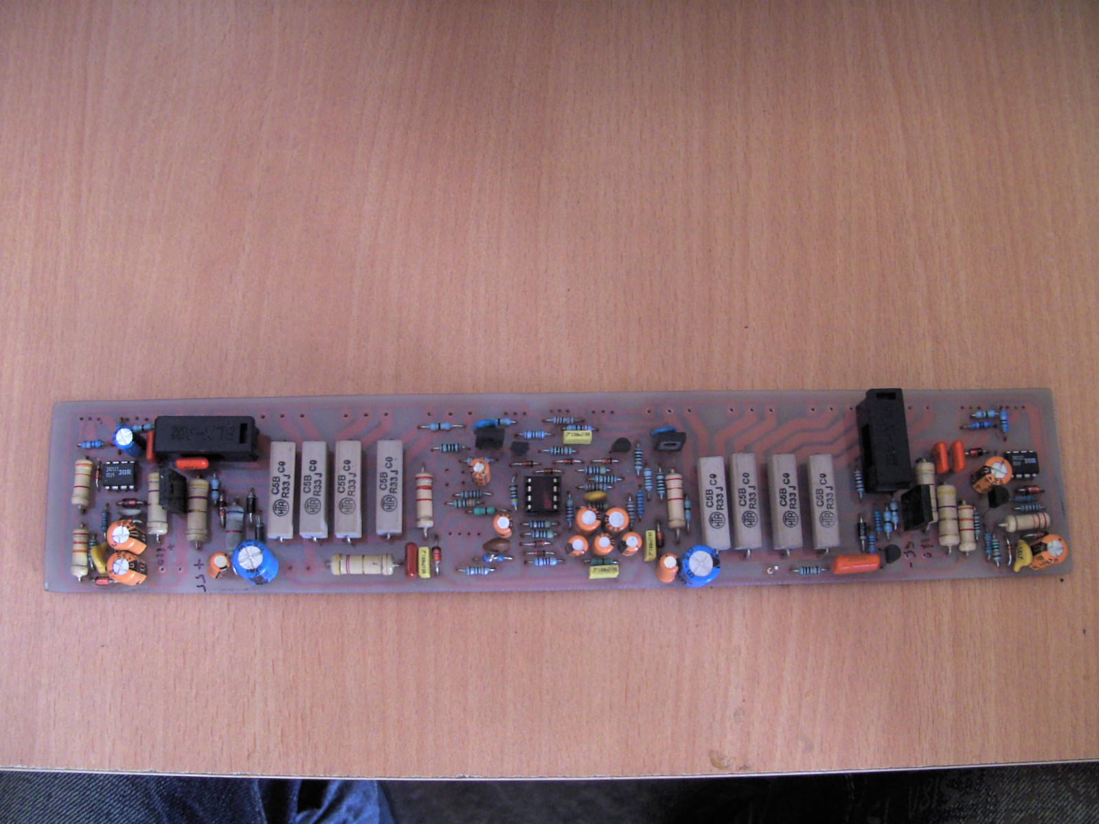

Is this your PCB design?apex,
yes i use dual op amp and make it stereo balanced input
thanks for sharing
can i use 5k resistor for max vol(5k pots not to use)
i want to control the volume from amp existing volume control

Just use signal from 100R, no need for 5k resistor.can i use 5k resistor for max vol(5k pots not to use)

NSL32 is opto-ldr, ldr with integrited led diode. There is four pins + and - (litle circle is -) from led diode and two pins from resistor. When led light resistor value incrise and atenuate input signal, that how limiter work. On your picture is just ldr with two pins, U can use this ldr as limiter with clear red led diode put together in black pipe.apex;
just for clarification
what kind of ldr is this one?
why this one can't be use as limiter?
Not parallel. Led - is dot on NSL32. Ldr pins are conected opsite from led pins there is two holes. Circuit diagram can also help U to understand.thank you verry much
ldr and led parallel connection
led positive to schematic of nsl with dot?
apex,
should the clear red led placed at nsl with dot (as for component lay out)
and the ldr to two holes in the middle of 22uf caps and nsl
Yes hole are for ldr, but led and ldr must look each other, and isolate from daylight with something black.apex,
