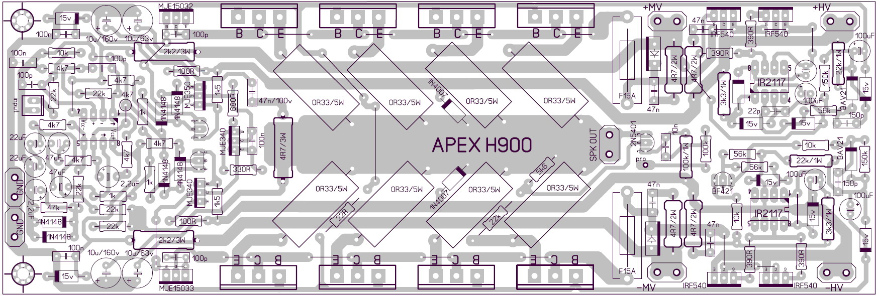

Hi..Apex...can I replace final TR A1943/C5200 with A2151B/C6011B? Because I have alot of them.

U can use 2SA2151/2SC6011 for 750W 4R (0,+/-45V,+/-90V).Hi..Apex...can I replace final TR A1943/C5200 with A2151B/C6011B? Because I have alot of them.

Sorry, any OPTO LDR. U can make opto ldr add clear red led diode, and put together in black pipe.any ldr can be use
can i use this one
Regards

where to connect +VH for opto limiter ? cant find in schematic how much Volt for +VH
Do you know different opto limiter device number easy to get in market ?
All connection for NSL32 are on PCB. +VH is +HV (+110V).Hello Apex

Yes is OK for H900 and B500 also.Hallo Apex
how about XLR Balanced in with NE5534, it looks similar like yours schematic, is this device configuration ok ?

ok thanks, and how much is max. Rail Voltags +/- for B500 schematic ?
Limiter activated when voltage level at the output is closser than 15V from +HV. It is no mater is +HV: 90V or 120V.ok thanks, and how much is max. Rail Voltags +/- for B500 schematic ?

If U want balanced input use OP. Amplifier also can work unbalanced just with pot for level control.want add XLR Balanced in without OP, could this work or any idea to improve ?
or is it better to use op like my previous posting ?

Power Ground and 10/63, 10/160 translate on step driver side. VI limiters if not useing protect with overload cut-out.Dual OP version , what other changes do you think should be done? I have a curiosity apex , what program you use to design circuits?
