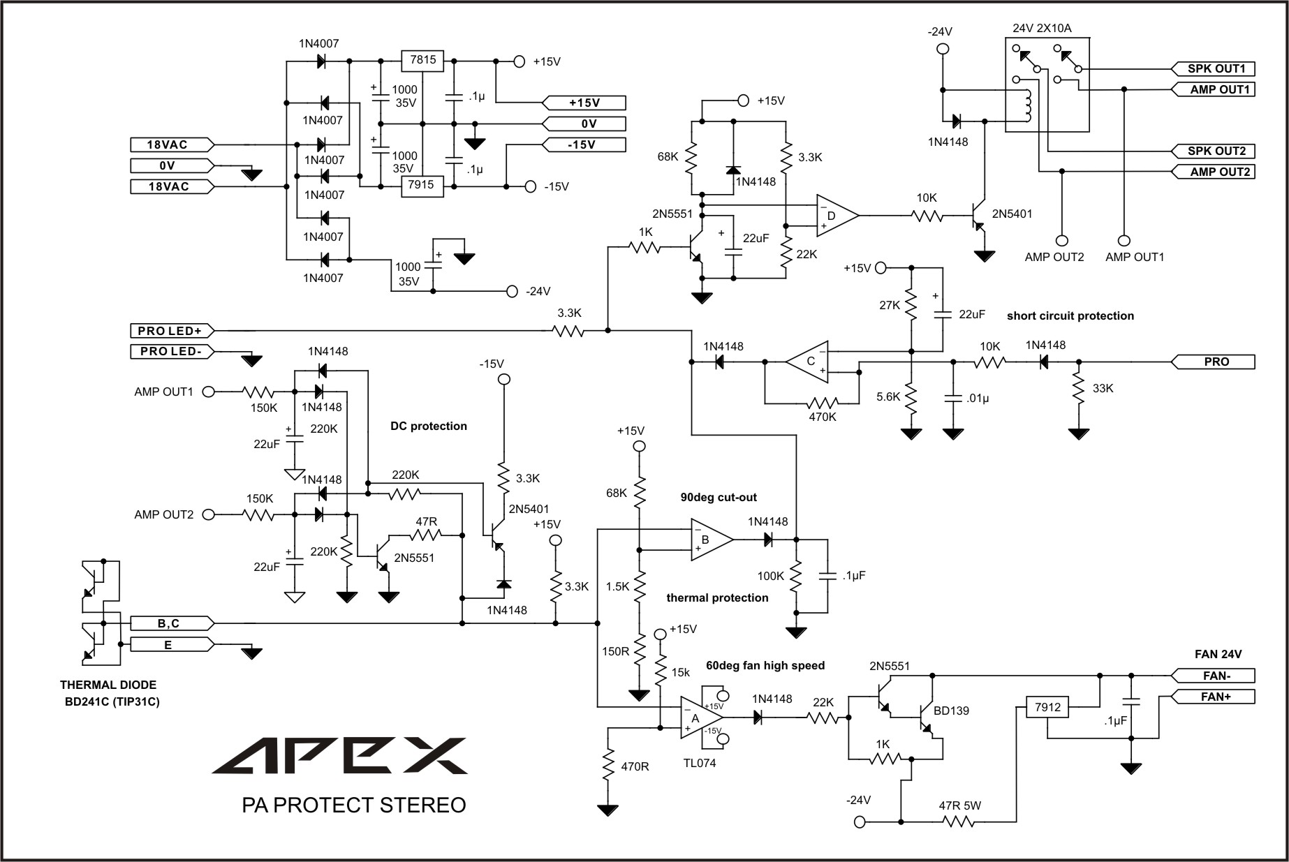

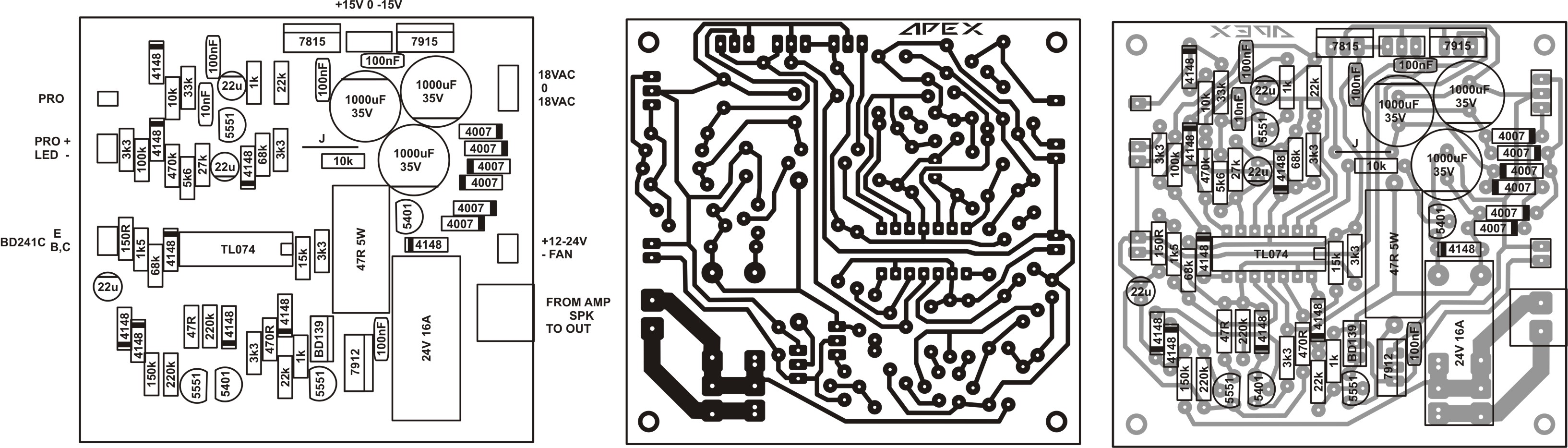

6VA 18+18Vac has a maximum continuous AC rating of 166mAacOk folks , I ran into this problem , I got a 6VA rated little transformer with two secondaries each 3VA and 18volts, I wanted to power my apex protection circuit from it.
Now maybe it is worth noting that i have two stereo protection circuits powered in parallel , as I have 4 channels one circuit for each two channels.
now when i run the transformer unloaded it shows about 20 volts out measuring from center to each side, as soon as I connect the wires it shows 0.5 volts on each side , the transformer inner wire seems very very think when i look at it and it seems it's physically unable to deliver the load.
I have a larger and thicker wire secondary , transformer , but it has only one secondary output winding,
can I use it somehow to make a floating ground and have it as bipolar psu for this protection circuit ?
I have attached the schematic I could use to make it bipolar.
what do you think?
the maximum continuous DC current is ~ 90mAdc.
To allow the transformer to run cooler aim for ~ half that maximum, i.e. <50mAdc continuous.
Your protection circuit should operate with a lot less than 25mA per board.
What have you done wrong?
I presume you have 18+18Vac because you have 24Vdc relay coils.
Is that correct?

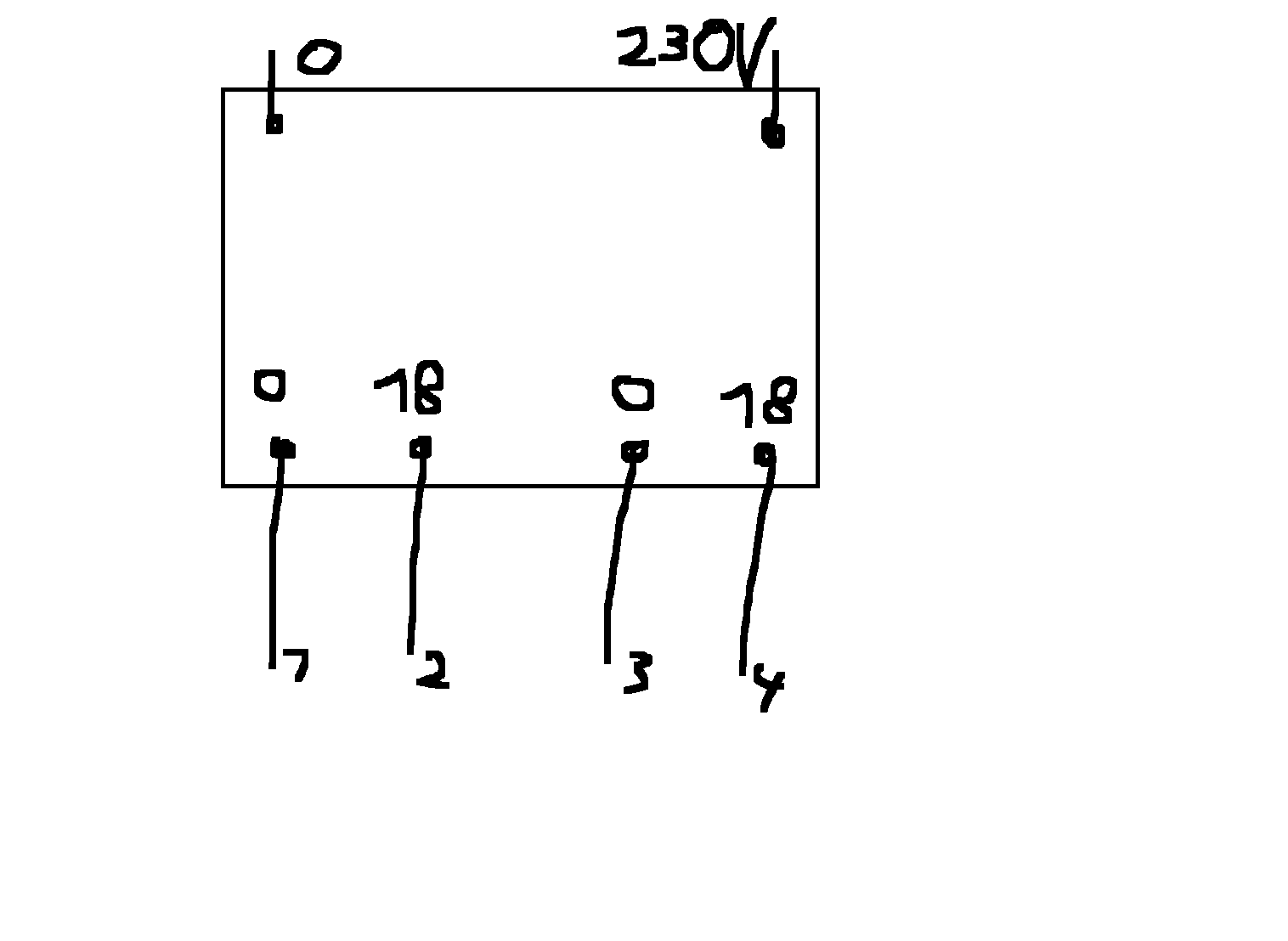

I have a transformer with to separate secondary windings , each rated 3VA, each 18 volts.
I connected them like this, one windings end is tied with the next ones start , not sure whether that's the way inside the traffo but since i cant see inside just at the outside terminals this is the way i connected it.
so now as I measure from the center i get about 20 volts each way.so it's about 20-0-20, as soon as I connect the load i get about 0.5 v each direction.
If the schematic is right and doesn't have one of those special mistakes put in so that the dumb copycats can't copy it then there's something wrong with my soldring maybe , I am checking this now.
Have you seen the post #3409?I really don't know , I've built everything according to this schematic and layout picture
This ia a working circuit,can you please explain what is your problem?yes thimios , thank you , I reversed the diode , but that surely isn't the cause of my current problem.but anyway it was a mistake either accidental or deliberate on the layout picture.
yes , the transformer sags dead when i connect the circuit , before connection it outputs about 20-0-20 volts but when i connect it it goes to 0.5 volts.
its a small 6VA transformer.
the circuit itsel appears to be ok, measured both circuit input at the diode rectifier and they show the correct values no short circuits.
sadly i dont have a stronger transformer to test just for curiosity.
Does the bulb of the Mains Bulb Tester light up?Did you see the bulb of the Mains Bulb Tester light up?
Fan polarity is wrong ,did you correct it?yes , the transformer sags dead when i connect the circuit , before connection it outputs about 20-0-20 volts but when i connect it it goes to 0.5 volts.
Now i see, your schematic is ok.
Did you test the circuit with a fan attached.
Is your transformer suitable (enough current) for fan operation?
yes I just did a test and a 25w bulb glows mildly but beautifully when connected in series with the primary of the transformer , the secondary shows 0.4 volts of output.
I have no fan attached , I made my box and heatsinks such that no fan is required.
I have no big load attached to the circuit just the protection circuit itself.

Then check your circuit for wrong polarity electrolytic capacitors or regulators,diodes or short circuit by solder points.yes I just did a test and a 25w bulb glows mildly but beautifully when connected in series with the primary of the transformer , the secondary shows 0.4 volts of output.
That bulb filament lighting up tells you the circuit is drawing too much current.yes I just did a test and a 25w bulb glows mildly but beautifully when connected in series with the primary of the transformer , the secondary shows 0.4 volts of output.
Sort the wiring.
If necessary go back to just the transformer. test.
add on the bridge rectifier. test
add on the smoothing. test.
add on the second rectifier. test.
add on the second smoothing. test.
Once you have the correct voltages at the two sets of smoothing and the bulb is NOT glowing, then you can add on the protection circuit.
Ok, I measured the pcb and found out that one of the two pcb had many short circuit points were the traces were touching which was unseen by the naked eye but when upon closer inspection it resulted in such.sadly the pcb turned out kinda crappy and was messing with my head , now I sorted it out

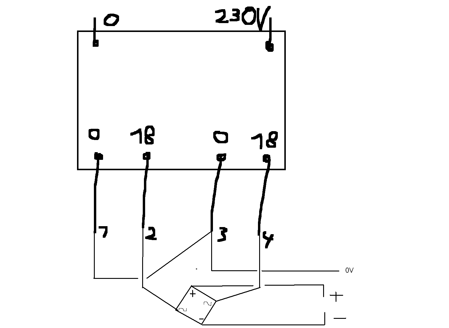

just of curiosity , what the right way to connect the two secondary windings of the transformer to form a bipolar supply ?
I attached a ms paint picture of my transformer layout
