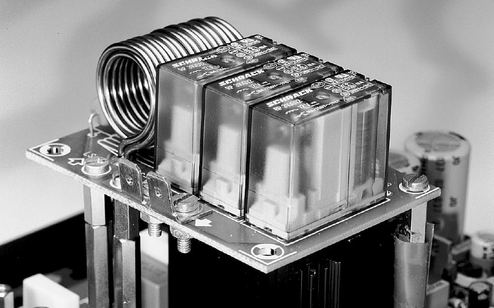

Guys is there any substitute for the relay used in this circuit I.e. 24V 16 A relay in terms of Amperes and voltage that I can use because I am unable to find it in India

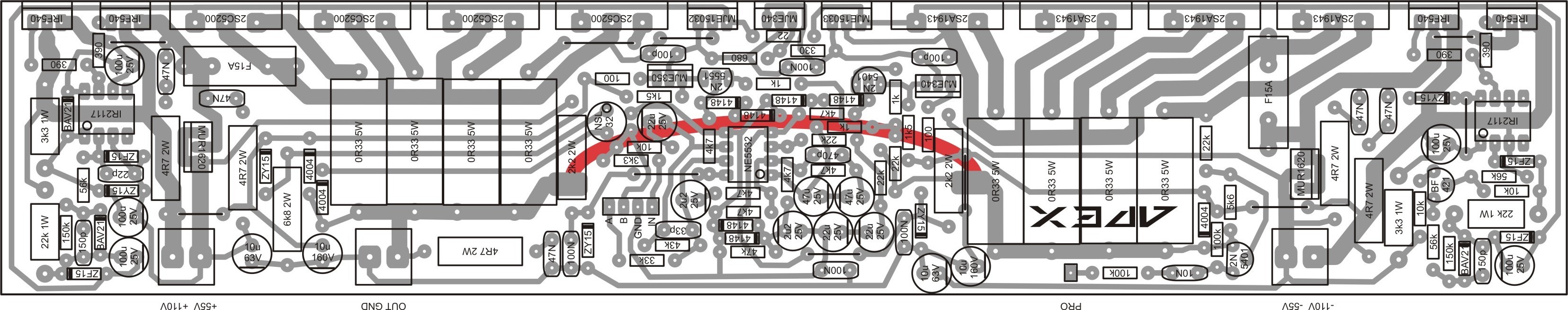

Well, here are Gerber and Excellon for H900 version 2.1.
Enjoy!
Hello Sale030... may i know what software to use in opening this gerber file.. thanks
You can use 2 relays 24V/8A, 24/10A, or one stereo relay 24V/2x8A, even two stereo relays in parallel 24V/2x5A... Try to find anything on 24V 🙂
For the viewing Gerber files, you can use any software which can import Gerber. For example, Sprint Layout

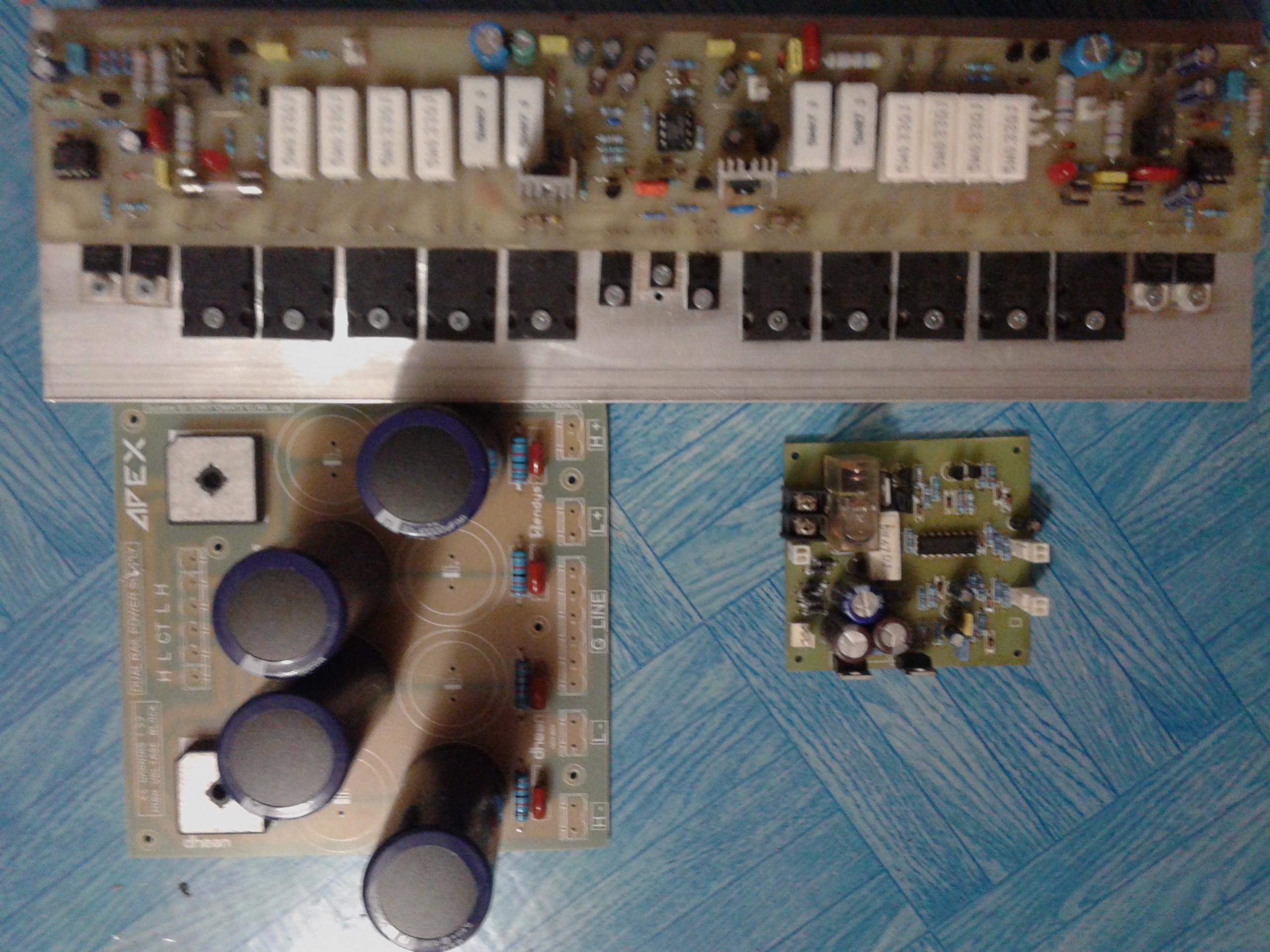

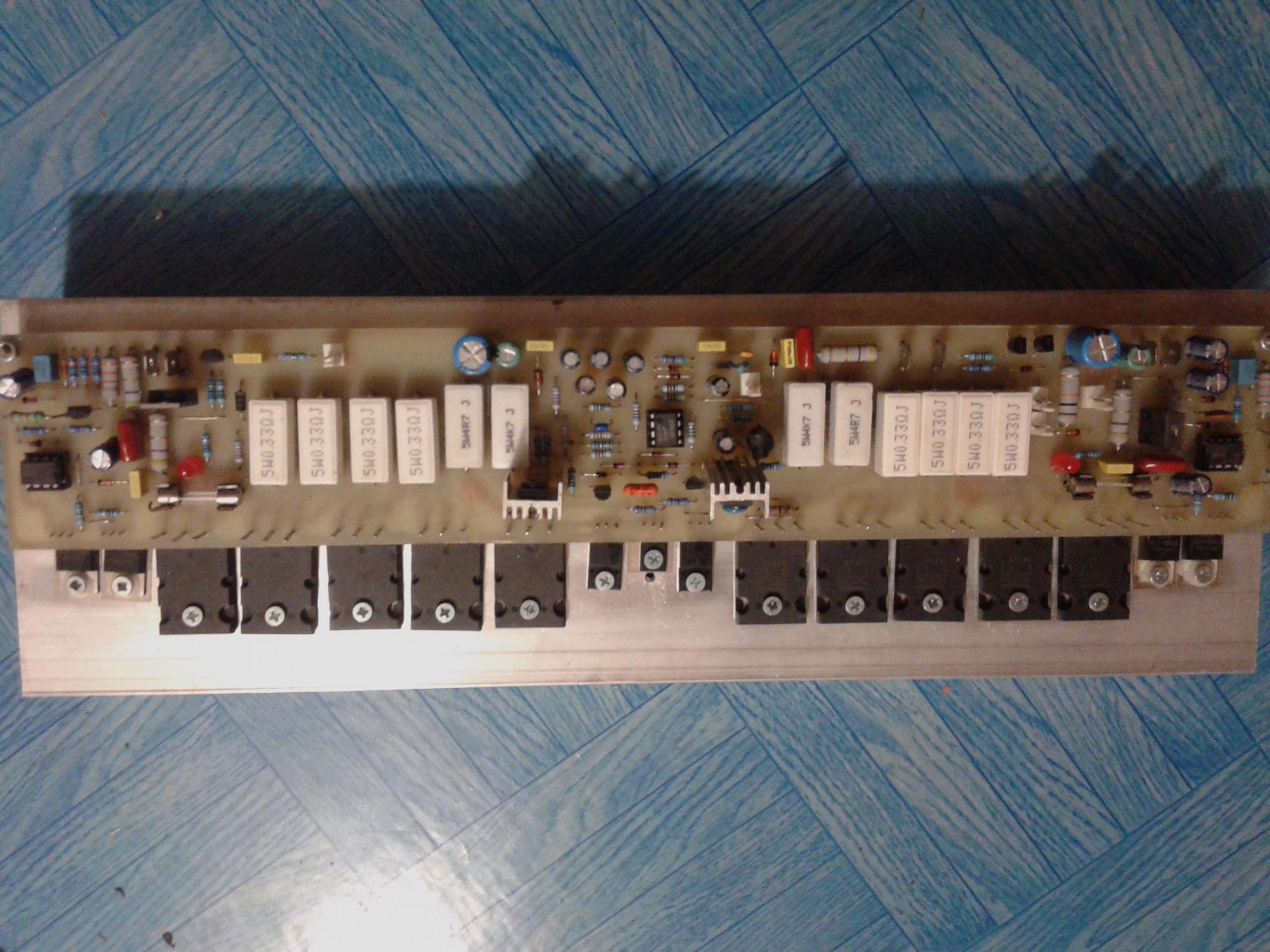

Good day Andrew sins you have experience in APEX H900 in particular power amp i have a question
1. The power supply of protect circuit did you separate it from the main Transformer?
2. Did you put Balance input circuit?
why i am asking this because i am data & experience of many DIYer who made this H CLASS, this my first time to make or assemble an H CLASS power amp i had experience but in simple power amp 100W so please don't get annoyed for my many question k & how is your APEX H900 going?
