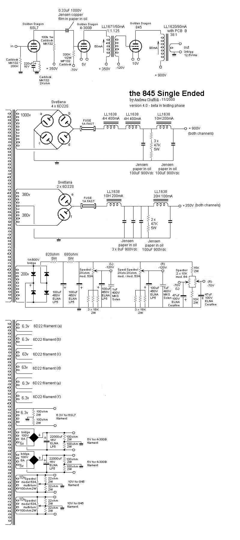

search Andrea Ciuffoli New 845 amp.
this and others 845 projects

Since you are a relatively inexperienced builder, here are a couple of observations about building an 845 amp. It typically uses very high voltages and most designs call for over 1000 volts. Many very experienced builders are too scared to go up into that voltage range since it is very dangerous. As you have seen in the thread on output transformers for an 845, the transformer needs to be rated to handle that voltage.
The high voltage power supply will be large and heavy with chokes that are rated for at least 1000 volts. Your capacitors will also need to handle the voltage as well as the diodes. Such a power supply is not trivial.
You use high efficiency Lowther drivers. The 10 volts that you will need to heat the 845 may result in hum issues if you use AC with a hum pot. Hum would be less of an issue if you had less efficient speakers. The alternative would be to use DC to heat the filaments. The best solution are the Rod Coleman regulators but then you have to build a substantial power supply for each channel to supply the regulators.
Already what I am describing is a serious boat anchor amp which will be quite difficult and expensive to build.
Since you are concerned about linearity, you also need to consider the input tube as well as the tube or mosfet or interstage solution you will need to drive the 845 tube.
Or you can make life easy for yourself and use some of the most linear tubes ever made, the 45, 2A3, 4P1L or 300B which will work fine with your Lowthers. There are plenty of designs using these tubes and as a relative beginner, you will have a much greater likelihood of success and your amp will sound just as good on your speakers as an 845 amp. There are also kits you can buy using some of these tubes which will teach you best practice lessons about layout and wiring. The cost will be much less and you will be able to carry the amp without getting a hernia.

If you ever do build an 845 amp, the power supply is not as daunting as some would have you believe.
The choke(s) do not have to be rated for 1000VDC. You don't need to put the choke(s) in the + high voltage line. As a safe alternative, you can put the choke(s) in the negative line and they are just as effective. Do a search and you will find a circuit for reference.
The 845 filament only needs 10VDC @ 3A. Not a big deal to make a DC filament supply. For a nice starter amp, this supply does not have to be regulated.
Not all 211 or 845 amps are boat anchors. I've seen 300B amps turned into boat anchors.

I am interested in implementing the circuit provided by Dietmar. It is a full design of a SE amp. Do you think it is a flawed design? If so please provide specifics.
I am not interested in any SET amp , only 845.
Any experience with Bez amps ?
The Dietmar works, better than original, but needs more power supply regulation circuitry. Not sure whether transformer is the limiting factor. The 845 is the triode to do, as it can deliver 20 watts per channel, so it can go quite loud even without horns
