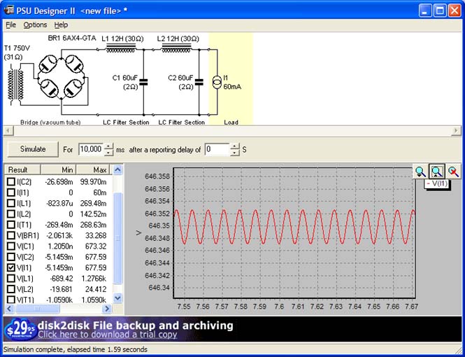

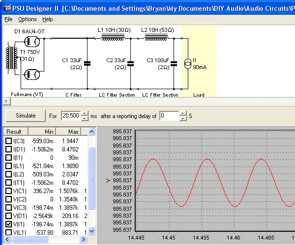

The GF is away for the next five days, so I can get down to business. I will start breadboarding. I think it will be wise to breadboard each channel seperately, as this thing is going to weigh a ton! I will buy some wood this afternoon/tomorrow morning, with weight capacity in mind!
So, power supply. Lets start with the driver PS. I have available:
375VCT 300mA power transformer
12H 100mA chokes
multiple values of motor run caps (1, 2, 10, 20, 33, 50, 60, 100uF)
83 rectifier (and associated iron)
6au4 rectifiers (and associated iron)
silicon rectifiers
For this power supply, I will ultimatley like to run any and all of the driver options (45, 2A3, 300B, el34, KT 66, etc), so I want plate voltage which will be ample for every valve. I will be IT coupling this stage to the 845 grids. I'm thinking CLCLCRC tapping the driver off the third C and then the input off the final C. Choke input here will probably not give the voltage I need...
Given the available components, does anything jump out as obvious? Also, full wave, hybrid bridge, etc, keeping in mind useful working voltage for drivers....?

So who's going to give you the "kiss of life"?😀The GF is away for the next five days, so I can get down to business. I will start breadboarding.
Seriously, playing with HV alone is hazardous. Take extra precautions.
Choke input is not really any advantage in this case as your driver stage should draw constant current.
Multiple element smoothing with chokes can give rise to strange turn-on / turn-off behaviour. Simulate it in PSUD2. Do you really need all that smoothing? My gut feeling is that 200mV of ripple is fine for the driver.
My suggestion: Only breadboard 1 channel until you are ready for serious listening tests. You can gauge a lot from 1 channel.

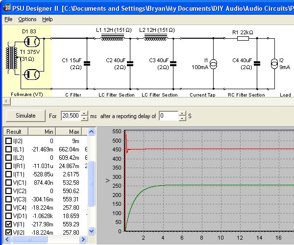

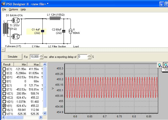

dhaen,
Ahh, the kiss of life... I didn't say I would turn anything on, just set it up! Cautions well noted!
It turns out I whould have plenty of HV, as the PS Tranny is 375-0-375. If I work up a full wave hybrid bridge, choke input, I'll have more volts than necessary.

Is there a general rule of thumb with respect to how much ripple is acceptable in the chain? And, at what point do we reach diminishing returns with respect to effort used clear these nasties?
I imagine that the ripple should be less for the input, compared to the driver, and less for the driver compared to the output tube. What ripple is acceptable for the driver tube?
Obviously if you can hear the effects at the speakers there is an issue, but how does this relate to real time numbers???

OK,
Here is the driver PS with sim. I think the ripple will be low enough for both stages...
What I like about this supply is that I can tune the driver voltage by adjusting the first cap. Depending on values I can get from 450 with the cap input down to 250 for the choke input. This should allow me a lot of room to work with various drivers, no?
