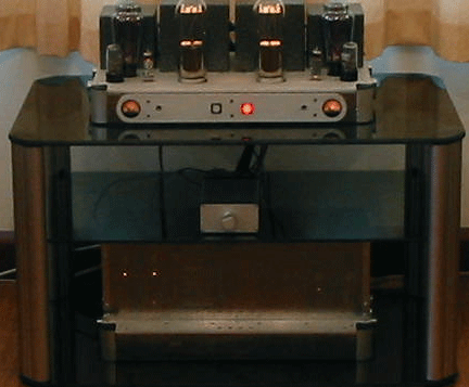

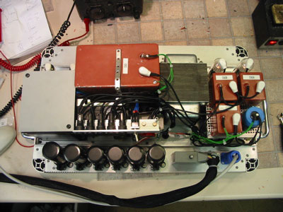

See my amp at
http://users.telenet.be/filip.peters/gm70.html
the powersupply is just transportable by one person. it's very heavy. Transformers are big blocks of iron....
Also, if you use 866, let them pre-heat always a bit before hitting them with voltage. A seperate transformer is best for this, but think on how you're going to switch this.
