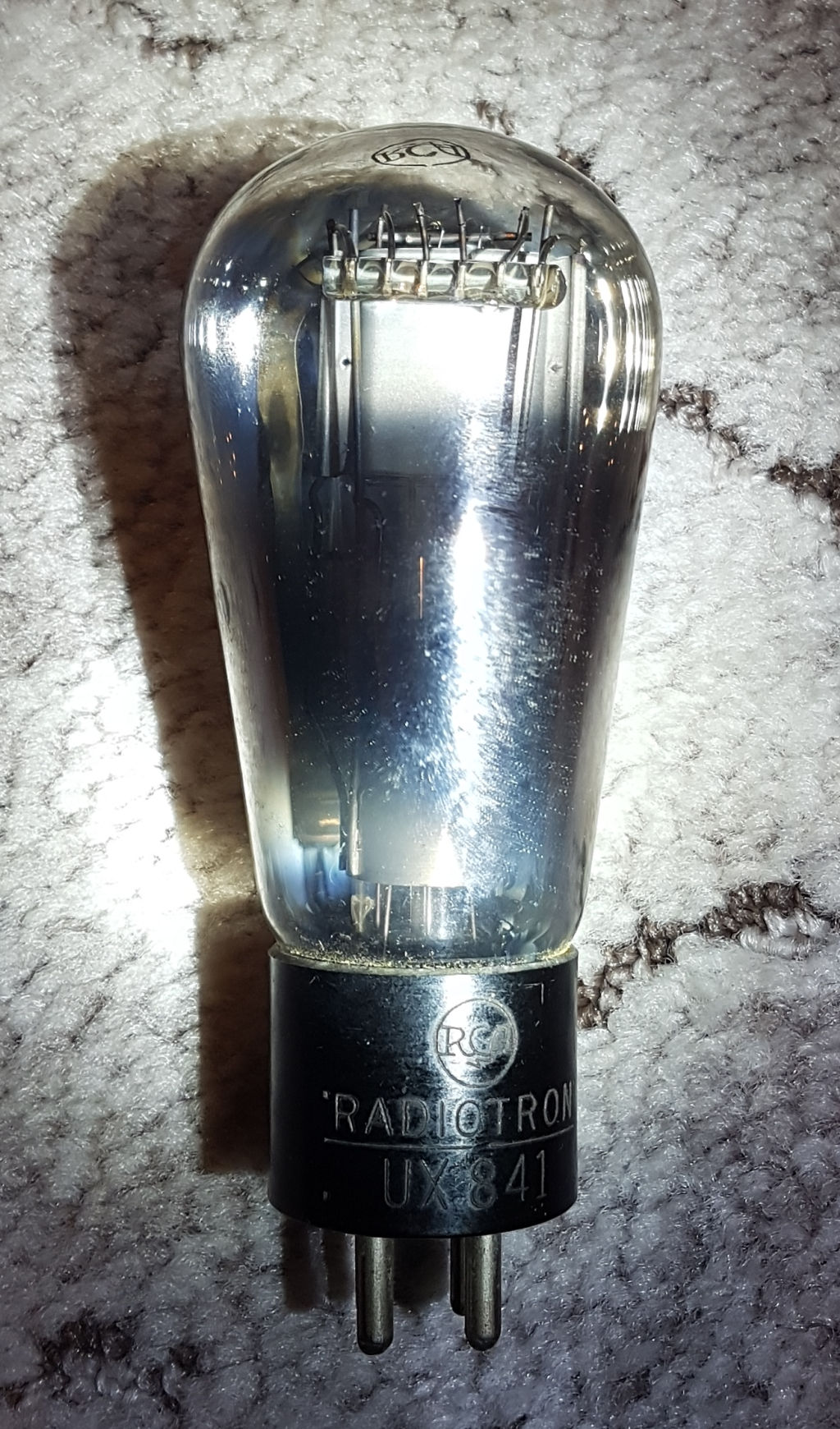

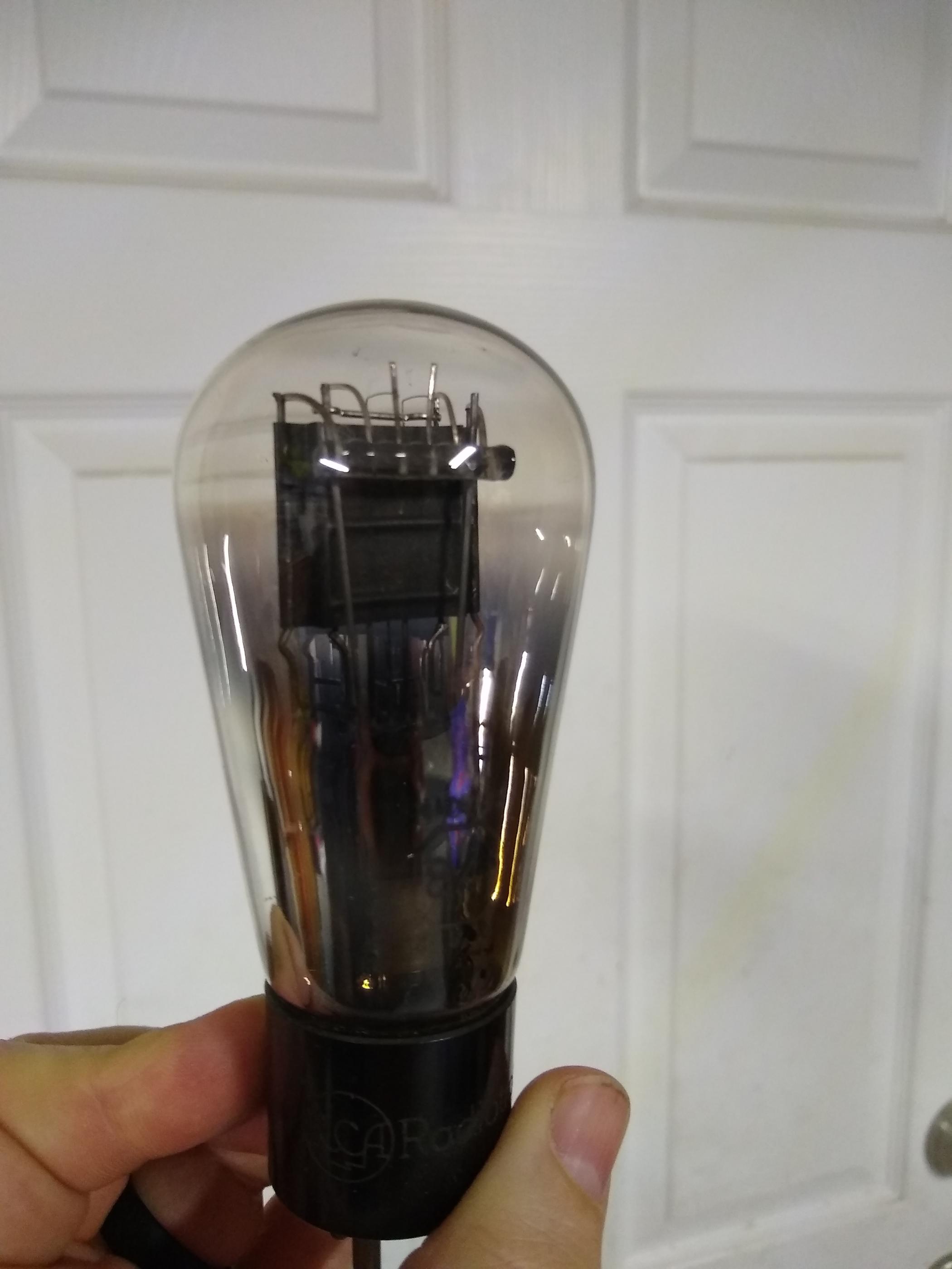

Thanks, SS! That RCA pair of globes are the only ones I have, every other pair are the ST Hytrons, the most common in my experience too. Wow, never came across a Raytheon 841, I'll have to keep an eye out. There is a fella with some really nice NOS GE globe 841 on eBay, but asking quite a pretty penny for them. Switching everything to TO-247 is probably a good idea, I'll keep that in mind 🙂

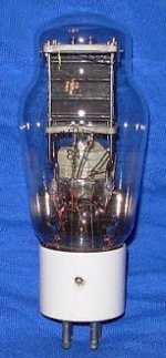

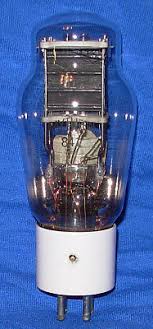

That is one nice looking tube, love those ceramic bases. A pair of those must be as rare as hens teeth, I'll keep an eye out!

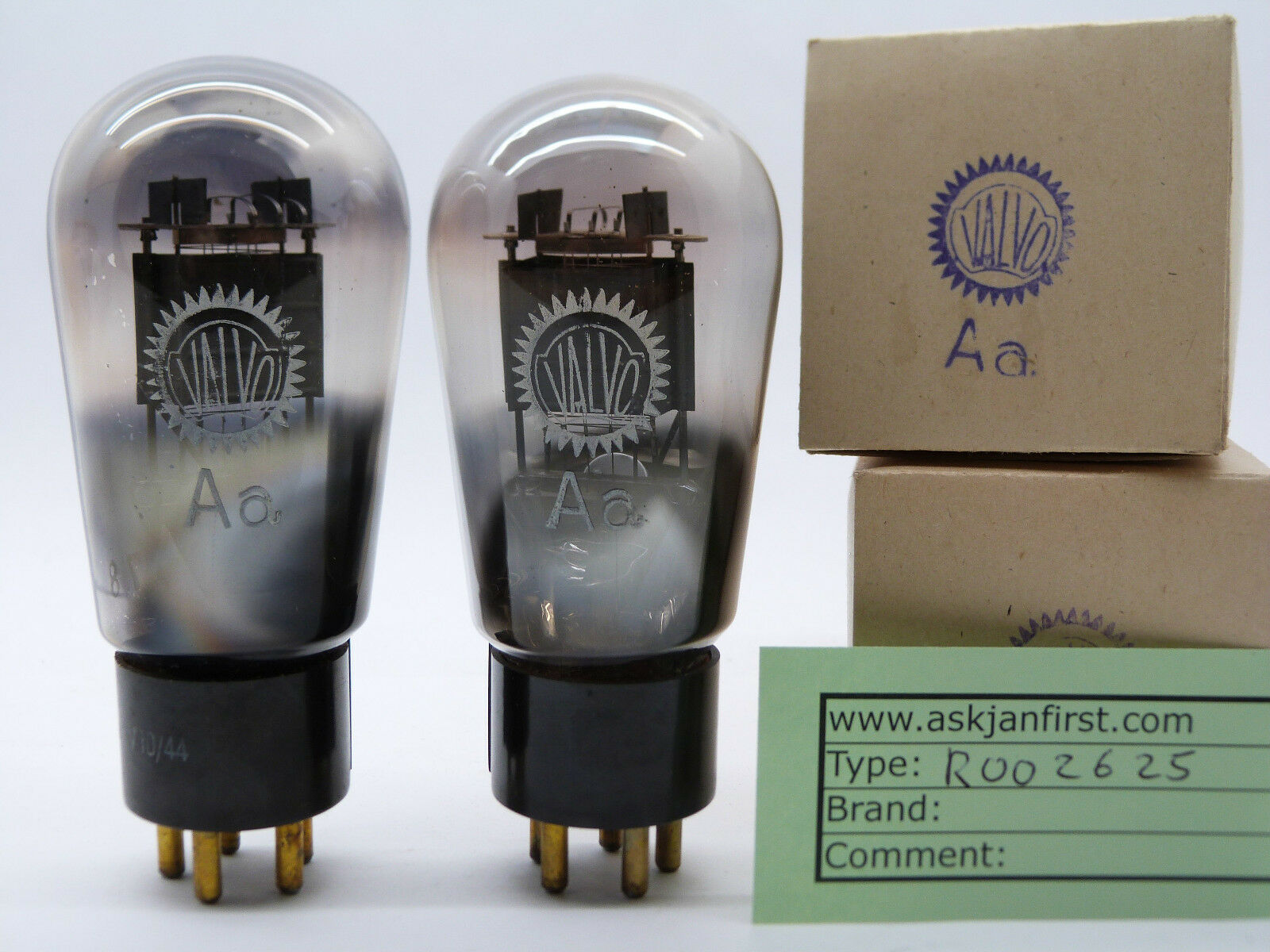

On the subject of rare DHTs, this simple design could be implemented with another high-mu DHT option, the Valvo / Siemens Aa postal tubes (mu of 30).
These are actually more common than the 841 and would relax the B+ requirement big time (around 200-250V). They are around $150-200 a pair though.

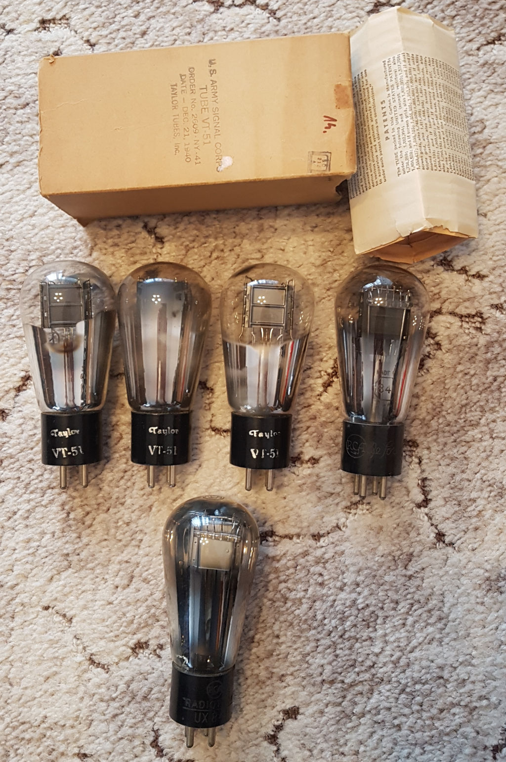

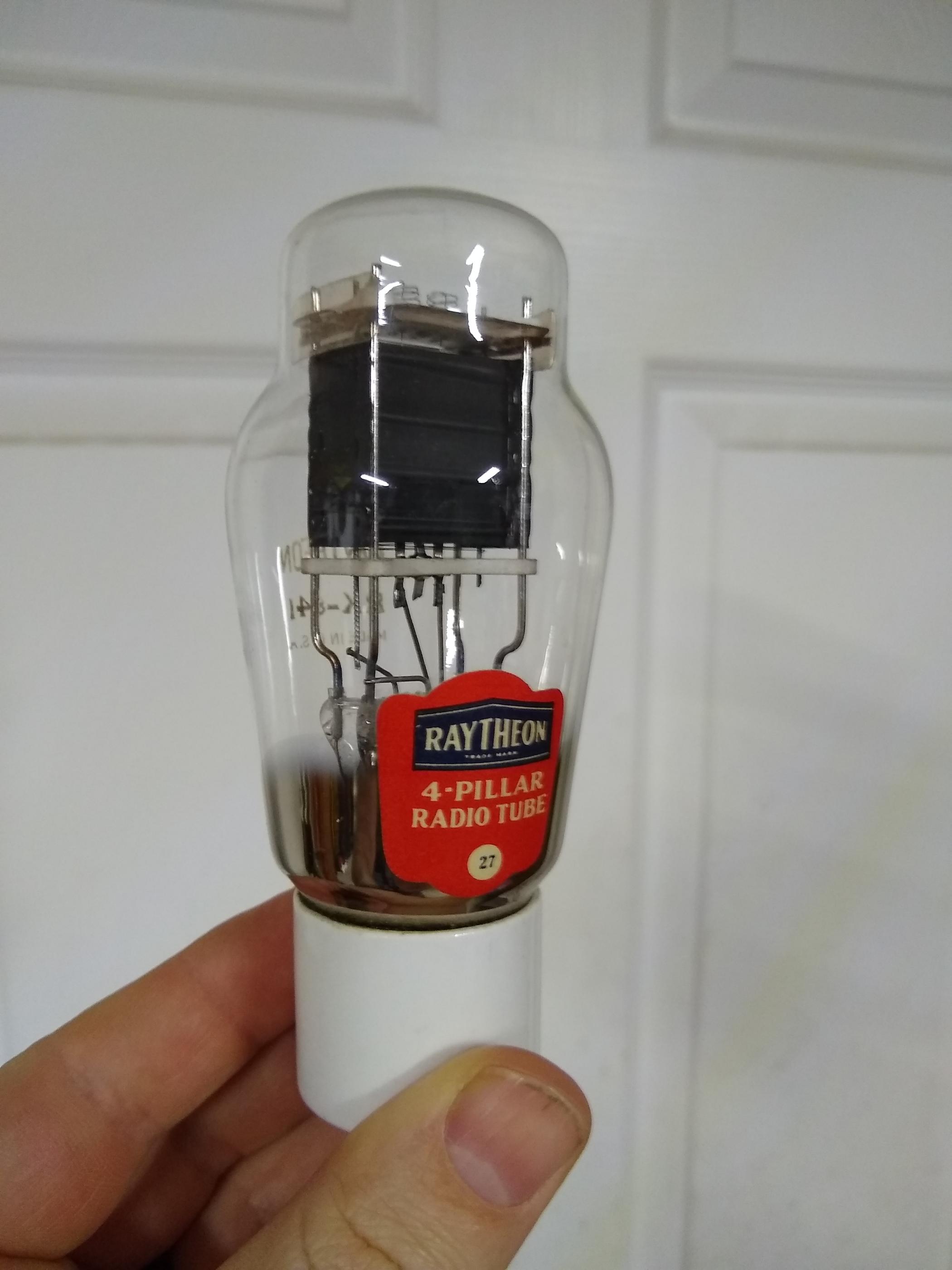

Man, the box plate Raytheon is stunning, would love to find a pair of those. The RCA appears to be identical to my pair, the only other globe 841 I have come across are General Electric and euro21’s smooth plate Radiotron.

Nice tubes euro21, beautiful Taylor globes, maybe I have seen those once before but I cannot remember where.

"maybe I have seen those once before but I cannot remember where"
I bought these (one pair, and the single) via ebay at 2014 from different sellers in USA.
The average price per tube was then about 90USD (include shipping), now the shipping itself sometimes exceeds even 30-40 dollar. :-(

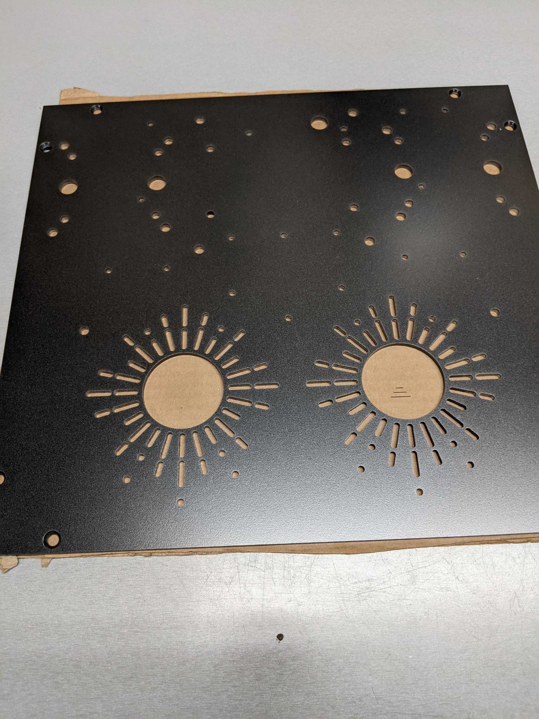

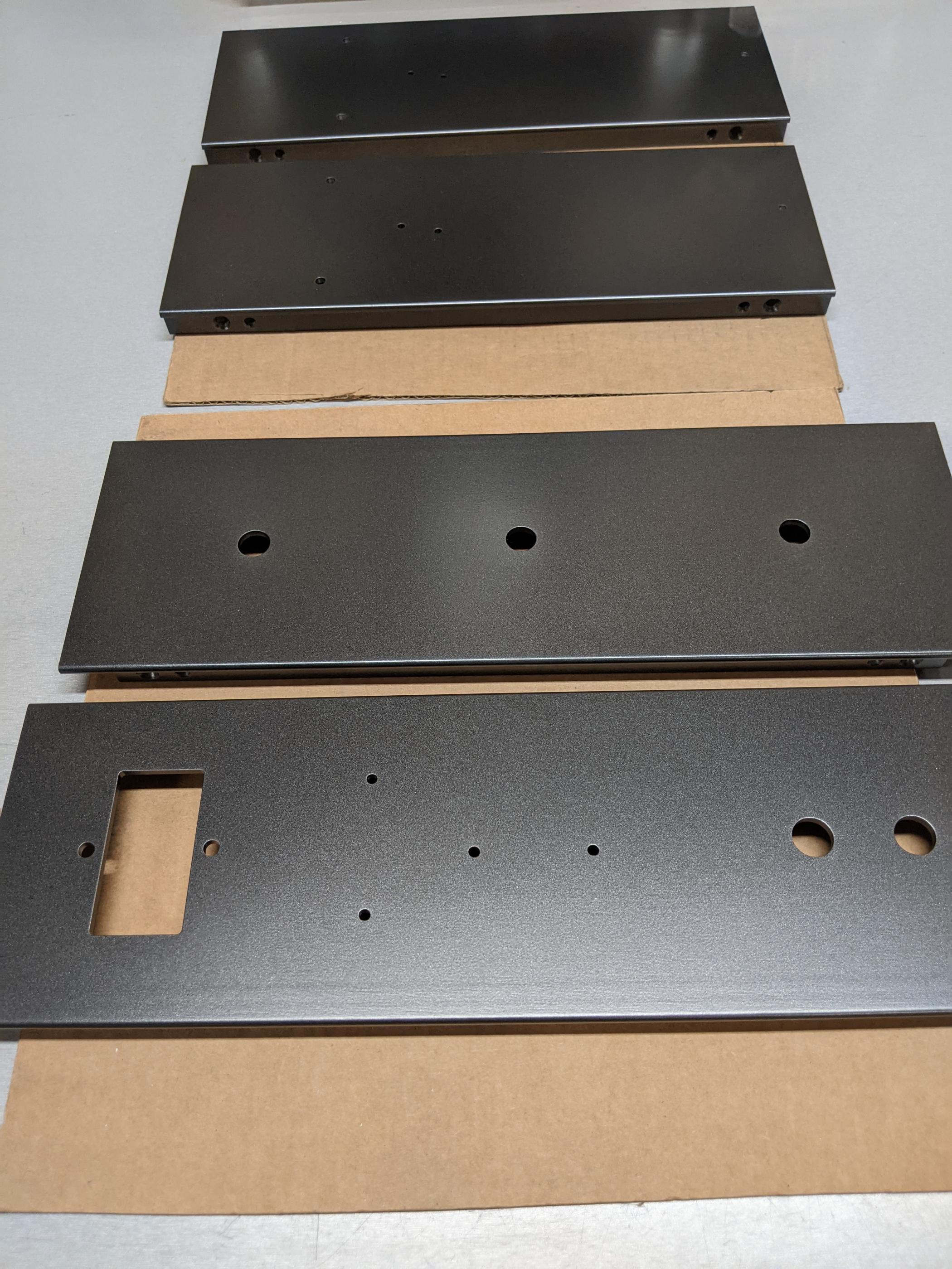

Should have the chassis for this amplifier any day now, I've attached some photos from the gentleman who machines them for me, powder coated in a metallic gray.

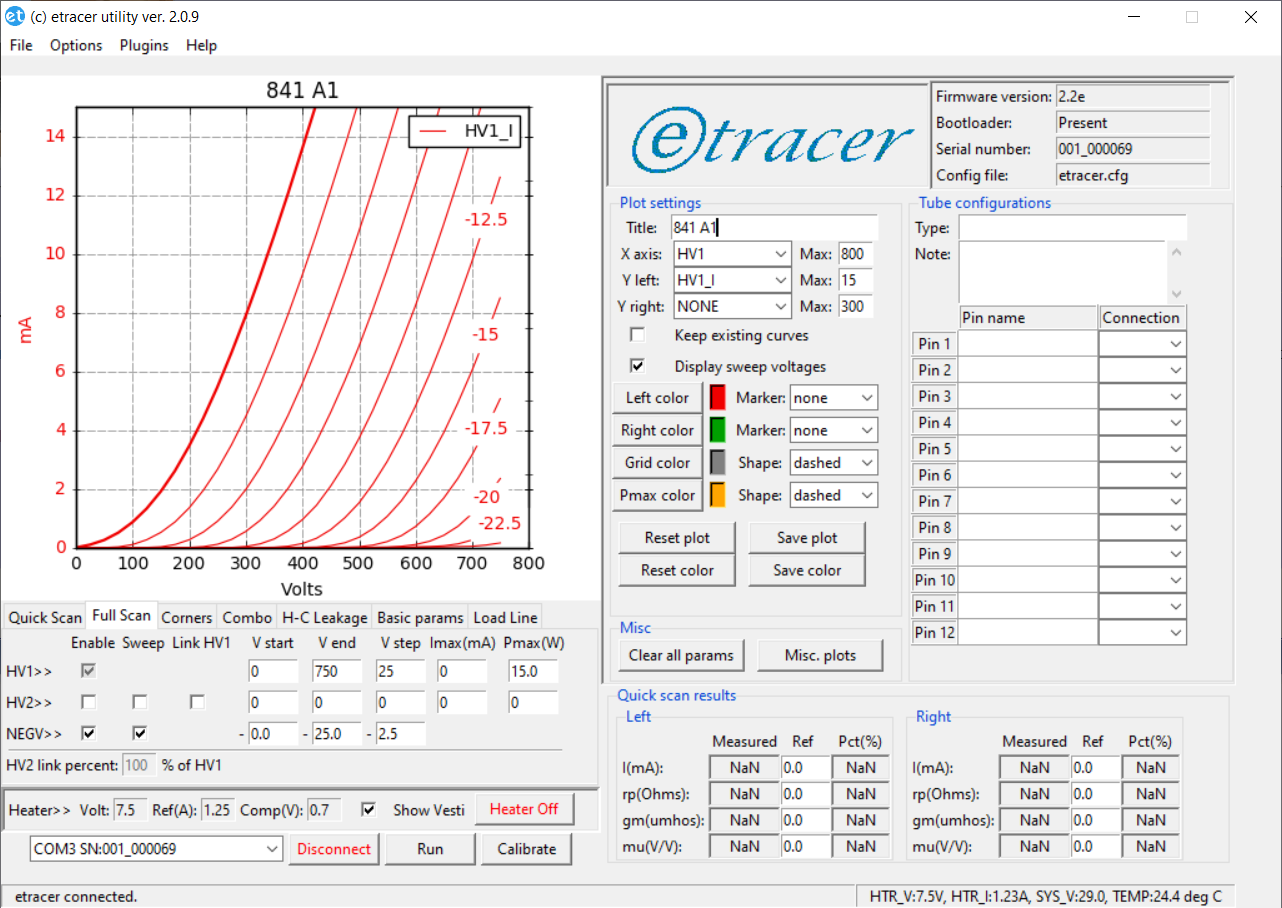

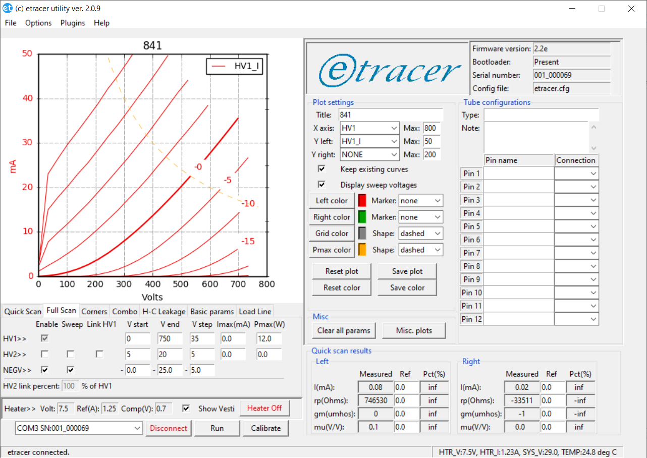

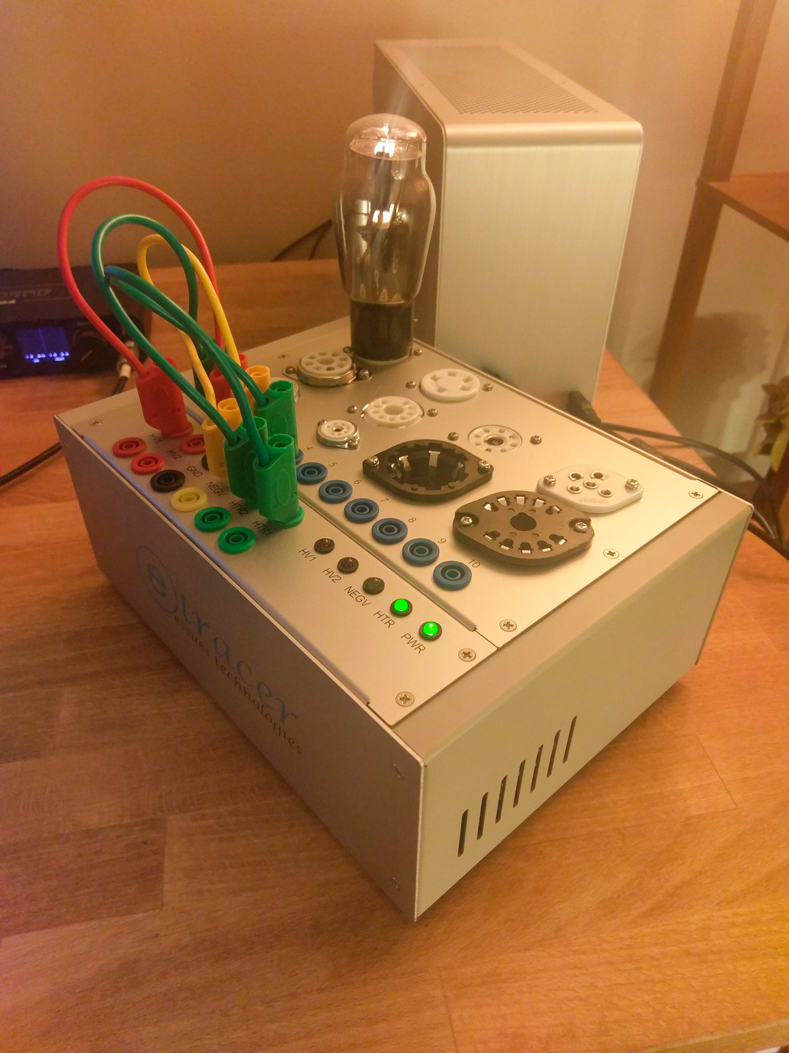

I also made a big purchase the other day, the etracer curve tracer. Attached are some A1 and A2 curves for the 841. Some interesting applications at a positive grid A2 bias point perhaps, although this amplifier is A1 only at a very modest bias point, the tubes should last a very long time.
I'm a little jealous of the curve tracer...😀
That 841 has really pretty curves. I run mine with a 10mA CCS load, about 400V on the plate, and about -2.3V bias. It swings about 440V pk-pk. Looks like a good zone to operate. Solid state driver supplies the necessary grid current.

Hey thanks, SS! The etracer is a pretty cool little unit, but not cheap by any means :/ luckily I have been working overtime lately.
Wow 440Vpk-pk, need to go back to your blog and refresh my memory on how you are using them, they can swing some serious voltage, think I'll find another circuit for them some day. My little headphone amp is sort of an odd use I admit, but it sounds great. I have them CCS loaded as well, 6mA, 400V on the plate and roughly -3.75V on the grid. They'll swing something like 150Vpk-pk which is plenty to drive any headphone to ear-destroying volumes with the output transformers I'm using.
Here are just the A1 curves up to 15mA.

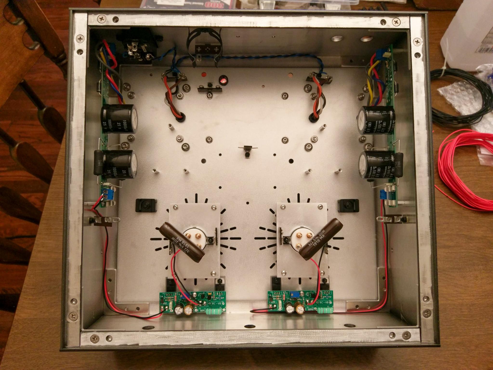

Finally making some headway on this amplifier. Prepped the chassis last night - sanded away powder coating overspray on the top plate and mating faces of the side panels to get a good ground connection.

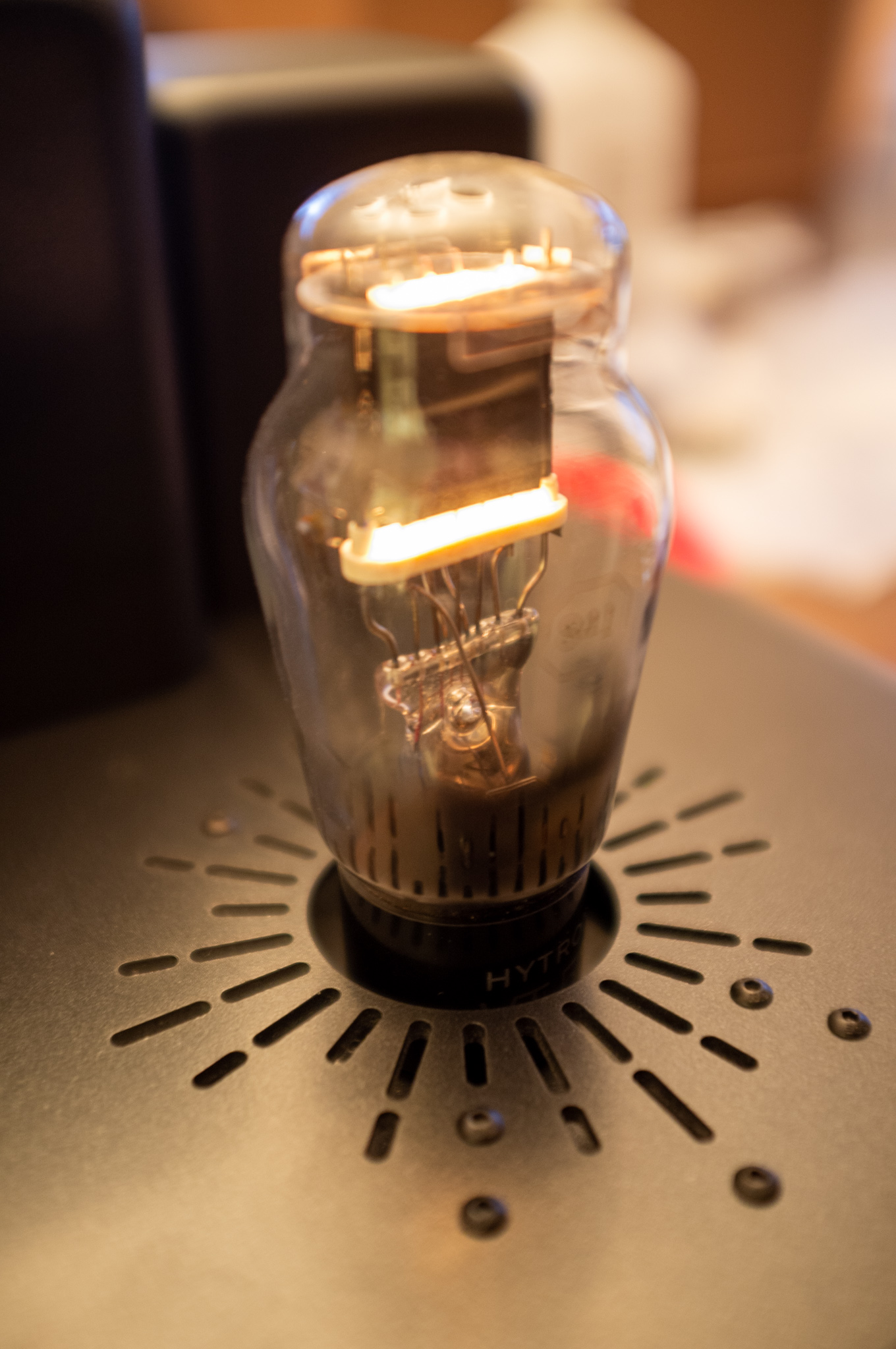

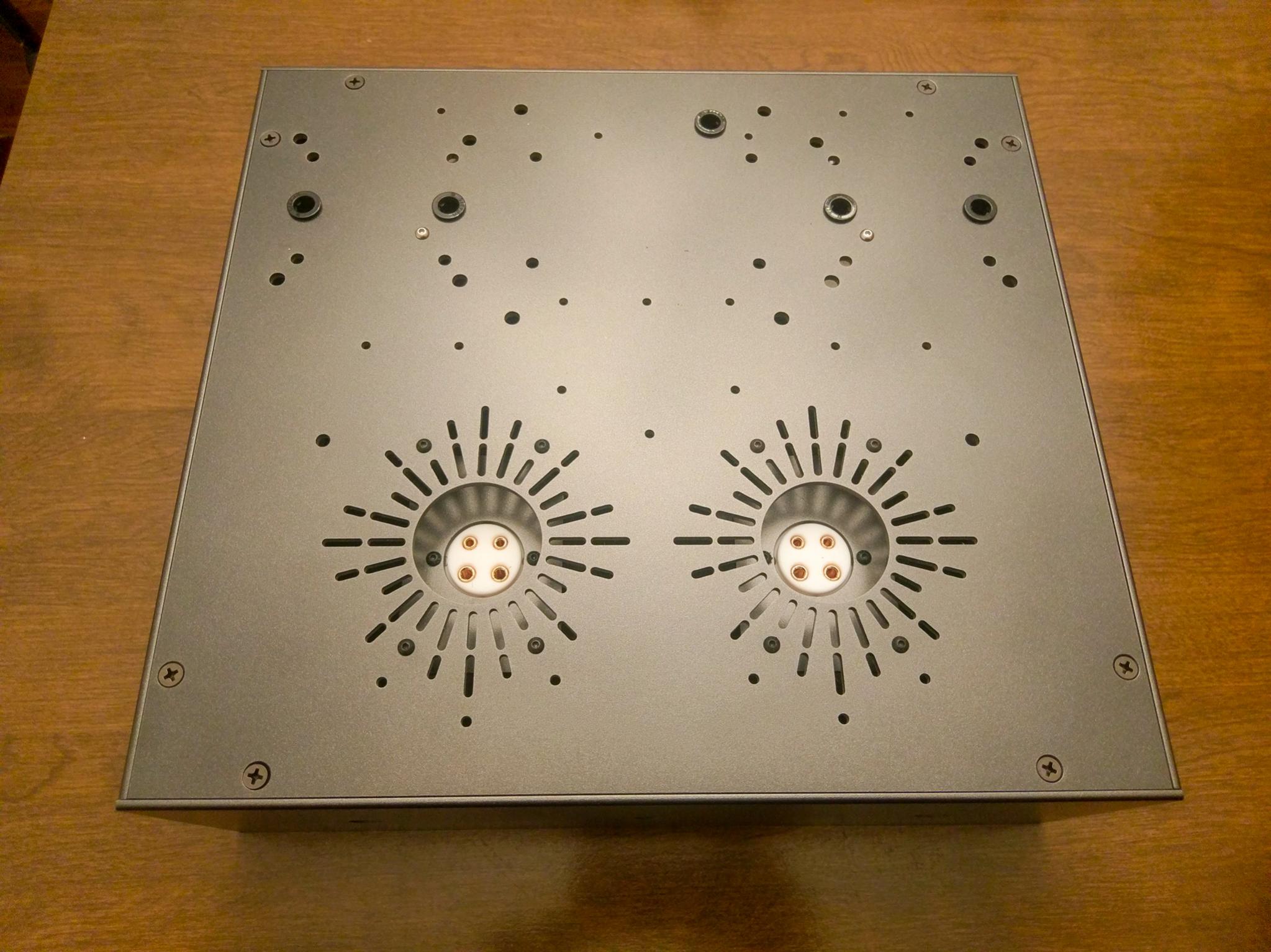

Started mounting parts as well. My recessed socket design turned out well! Looks really nice with a pair of globe 841 in place. Should be able to finish the amp by this weekend.

I like the recessed mounting with plates under the chassis. I've got something similar planned when I make my 826 amp, so that I can have a hole in the chassis and different sockets that mount under the hole for different tubes. I also probably have to put a little fan under for extra airflow.
I really like the chassis and I might have to try Landfall out for my next project.
Where do you get those 4-pin sockets? Those look really nice and I will need some sockets for my 100THs.
