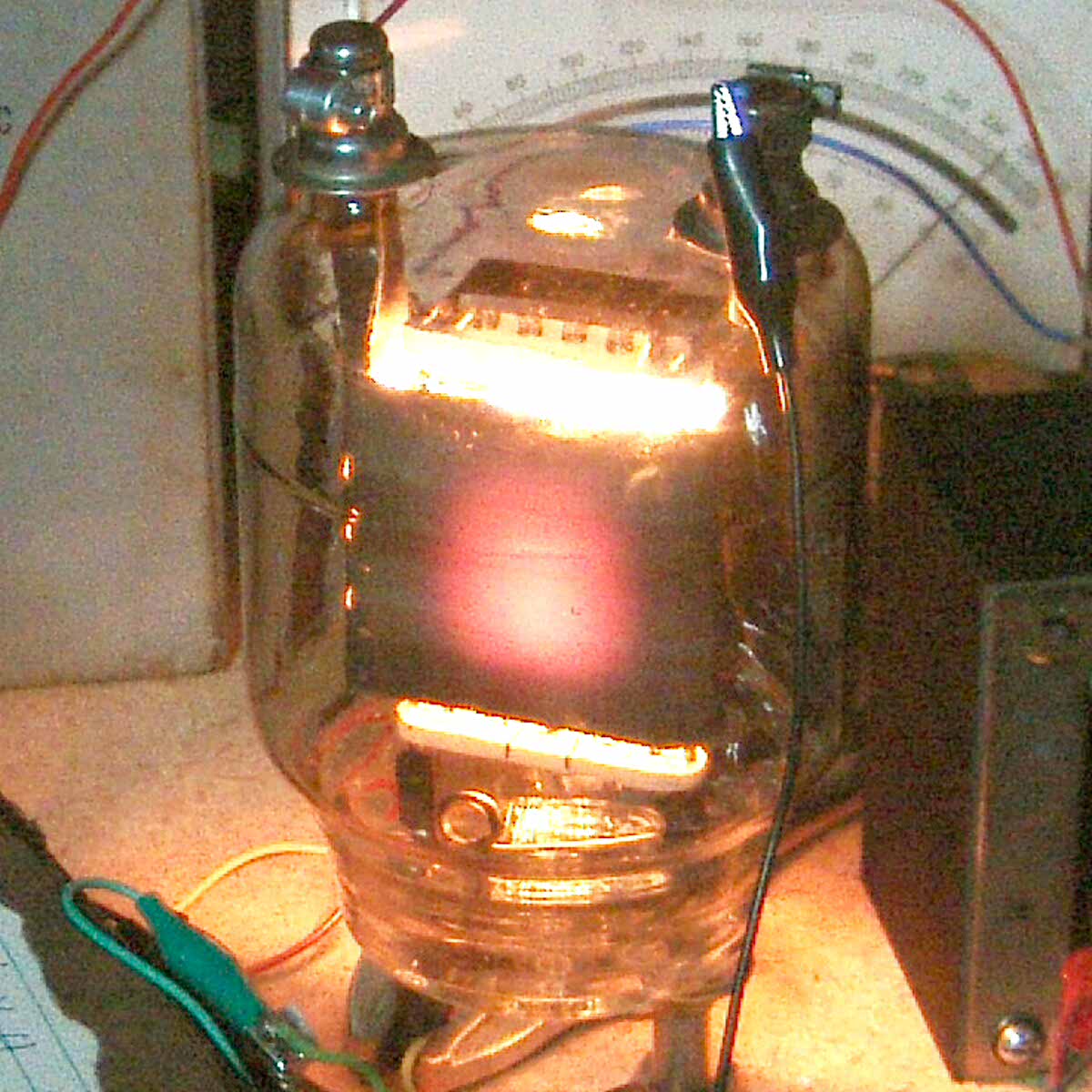

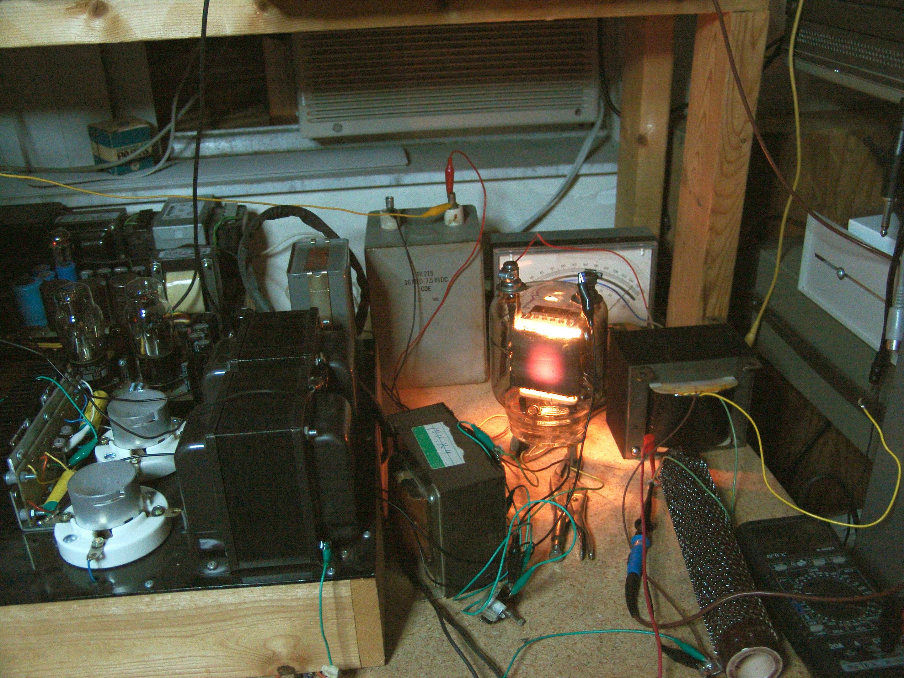

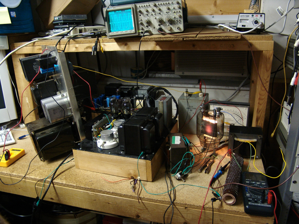

The guts inside an 833A can take some heat. The metal to glass seals at the pins are the weak point. I would advise some airflow. It wouldn't hurt the tube, but everything around the tube will get hot from the IR those guys put out. You can feel it from several feet away. Of course I was running mine pretty hard, 1500 volts and 275 mA.
Note that this was a breadboard test amp cobbled together from a Motorola power supply from an old tube transmitter (1500V, 500 mA), my 845SE amp, a 10 volt transformer with 4 X 10 amp windings, a custom OPT, a small bench power supply, and a big cap from an old cardiac defibrillator. It existed for about a week and for all but a few pictures there was a thick Lexan shield between me and the amp. Extremely lethal voltage with Vise Grip, hose clamp, and Radio Shack clip lead construction is definitely not a safe environment.

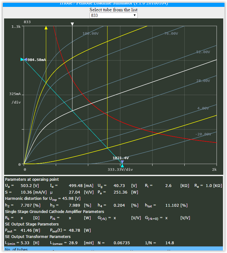

why not try 500v at higher current with 833?
It would probably work, but the maximum rated continuous plate current is 500 mA. The maximum rated continuous rated continuous plate dissipation for the old style (not graphite plate) 833A is 400 watts, this puts the plate voltage at 800 volts to be capable of reaching the maximum ratings.
Maybe something like this?
~1K output transformer (1.1 * 950V)
Biased at +50V, putting the tube at 500V / 500mA
Pd ~ 250W (I wonder if that would get the plate hot enough?)
I wonder how this would sound?.. Would be neat to try since you could get away with an easy power supply. Though I don't imagine 1K / 500 mA output transformers are overly easy to come by..

1K/500mA=2000ohms Rp
Rl would have to be much higher around 4K or more.
10K Transformer should work the same.
I saw that vise grip holding the tube and I would be scared to come near you. I have a few 10V 17A transformer for the filament duty.
