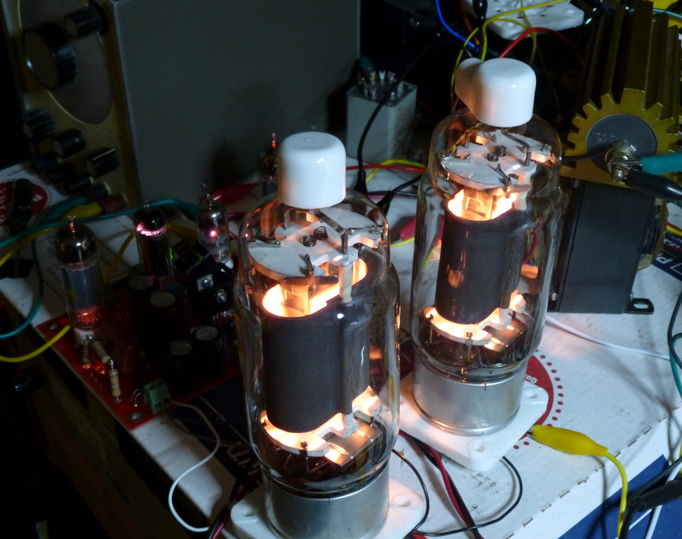

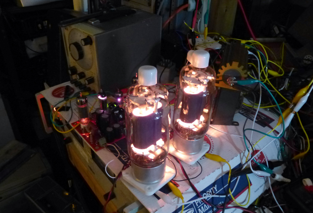

I tested the 813's at the upper limit of my bench power supply which is 650 volts. I tried triode and pentode configuration with a 5000 ohm, 6600 ohm, 10,000 ohm , and 13200 ohm load. The most power I could get was around 35 watts with a 6600 ohm load. I can do that with 6L6GC's. Game over, tubes sold.
Pete Millett built a single ended (one tube per channel) 813 amp that ran on 800 to 900 volts. He gets about 20 watts at clipping and around 10 watts at 1% distortion. Details here:
813 SE triode amps
A decent amp with 813's to get over 100 watts per channel will require over 1000 volts of B+ and still need a rather high impedance OPT.
A couple pictures from my 813 tests are included.

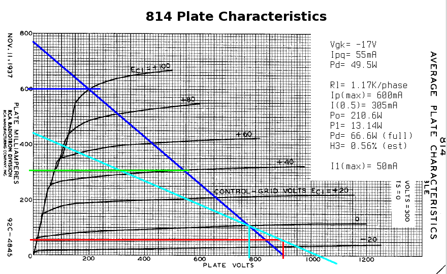

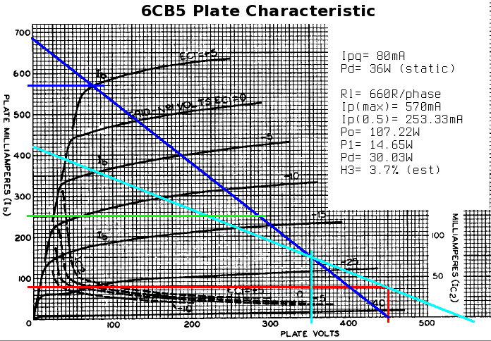

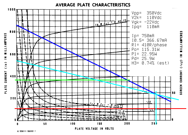

813s are RF finals, and should be reserved for RF experiments. If he doesn't want to do that, then sell 'em and use the proceeds for types better suited to audio power amplification. Hams will definitely want them. Getting 100+W doesn't require extreme voltages and load resistances. (attached).
6CB5: This one gets past the century mark for less than half the voltage, and with a pretty good h3 estimate. Tone it down a bit, and you improve that estimate, though you drop below 100W.
6LW6: Easily gets past the century mark with very moderate voltages. h3 estimate looks very good, and that's without doing anything weird like screen drive. Evenn though the 6.3V version is rare and expensive, there are lots of variations with odd heater voltages that are neither rare nor expensive.
814: Does better than 200W, though requires a higher plate voltage (but still under 1.0KV). another RF final that will need to go into Class AB2, but has some good lookin' h3 estimates. Will need a good grid driver as this one will pull grid current. Possible problem as the operation will be deeply into Class AB, and that could mean x-over.

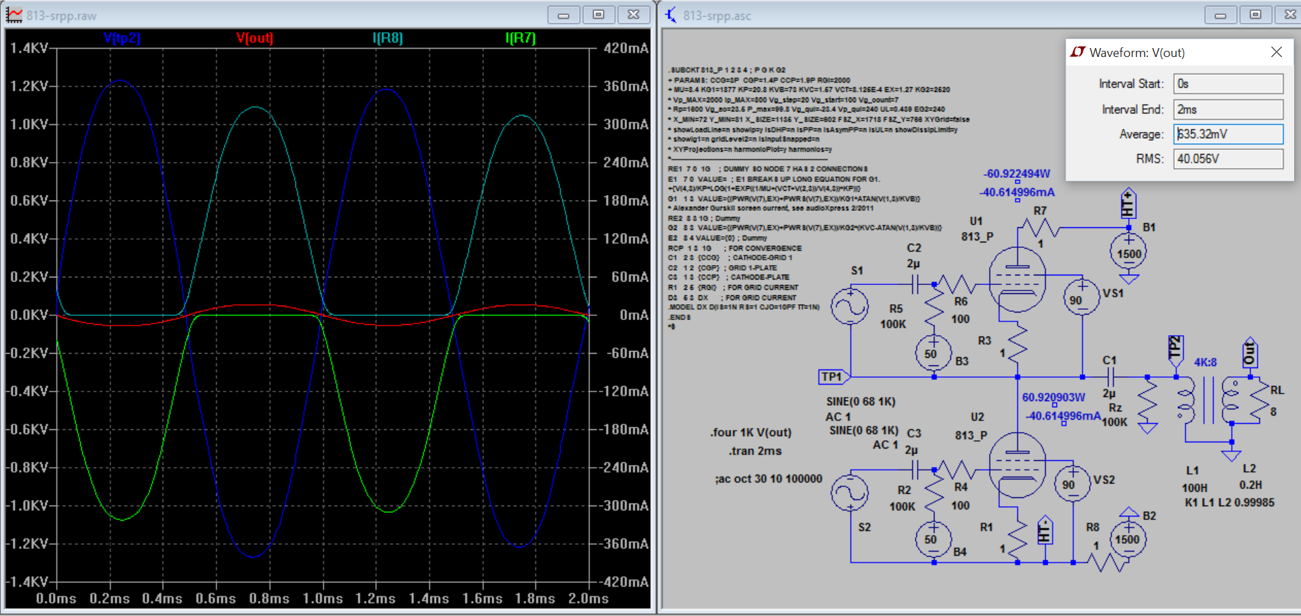

How about configure output as SEPP? Can drive electrostatic speaker directly and if transformer is used, the restriction is much relax. 100W @1.3% THD, when HT is +-2KV, output go up to ~200W
The supply is limited to +2KV AFAIK, for 100W, why even bother using the 813's as the others have already mentioned... Gotta go big or go home.😀
If you build with conventional PP (ie non ultra-linear or zero feedback) you have incurable transient distortion. Your circuit you post is of date, in the day when neither ultra-linear nor Williamson was invented, so get real.
Take it easy, man. No disrepect was intend for your sim, please read the spec's on the Altec before you poo-poo it, "incurable transient distortion", really? Neither UL (now that's a can of worms) nor Williamson topology was needed to make a decent amplifier despite what some may think.
