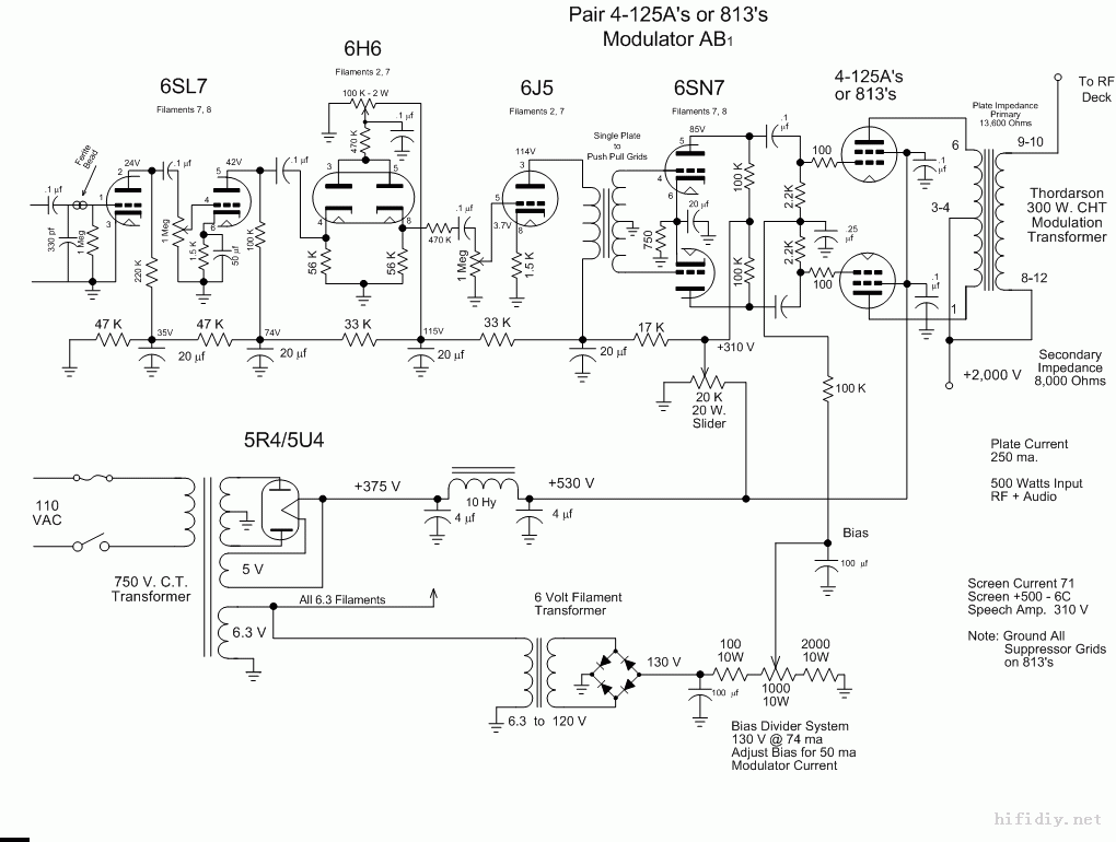

Assuming the OP has to use the PT with B+ around 2kV, where would he even find a OPT that has the high primary impedance and the high power capacity required? I assume this one has to be a custom job and likely cost $$$ to get one done...
A decent amp with 813's to get over 100 watts per channel will require over 1000 volts of B+ and still need a rather high impedance OPT.

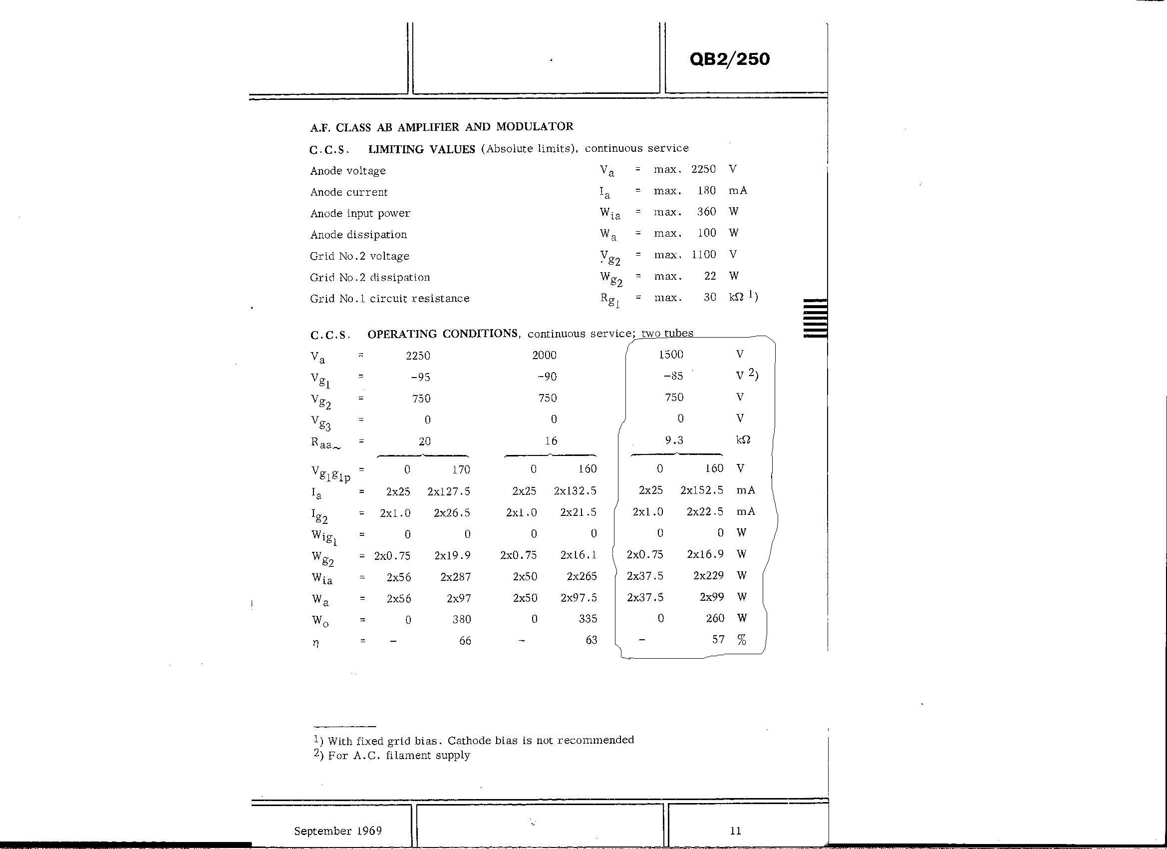

813s are RF finals, and should be reserved for RF experiments. If he doesn't want to do that, then sell 'em and use the proceeds for types better suited to audio power amplification. Hams will definitely want them. Getting 100+W doesn't require extreme voltages and load resistances. (attached).
6CB5: This one gets past the century mark for less than half the voltage, and with a pretty good h3 estimate. Tone it down a bit, and you improve that estimate, though you drop below 100W.
6LW6: Easily gets past the century mark with very moderate voltages. h3 estimate looks very good, and that's without doing anything weird like screen drive. Evenn though the 6.3V version is rare and expensive, there are lots of variations with odd heater voltages that are neither rare nor expensive.
814: Does better than 200W, though requires a higher plate voltage (but still under 1.0KV). another RF final that will need to go into Class AB2, but has some good lookin' h3 estimates. Will need a good grid driver as this one will pull grid current. Possible problem as the operation will be deeply into Class AB, and that could mean x-over.
How about configure output as SEPP? Can drive electrostatic speaker directly and if transformer is used, the restriction is much relax. 100W @1.3% THD, when HT is +-2KV, output go up to ~200W
The supply is limited to +2KV AFAIK, for 100W, why even bother using the 813's as the others have already mentioned... Gotta go big or go home.😀When HT is +-2KV, output go up to ~200W
