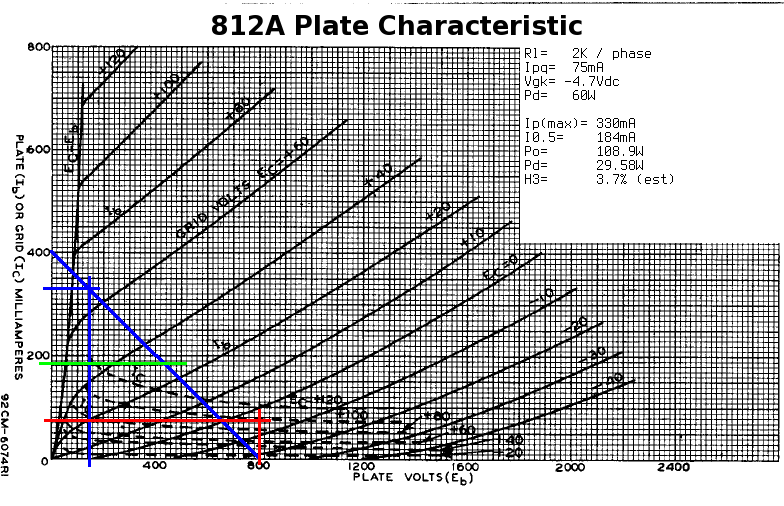

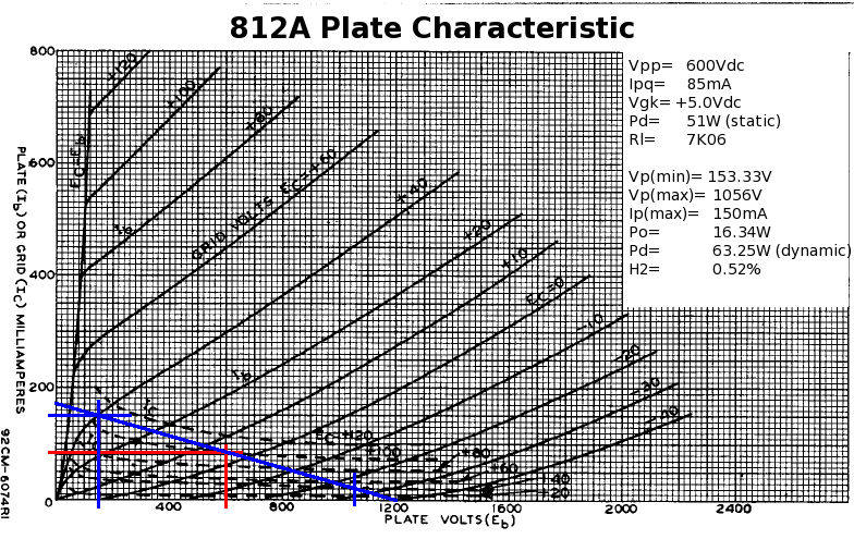

I drew up a PP loadline for the 812 (attached). Since RL= 2000R per phase, you would need an OPT that could match 8000R to your secondary load. The h3= 3.7% estimate is looking pretty good. As for how this actually sounds, that would depend on the actual harmonic profile of the distortion in practice. You probably don't need more than enough gNFB to take the edge off.

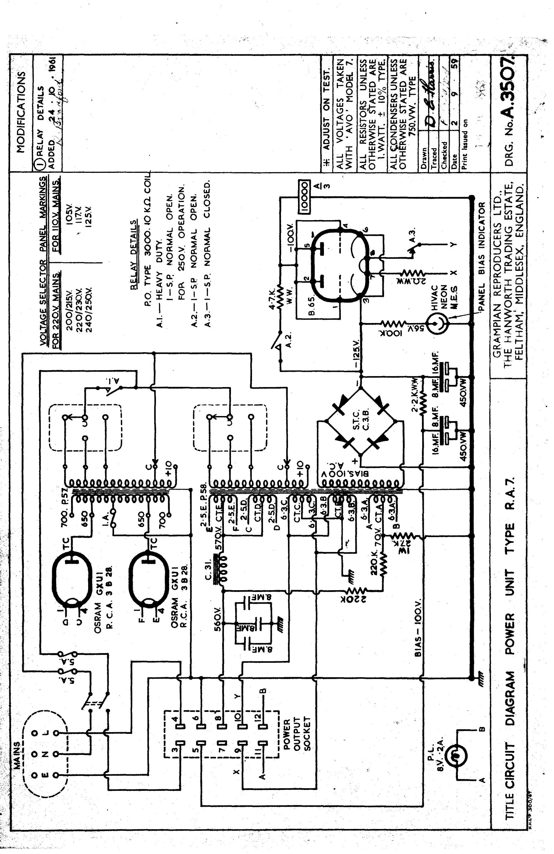

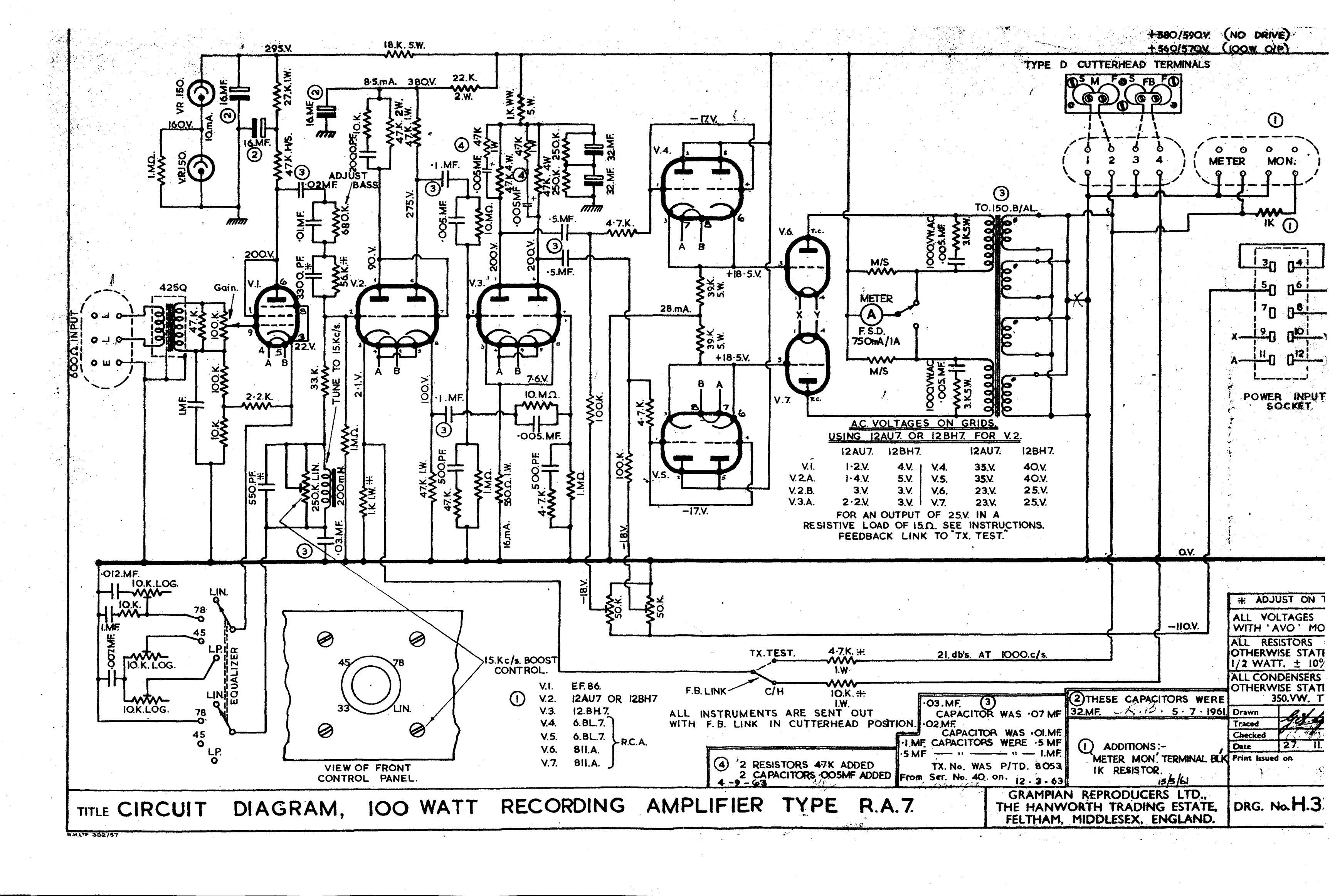

Hi, I know this is a little off topic, but not by much... Linked is a schematic for the Gotham PFB-150 cutter amp:
http://www.vintagewindings.com/gen pop/8299543VW8335/ProAudio1/Gotham PFB-150 Cutting Amplifier.pdf
I knew about the PFB-150WA amplifier, made to link up with the Grampian cutter head, but Gotham also made the PFB-150WD version of this amp which was made for high fidelity music reproduction. Both used a General Radio torroidal output transformer which can be configured for several primary and secondary impedances.

I used to think this amp used the output transformer configured for 6600 ohms primary linked to a push-pull pair of 811A output tubes but in actuality, the output transformer in these amps is configured for 1650 ohms primary impedance for the pair of 811A tubes. This seems very low for 811A tubes, even though they are operating in class A2. Can anyone shed any light on this? Thanks...

Gain, gain, and more gain, then lots of feedback to round things out.
I have one of the C core output transformers made for the Grampian cutter head amp I checked it and also sent the readings to Sowter in England the plate to plate worked out as 2.200ohms P To P.
