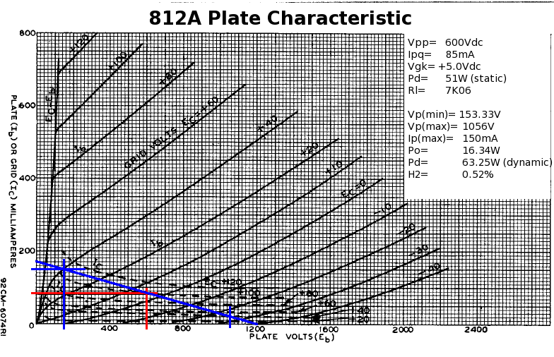

How do you get enough plate current without positive grid bias? I had to have Vgk= +5Vdc to pull the necessary Q-Point bias. (Loadline, attached) It is, after all, a rather high-u VT, even if not nearly so high-u as the similarly rated 811A.

Maybe I am looking at this wrong or most likely missing something, but with 800V B+ and considering losses in OPT, Cathode resistor, and error in manufacturing, it looks to be reasonable to have 0V grid for 80 mV of plate current
With zero bias, or even a little negative bias that driver circuit isn't gonna cut it. The 812A starts to draw grid current at around -5V. Cap coupling is a recipe for disaster. Add a FET follower and it would be fine.

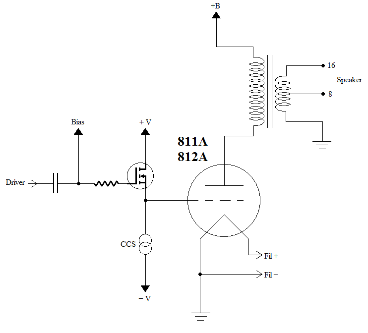

I saw another circuit on here for an 811A that was basically a 6SN7, into a 6V6 (CF), then into the 811A. I may look into that config as well.
Here it is

You have to look at the plate curves first. The 811A and 812A bias up at different points. Just use a FET follower and you will be able to drive the grid anywhere you want it.
