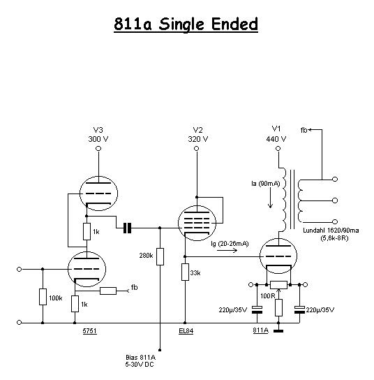

First try
Hi all,
This is going to be the (first) tryout for my 811A-class A2 amp.
Any comments are very welcome !!!!
Greetings
Jim

I think that the problem is probably a mistake on the circuit diagram - it shows Ig at 20-26ma, which implies a voltage of over 660 volts on the grid of the 811A, obviously impossible! With a current of only 1ma passing through the 33k resistor that would give a voltage of 33 on the 811A grid, a much more reasonable figure.
Re: Class A2 !!
jim said:
Hi all,
The 20-26mA flows into the grid of the 811A,
just as the arrow indicates.
The anodecurrent of the EL84 splits into 20mA for
the 811A and approx. 1mA for the 33k resistor.
Jim
When you've got it running, try a CCS as the CF load. I think it's perfect for this application, and will likely result in lower distortion and more stable bias under dynamic conditions. One of Gary Pimm's BBMCCS would be what I'd try.
{added later} Or (read Kimmel's article below, and) run the EL84 as a pentode CF.
