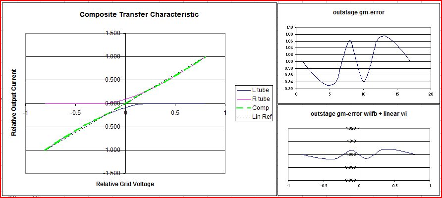

They're not. The pic is of the result of subtracting the input from the output with an op-amp linear subtractor. What's left is the difference (i.e. distortion). It's not a complete null due to phase shift at the test frequency (166Hz). The "little fuzzies" are the result of one side of the PP pair handing off to the other side, as one final goes into plate current cutoff. If you aren't using a linear subtractor, you can't see anything by o'scoping either the primary or secondary, and there are definitely no RF parasitics. ("Snivets" are quite obvious.)
This occurring with 6BQ6s biased to Ip= ~50mA (biased hot: ~17.5W of static Pd -- spec busting as Pd(max)= 12W according to the spec sheet. Since these were originally designed as HD finals, the ratings are very conservative, and so spec busting for audio final operation does no harm.)
I observe the same.
I have a breadboard with a high leakage OPT, on which I can twiddle the bias settings and move the turnoff glitch nearly up to the peak of the sine wave. It doesn't take much overlap because my driver is trying to stretch out the turn-off. In doing so, it simply moves the glitch around, but doesn''t eliminate it.
I'm convinced that there needs to be cross-coupled differential feedback or someting to control the turning-on side to completely eliminate this.

The differential feedback might be of some help for limiting the glitching by smoothing the transition of current, but I think one is still faced with the fundamental problem here that the turning off tube has no transconductance left at low currents. So any feedback is loosing control at the final cut-off. Perhaps one could limit the grid signals to the tubes such that they never quite turn off, a diode limiter for each tube grid of some kind maybe.

PS For me, there is not much practical difference between class AB (current flow appreciably more than 1/2 the cycle) and class B (plate current "nearly" cut off) because I find that there is a particular point in the overlap where the crossover distortion due to the combination of 2 tube curves is optimized. The attached graph shows a 3/2 power approximation to illustrate, but real valves deviate from the 3/2 power curve at low plate currents and need to be measured. To my mind, the only thing huge conduction overlap buys you is delaying the occurence of the turn-off glitch.

OPT leakage inductance stores some energy which is released as a reverse voltage spike when the tube driving one side of the OPT stops conducting. The greater the leakage inductance (less perfect coupling to other windings) the greater the spike.
With local differential feedback there is a special side effect:
This spike (glitch) confuses the local feedback system into trying to compensate by increasing the conduction of the tube which is in the process of taking over driving. The fed-back glitch fools the turning-on tube into thinking the other tube has gone beyond turn-off and is now sinking current, causing the turning-on tube to source even more current to compensate. The result is an anti-glitch at the output. I may have some scope pics somewhere...
