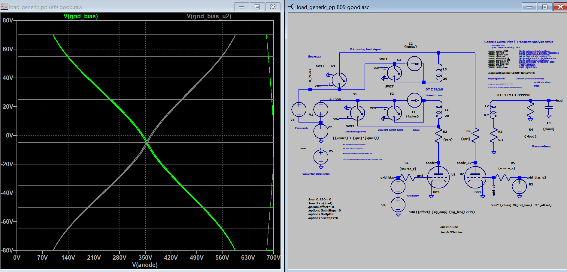

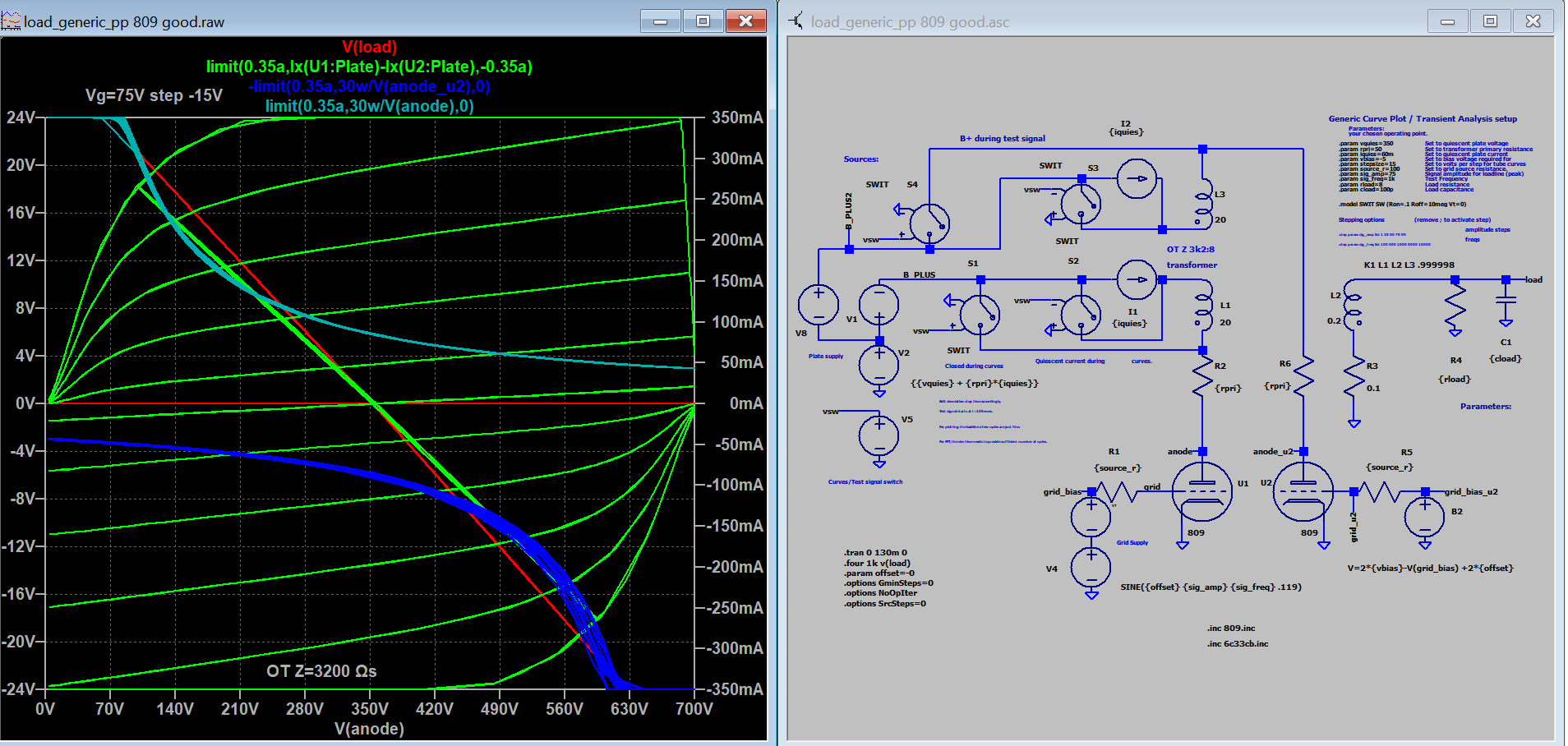

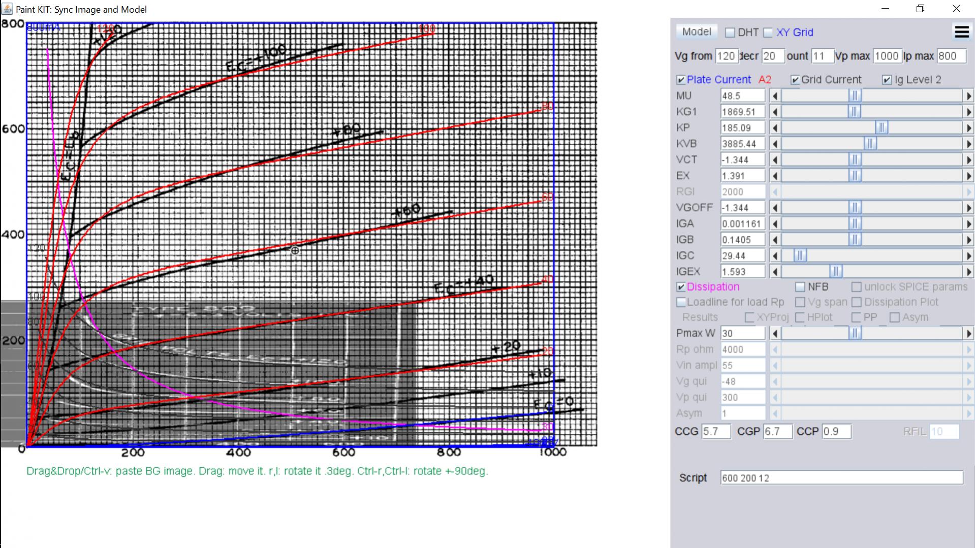

There is only one pp schematic on the net which is a modulator. After some researches and build model for 809, I come up up with these data:
OT 3200:8 (or double this if anode supply 700V)
bias -5
quiescent current 60mA
anode suppy 350V
grid swing +-75
output power 30W rms
Thd 3%
It is found that least distortion around zero bias (-5V), power is increased with higher anode supply but distortion also increased to >5% as grid swing beyond +-75V.
809 model:

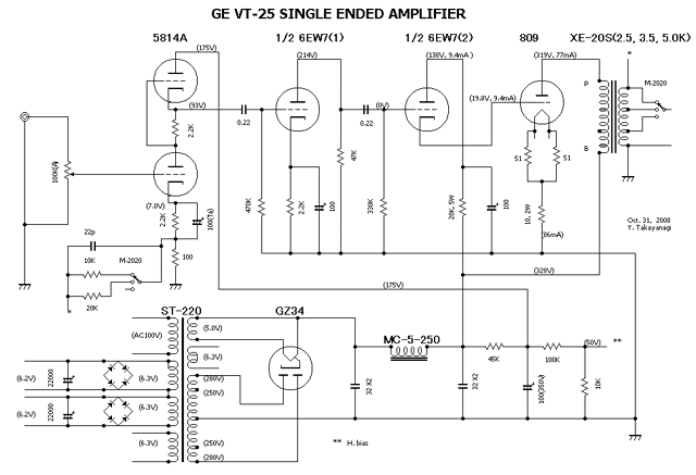

I found this one on a Japanese website, dont have any 6EW7, will probably use something with a plate cap like 807 for the positive grid bias. There was gentleman on here called "multi" who passed away who was a fan of this tube, I wish I could have talked to him.

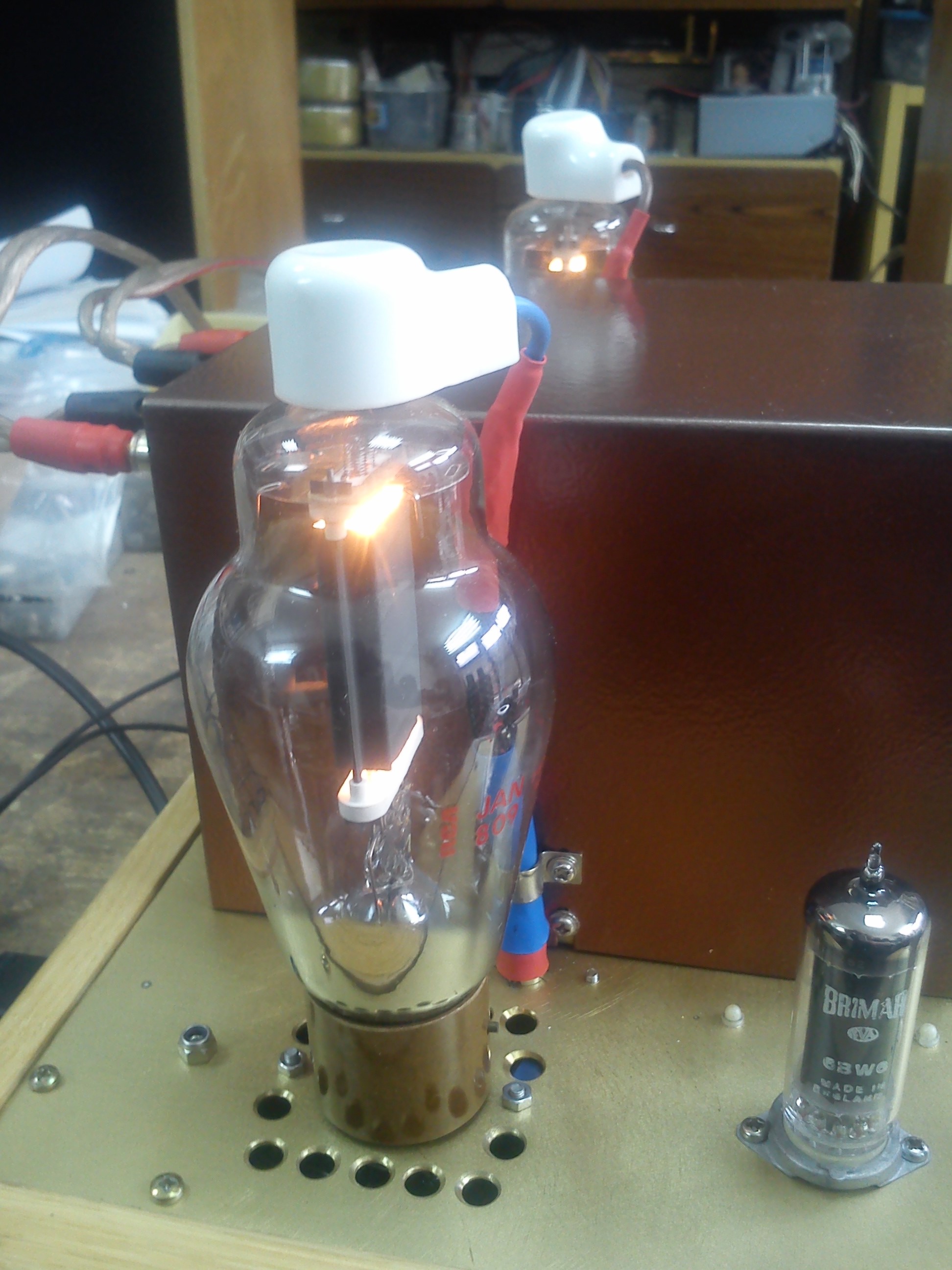

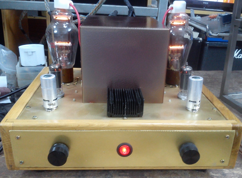

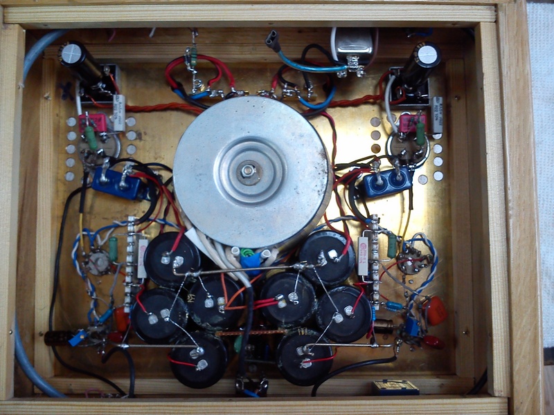

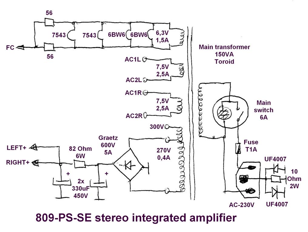

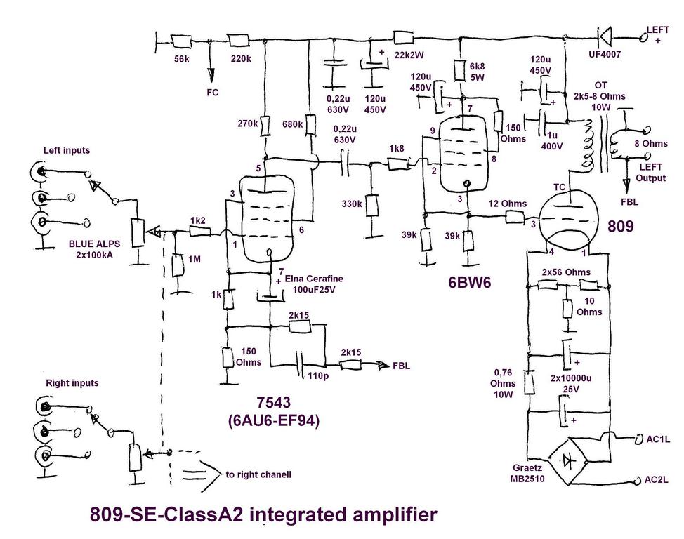

Back in 2013, I made an 809 SE-amplifier in class A2 with a tube, but the connection is also applicable for an push-pull amplifier with the necessary modifications.

So I was thinking about using the above schematic (6EW7), but using an interstage TX for the phase splitter. Any issues with having the interstage TX in the GNFB loop? Also not sure if I like the 12au7 input.
The 680K resistor on the 6AU6 screen needs to be bypassed to the cathode.🙂
Hello davorin,
I'm trying to understand the way the 6BW6 is driving the 809. What is the voltage on the grid of the 809 without signal? Am I correct in thinking that the grid of the 809 never goes negative with respect to ground since the cathode of the 6BW6 can't go negative with respect to ground?
