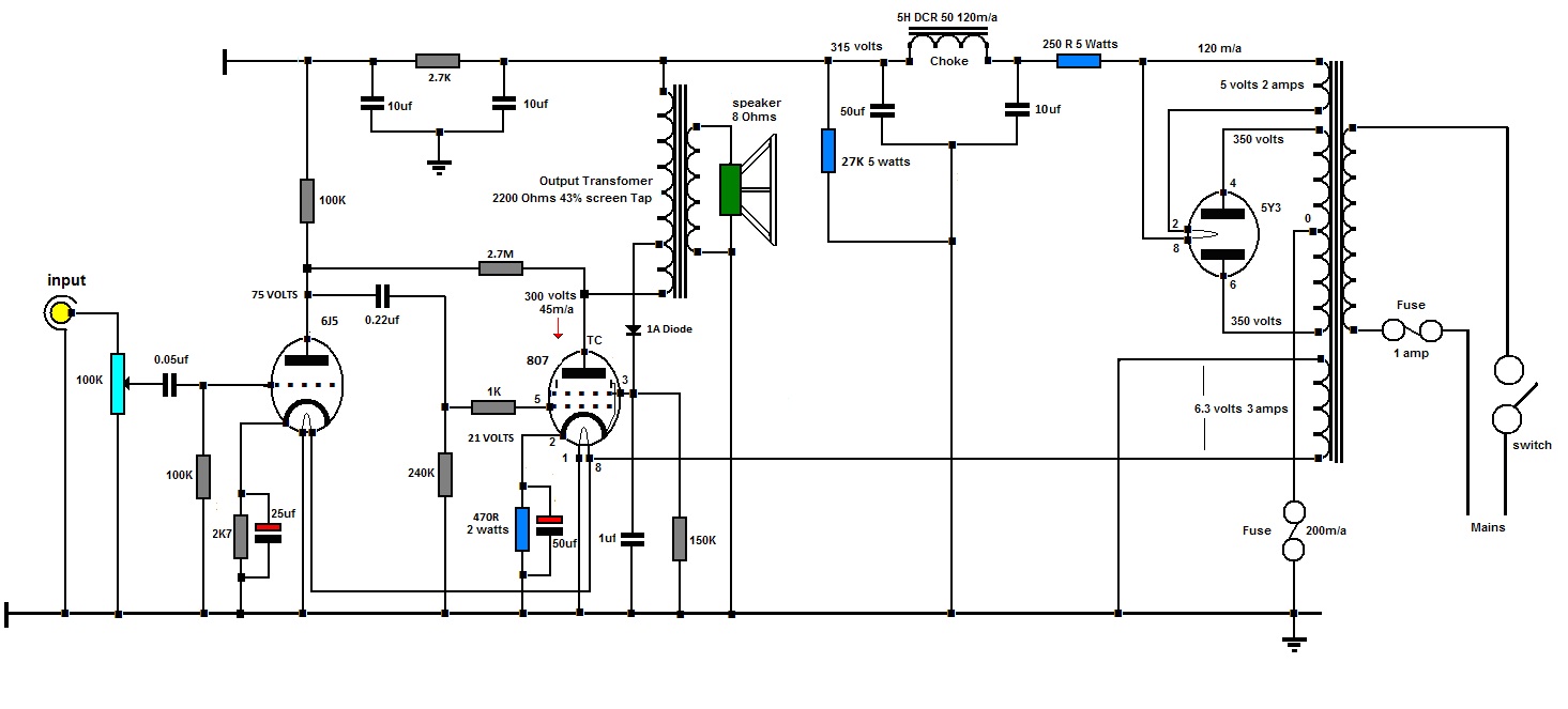

Well life is full of surprises. I am or used to be a die hard Push Pull Amp guy, that was until I made an 807 SE amp (5 watts, no NFB) for a friend. Long story short I am stunned at how good it sounds......I am not sure why !!!! I would like to think it has something to do with the circuit I designed (????) or more likely just the simplicity of SE amps. So now I am in a dilemma since I was about to embark on the building of my own PP amp next month. I need to think it through, is SE the way to go I wonder ????????

Attached is the Circuit Diagram

Thank you for the simulation...you are of course correct. On the original design it was noticed that certain diodes generated noise and the cap was used to suppress it. That said on the actual finished article I played around with different diodes and found some that were quiet and did not need any filtering. The circuit I posted shows the cap in circuit when it should have been omitted.
This is the simulated frequency response of the above circuit.
Without 1 uF capacitor from screen grid to ground the response is fully flat.
This is the circuit diagram I used for the simulation:
