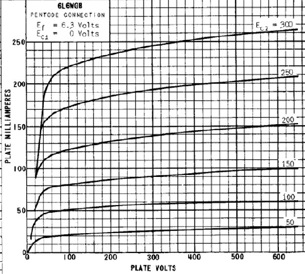

Lots of advice. But pentodes in general are very much dependent on the plate & screen voltages to arrive at the optimum load impedance.
For maximum output at any plate voltage the output load impedance is dependent on the screen voltage used.
That becomes obvious when one looks at the plate voltage curves for Zero grid one voltage while the screen voltage is varied.
The ends of the loadline need to go up into the knee of the plate current curve. Otherwise max power is compromised
& screen dissipation increases when large signal occurs.
Curves for the 6L6 are here. The 807 is a 6L6 with a plate cap & a 5-pin base. That's All. 🙂

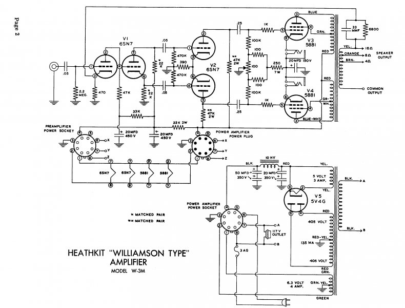

There were literally thousands of DIY 807 Williamsons built in the early 50's. I've personally restored early 807 Williamsons with the original 807s still in good condition. There's ample documentation that with 400 volts across the tube, the screens hold up fine in either triode or UL mode. I wouldn't exceed that, but there should be no problem.
Perhaps the many schematics of the Williamson amplifiers that have output tubes such as the 807 and 6L6, are because of the vintage of Williamson design and the vintage of the 807 and 6L6 family design,
The KT66 is also used, because it has very similar characteristics as the 807 and 6L6 family.

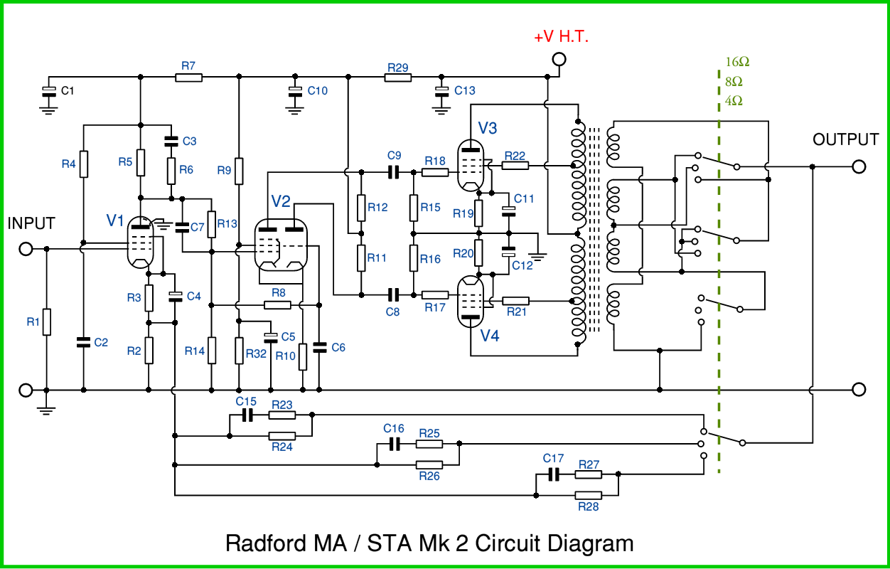

The article you included in post #10 is, in fact, very close to a Mullard-type design, with a pentode voltage amplifier and a long-tailed phase splitter. It's a bit simpler than a Williamson, but since we don't know the ouput transformer used, it's still anybody's guess as to how well the Sowter will work. When those articles were written, it was a given that a competent DIYer had a 'scope and other analytical tools at hand, and could order a Triad or a Stancor or a Chicago or what have you, and tune the circuit accordingly.
Just about any PP amp using a beam power tube or pentode is going to need feedback to some degree. I've seen no-feedback 6550 designs, but I assume that's possible because the plate resistance is so low. The 807 in triode operation will have a plate resistance of about 1700 ohms. That's pretty high for a no-feedback amp. A quick search for PP 807 amps yields nothing that doesn't call for feedback, but there might be something out there.
I'm not saying you can't experiment, of course. But you have some very nice OPTs there, it would be worth learning how to build a quality amp with them.

The Heathkit W4AM is basically a slightly modified Musician's Amplifier with added stability measures and an updated power supply, as were all the Heathkits up to the W5. The schematic is easier to read. This is actually what I pretty much use now. The only thing I add is 15 ohm test resistors between the output tube cathodes and the main cathode resistor, to make it easy to balance the output tubes with an ohmmeter. The feedback values won't be the same, and the input cap isn't necessary with modern preamps, but the rest of the circuit is pretty much a standard Williamson.
http://www.tubebooks.org/file_downloads/W4-AM_Manual.pdf
This is a key learning. And just for clarity which exact area in that graph is the "Knee"? Pardon my ignorance.<<For maximum output at any plate voltage the output load impedance is dependent on the screen voltage used.
The ends of the loadline need to go up into the knee of the plate current curve. >>
