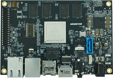

The AM5748 is a brand new chip, and the only System-on-Module I could find with it is the recently-announced Lenovo Industrial Intelligence Development Board: Super Edition. It has the following features:
- 2GB DDR3L 1333 high speed memory
- 16GB eMMC high speed storage
- 2 Gigabit Ethernet ports

Interestingly, by switching from an AM5748 to an AM5728, we just lose two Gigabit Ethernet ports, but we gain the ability to source a System-on-Module today that would fit within our bricks (55mm × 45mm): the phyCORE-AM57x. I do not know the price of this module yet, but a similar one goes for $96. And the beauty of the design is that such a relatively expensive module could be used with different tops. In other words, by splitting our bricks into two separate components, we make them a lot more modular, and we make the expensive parts usable for different applications at different times. Of course, one could also make a bottom with a much cheaper chip like a $1 ATMmega328. In that case, only a subset of the bottom-to-top ports would be populated, but this might be sufficient for a wide range of applications.

The bottom part would be connected to the grid through a USB port, using spring-loaded headers or some magnetic connectors. As originally envisioned, this bottom part could be mounted on the grid in any orientation. The top part would contain the brick's logic and controls, now including things like ADC or DAC converters. The interconnect between the bottom and top parts would provide a mix of pins (single orientation):
- One or two USB ports
- Up to four SPI ports
- up to 16 GPIOs
- Various power levels
- Ground
Then, according to this design, we can move the ADC and DAC converters into the tops of bricks. For example, the Khadas Tone Board is an excellent open source DAC and is only 82mm × 74.5mm, including three RCA connectors. Therefore, I believe that we could make a version that would fit into a 60mm × 60mm brick and put two of these boards on top of each other, thereby enabling a 4-channel audio output brick. And with a bit of luck, we should be able to do the same for audio outputs, thereby offering 8 inputs and 8 outputs on a 2 × 2 OTO surface.
With such a design, the ADC or DAC converters mounted within brick tops would be connected to the brick bottoms over USB 3.0. As a result, we would have a very clean decoupling between audio input, audio processing, and audio output, and we could use off-the-shelf ADC and DAC boards initially, while we focus on the core OTO form factor. Of course, I still want my AK5578EN 32-bit, 768kHz, 130dB ADC and my AK4499EQ 32-bit, 768kHz, 140dB DAC, but these could come a bit later.
I must say that I like this design a lot more than the previous one...
