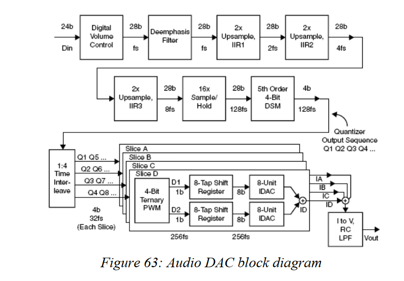

Modern converters are all clocked from MCLK directly and the I2S data is probably clocked into shift registers / buffers. I don't see how levels of jitter that don't violate the setup and hold timing or something crazy like that could have an impact on those signals since they aren't the conversion clock.
As far as I am aware most modern converters use the bit clock as the timing reference, as far as jitter is concerned, for the conversion of data from A>D or D>A.
The master clock itself is only used to allow the oversampling of Delta Sigma parts to function. Most chip manufacturers state that the master clock needs to run synchronously to the other clocks but the phase relationship between them is not important. Data transfer and audio timing is managed by the rate of the bit clock.
This only applies to an ADC operating in slave mode though. If the ADC is operating as a master then you only need supply it with a master clock and the chip will generate everything else.
Some DACs, mostly the ESS parts, have built in ASRCs that reclock the data to a provided high quality master clock. This eliminates jitter problems that would ordinarily occur from high jitter being present on the incoming bit clock, or any other incoming clock, but the flow of data is still controlled by the incoming bit clock.
Given the system at hand the master for all data flows should ideally be the USB interface. It would therefore take two low jitter master clock sources, such as the NDK parts, one for 44.1k base data rates, one for 48k base data rates and their multiples.
The USB interface would then produce buffered master, bit and LR clocks, plus the relevent data lines. These would then interface with the DSP core or be sent directly to the audio converters.
For example if going to a DAC the data would first pass through the DSP before being converted. But if going to an ADC, the master clock, bit clock and LR clock would be fed directly to the ADC. The ADC would then output a data stream and this, along with the bit and LR clock would be fed into the DSP, for processing, before the data line be fed, from the DSP, into the USB interface.
If the system of this thread is only going to use analogue inputs and outputs then you're done as the data rates are all handled directly by the USB interface and everything is synchronous from bringing to end. The problem occurs when you want to add in digital inputs. Outputs are fine as they are just slaved to the internal clocks (connecting a SPDIF transceiver, instead of a DAC, to an output data line is essentially the same thing). But inputs come with their own timing/clock and require special attention. Realistically though the answer is simple you have to use an ASRC on the incoming digital data stream then use one of the USBs digital input data ports as the master for the signals that the ASRC reclocks to.
The critical clock is definitely MCLK for every single delta sigma part. It wouldn't even be possible for the part to function if the conversion clock was BCK. If you find or look at detailed enough block diagrams you'll see this. I'm not sure what would lead you to believe the bit clock is of any importance? It is only important in cheap parts that do not have an MCLK input and recover it via PLL or in obsolete DACs like PCM1704.
In such a complex system as this, it is probably best to have an I2S master in the FPGA and everything else that can, including the USB interfaces, operate in slave mode. Obviously, SPDIF inputs can't operate like this and will need a PLL, FIFO, or ASRC to be synchronized with the clocks in the box. I already described, perhaps in different words, the need to bridge clock domains for digital sources that come with their own master clocks. You don't absolutely have to use an ASRC to do this.
Just as an example, this attachment is from an early 2000s Cirrus Logic ISSCC paper describing some unknown delta-sigma audio DAC design. You can see that the converters are actually clocked at 256*Fs, which is higher than the bit clock will ever be, and a typical value for MCLK.
In such a complex system as this, it is probably best to have an I2S master in the FPGA...
The I2S master will indeed be in the FPGA.
And yes indeed, I want the system to be able to mix both analog and digital inputs, and the latter will need to be synchronized somehow. I am still digesting what you sent earlier on that topic...
Thanks!
As far as I am aware most modern converters use the bit clock as the timing reference, as far as jitter is concerned, for the conversion of data from A>D or D>A...
Thanks a lot for all this. Super helpful!

No problem. You can basically slave the USB receiver if you have one and the network audio stuff, I think. Those can or do operate asynchronously and control flow via feedback to the host. So you can have the XMOS be an I2S slave and not worry about dropouts or clicks or anything.
For SPDIF, AES, ADAT, HDMI, etc there is no opportunity for feedback, so they have the clock encoded with the data and those receivers recover it. You don't really want to use the recovered clock directly (if you want state of the art performance) in many cases because it can be very jittery. ASRC's like the AD1896, SRC4392, AKM version, etc. will attenuate that jitter with a DPLL that has a very low corner frequency. Alternatively that CS2100 I think works like some of the TI jitter cleaners for LVDS.

That makes a lot of sense. I will look into the different options for an ASRC. If you were to build a statement device, which one would you pick?
Yes I am aware of that and jitter on the master clock is important for proper DAC operation and performance. But the data flow and data clocking is all synchronised to the bit clock/LR clock.
It has to be, by its very nature the data that encodes the analogue waveform is stored and retrieved by the rising edges of the bit clock. When a complete sample has been received the DAC process it and outputs it. The timing of the successive samples comes directly from the bit clock and nothing else.
DSPs don't even need the audio master clock to function. They need their own internal processing clock for data manipulation (very much like their own master clock) but the data itself is clocked in and then out again via the bit clock.
The master clock isn't needed for audio data or audio timing this is all present in the data stream, the LR clock and bit clock. Jitter within these appears on the output of a DAC because these are precisely what controls the flow of data.
The master clock in DS converters supplies the oversampling sections with the high speed clock required for device operation but the flow of data within them beats to the rhythm of the bit clock.
Of course the master clock needs to be low jitter too otherwise jitter introduced to the oversampling sections will appear on the output. But jitter present on the bit clock and data stream are very relevant.
TI say in the datasheet for the pcm1792a
In other words the LR clock (and by extension bit clock and data stream) needs to run at an exact division of the master clock with regards to frequency but not with regards to phase. This means the DAC doesn't need the rising edges of the master clock to coincide with the rising edges of any of the other clocks. As a result none of the timing of the audio data is tied to the master clock and it's tiny changes within the timing of the data samples on the rising edges of the data/LR/bit clock that results in jitter on the output of the DAC.
In fact all ASRCs and the jitter eliminator within the ESS DACs are about getting rid of jitter present within the data clocks and not the master clock. They don't even need the master clock of the original data line to function because it serves no purpose.
In ESS' white paper on their sabre DACs, towards the end they say this...
This has nothing to do with the master clock as they are showing how effective the ESS part is at removing the jitter present on the incoming data line. And without that jitter removal, no matter how jitter free your master clock might be, if there's jitter on the data clocks your DAC performance suffers.
Old multibit DACs didn't need a master clock because they didn't oversample the data they just ran at the rate of the data itself. They were however susceptible to jitter present within the data clocks, they had to be these were the only clocks they used and jitter didn't just vanish as a physical property because they didn't use a master clock.
DS are more susceptible to problems with jitter precisely because they use a master clock. They will show performance degradation towards jitter present on both the master clock and the data clocks. But, as far as I am aware, are also worse at suppressing jitter present within the data clocks than multibits were. A guess would assume this is because of the oversampling process where small timing/jitter issues in the data clocks are magnified by the oversampling process and then modulated by any jitter on the master clock.
All clocks need to be jitter free.
As to what hardware part operates as the master device. The DSP doesn't make much sense. The DSP processing core will most likely run asynchronously to the actual data clocks anyway. Typically a data byte will be clocked into the DSPs front end. Upon receiving this the DSP will process the data byte as fast as possible and then present it to the DSPs back end. When the next LR clock pulse comes along the data is clocked out with the rising edges of the bit clock. Of course the DSP can delay the outputting of the data by X sample periods if necessary (for delay stages) but usually a DSPs audio capability is determined by how much data is can process in one sample period, be it 44, 48, 96 or 192kHz. Once the processing would take longer than one sample period you've gone beyond what the DSP can do in real time.
Data processing in the DSP core runs at the rate of the DSPs internal clock, most likely from an internal PLL and at many MHz maybe even GHz. It has no relationship with the audio clocks, except for the fact it starts number crunching the instant it receives an audio data byte. It has no use for an audio master clock itself and its internal clock jitter has absolutely no bearing on the jitter on its output because that is clocked and timed to the LR/bit clock.
If you wanted you could provide the DSP/Xilinx chip with two high quality audio master clocks, one at 44.1k and it's multiples then one at 48kHz and it's multiples. Then have a part of the Xilinx chip work on clock generation. This would then feed the USB interface, DAC, ADC and DSP audio data input/output, but it would need a lot of interfacing between the USB interface and the Xilinx chip. You would also need bespoke USB interface code.
Having worked with a Cmedia asynchronous USB interface using it as a slave just seems like a massive mess. The chip itself has different audio input and output blocks such that you can have one DAC running at 44.1k whilst another runs at 96k, as well as having one ADC going at 192k and another at 88.2k. This is all at the same time. The operating conditions for each input/output block is handled via software via the operating system and is controlled by a software/hardware combination onboard the Cmedia chip.
With the USB interface acting as a master it takes the two high quality clocks (44.1 and 48k multiples etc) and generates all of the required clocks for whatever you want the chip to do. It's been designed specifically for this task and slaving the DSP audio input/outputs to the USB interface is just as easy as slaving it to clocks generated on one of its arm cores.
Slaving the USB interface to an external clock generation source within the Xilinx chip sounds like a nightmare, you'd need multiple clock lines for each input/output module along with communication between the USB interface, Xilinx chip and the operating system. I mean if the OS requests a sample rate change the USB interface needs to change its settings but the Xilinx chip needs to alter its clock generation settings to match too. Plus making it all work with ASIO.
This seems like a massive headache Vs just having the USB module act as a master and with drivers that already work.
If you really wanted to push the boat out you could ditch a third party USB interface entirely and use the USB port on the Xilinx chip. Have one of the arm cores handle the audio communication with the PC. That can then act as the audio master and feed everything directly. This is both elegant and simpler, requiring fewer chips and making PCB routing less complex. But it adds in a layer of complexity elsewhere. USB protocols are a pain and if someone you know is good with them then writing drivers and your own USB code may not be that hard

Look, the critical conversion clock is MCLK for any delta sigma part that doesn't have an integrated PLL or ASRC. It is very simple and not really up for debate. The bit clock is only used to shift data into a shift register. I already showed you the actual D to A converters are operating above any possible bit-clock frequency. The data is BUFFERED and bit clock does not matter at all. You are misinterpreting what the datasheets say. How is the bit clock important at all when you need to assemble a full 32-bit word to feed into the oversampling filter, for example? The only clock that matters (unless you violate setup and hold) is the one that clocks the data into the analog domain, this is never bit clock on an AKM part like this, nor for a PCM1792, AD1955, ES9038, and on and on.

It is not that complicated, MCLK is the only important clock. I don't care what JA does. This is incredibly simple. I don't need arguments from authority to know with 100% certainty it does not matter how much jitter there is on BCK and WCK for a DAC like AK4499 until it violates setup and hold time. I am open to a technical explanation of why it would matter since the data is obviously deserialized and clocked into the OSF and then the DSM before it gets clocked into the actual DAC by the MCLK. If you don't understand how this works, then please stop giving misinformation. Edit - JA's test is not even relevant here, he tests it at the external interface level. It has ZERO impact on a USB audio endpoint running in asynchronous mode. You keep confusing things that are not the same.
