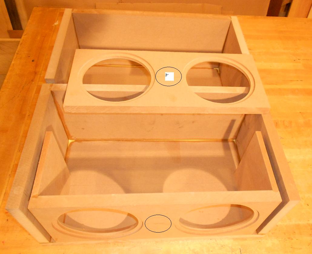

I did have some time to work on this today.
Woofers are 11" center to center. Had some 1" mdf, so that seemed like the best choice.
The tweeters won't be here until next week, but will continue with tuning, etc.

ODougbo, that's not the optimum solution because the distance between the two woofers is too large at the crossover. For example, if you cross them at 2 kHz to the tweeter, both woofers are radiating 2 kHz and they are too far apart. Around 2 kHz, the ear's sensitivity is highest, and it is also the region where we perceive direction of sound. In an MTM, it's not just the distance to the tweeter, it's the distance between the two Ms.

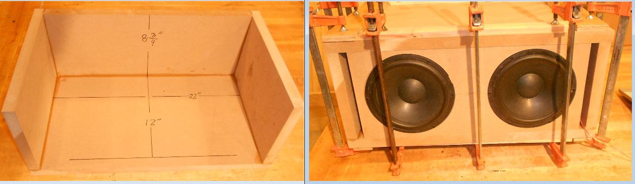

Checked tuning, the sim was correct, "wings" are 5-3/4" from front edge.
I used volt meter, load resistor, etc. I think of the three points as a triangle; this looked good, both of the high swings were equal, valley 50hz-52hz.
(somebody may have to interpret 😱)
The bass is nice and strong to 55hz-60hz, a noticeable dip around 50hz.
The woofers are pretty darn smooth; they do not push a lot of air.

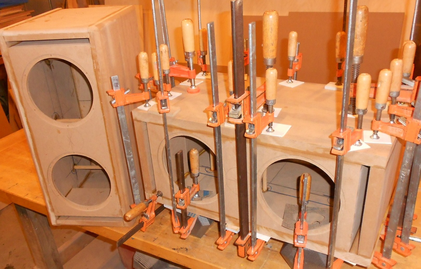

Buttoned these up tight, they still seem to have a "ring". I have better luck with BB ply and angle walls. Will add some cork to walls.

This project is fresh start, new tweeter and placed drivers as close as possible; ports are also on top and bottom. vs. the side ports (other project).
Can agree with the bass response here - that was obvious.
I saw some small plastic flare ports, that might have worked nicely, but just don't think they will ever have low bass (but we'll see soon).
If they do have some 😱 I could work some flare ports into the top/bottom vs. slots.

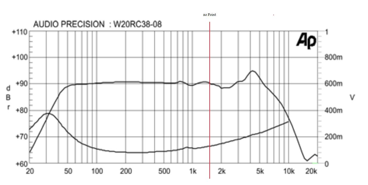

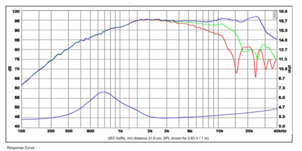

Thinking 1600-1700hz is a good xo point.
