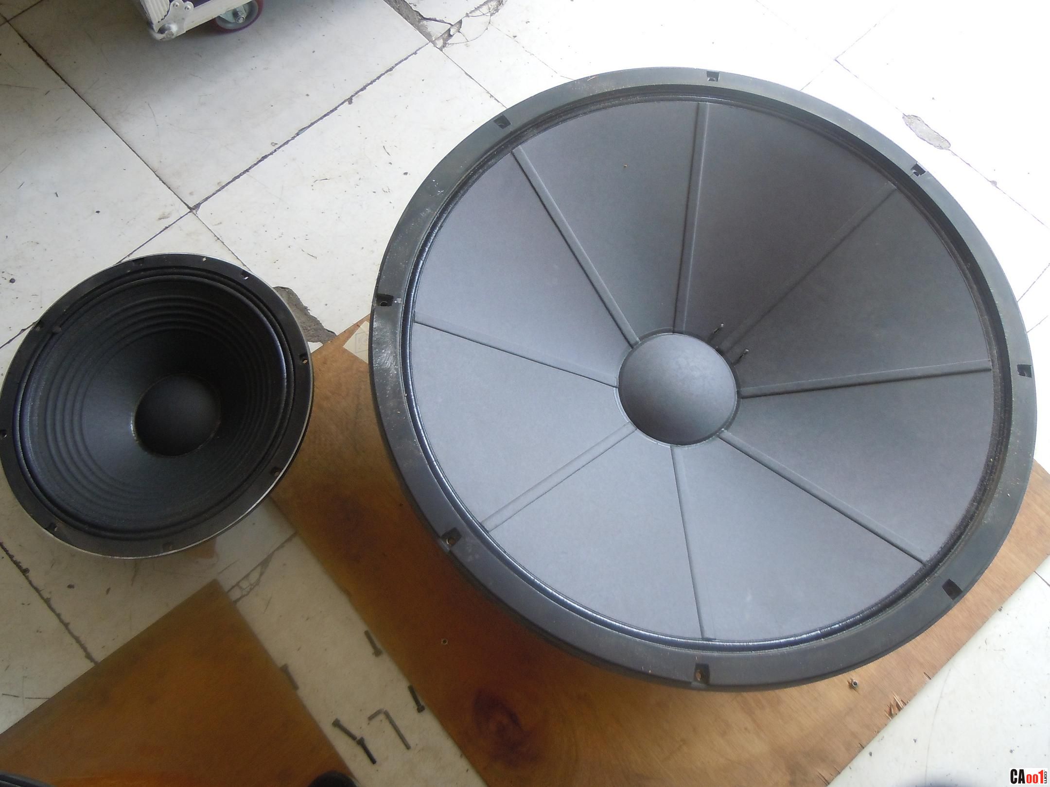

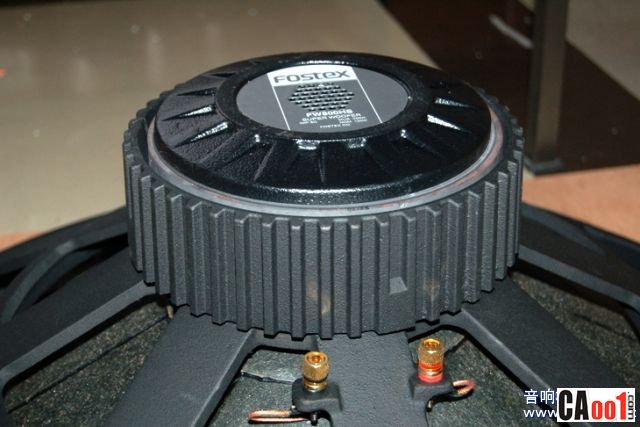

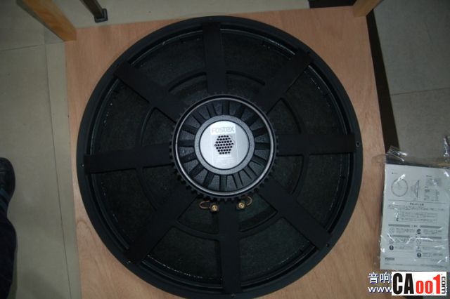

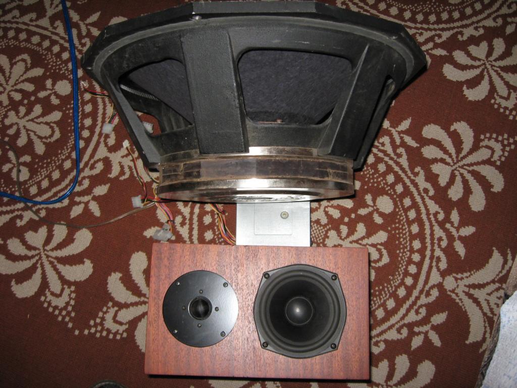

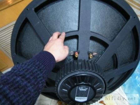

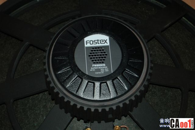

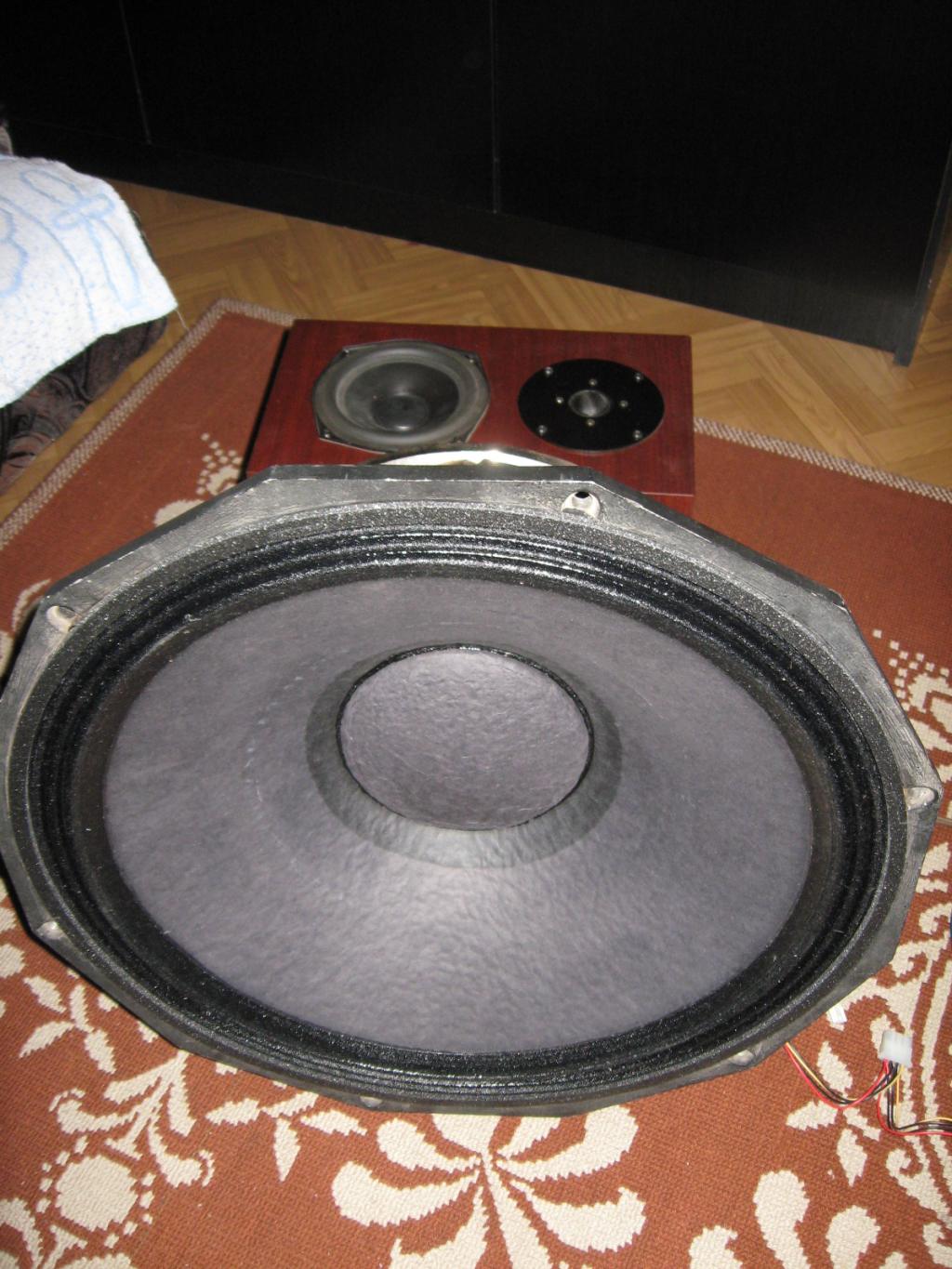

I was asked for a new vented 4000L sub woofer project - obtained by a separation in front of the complete back wall - basicly as to see in the first jpg attachment from post #1 about
http://www.diyaudio.com/forums/mult...dy-present-inwall-subwoofer-esl-dynamicl.html
and after completion post #15 about
http://www.diyaudio.com/forums/subw...ubwoofer-precision-devices-pd2150-inside.html
The dimensions of the listening room are 8,50x5,00x2,80 m (after finished the probably bricked separation approximately 7,90x5,00x2,80 m).
The prospective user prefer the Fostex FW800HS. I had advised him, that eight items of Precision Devices' PD2150 will provide the better performance in all respects, larger effective piston area, better price-performance ratio and highest electrical input power (for home audio application I recommend for safety reasons a subwoofer power amplifier with only max. 10 watts output power).
OTOH - the Fostex FW800HS provides extremly low losses in the suspension (Qms nearly 20 !!!)
That ensures perfect clean and tight bass transmission even at extremly low level output.
What are your assessments and estimates to both options ??
At follow the juxtaposition for compare of this two variants
1) 1 Pcs Fostex FW800HS (VAS: 1400L Ots 0,7 - ~ 5200 Euro retail price in Germany)
http://www.fostexspeaker.de/speaker.pdf
http://www.fostexspeaker.de/woofer/fwserie/fw800hs.pdf
http://www.stereo-lab.de/media/docs/fw800hs-datenblatt.pdf

2) 8 Pcs Precision Devices PD2150 (VAS: 5000L, Qt: 0,2 - ~ 4400 Euro retail price in Germany)
