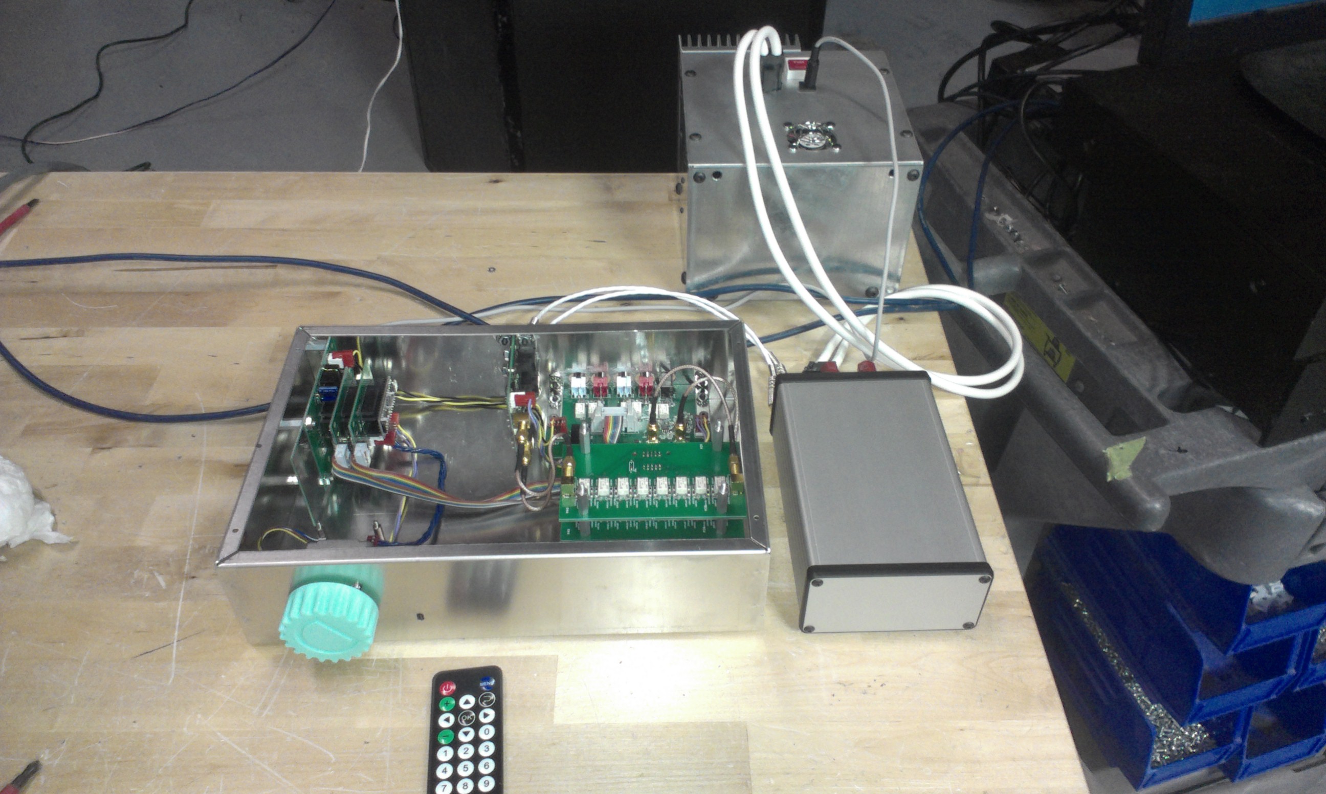

@jan.didden could you share the PCB layout for the pga board.
I have made one for Pga2311 but I m facing the hissing noise issue when I go above 0 db. I have made mine as per mark Hennessy buffered input.

I read the pdf shared above and I saw your layout with two pga2320 but couldn’t understand if it was ground poured on both layers, you haven’t used op-amp buffer so is there any specific reason.I might, but I must look for it ...
Jan
The board I made is single layer.
Input should be 600ohm or less so that is what is creating a whirlwind in my minds and my query was to the input of PGA not the outputThe pga output IS an opamp.
Look in the data sheet.

Or could you help me get rid of the hiss when I go above 0db gain other wise it is silent. We could connect via pm.I might, but I must look for it ...
Jan
It would help me finish the project and enjoy - the amp is LM3886 ( My Ref Rev. A but will convert to Rev C. )
That is hard to say without more info. For example, what is changing significantly when you go above 0dB? Do you insert a gain block?
Can you post a (complete) schematic?

Input to what? Or is it the source output impedance? You mean greater than 600R?Input should be 600ohm or less so that is what is creating a whirlwind in my minds and my query was to the input of PGA not the output

Sure I can do that. Can I PM you the PCB projectThat is hard to say without more info. For example, what is changing significantly when you go above 0dB? Do you insert a gain block?
