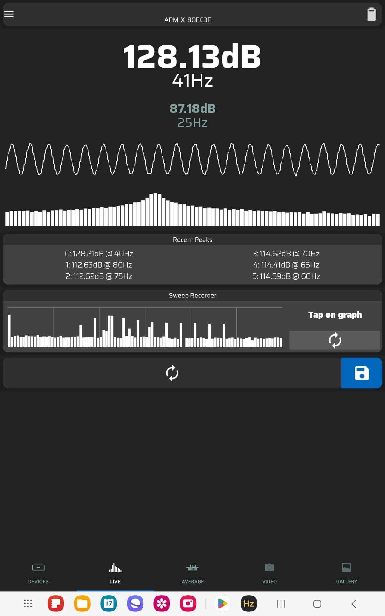

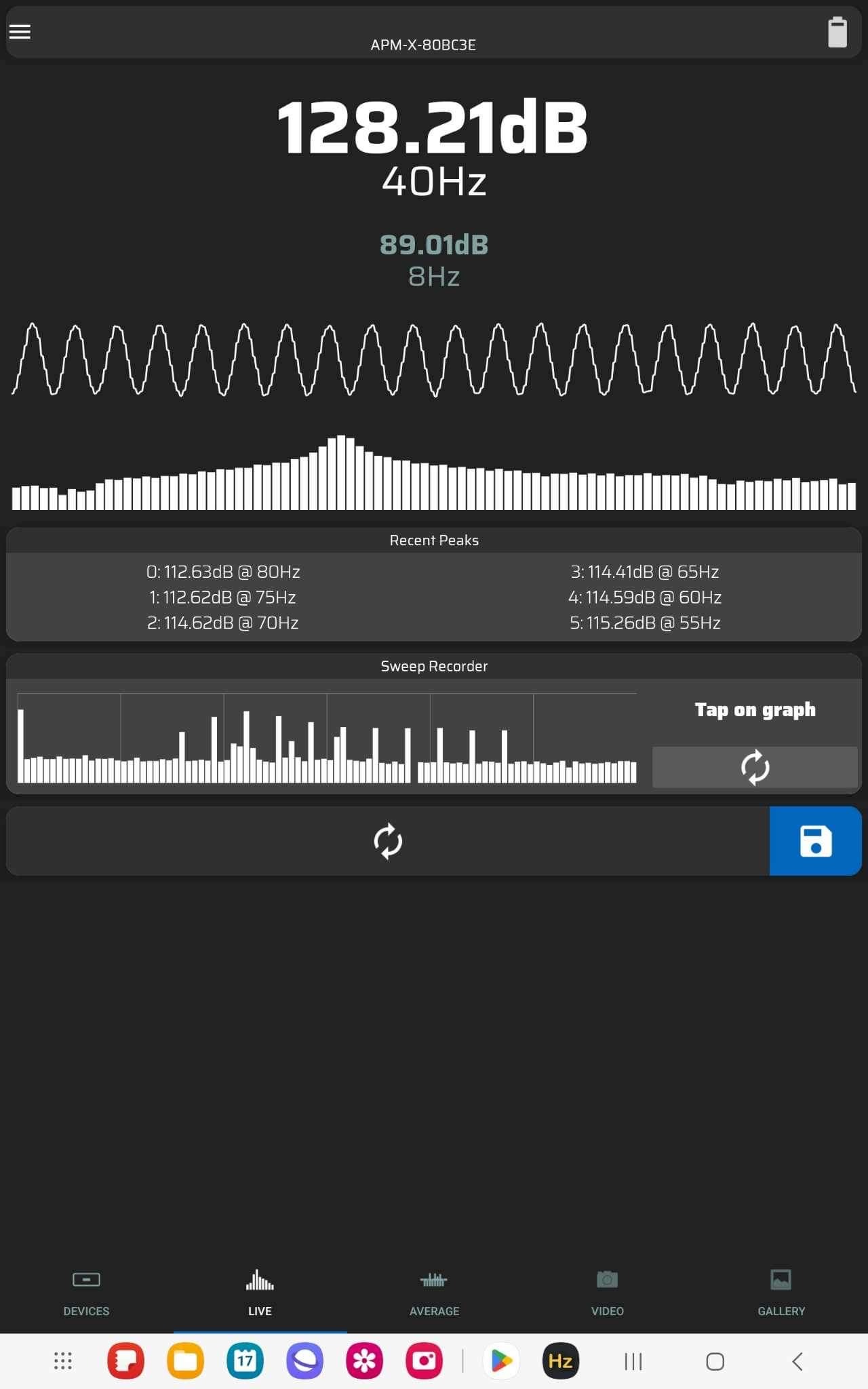

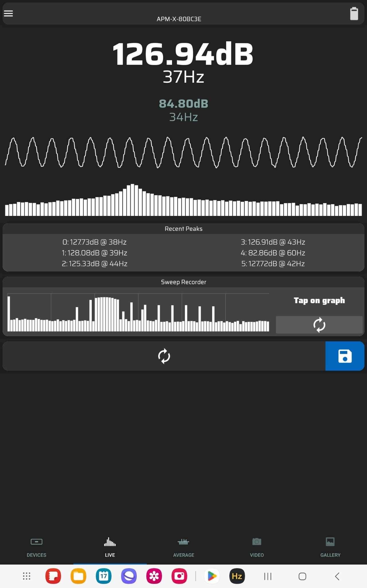

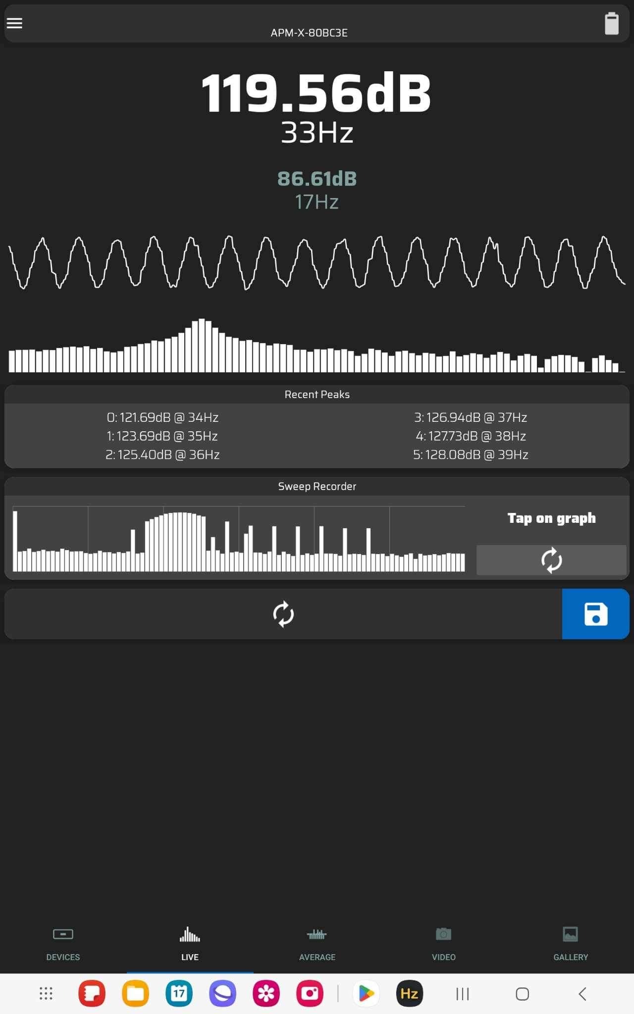

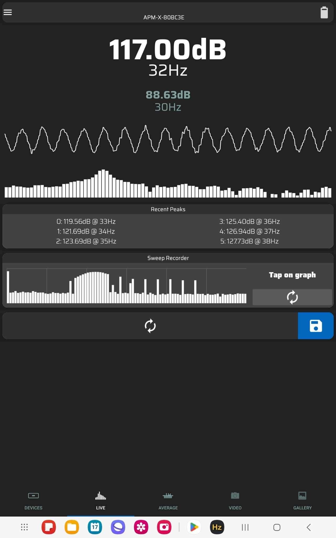

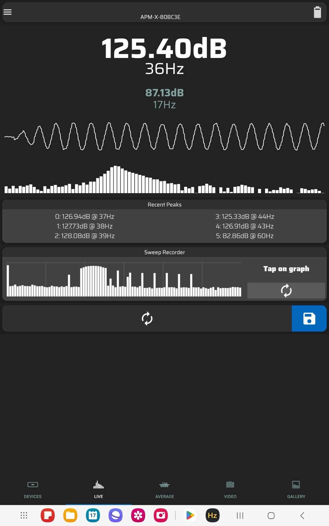

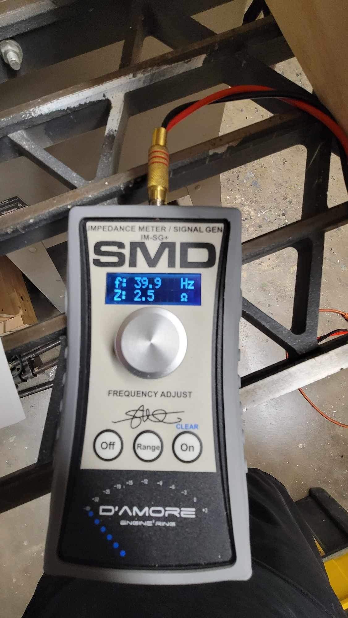

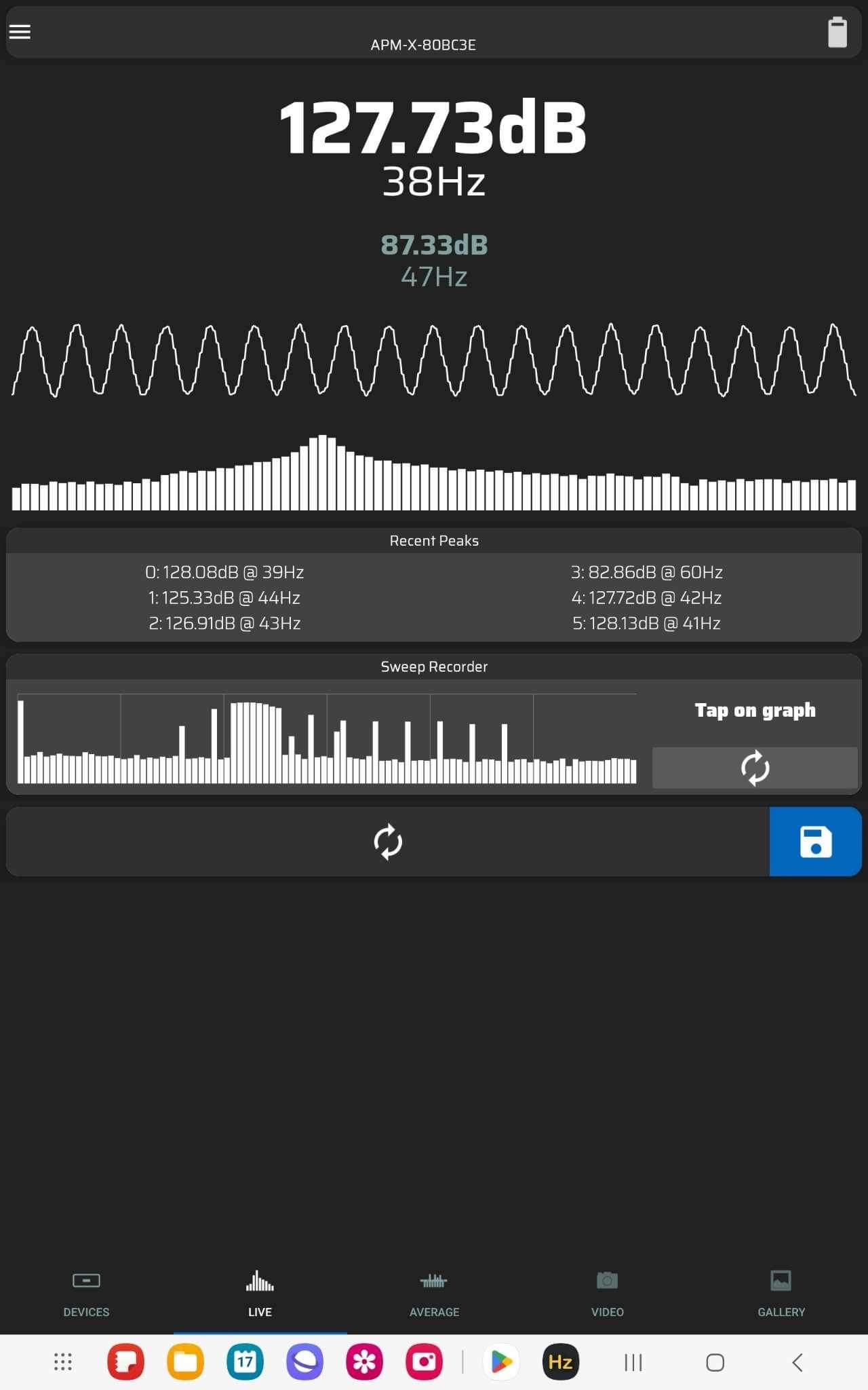

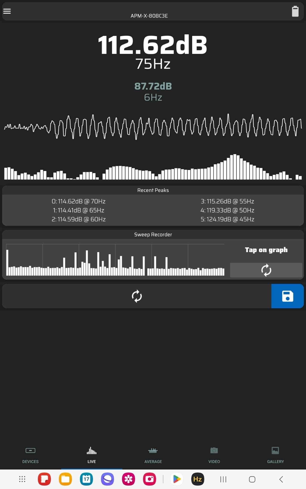

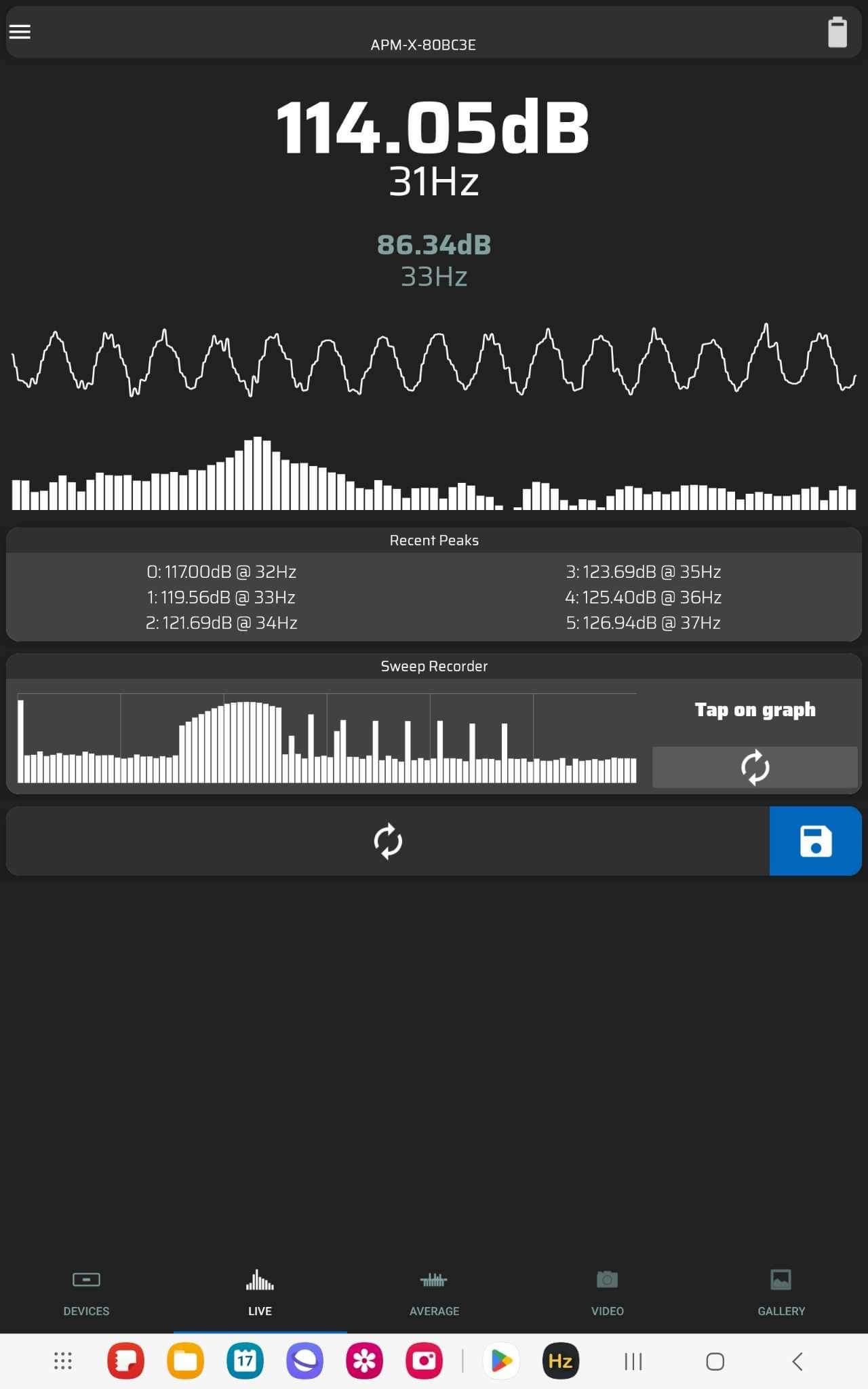

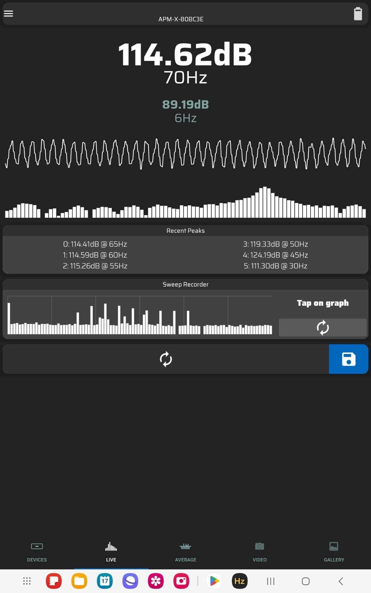

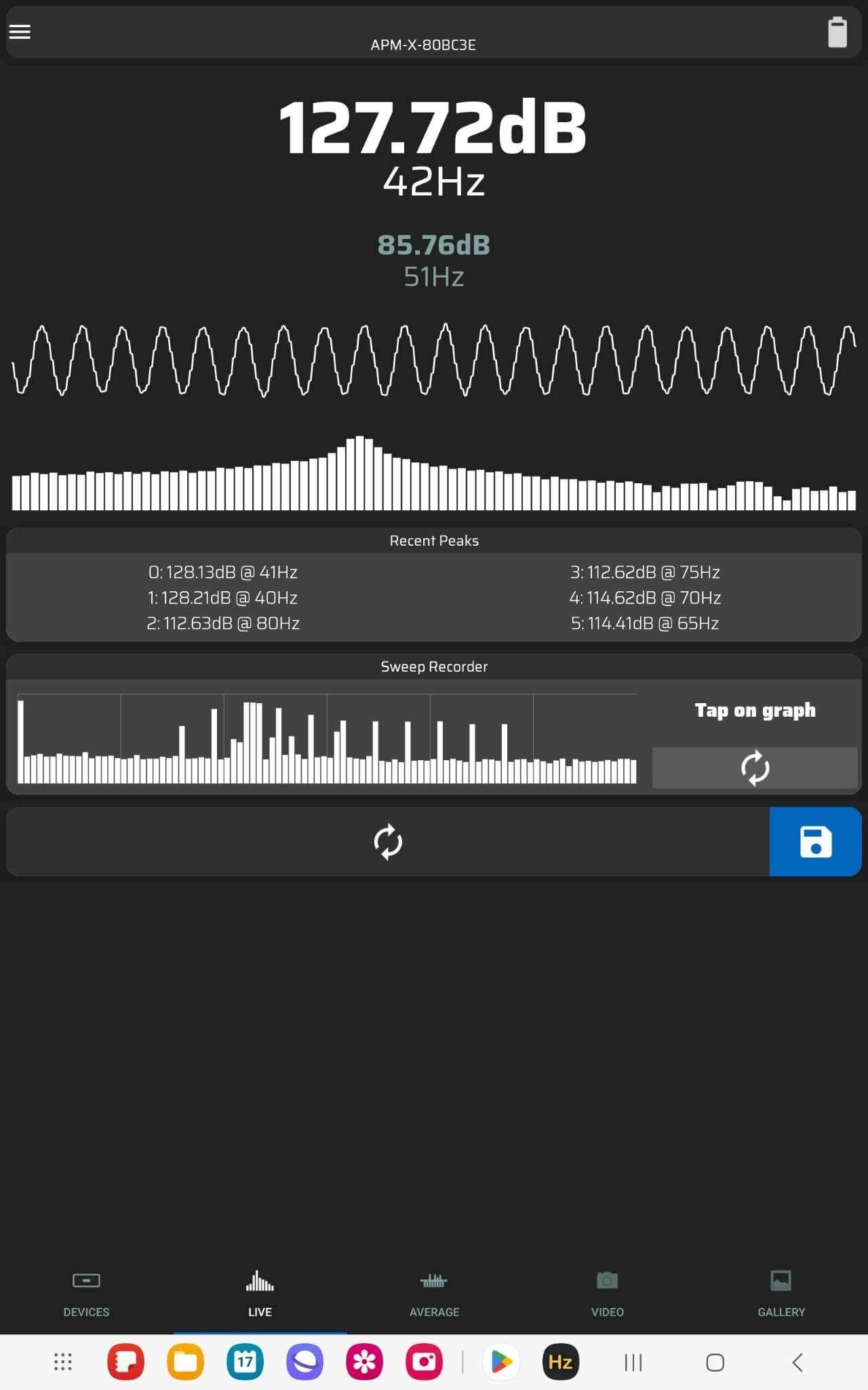

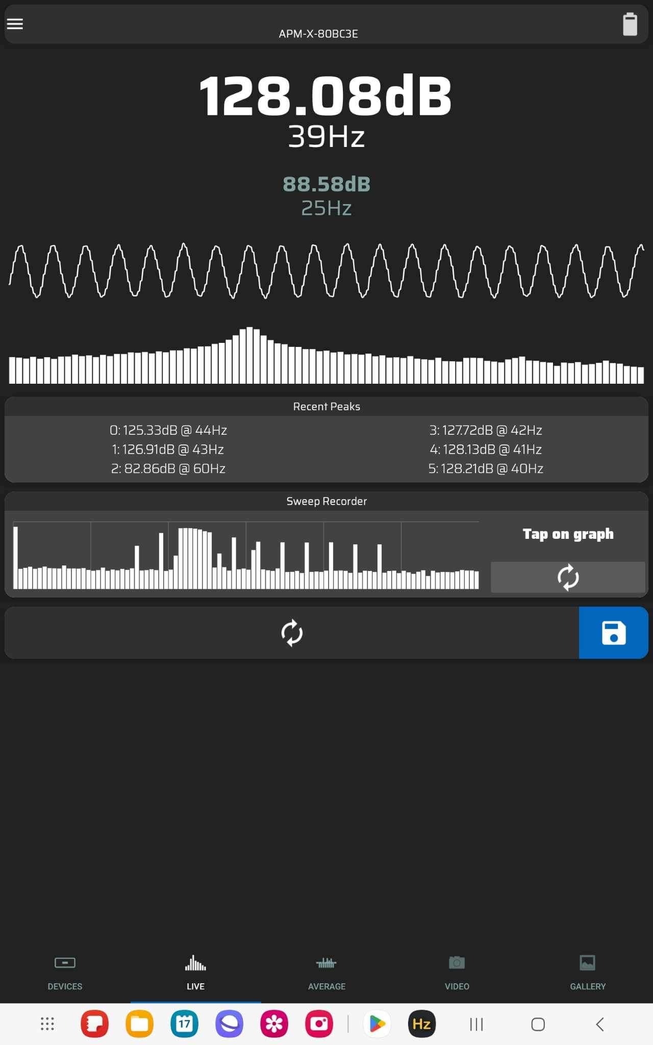

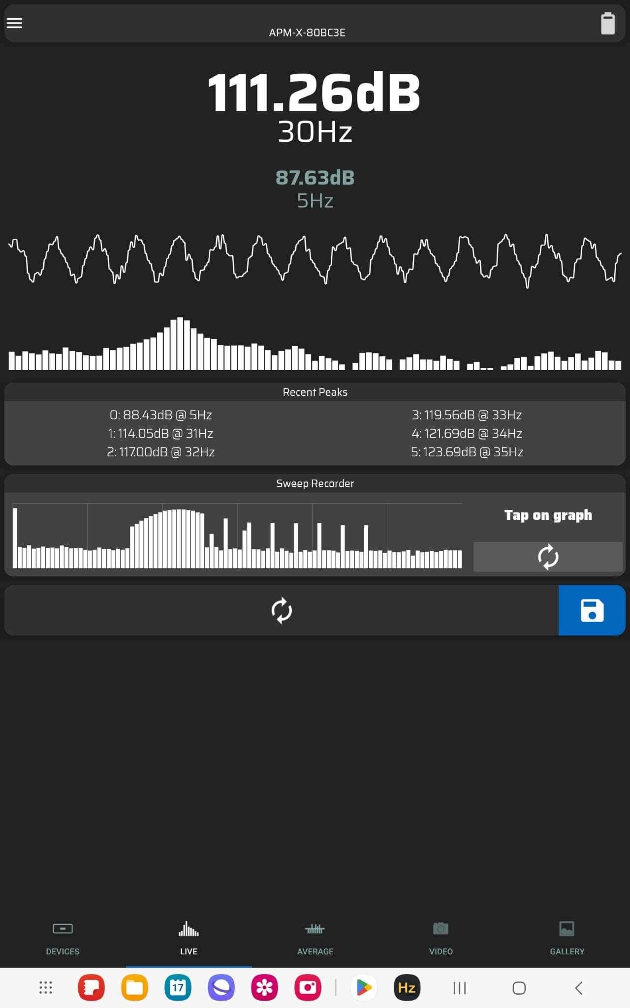

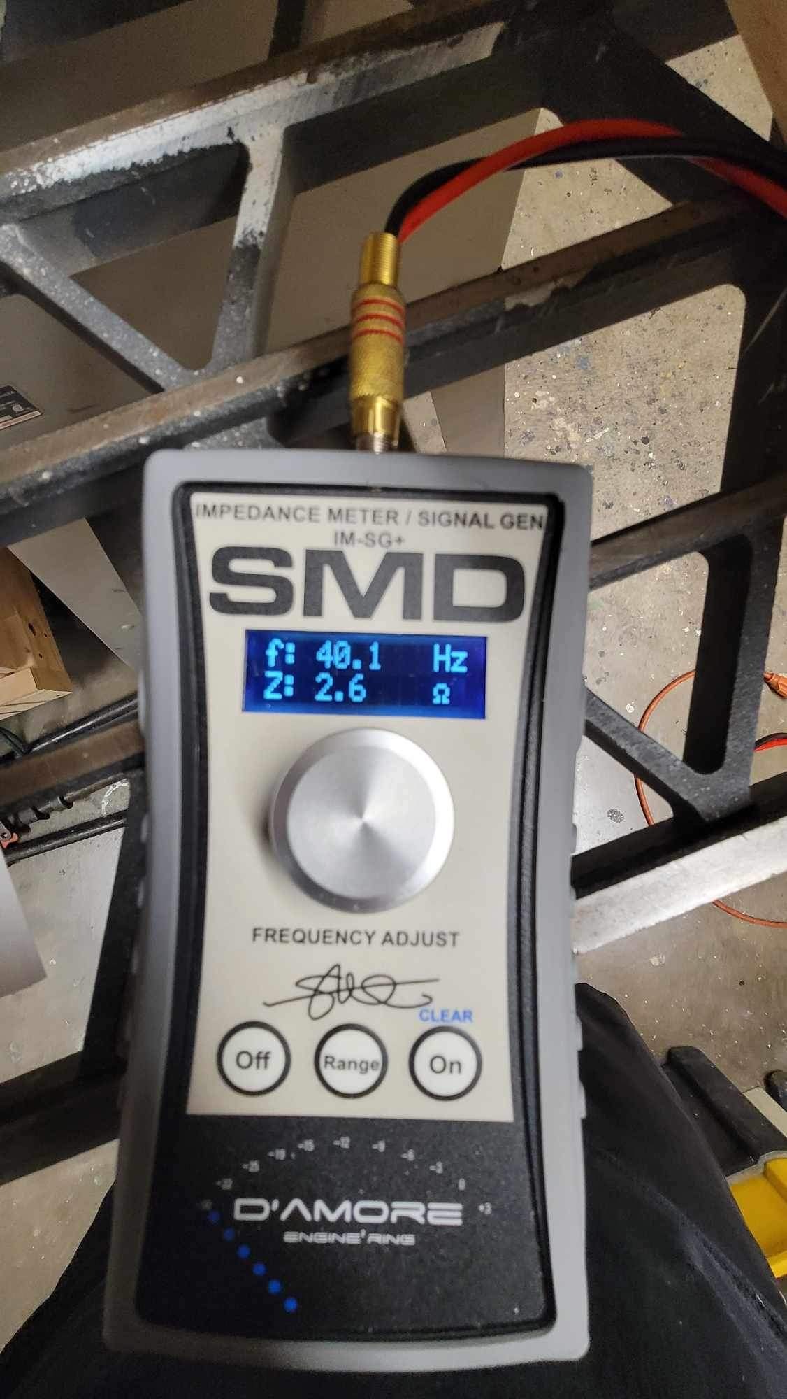

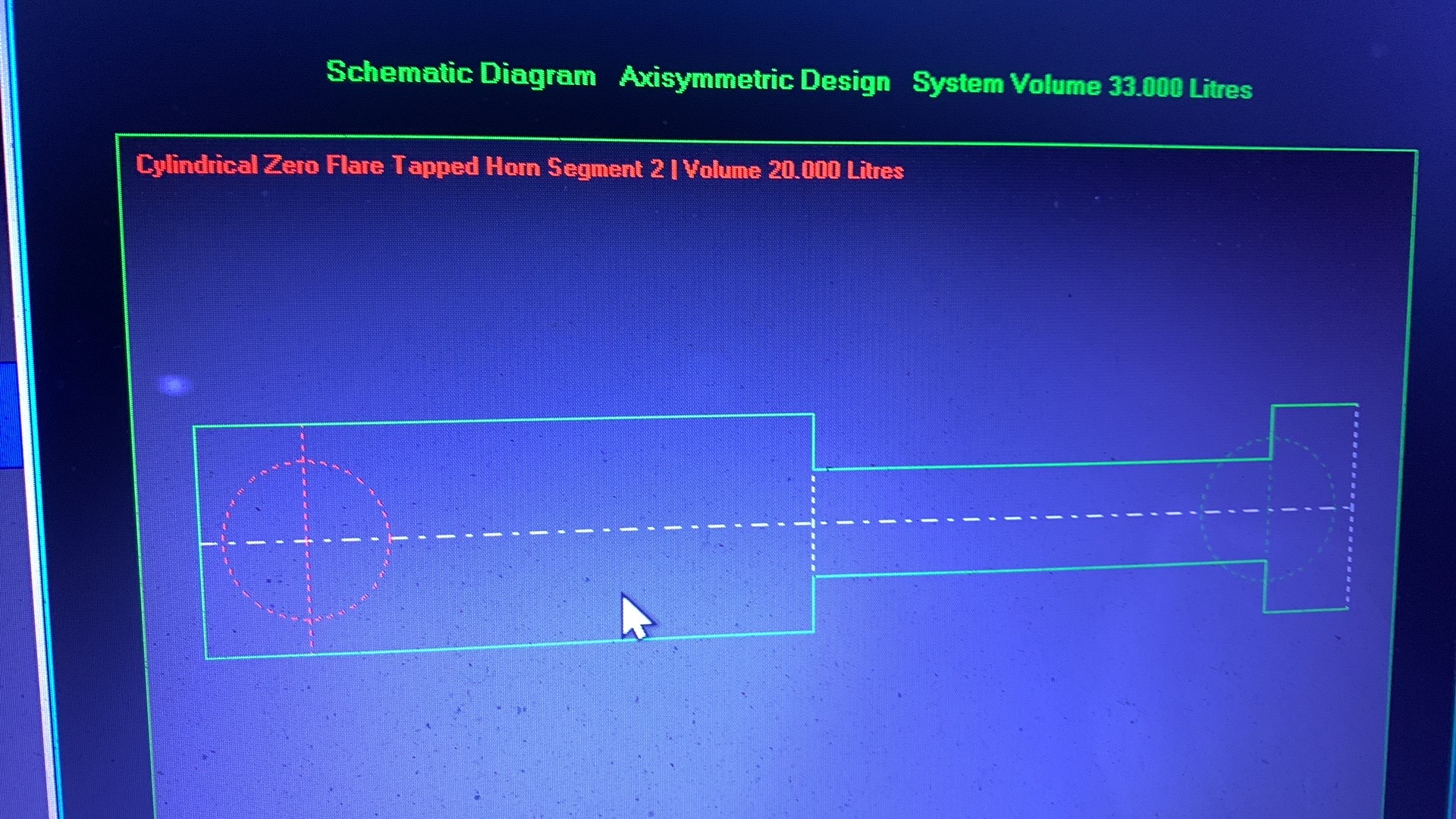

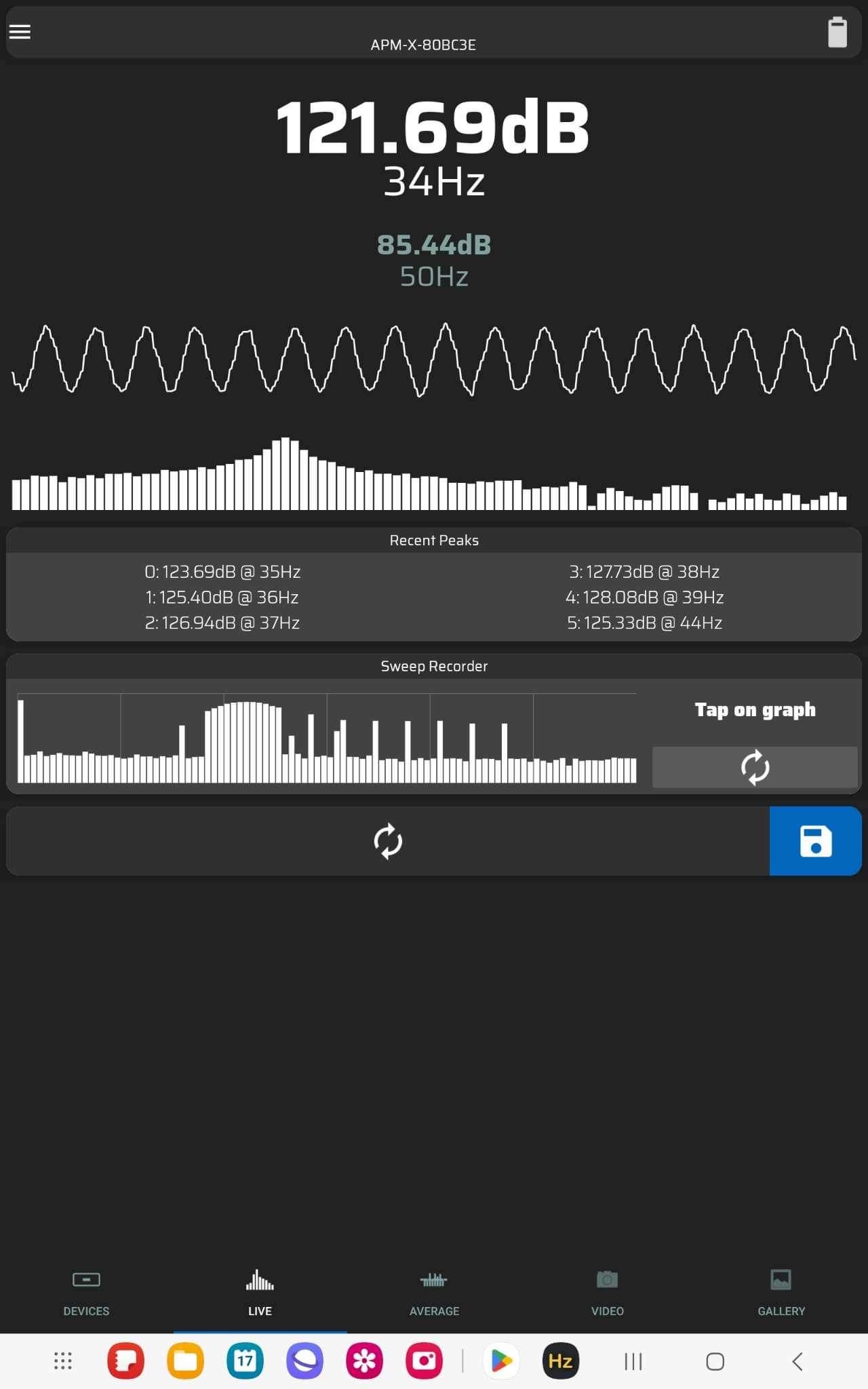

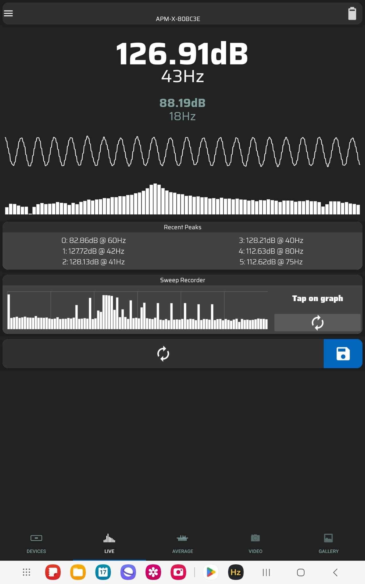

8” car audio tapped pipe

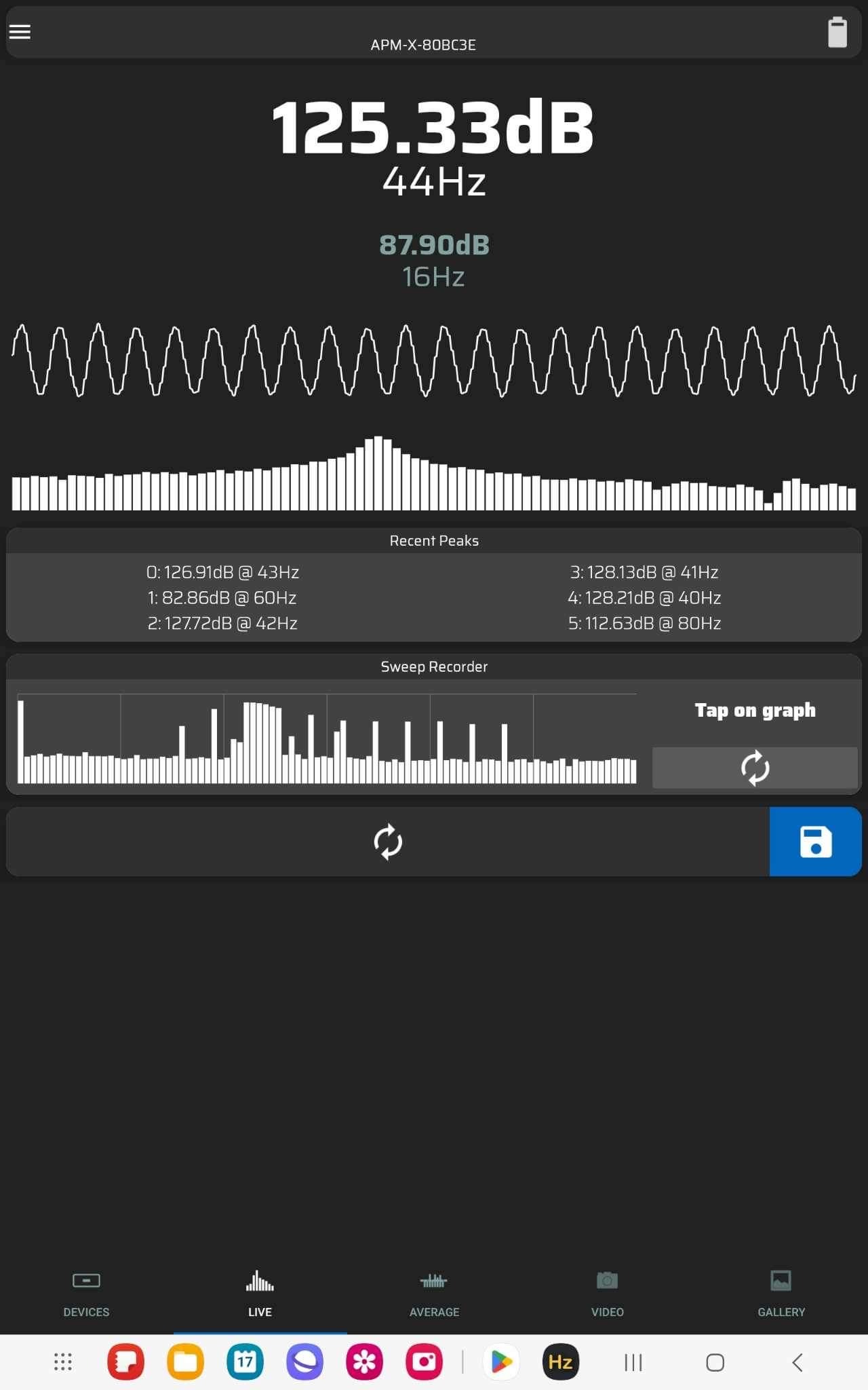

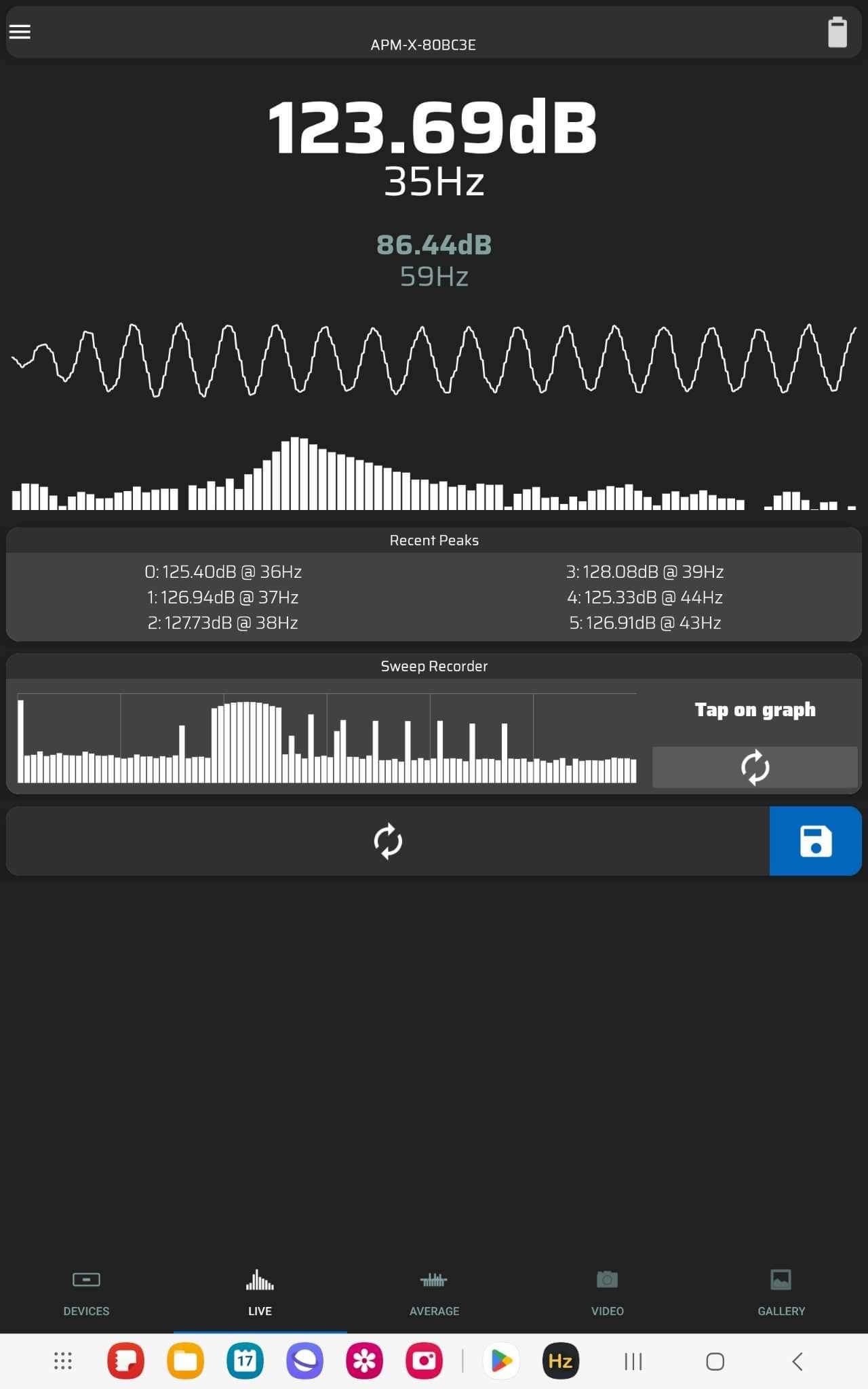

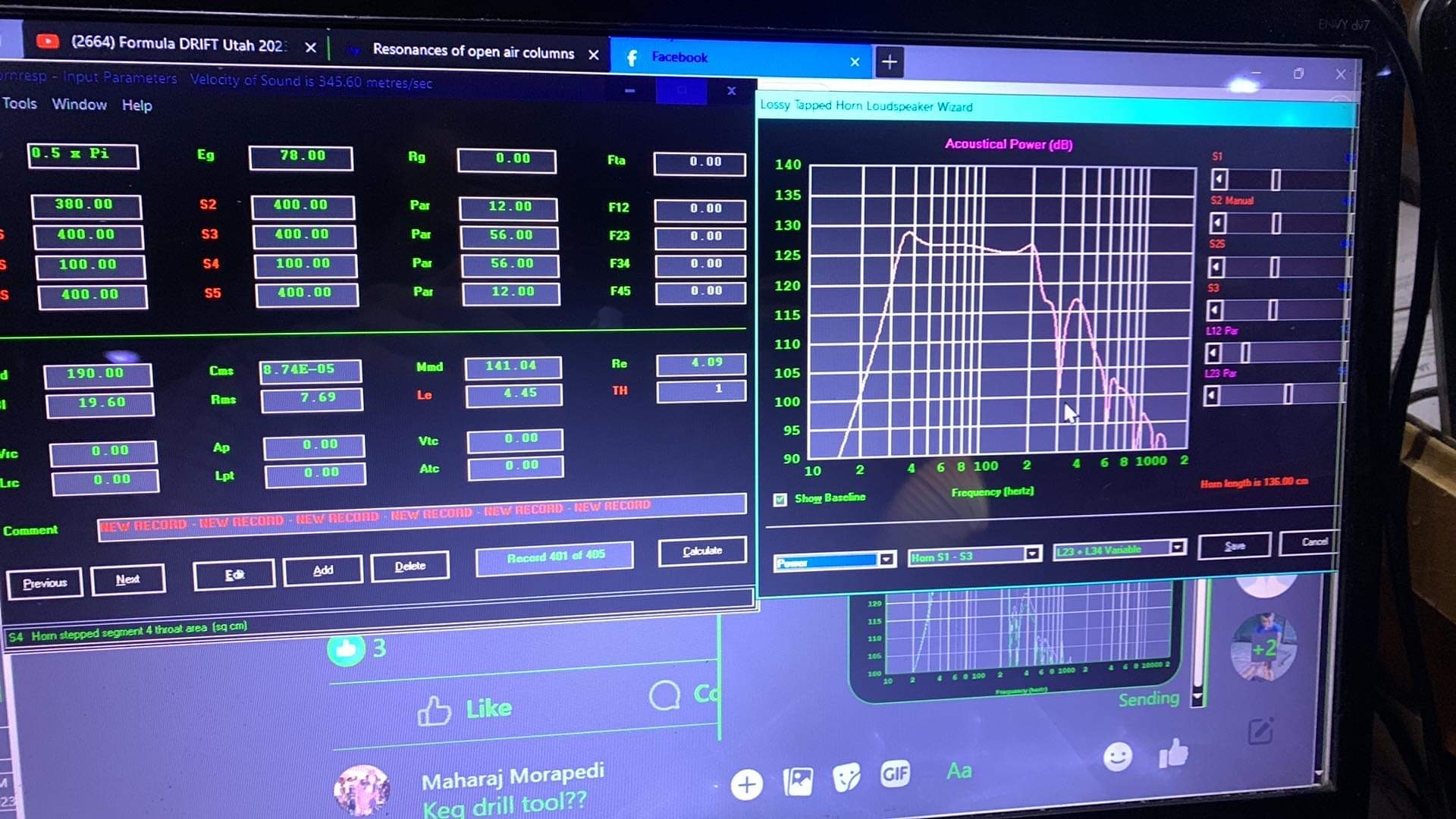

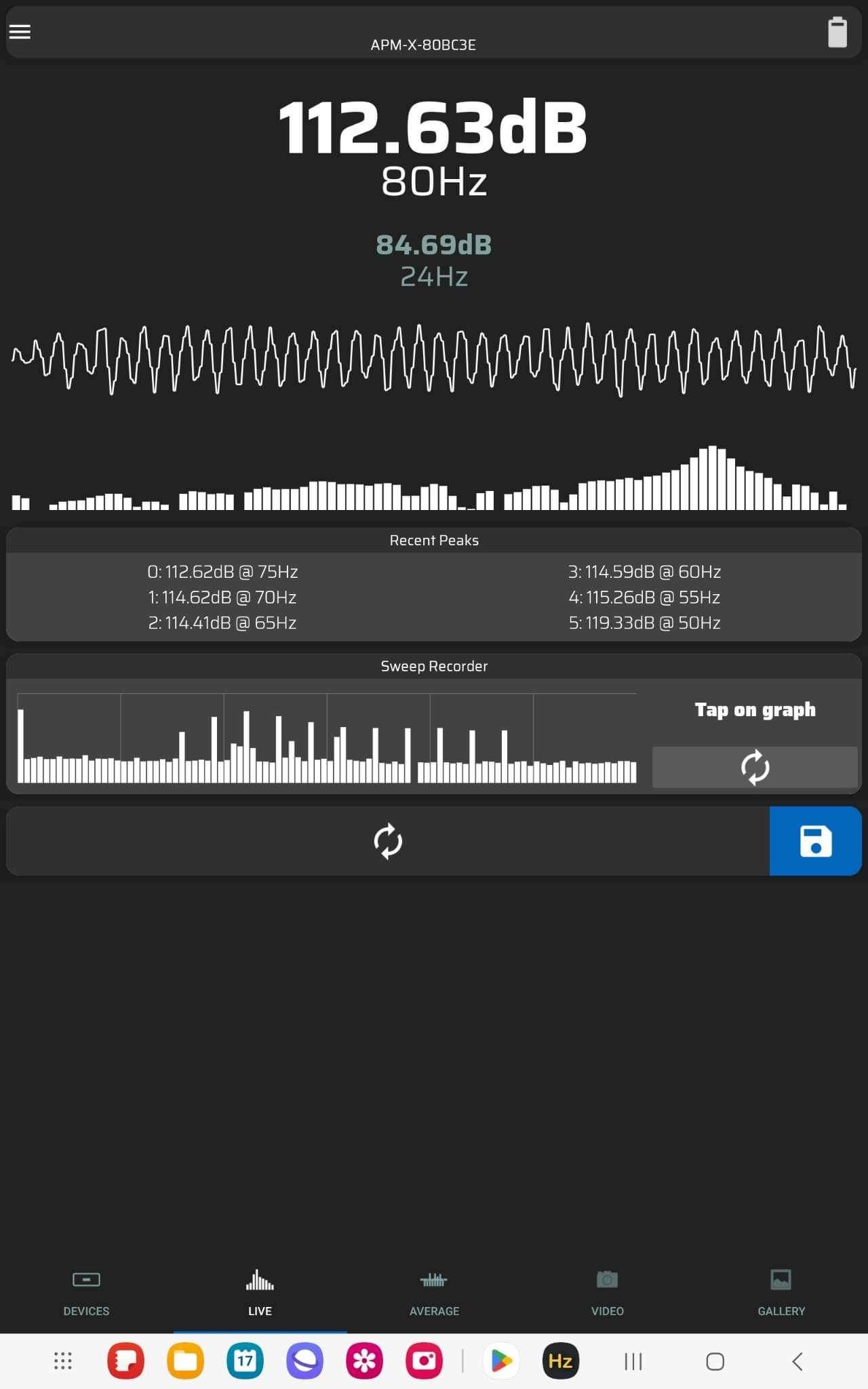

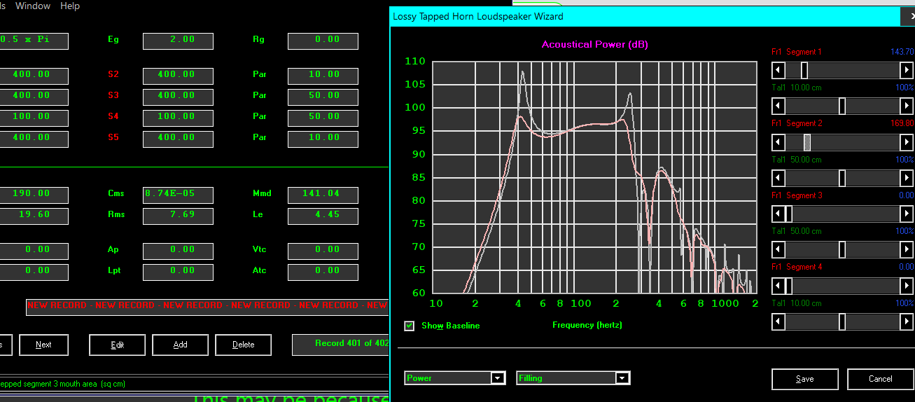

I kinda ‘fudged’ the exit in the sim ?? Any ideas/opinions Before it gets wired up and plays?
My buddy built/rendered this after we looked around in HR for something fun .
Looks like a bass reflex to me, does not look like the port slot covers the cone at all.
I'd probably have wrapped the port in an "L" to the back of the cabinet to lower the Fb, cabin gain and voice coil inductance will probably make for a downward slope from 40Hz to 100 Hz as it is.
Big surround on that driver, what's the make and model?
