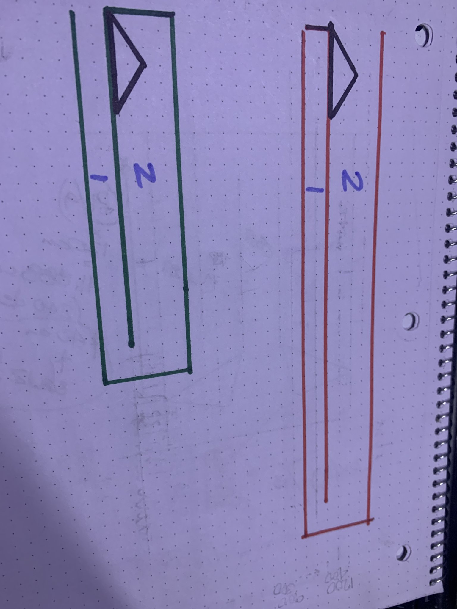

8” car audio tapped pipe
If the subs are flushed inside the driver seat 😜
Try a few designs with this and see what you guys come up with? Hes open to trying many things in the name of science🤓👍🏼
(try and get it to stay flat)

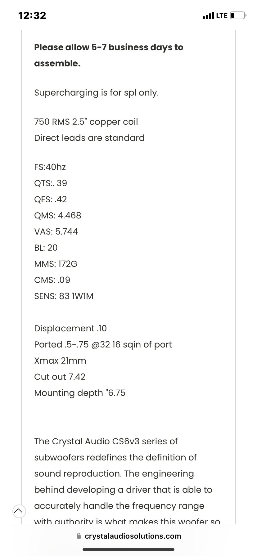

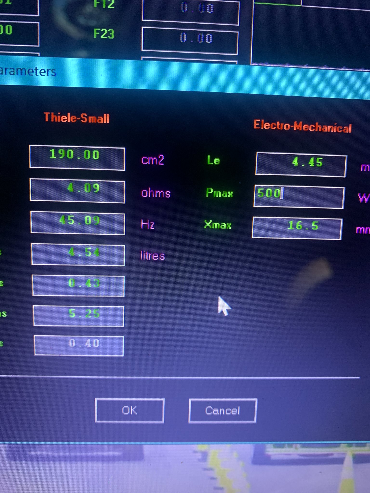

It’s actually 21 mm but these SPL drivers with tight suspensions drive me crazy with how they just go nuts at resonances and are lack luster in between??
much like super high Qts drivers, the super small Vas ?
i suppose this is why the skar ddx12 💩 the bed so bad in paraflex and then does so much better in a roar ? Long skinny pipe in the roar damps the thing?
i can’t tell? It’s like the worse possible combo of TS parameters to try and design a descent subwoofer with. Car audio ‘SPL‘ drivers are rediculous
