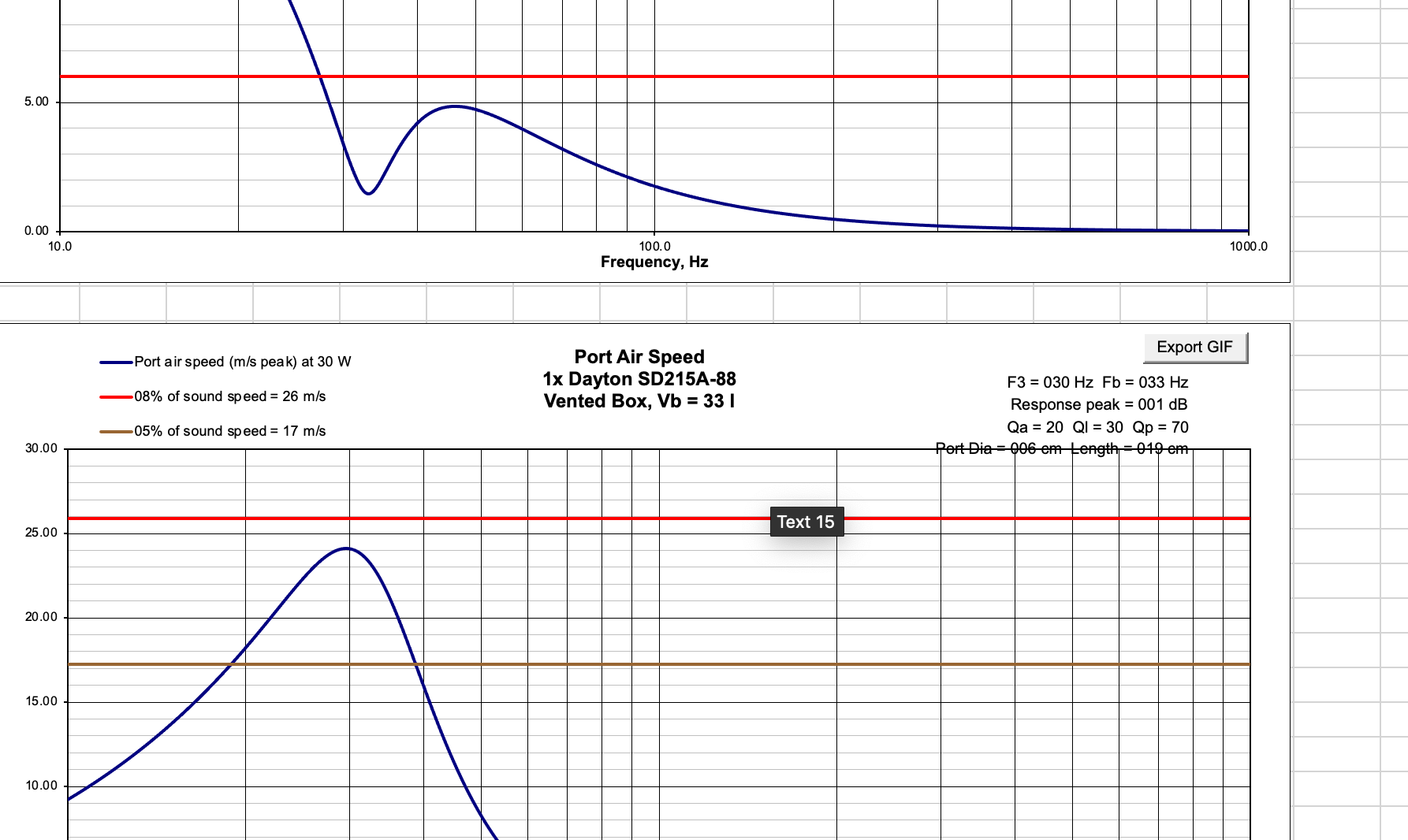

I'm tinkering with unibox and can't quite get the port air speed or cone excursion to look quite as good given my larger volume, smaller port diameter, and less extensive damping. I can reduce the volume and increase the port diameter a little, but I probably won't be able to damp as extensively as he has. I'm sure it'll be okay though?!

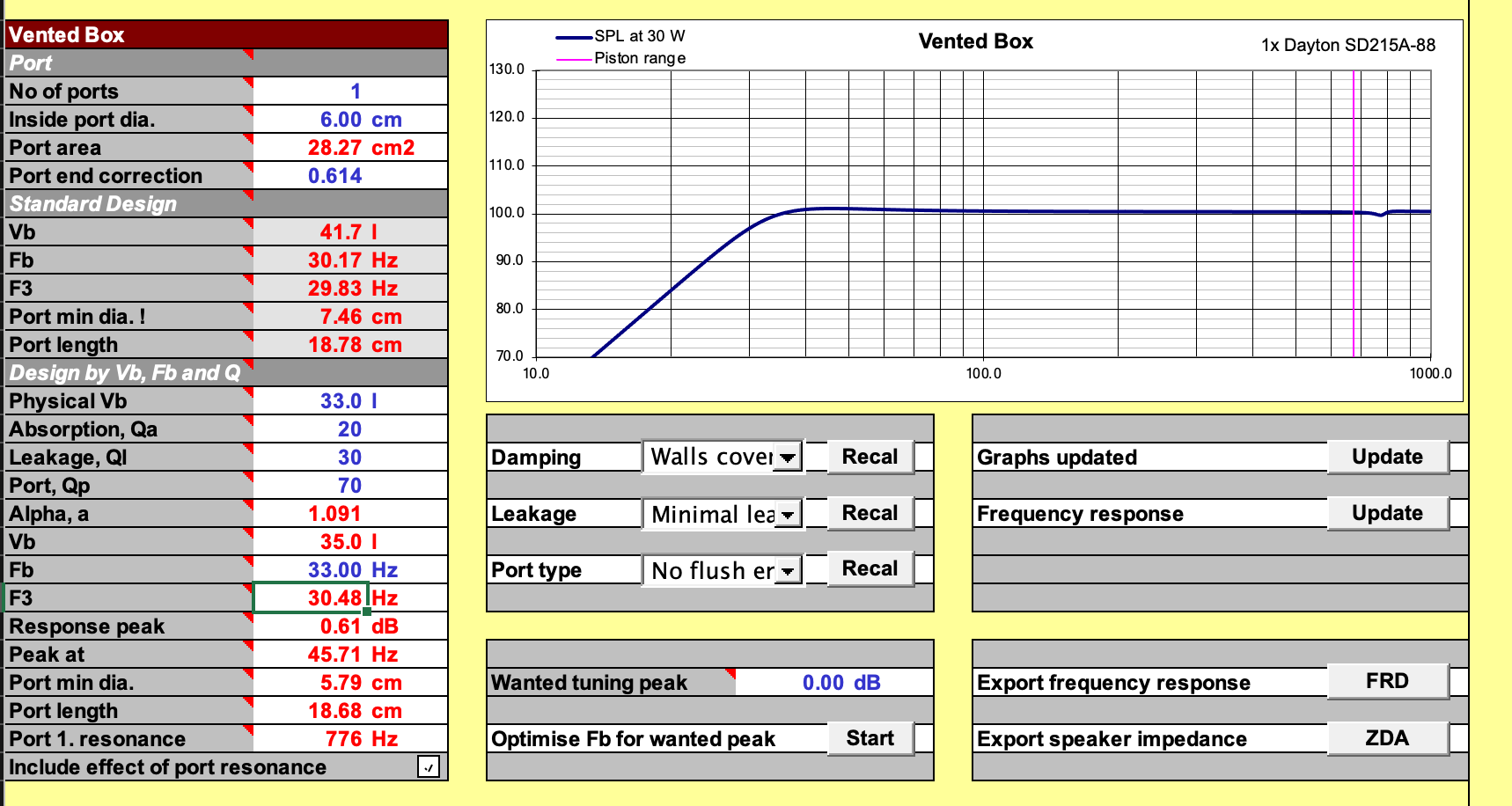

When you say optimise for 100dB output, does that mean reduce the nominal power until the freq response graph plateaus around 100dB? If so, that answers a question I had: why you had used 45W rather than 80W in your models in the PE forum. Following this logic, I can actually put the nominal power to 30W, yielding a 100dB output in the FR chart. Then a 60mm tube tuned to 33Hz (187mm long) starts to look decent! See attached.
I think I'm going to just order the parts and see how they sound with the 60mm port. If there's loads of chuffing, I guess I'll seal and cover the port opening, and add a new, bigger opening to the sides of the cabs 🙂
Lewis

I would advise at least a 2.5" diameter port, and lean toward a 3" in that volume.
