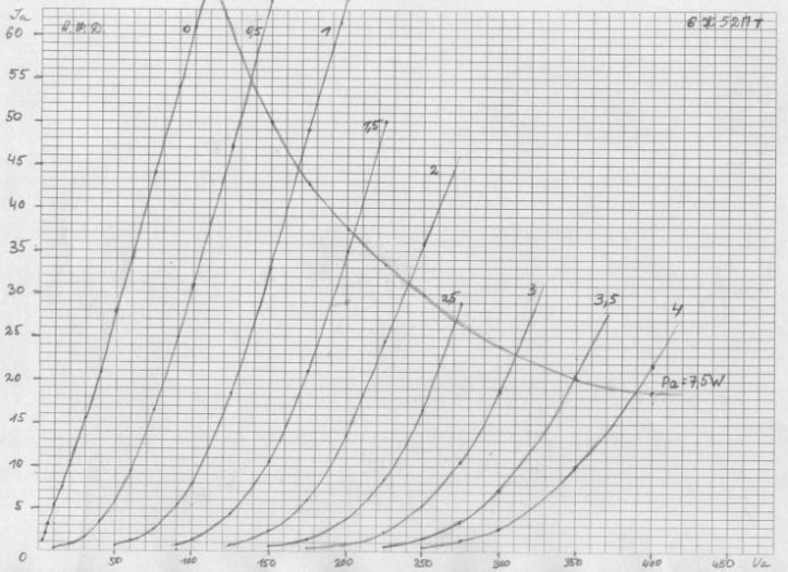

Boris_The_Blade said:Is there a russian close equivalent to this tube?
Yes. I newer wrote about them because I don't want to raise up prices before I bought bunch of them for my new hybrid project.
Ok gentlemen;
I can buy bunch of 6F12P, 6J52P, 6J53P tubes. In case of a group buy they will be relatively cheap, but we have to do that as fast as possible because since somebody already mentioned them here (@#$%@!!!) prices will go up rapidly!!!
They were designed for later tube TVs, very precision grid alignments, good technology, as the result they are very universal: can work as pres, drivers, outputs (I used to swap them with 6P14P in the same TV sets to get color picture back when urgently needed, without audible sound degradation).
I believe I can get them about $1.5 per tube plus shipment.
PM me who are in.
PM me who are in.
Curves for a triode part of 6F12P (Pentode is identical to 6J53P):

Ok, I'm ordering 200 of 6J52P, $2.50 each plus $190 to ship them to California from Moscow.
==$690 for 200, i.e. $3.45 per tube in California.

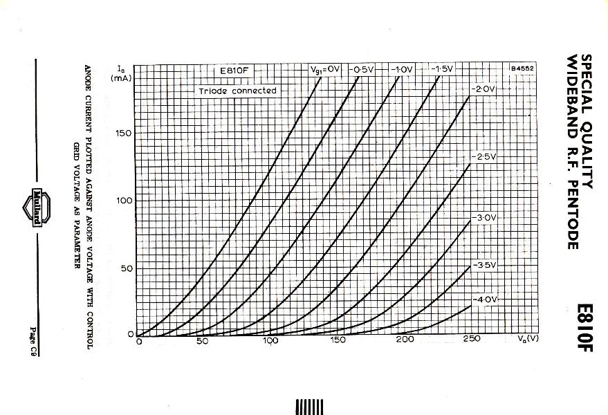

Hi boys,
following you can find some Sofia curves for:
E810F triode connection:
http://www.multitask.it/tubes/3-E810FTR.BMP
E810F pentode connection
http://www.multitask.it/tubes/2-E810FPEN.BMP
Match between 417A and E810F triode (more vertical curves, of course)
http://www.multitask.it/tubes/6-417-EF.BMP
This one is the match between E810F (always more vertical curves)) and EC8010
http://www.multitask.it/tubes/7-EF8-EC80.BMP
I amplaying for years with 417A but non in deep with theother two types; I am trying the soviet tubes similar to that.
Bye
Walter
