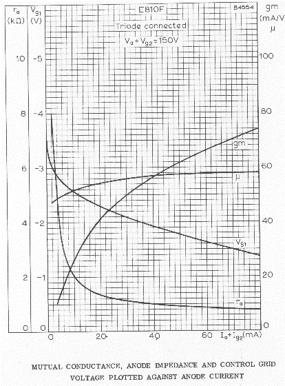

Yes E810F/7788 does make a super triode; the main problem is that one never knows the true Ca-g of pentodes when triode-strapped, so it's important to bear in mind that substantial Miller capacitance is likely and will have to be driven.
The only example I can think of where a maker quoted Ca-g for a triode-strapped pentode is D3A. This one has an American number (7722 I think). It offers gm of 40 and mu of 85 with quoted Ca-g of 2.7pF. Quite a good choice for a MC phono stage I would guess.
