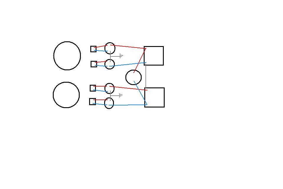

dc offset trim circuit for noninverted?
I meant to say near each output device.
Can you show a sketch of how they might be using the trim pot to trim dc offset in a non inverted amp? I can't see the traces but can see that there isn't enough showing to make a servo.
.CJ900RR said:
The pot is not connected to the output, it's connected to one of the inputs.

Well I might have to back down on this one. I was thinking about a design that works on ordinary OP-amps but now I'm not so sure it works on LM3886. Circuit below, not tested!
DRV134 datasheet says:
The DRV134 (and DRV135 in SO-8 package) converts single-ended, ground-referenced input to a floating differential output with +6dB gain (G = 2).
The BPA300 (and almost every other LM3xxx-based amplifiers) have a unbalanced, single-ended input. To bridge this amplifiers you need to convert one unbalanced signal to one unbalanced, non-inverted and one unbalanced, inverted signal. The signals need to be unbalanced, referenced to ground, and not a floating differential signal.
The DRV134 is not suitable for the job and there can be issues when using it for that. The job can easily been done with a dual OP-amp and some resistors instead.
leadbelly said:
Can you back this up with a techincal argument of some kind? TIA
