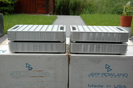

$7500.00 chipamp revealed
But it's not close enough to get similar performance. At least Rowland doesn't using so high value resistors, likewise I can't observe any big supply bypassing or decoupling caps near the chips in his Concentra/Concentra II Integrated Amplifier. A 10K gain setting resistor is clearly visible. At the right side there are only perhaps 100nF bypass caps. A feedback resistor connected directly to Ground pin (to minimize trace resistance and inductance, as well as DC offset I guess), so signal ground is omitted. However what is it a strange R29 resistor?
