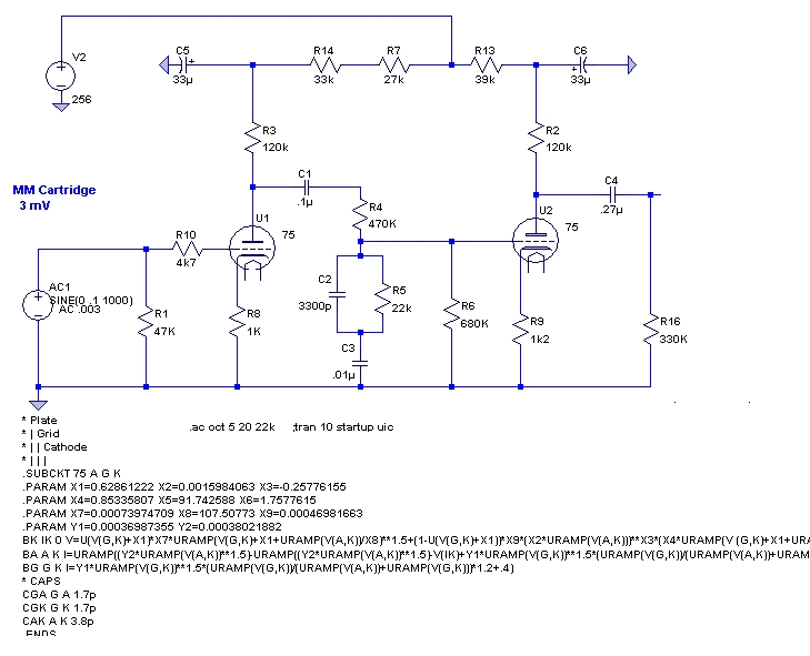

I was wondering if I could "adapt" the old RCA 7025 Phono preamp circuit to a set of 2A6's or 75's.
It looks like it might work?

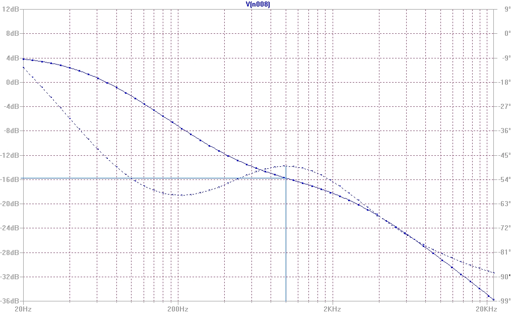

Differential between 20hz and 20khz is about 39db and at 1K it is down 19.5db.
That looks to be right about the RIAA curve?
