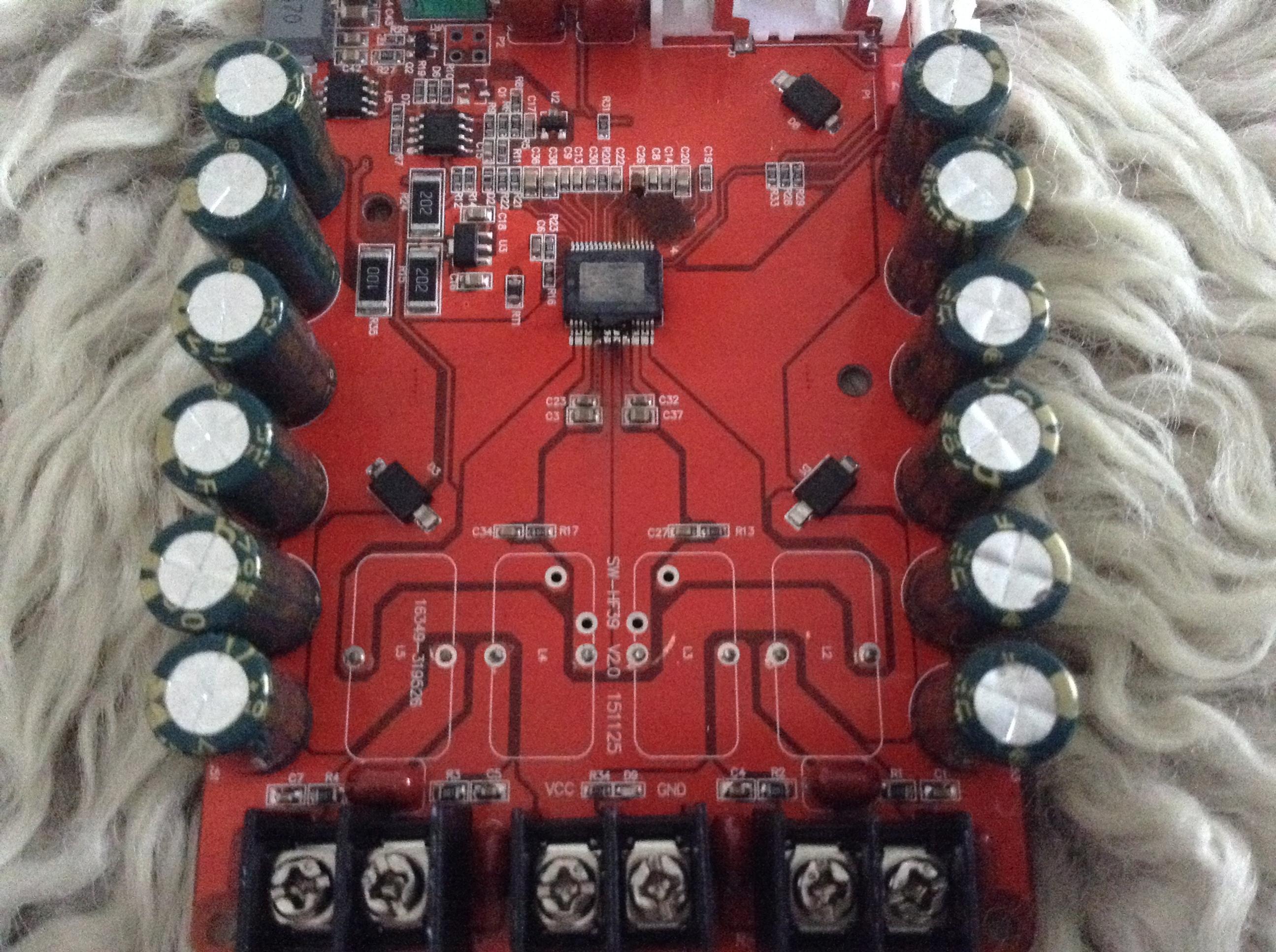

Removed chokes

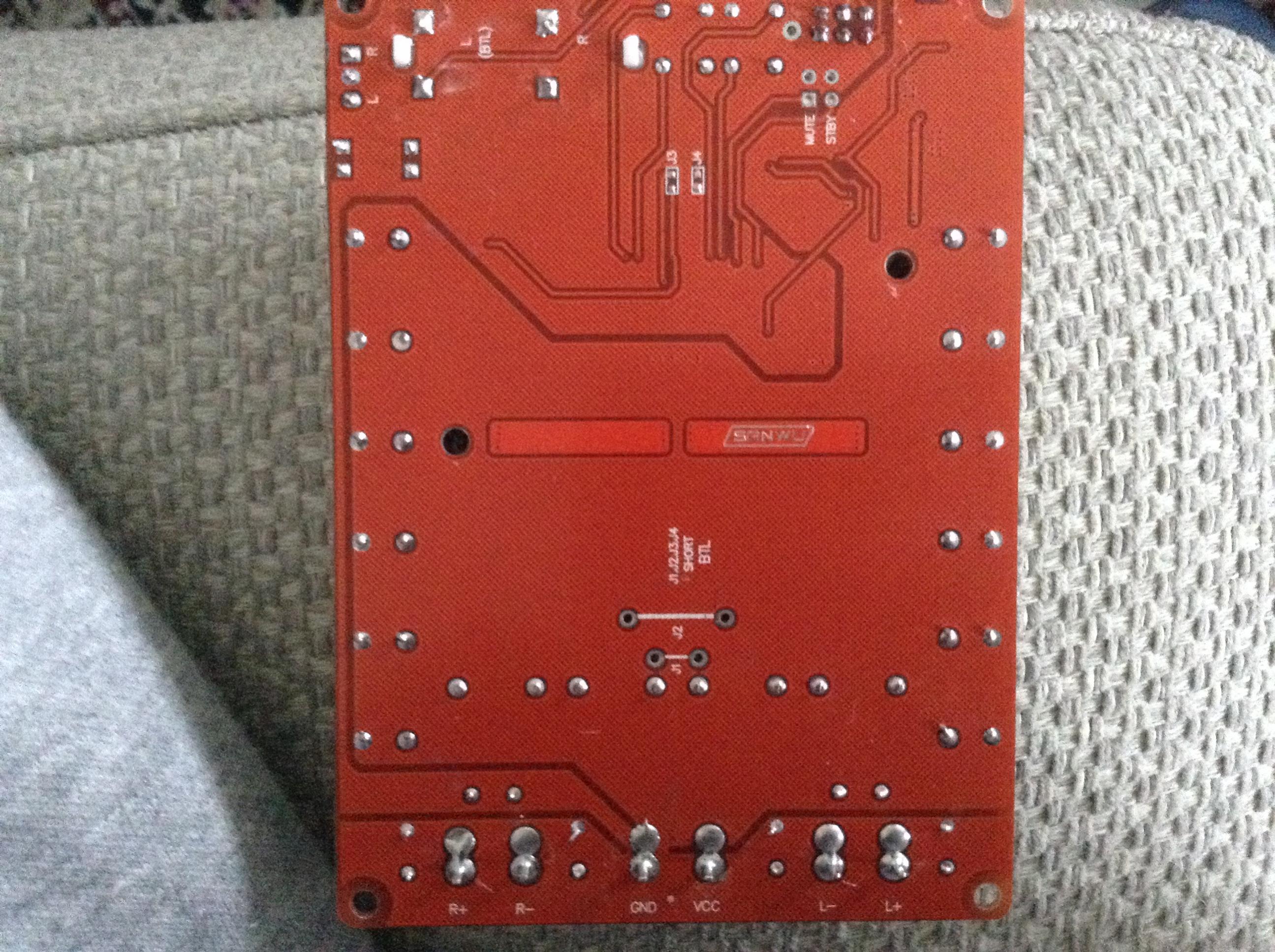

Here is the chokes removed..I can't see why both positive could not be connected together and both negative together when j1,j2,j3 and j4 are soldered and set up for mono. Then the chokes will be parallell coupled 2 and 2. Under the print the left input says btl. Both negative are tied together before the chokes,same with positive. This must be the right way to use it in mono? Or am I missing something?
My concern is, If you use a single stereo channel with a 4Ohm load, giving more power than you intend to use in PBTL-mode, a single choke and a single filter capacitor is seen as the optimum by the designers. If you put the chokes in parallel and the filter capacitors in parallel, you get half the inductance and double the capacitance. The filter will be more heavy for the amplifier to drive, while your load may be above the 4Ohm (two voice-coils in series) or a little less if you use only one voice-coil. I am not certain if the designers have foreseen (and accounted for) the use of the output filters in parallel. But, they have decided for the single filter as best for 4Ohm.

The situation is that the designer (if competent) decides for an output filter according to the maximum load current, the carrier frequency, the load impedance (for damping), the choke losses and the current capability of the chip.
NXP, a competent company, recommends 10uH/1.5uF for 4Ohm, 15uH/1uF for 6Ohm and 22uH/680nF for 8Ohm. If you decide to halve the inductance and double the inductance, you may deviate from the best values.
As a personal experience, when I have been using too heavy class D output filters, the treble had a tendency of producing a whistling sound.

Much technical info but output filter has major influence in the higher frequencies,not in the bass,am I right? So it's not critical for bassamplifiers used 100Hz and lower? So maybe it's not so critical if the output caps and inductors is parallelled in the TDA7498e used in PBTL-mode? And maybe it's okay used with 3ohm or higher impedances,such as coils in series in my subwoofer; 2x2,7 ohm=5,4ohm? I use the sub under 80Hz
The question is: would it be bad for the amp with parallelled left and right output in PBTL mono-mode,could it kill the amp? Or is it just sound quality issues?

Back to amplifier electronics: The class D amplifier will keep on switching between the rails at a frequency of 300-400KHz (the carrier frequency), disregarding if you only use it for up to a couple of hundred Hertz. The output filter has to be adapted to that intrinsic switching at more hundred kiloHertz. If you put too heavy a filter on the output, you may have noise and excessive chip-heating even if you do not use the amplifier at all. You will circulate higher currents to a more heavy filter. It is not a matter of the cut-off frequency that should remain about the same with half the inductance and double the capacitance.
Your TDA7498E chip is not likely to be damaged if you try with parallel filters. The chip has over-current protection functionality.
