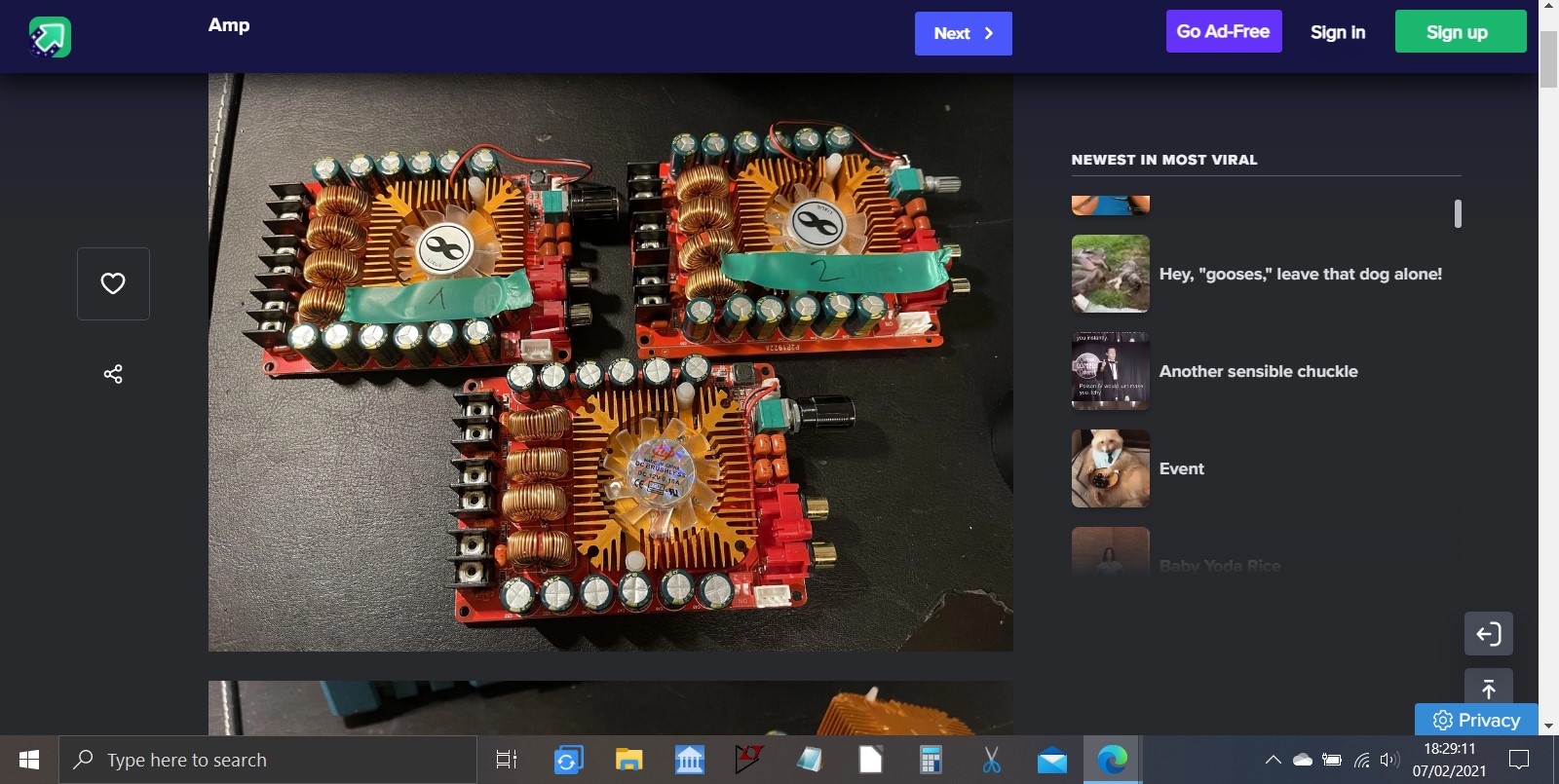

I sat down today with both "dead" boards. Found a 19V charger, used that and some 4 Ohm speakers and my iPod. Nothing. Dead. Just the red LED.
I then took another amp out of an old speaker project I made a while back (I bought that one on Amazon for 24 Euros 3 Years ago, rather than the 15 Euro china boards that both broke which I bought recently for this new project).
Initially they looked identical except for the fan logo and the tops of the capacitors. Multimeter readings (continuity etc) all similar.
Amp - Album on Imgur
Boards labelled 1 and 2 are the new boards that both stopped working. Both had 0 thermal paste.
My old board had thermal paste and a component soldered where my finger is in the picture. And the chip has slightly different writing on it.
That could be due to design changes over the last 3 years? Or its fake and broke because of that? Or it just overheated?
I am now est running my old board with the other speakers. The speakers read 2.5 Ohm.
Can I run them each on an output? Or should I run both in series on one output to give the amp 5 Ohms?

I get nothing from "Imgur" but a dark screen. It may be due to settings of my PC. I will try another PC tomorrow.
No thermal paste is bad news. Due to the very small size of the IC, thermal coupling to the heatsink is critical. But, too much thermal paste may end up between the IC pins at that is no good either.
No thermal paste quickly leaves the IC to overheat. However, the chip should have thermal protection such that when it cools off it should work again. It should not become defect even from overheating.If the chips overheated to destruction, you should measure low impedance values at the outputs. You tested them and it seems OK.
The marking on the ICs, is that TDA7498E or TDA7498?

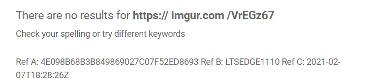

Maybe try the direct link: https:// imgur.com /VrEGz67
Not sure why you get a dark screen, might be the forum.
The second link is a dud (spaces?), your first link does work.
It would be much better if you attach images directly 🙂

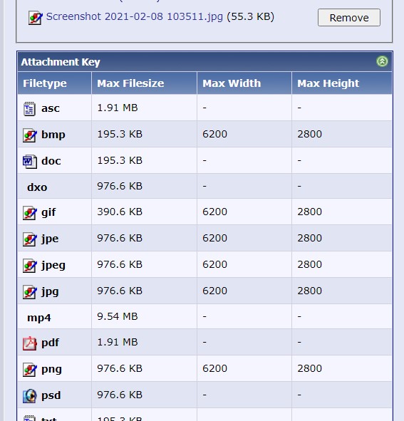

How to attach images to your posts.
Please use the ordinary picture posting facility as kindly suggested by Mooly.

Dear Mooly, sorry I did not know - I tried the image icon but that led me nowhere. Tried your instructions just now, but my jpgs don't upload. the site just gets stuck for 10 minutes. Yes I pasted the link with spaces as I thought then maybe it will be forwarded as text.
