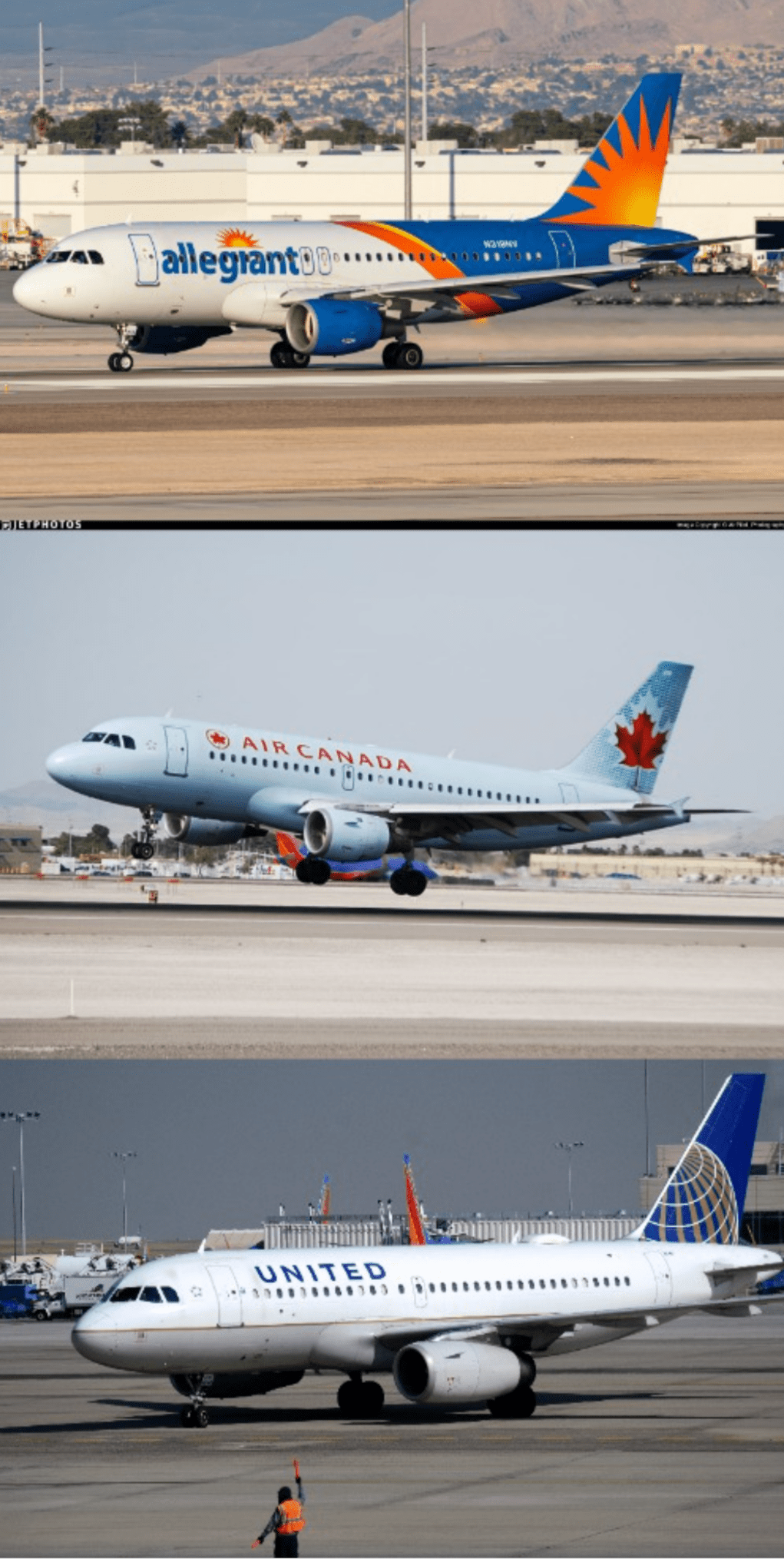

That's not how it works.
14 CFR 25.807 lays out the rules for exit doors and the seat to door ratio. It's fairly complicated, but the overall effect is as the number of seats increases, the number of doors must increase.
So your above statement is absolutely incorrect.
The reason for an aperture in the fuselage built this way is if you have a cabin with lower seating density you can have the blank, but if you have higher density, you can install the escape hatch... and the factory that builds the fuselages can minimize the production differences. It actually is quite logical.
That it failed is obviously a significant issue, but the reason for it being built that way makes sense.
Example -
The three craft in these photos are all Airbus A319.
The Allegiant has (2) overwing plug doors, but the Air Canada and United only have one. Why?
Simple - Allegiant is a low-cost carrier and has a single-class cabin with capacity for 156.
The Air Canada is 2-class, with 120 total seats.
United is 2.5-class with seats for 126.
Just imagine if one of these planes with the blanked off emergency exits had been involved in something like that runway collision they had in Japan recently. They would never have got all the passengers off.
Again, this is incorrect. The seat to exit ratio is going to be maintained. Of course different certificating agencies have slightly different rules, but in the whole they are the same across the world.
