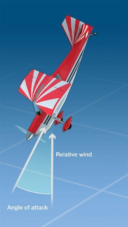

Angle of attack is the difference between the wings chord line and the "relative wind" - the angle between the chord line and the movement path of the center of mass of the aircraft. Pitch attitude (where the nose is pointing) actually doesn't have much to do with it...
For a great example of the nose (and wing) pointing up, but the flight path going down, just look at Concorde landing. Very high AOA.

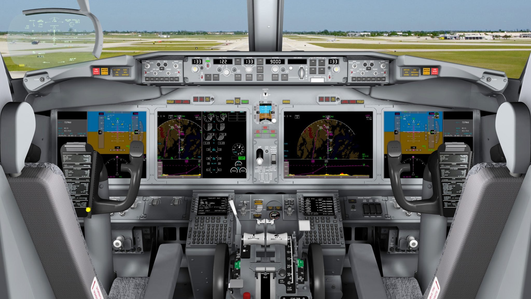

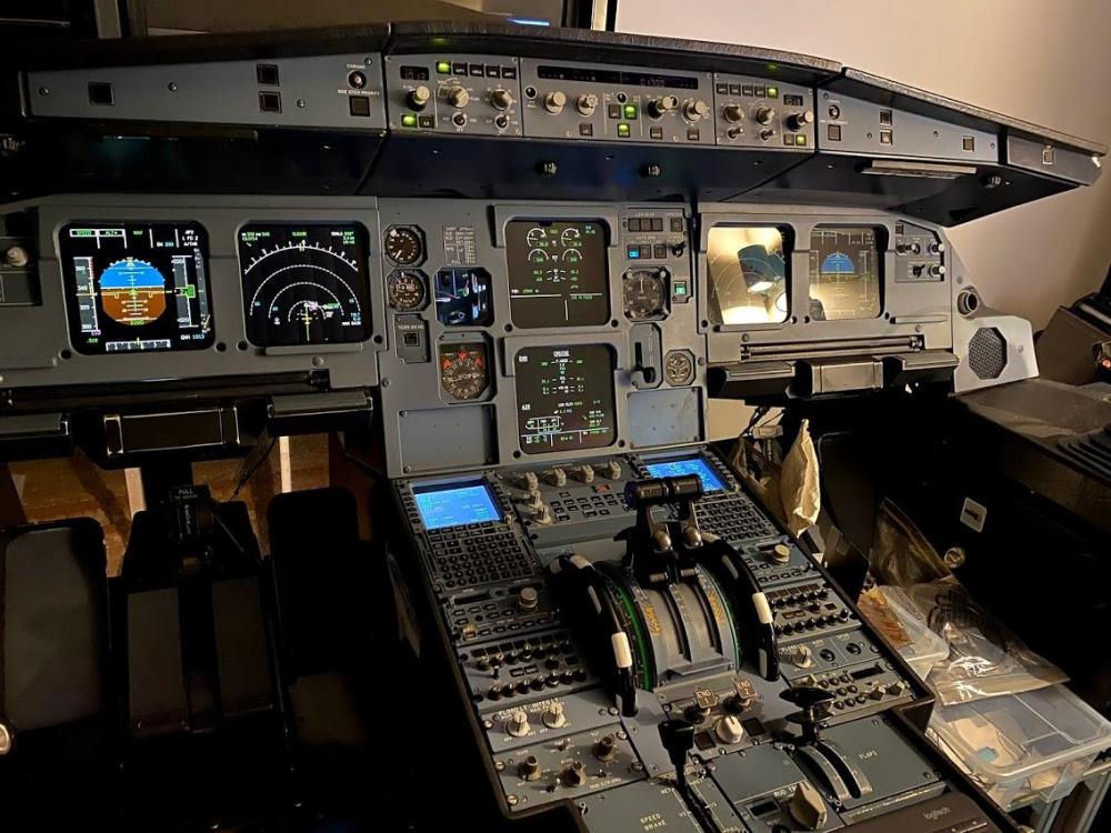

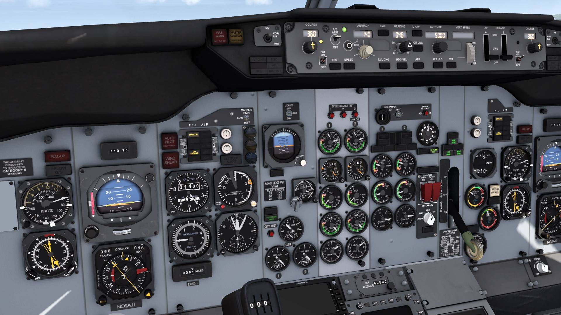

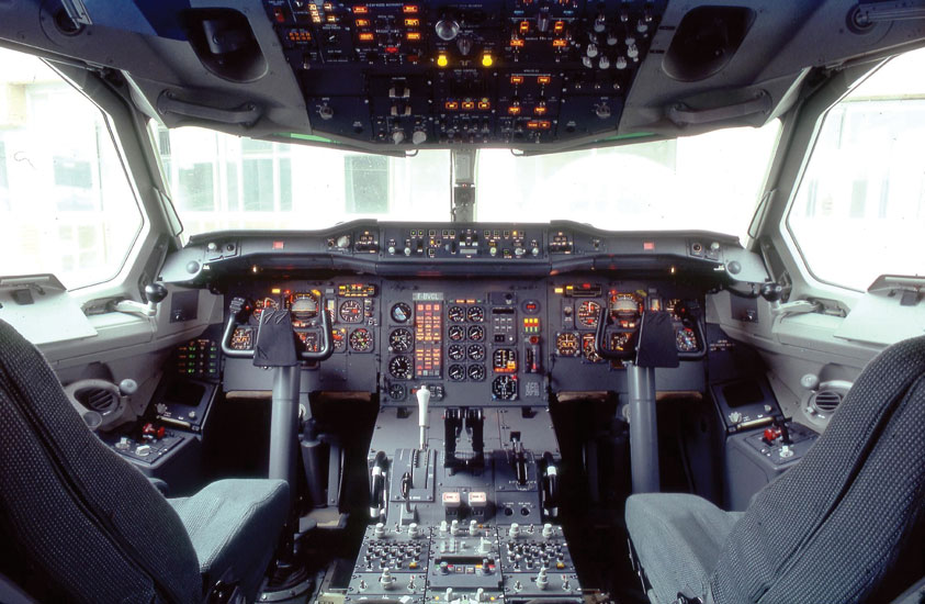

There was a Standby (wet) Compass on the older airplanes. Totally self contained.When people talk about stalling an airliner, I always wondered why there wasn’t a simple mechanical device in the cockpit that directly indicated the nose- up angle. You could hang a small weight off a string and you’d get a clear indication.
There was and is one Attitude Display in front of each pilot (on the main EFIS display today, or “Artificial Horizon” on older versions).
There is one Standby Attitude Display in the middle of the front console
(look at pictures shown two posts above)
George
