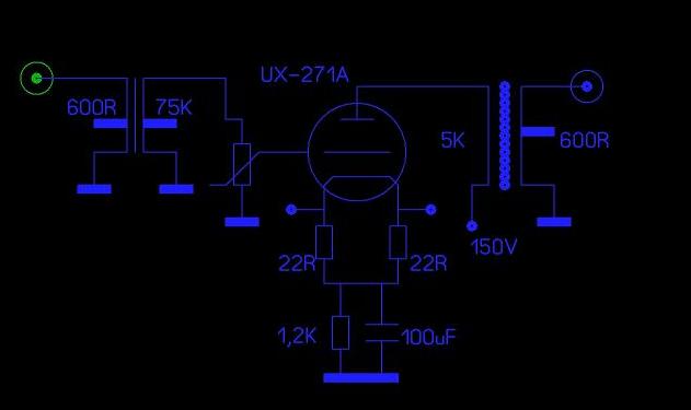

Hi Noodle88,
My friend used input transformer 600 : 75 K with good result.
his schematic :
Van Duy

You can replace 45 driver stage with 71A, my friend tried and he chose 71A. he used Lundahl (unknow) - 71A - LL1677-300B - XE20s.
I did amplifiers and pre-amplifiers with 45.
- Power: 417a-45-James transformers.
- Pre: Lundahl 1544a (or 6j5) - 45 - LL1692A.
I like the sound power amplifiers 45 but low power (I test with Fostex 208 BLH speaker). With pre45 I failed, may be my preamp schematic is not good.

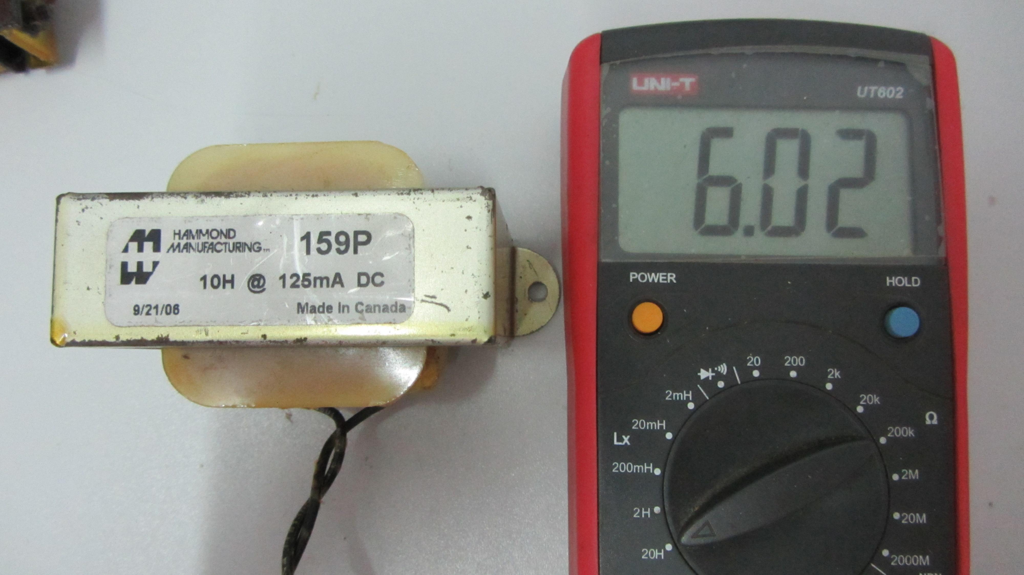

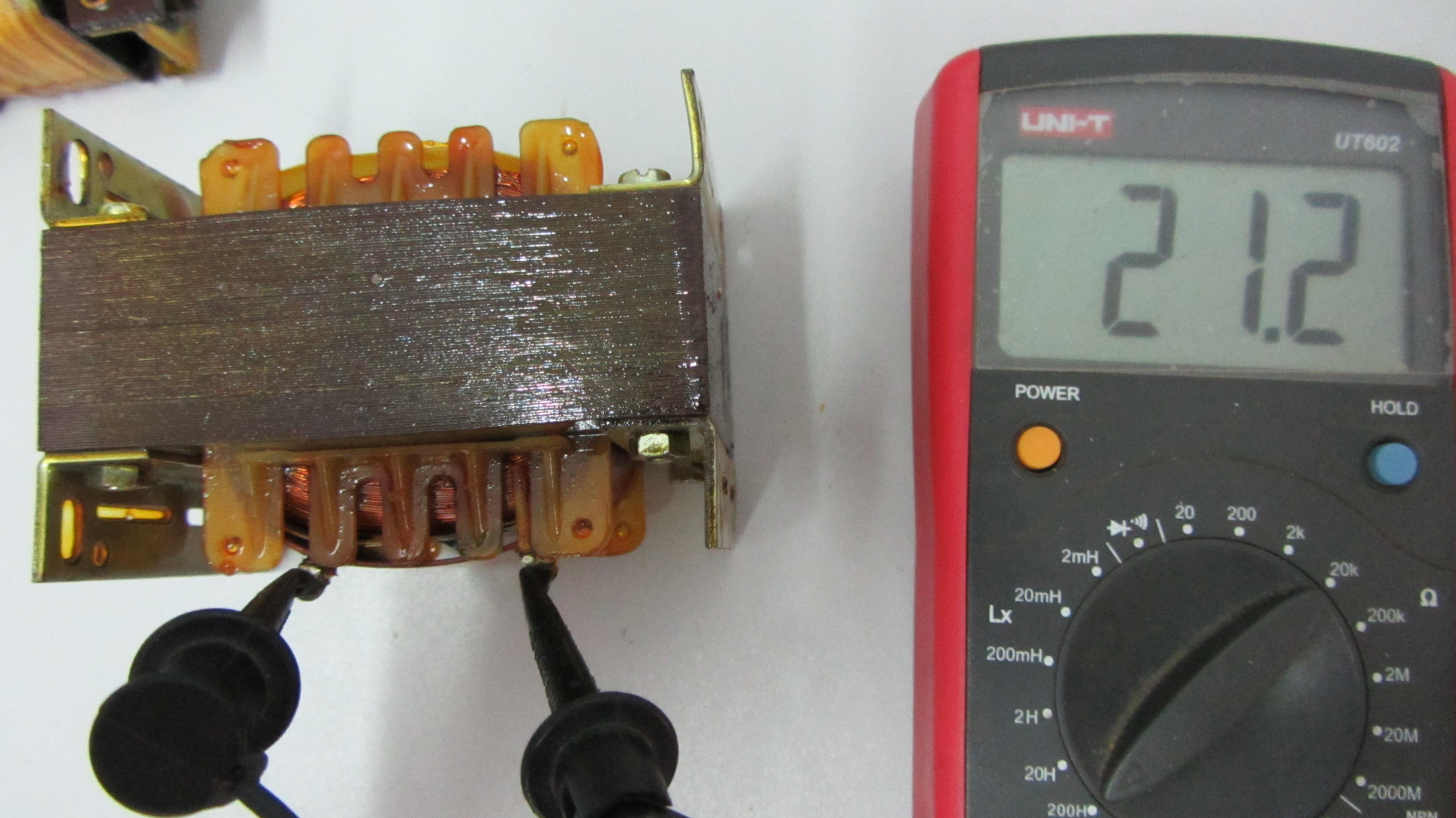

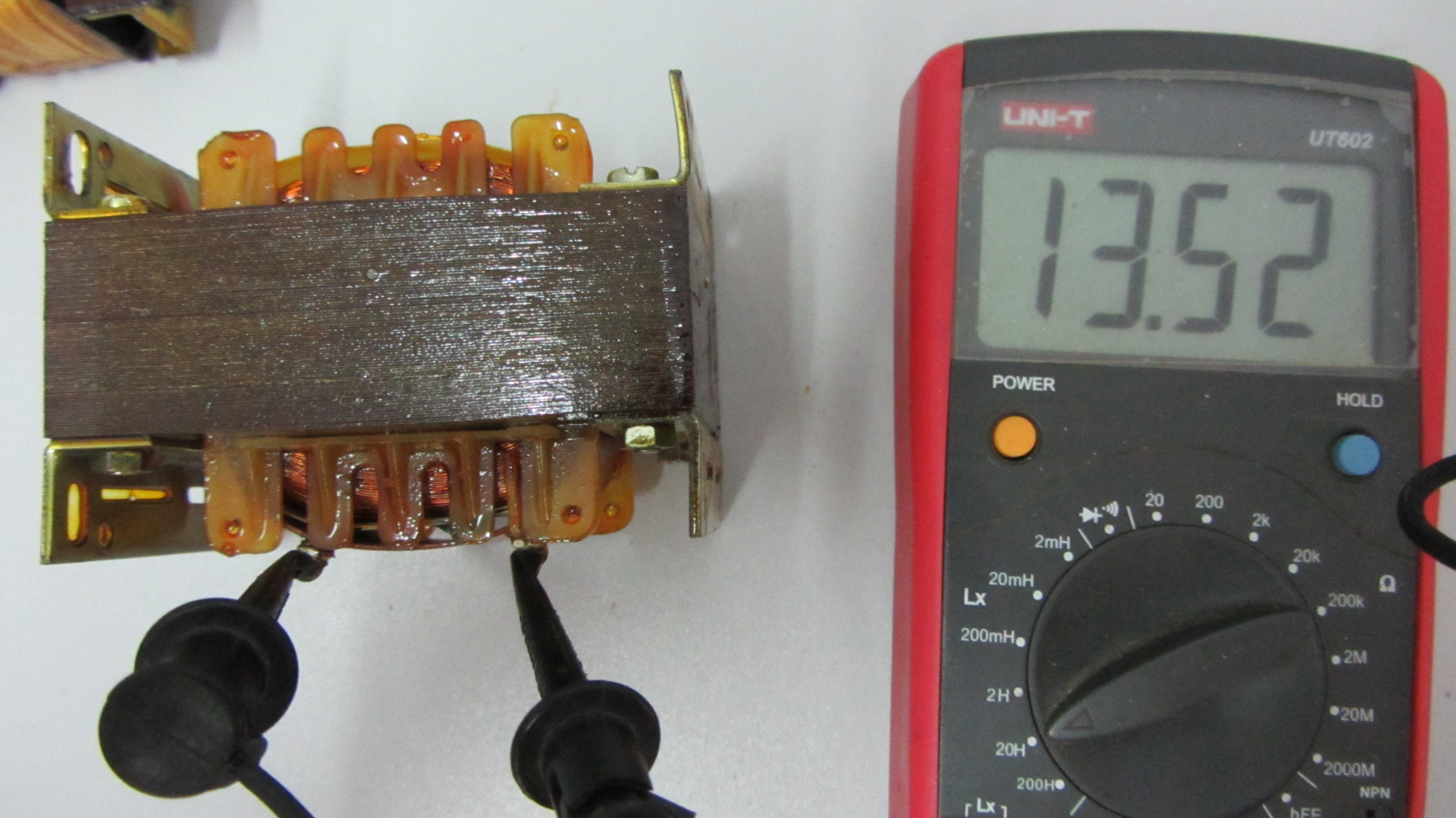

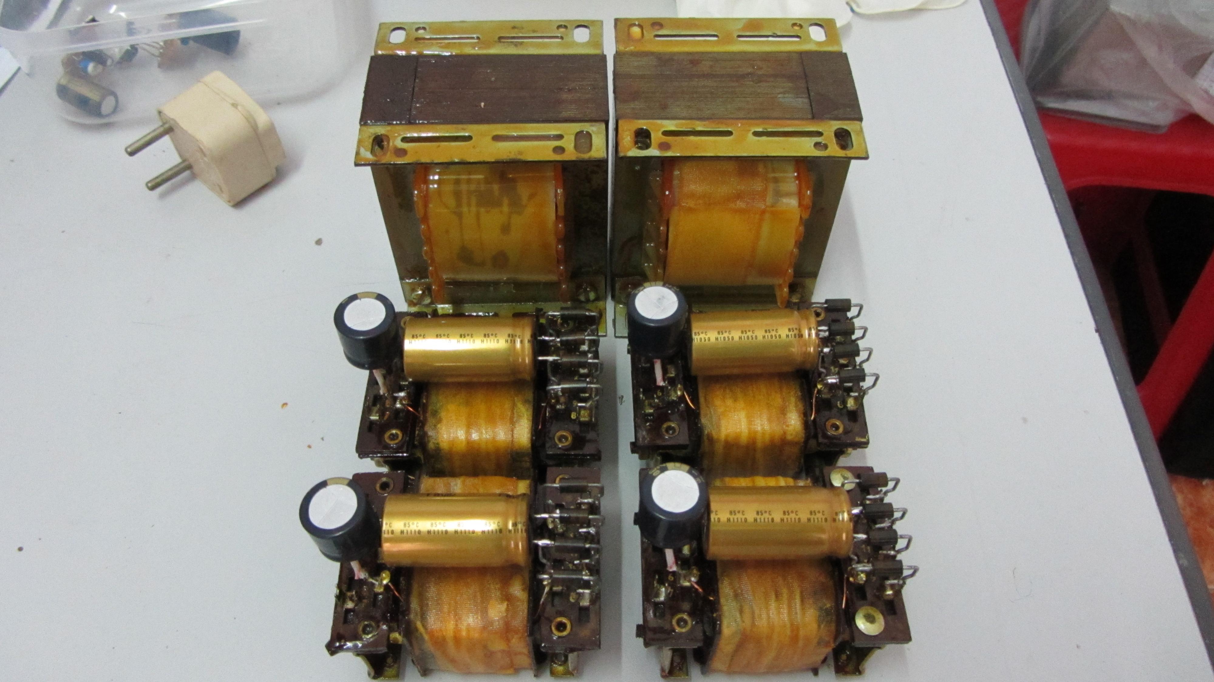

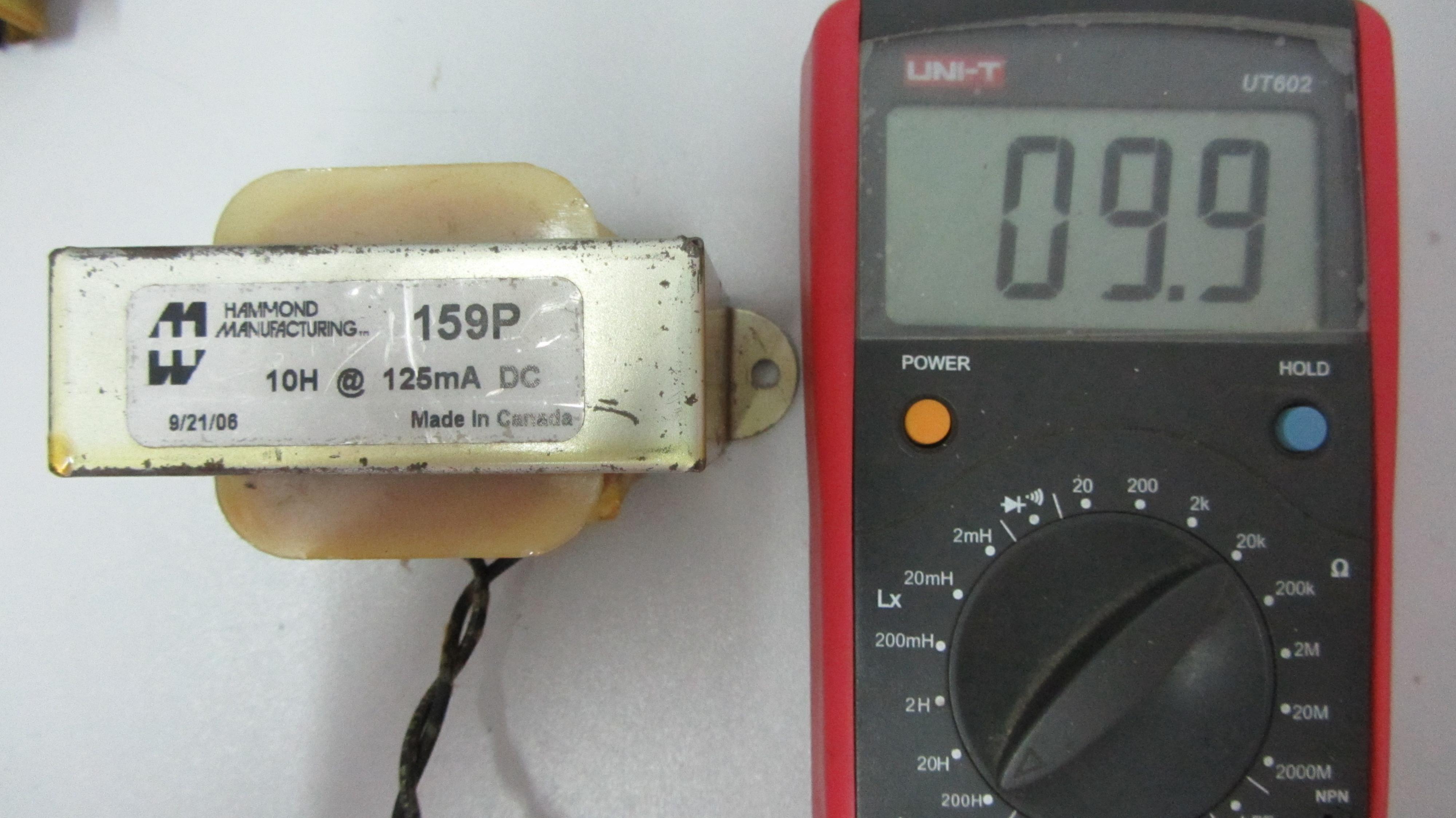

I just winding 4 x 4,2mH for 71A filament and 2 x 14H for B+ .
LCL filter is always good for 71A. I replace 71A RCA with UX-171A Cunningham/RCA for my preamp. It get more microphonic but sound is fanstastic. I did improve filament filter with bigger capacitor and better B+ with more henry choke so hum noise become minimum, < 1mV
Thank tcqanh , I use 10,000uF/16v for first capacitor .
My choke measured with different values ​​on the same gauges henry with 20H and 100H meter. I test with 10H/125mA Hanmond .
* 20H meter :
- Hanmond is 6.02 H
- My choke is 13.52
* 200H meter :
- Hanmond is 9.9 H
- My choke is 21.2 H
