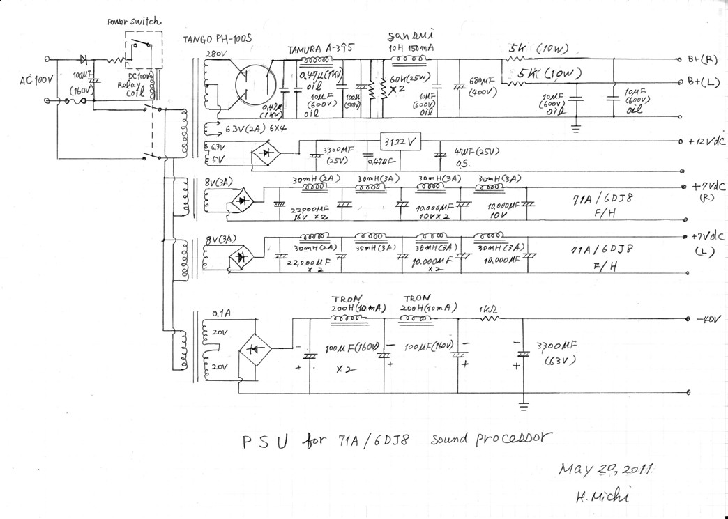

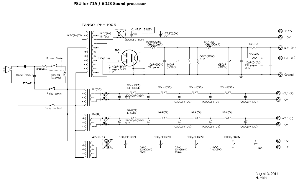

Updated schmatics of 71A/6DJ8 sound processor
I have made minor modifications to the PSU and the Amplifier as follows:
 B+ voltage is to be always supplied to both tubes:71A and 6DJ8, for which the built in toggle switch was removed. So selection of the operation is only done by the filament voltage.
 Addition of a resister 3K ohm (5W) & a decoupling capacitor for lowering the operation voltage of 6DJ8 in the amplifier.
 Addition of a pair of Oil paper caps 0.47 micro F (1Kv) to the cathode of 6X4 (an idea adapted from the recent thread ).
 Addition of another bleeder resister 60K ohm (25W) in parallel in the PSU.
So far, I am fully content with the sound of either 71A or 6DJ8. However I do concern on the flicker noise level appeared namely in the 6DJ8. I suspect that this flicker noise level would influence badly to those of high order harmonics, though it is not audible noise. Is there any idea to overcome this problem? Never the less, I understand that choke input circuit is good for sounding but weak at the flicker noise characteristics.
Measured the residual noise level by VTVM(1mV and 3mV range)
71A: 0.04mV ~ 0.3mV
6DJ8: 0.1mV ~ 3mV
The inherent gain of 6DJ8 amp was of 12dB, while 71A was of 0dB.

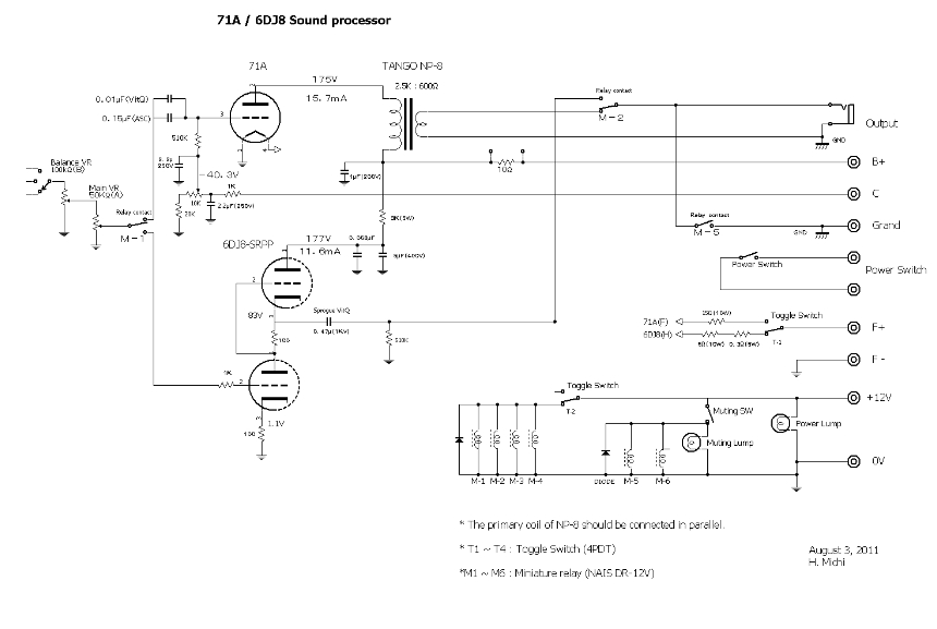

Updated schematics of 71A/6DJ8 switchable sound processor
I have made further touch up to the said sound processor as follows.
Now I am quite contented with the sound of both 71A and 6DJ8-SRPP.
1. Removed a load resistor 1K ohm terminated at the output coil of NP-8.
2. Some changes have been made in operating point of 71A:
*Plate voltage: 175V
*Plate current: 15.7mV
*grid bias: -40.3V
3. Input voltage vs. Output voltage vs. Distortion%
1.00V vs. 1.42V vs. 0.02%
2.00V vs. 2.90V vs. 0.028%
3.00V vs. 4.30V vs. 0.048%
By removing a load resistor of 1K ohm, improving distortion characteristics and an anmprlifier gain became 3.0 dB from 0 dB.

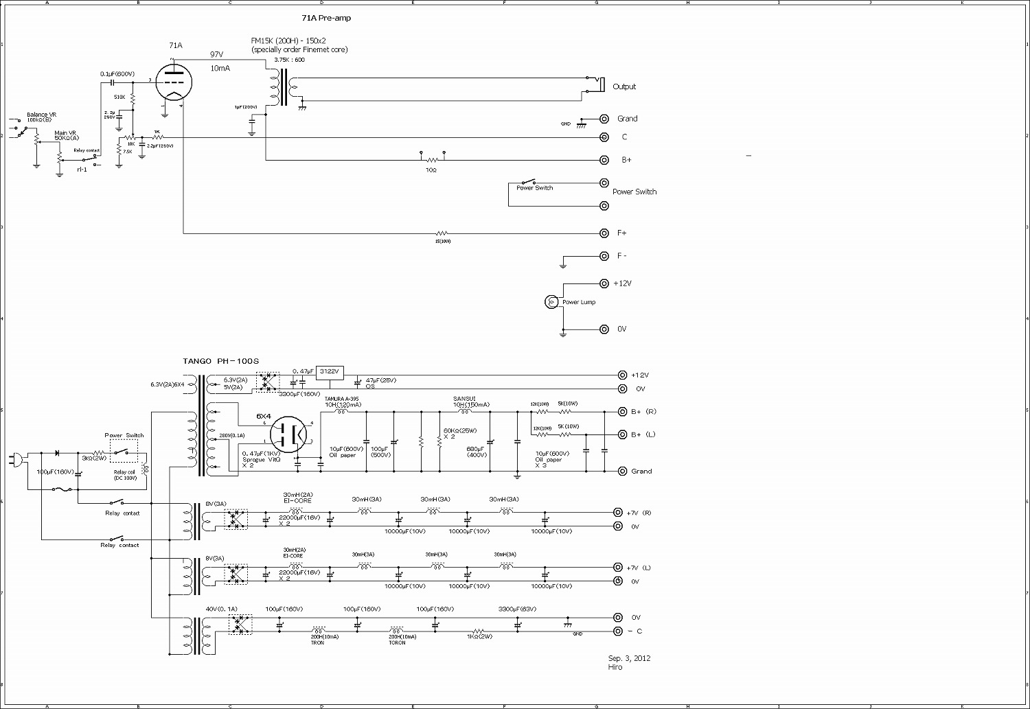

The last version of 71A pre-amp
Hi Michi,
Do you have any more modifications ?
what schema of 71A is the best sounding for you ?
For the past 18 months, I have been playing in developing or upgrading the 71A pre-amp on try and error basis. Now I would conclude this project as I have got an favorable results in all respects.
followings are the highlights:
*Change OPT from Tango NP-8 to Finemet core OPT,FM15K(200H)-150x2
*Load impedance from 2.5K ohm to 3.75K ohm
For the next project, I am considering to try 26 as it has been said in the community of its specific sound properties.

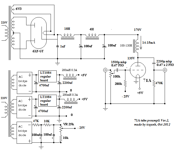

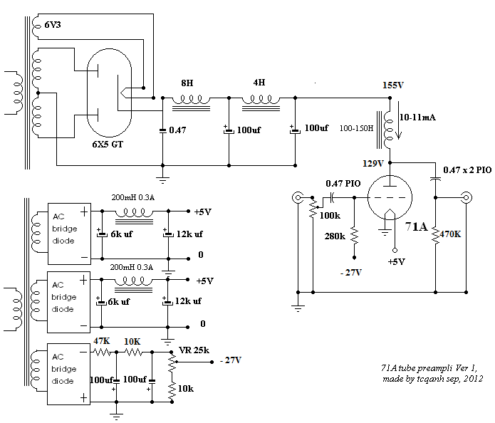

First I used plate choke of 50H, bass was a little bit weak. Now I exchange to 100-150H choke (I have 2 manual LCR meters, one show 100H, the other show 150H at 120Hz scale 🙂), so bass become better. But I feel that bass is not tight very much when compared to my solid state preamp.
midrange and treble are fanstastic. high frequencies get better, sparkle with 150H plate choke.
here is my schematic

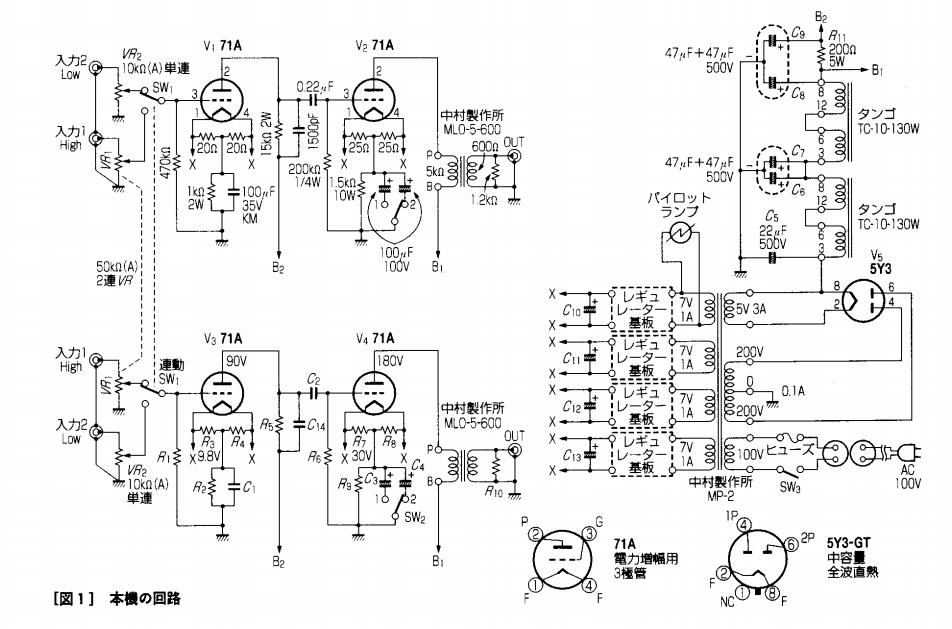

71A Preamp
I have plans do 71A preamplifier, but it's delay for a long time.🙁
The schematic was designed by Matsunami-Japan, I have done a few projects in his books, very good results .
I use Hashimoto HL-20K-6 with parrallel primary for 5K:600 Ohm .
