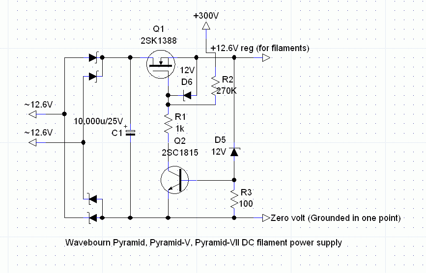

that is an amplifier Anatoly isn't that?
Q1 is the series pass and Q2 is an error amplifier...
Yes. An error amplifier loaded on 300k, and a source follower with voltage on the gate limited by 12V protecting Zener. 0.022 Ohm resistance. Simple, but functional, like AK-47 machine gun.

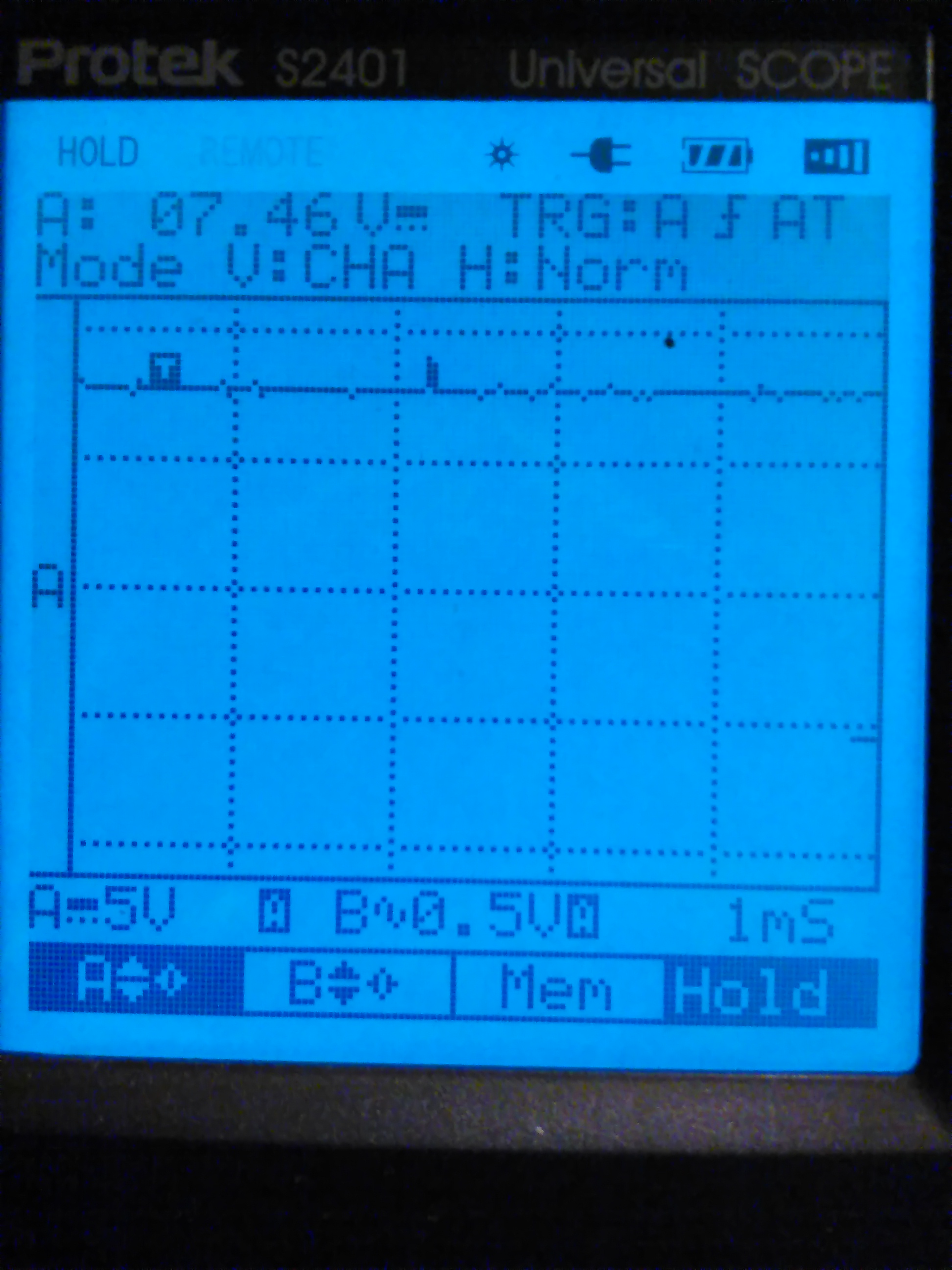

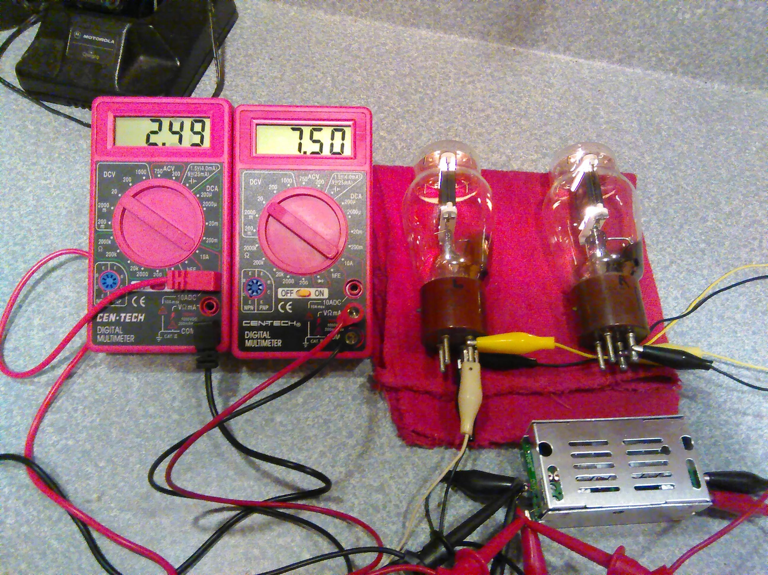

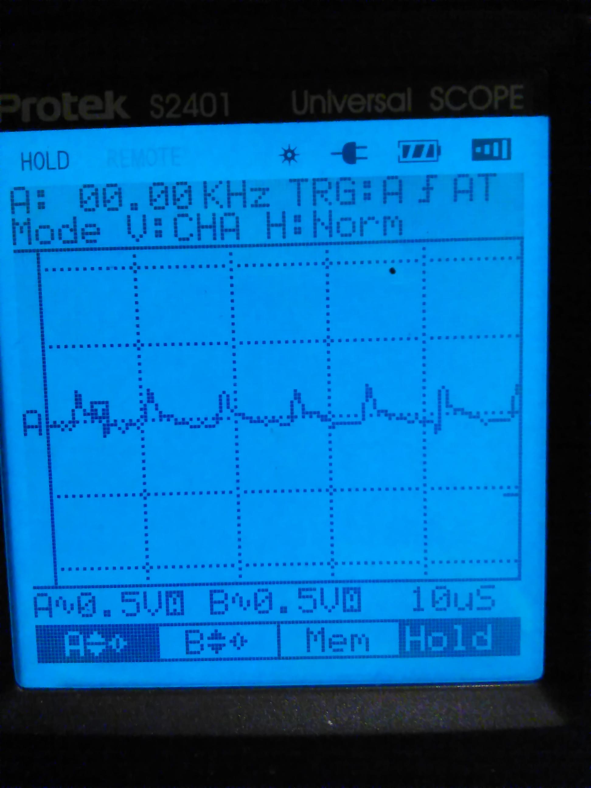

Has anyone used one of the dc to dc buck boost, or buck converters that are now widely available for almost no money to power dh filaments?
Out of curiosity, I hooked up a couple of 801A's to one that is widely available in the $5 USD range. DC output looks Okay, there is ac switching noise of about 0.2 volt at about 120 kHz. The scope shots are with it hooked up to the 801A's.
This one is supposed to regulate voltage and current. It held voltage to about 0.01 volt over an eight hour span. Not sure about the current regulation, it has a current control that has to be adjusted for the load, but it may be current limiting. Or something else. No documentation, of course.
