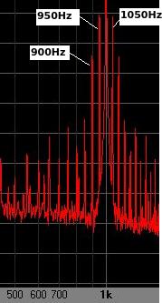

The power output in these plots is only 1W, but the ac-heated PP sample (the RIGHT-hand picture) is already generating large numbers of sidebands - the mains-fundamental sidebands (±50Hz in this case) are only 50dB down. Keep in mind that these sidebands will arise around every tone in the music, creating a widespread fog across the spectrum (a fog is rather like what it sounds like, too). This is certainly not my idea of Hi-fi.
I looked at it, and it is not convincing. First, why comparing apples to oranges (I mean PP and SE amps)? Second, in both graphs there is a lot of noise from AC and its harmonics, not necessarily coming from the heaters. Third, what you believe to be 50 Hz IMD in the PP graph looks to me like noise.
Well PP is very unlikely to make the ac-heated example perform worse. It is perfectly clear to me that the 1KHz signal has -50dB spurs at 950 and 1050Hz. Are you viewing on a small screen?
I have taken the liberty of taking a detail of Bela's FFT to expand and highlight the 1KHz sidebands.
Well, may be or may be not. PP data are particularly suspicious because, at least in theory, PP should be largely free of residual hum, as it cancels the 2nd harmonic. Then, how come 50 and 100 Hz fundamentals are lower than 1050 and 1100 IMD signals? Something doesn't match here. I tried to copy and paste the graph to expand it on the x axis, but it didn't work. Looking carefully, there are additional closely spaced bands in the vicinity of the 1 kHz band. Provided that this is a screenshot, it is a plausible proposition that this is noise.

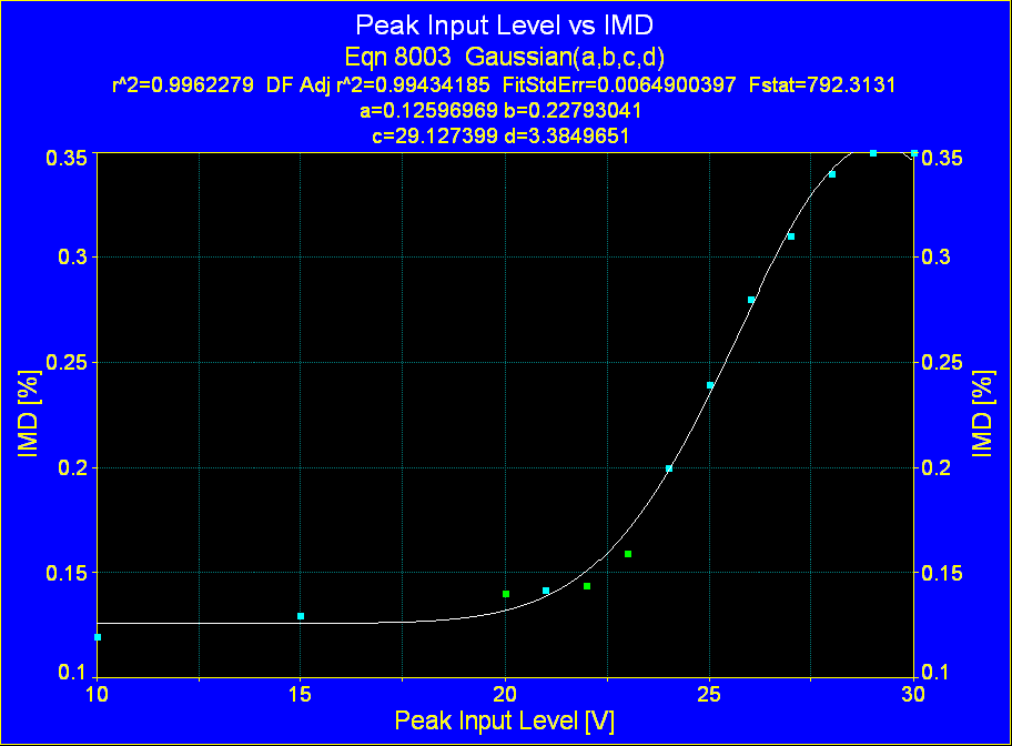

From Steve's paper, IMD from residual filament hum with 6.3 VAC filament voltage is about 0.12% at moderate amplifier power. For 2A3 or 4P1L it should be 0.04-0.05%.
Just out of curiosity, how did you find those numbers?
Can you please post some more detailed calculations?

Please look at Steve's paper here:
Effects of AC Heating Power Applied to Directly Heated Triodes
The IMD table is at the end of the article. The data are for DHT with 6.3 V filament. For 2.5 V and 2.1 V filaments, hum values and IMD should be proportionally less.
Sorry, the law of proportionality is not evident, but it is not linear for sure, actually raw data fit reasonably well with a Gaussian.
Then, your numbers are meaningless.
Rod's effort to explain us a phenomenon deserves at least some measurements and calculations.
