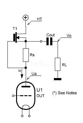

Another way of getting low output impedance would be to configure the '71A as a mu follower.
https://www.valvewizard.co.uk/mufollower.html
That can also easily be made with a depletion mode MOSFET (e.g. DN2540) on top of the triode, like so:

Does the audio signal run thru the depletion mode MOSFET?
The triode does the voltage amplification. The MOSFET is a constant current source (CCS), which provides a very high impedance to the plate of the triode.
Figure the impedance of the CCS is about 500k ohms.
That makes the load line almost flat, lying horizontally across the plate curves.
What that does is make the triode operate with maximum gain and linearity (lowest distortion). Not only that, but the output from the MOSFET source is very low impedance, so it won't load down driving reasonably short cables and the 10k input impedance of your amplifier.
I ran a simulation and got 1V rms out at 0.035% THD, all second harmonic, 3X gain. That's with no negative feedback (other than the intrinsic feedback of a triode and the source follower action of the plate load CCS). If you're looking for hi-fi, I think this would be the easiest way to go. It looks really good to me.
Another good thing is that the CCS only needs to drop 50V across itself. If the voltage at the 71A plate is about 110V, that means your B+ only needs to be 160V DC or so. You could do that with a single 0D3 VR tube.
Some people claim to dislike the sound of a mu follower made this way. I've tried it and I like it very much. I use it as the output stage of my phono preamp (a 6DJ8 with a MOSFET CCS plate load just like the one in the drawing in post 28).

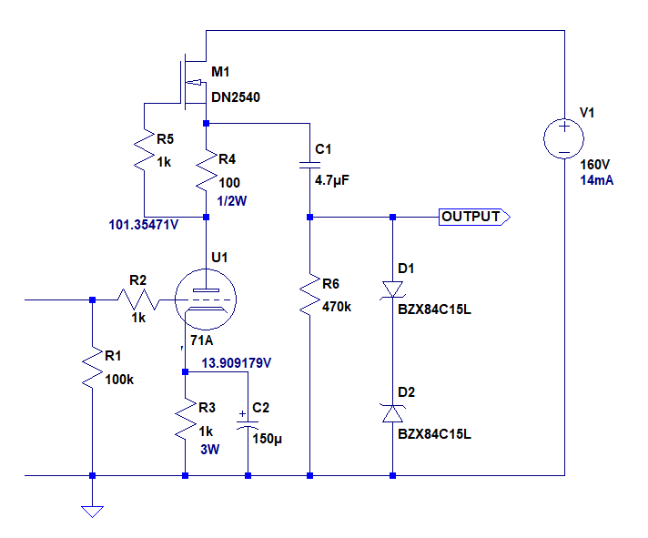

I would make the output cap 2.2uF at minimum. If this was my project, I'd use a good quality 4.7uF polypropylene film cap there. A 10uF film cap would be a reasonable choice too, if you can get your hands on a couple.
On the other hand, if -1dB at about 32Hz is OK with you, then fine. The low bass will be lacking, though. Low E on a string bass or bass guitar is at about 40Hz, so that should play through with no attenuation. The only problem is that hum could possibly be picked up by the cable from the preamp with a 1uF output cap to the power amp. A larger cap would minimize that possibility.

This is what I've come up with:
6A3sUMMER raises some excellent points. I suggest heeding his advice.

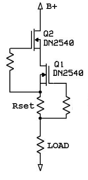

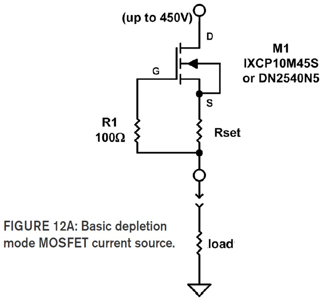

Yes, a cascode CCS is better.
But the single MOSFET CCS is easier to implement and will be very much good enough, as the rp of a 71A is low, about 1500 ohms. For a 71A, a plate load equivalent to 200k or so is pretty much as effective as a plate load equivalent to 2M ohms.
Single depletion mode MOSFET CCS:
Cascode CCS using depletion mode MOSFETs:

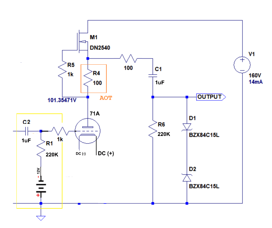

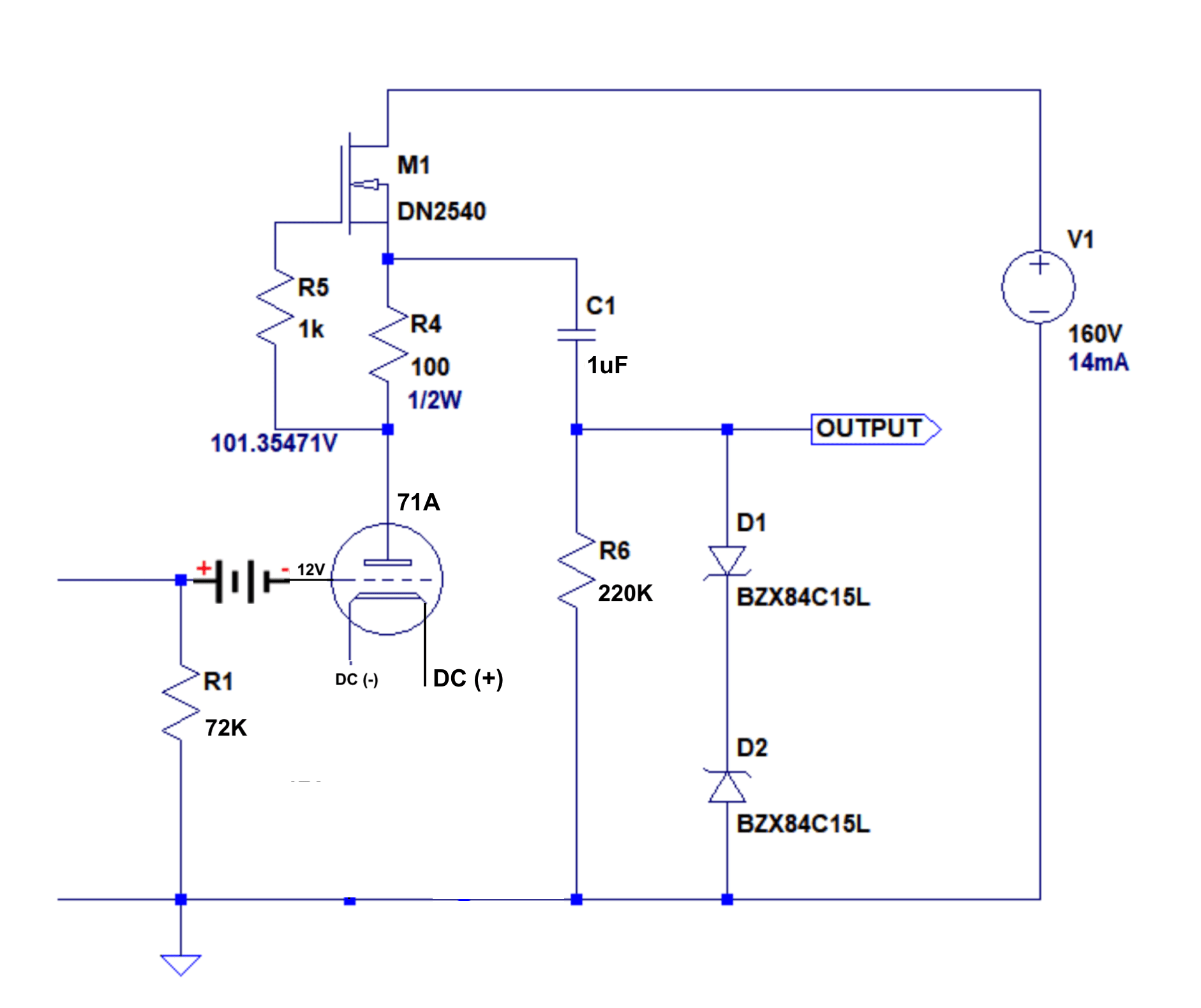

Here is the updated schematic. I made some changes based upon parts I already have. The coupling cap is 1uF (I can always upgrade to a larger value if the bass / low-end is noticeably insufficient). Notice the 12V battery fixed bias. Grid leak is changed to 72K (enough?).
Thoughts?

I'm not familiar with that way of applying fixed bias from a battery. I usually see it implemented like this (parts in the yellow box):
Note that R4 will need to be adjusted on test (AOT) for each MOSFET to obtain the desired plate current drawn through the 71A. You could put a 100 ohm trimpot in series with a 68 ohm resistor in place of R4, and adjust by measuring the voltage across that 68 ohm resistor (E/R =I). If you measure 1V across that 68 ohm resistor that means there's 14.7mA (0,0147A) drawn across it (1/68 = 0.0147).
Also note the addition of 'stopper' resistors before the 71A grid and after the DN2540 source.
The grid stopper on the 71A suppresses RFI pickup and possible oscillation.
The build out resistor in series after the DN2540 source inhibits oscillation when driving a capacitive load such as a long stretch of interconnect cable or an amplifier input with high input capacitance.
Those are just 'good practice' measures to stay out of trouble. 😉
