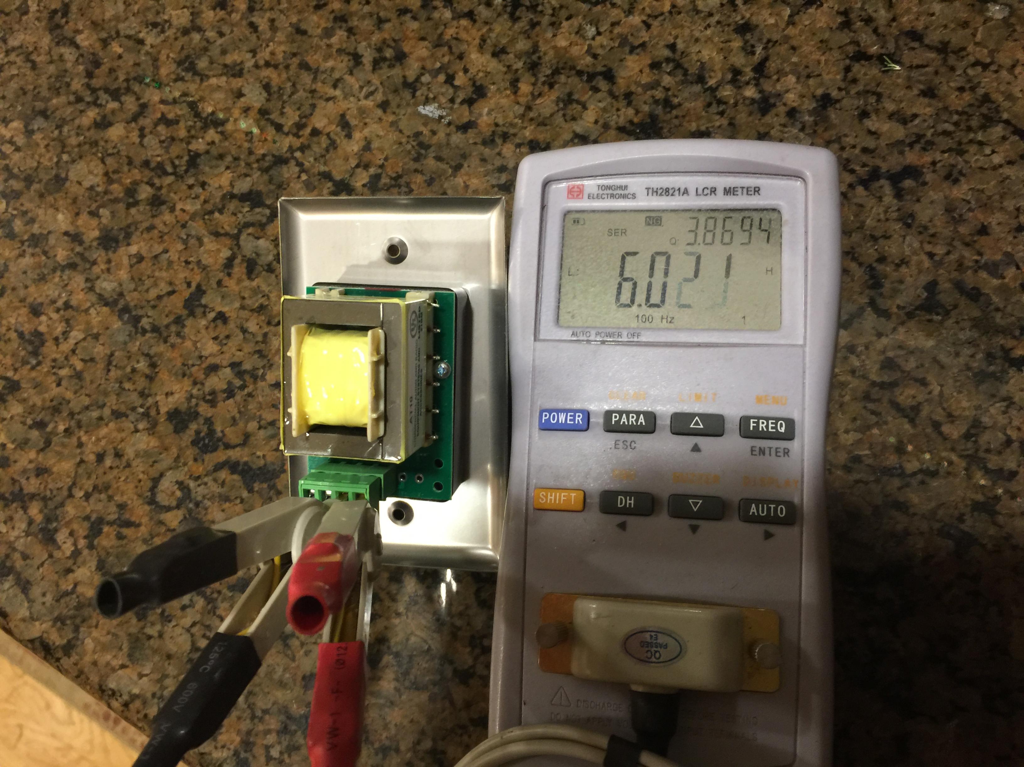

I bought a pair of 10W transformers, measure.
One on 100 Hz measures 6 Henry, another one measures 6.2 Henry. As I expected for 100V transformer. No free lunch, except in a mousetrap!

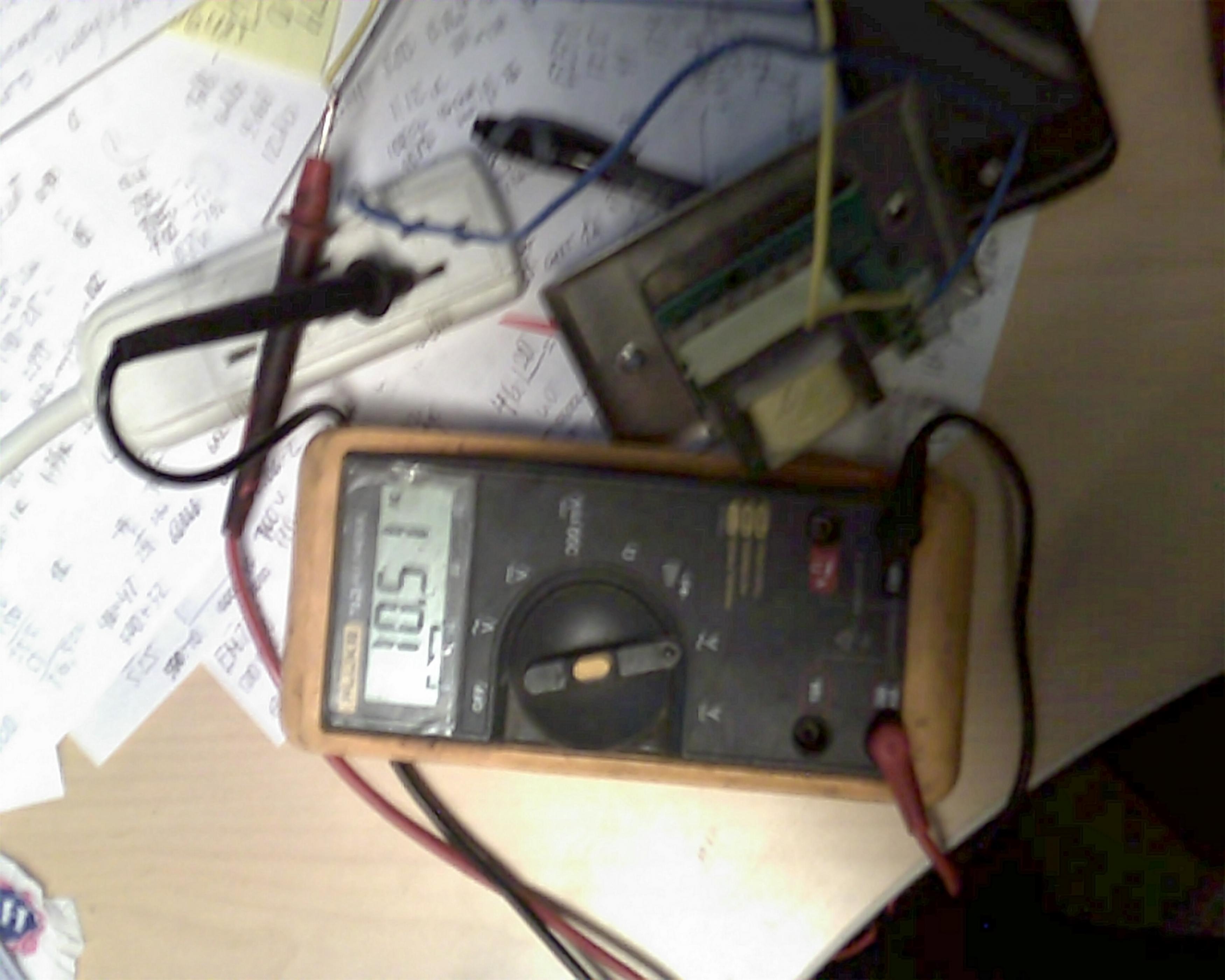

OK, another quick and rough measurement of AT10.
Transformer primary is plugged into 120 VAC outlet via Fluke multimeter set to measure AC current through 300 mA port. The current draw is 10.5 mA. Accordingly, the impedance is ~12K, which corresponds to inductance of 33 H. You could try it yourself, it is pretty easy.
Inductance is strongly affected by frequency and AC voltage, hence the discrepancy between different measurements. What measures 6 H at 1000 Hz (a typical frequency of LCR meters), could easily be 50-60 H at 20 Hz. When I previously reported 70 H, that was at 6 VAC 60 Hz.
There are two components in frequency-dependent change in inductance, one magnetic permeability change and the other change that applies to all coils, regardless of whether or not they have ferromagnetic core.
