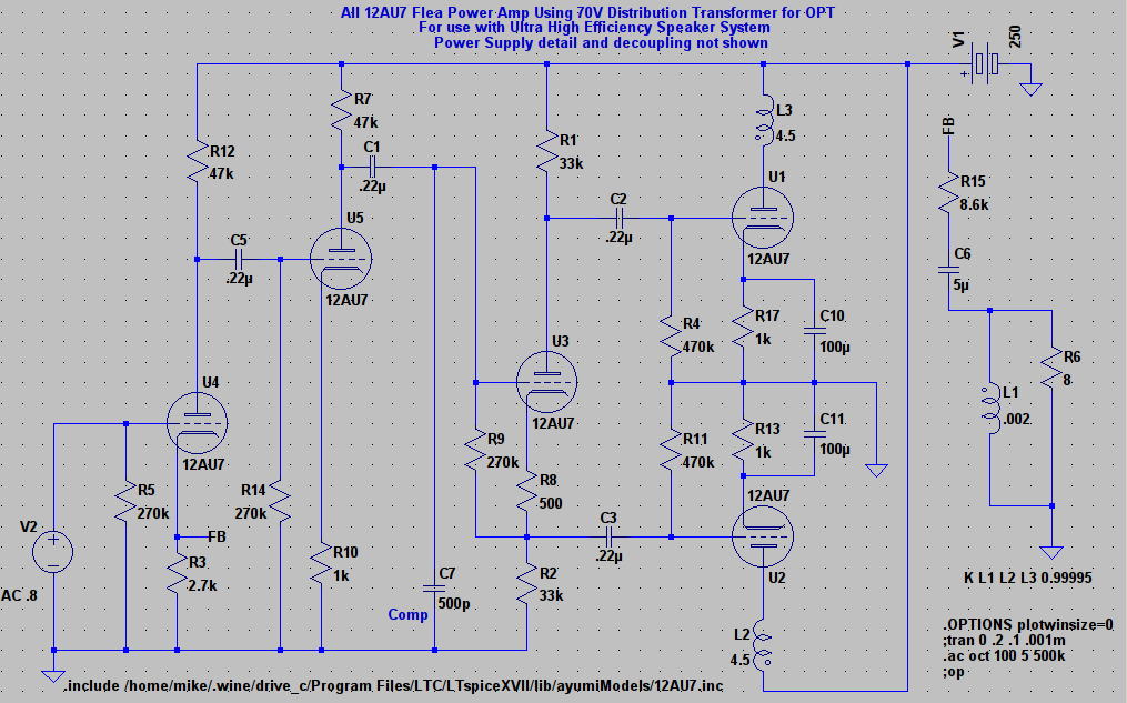

Many thanks. All this input has been very useful. This is the kind of application I had in mind (note this sim is far from complete in detailed component values and PS and is provided only to give an idea of the kind of application).
It would be used to drive very efficient speakers that would be supplemented with a sub. Another possible use would be a multi amp system for mid or tweeter.

Do you really need that much voltage gain to drive these »power« tubes sufficiently? The first triode, U5, could be omitted, the NFB related to U5's cathode instead *imho*. There's also no need for C6, unless you want some certain bass boost.
Best regards!
Will look at using only one VAS. It seemed like a single low mu VAS stage would not have enough excess gain for GNF (it worked fine for 0NF though).
I thought the cap in the feedback loop was needed for proper DC biasbeing that the OPT is at DC ground. Certainly would be nice to be rid of it.
12AU7 as power tube may need 12V drive.
U5 would have gain of 13, except Rk is not bypassed, so gain of 6.
2V at that grid would work _if_ no NFB were desired.
As NFB seems to be in the plan, another gain of 2-20 is needed to make NFB work. Hence U4.
Yes, could replace U4+U5 with a single higher-gain device. 12AX7 gain of 60 (into cathodyne), 0.2V naked so a 1V sensitivity allows 14dB NFB. Some people dislike 12AX7.
No. Figure your DC bias as R3||R15. Won't hurt to put part of U4 current through the OT. (Yes, ~~1/10th of U4's R15 current then flows in speaker; this should do no harm.)
2.7K||8.6K= 2.05K. This does seem low for 12AU7 with 47K plate load. Well, not that low. And U4 bias does not have to be "optimum" because it only has to swing the small level that U5 grid can take. And running rich increases gain, which is really U4's main job. FWIW, GE R-C data suggests for driving 240K load (you have 270K), use Rp=100K and Rk near 4400r. Since this is twice what you have now (with C6 strapped-out), double R3 and R15. 5.8K and 18.5K (5.6K and 18K, 6.2K and 20K).
The plan has _four_ stages on one power node. Remember the B+ line couples signal at any one stage into any/all other stages. While B+ filtering reduces this (and SPICE's perfect batteries won't allow this), high-gain amplifier chains DO oscillate. Typically the forward bass gain exceeds the backward B+ bass filtering and it motorboats. Rule-of-thumb says no more than two stages per node without hard thinking. While U1 U2 nominally cancel, do not bet on it. Also because U1 U2 mostly do cancel, they do not need super-clean power. But U4 sure needs clean power. U5 and U3 could use judo to improve PSRR, but can't be assumed to do so. And with sane Rp values current in the first few stages would be very low, easy to filter just that. Or with low-cost electrolytic B+ filters, take all 7mA with a 70V drop (250V-180V), 10K, and even 50uFd would be ample. So use 2K and 250uFd to keep first-stages B+ high.
Have you run your sims down to sub-Hz? This is where a many-RC and OT amplifier under NFB often turns vicious, big sub-sonic hump. Maybe you do not have enough NFB gain to be in deep trouble. Remember the OT inductance is very variable with brand and signal.

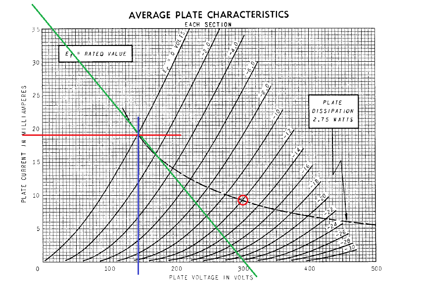

The Quam TBLU could be connected to yield a 16KCT primary, which looks practical for PP 12AU7s in class A1. With the anodes at 300V, I reckon power output of 0.75W for this alignment. Somebody should check my work, though. See attachment.
This tube can deliver a lot more power when the grids are driven positive -- maybe 4W into 16K with +10V grid peaks in class AB2, which requires about 10mA grid drive current. The little Quam xfmr might not like this alignment, however.
